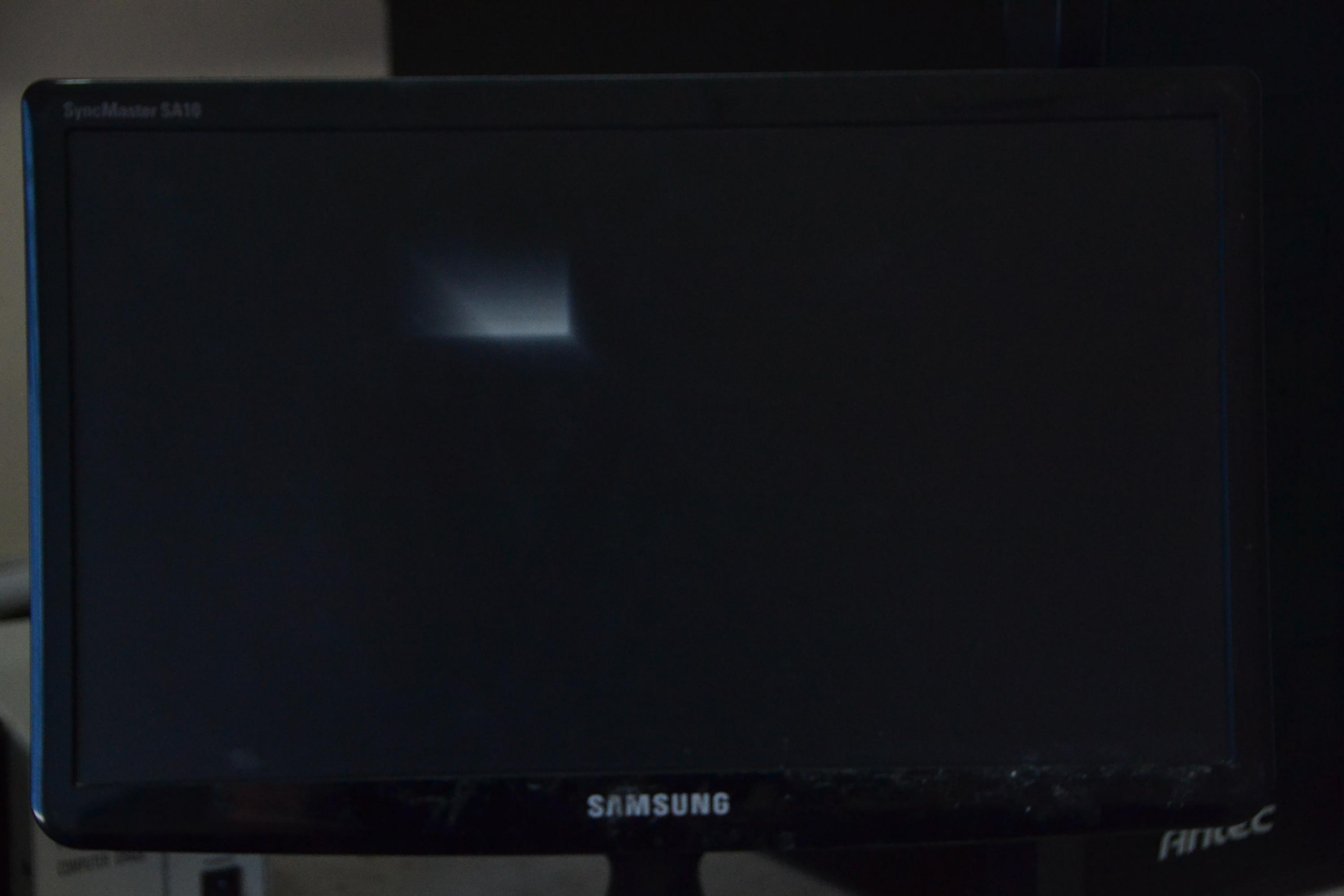

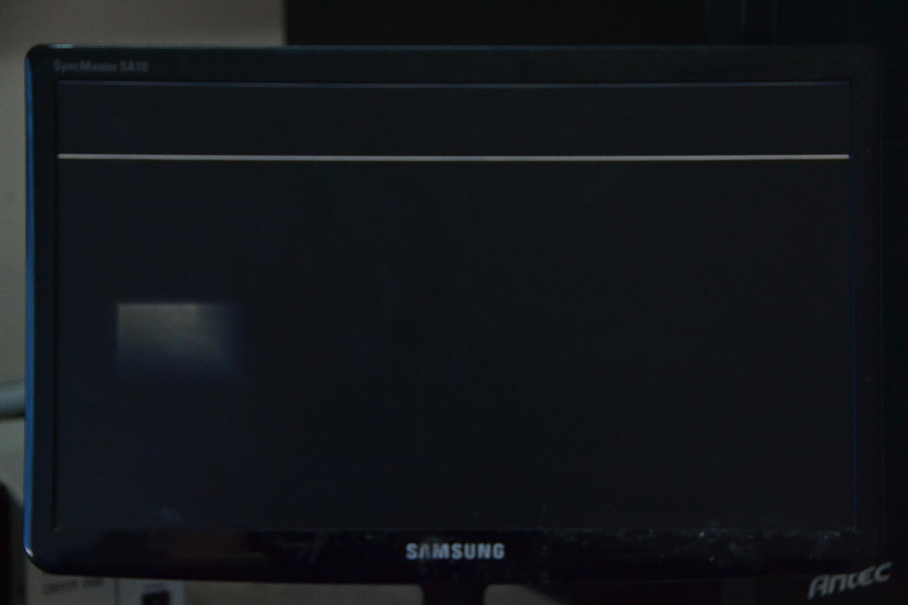

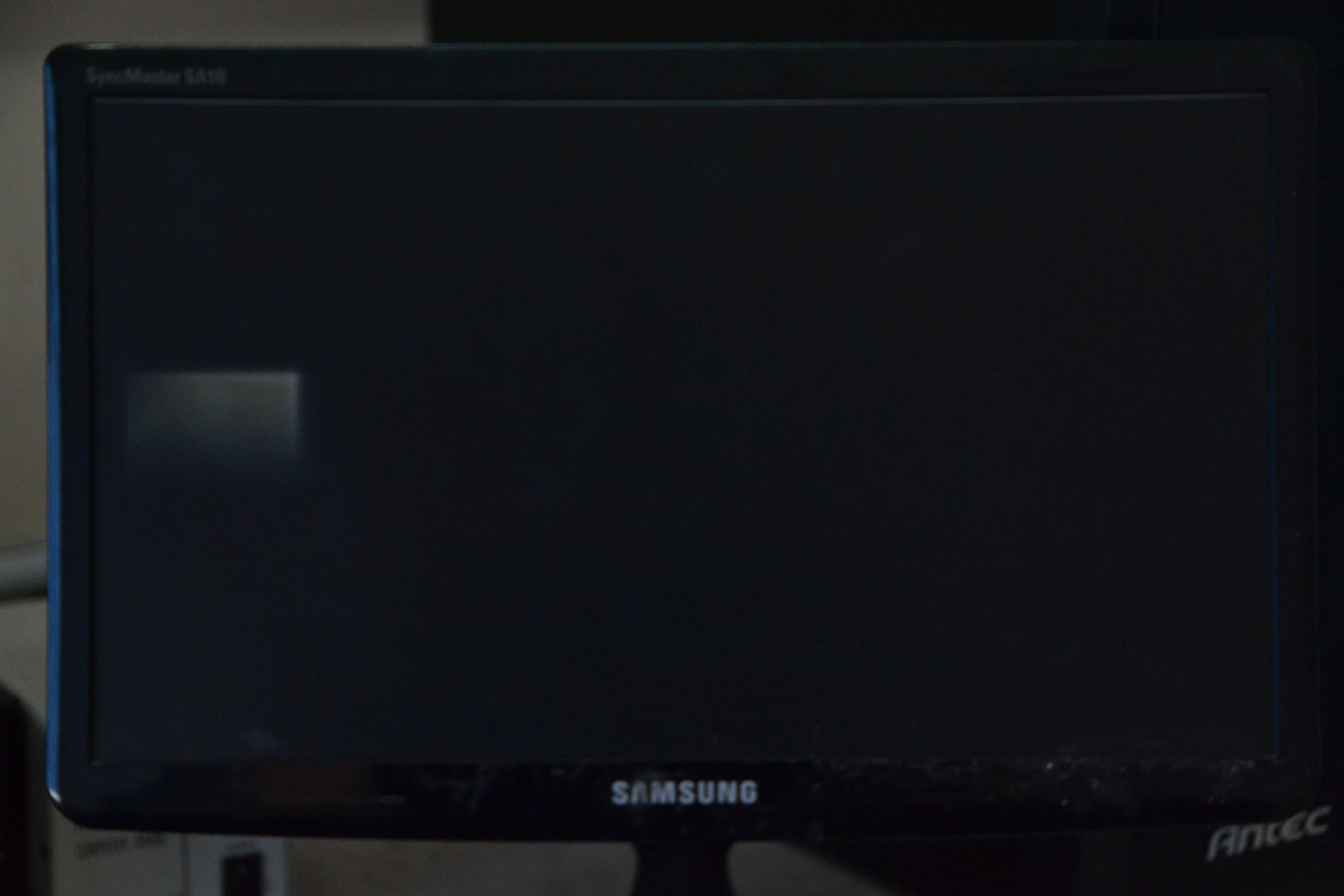

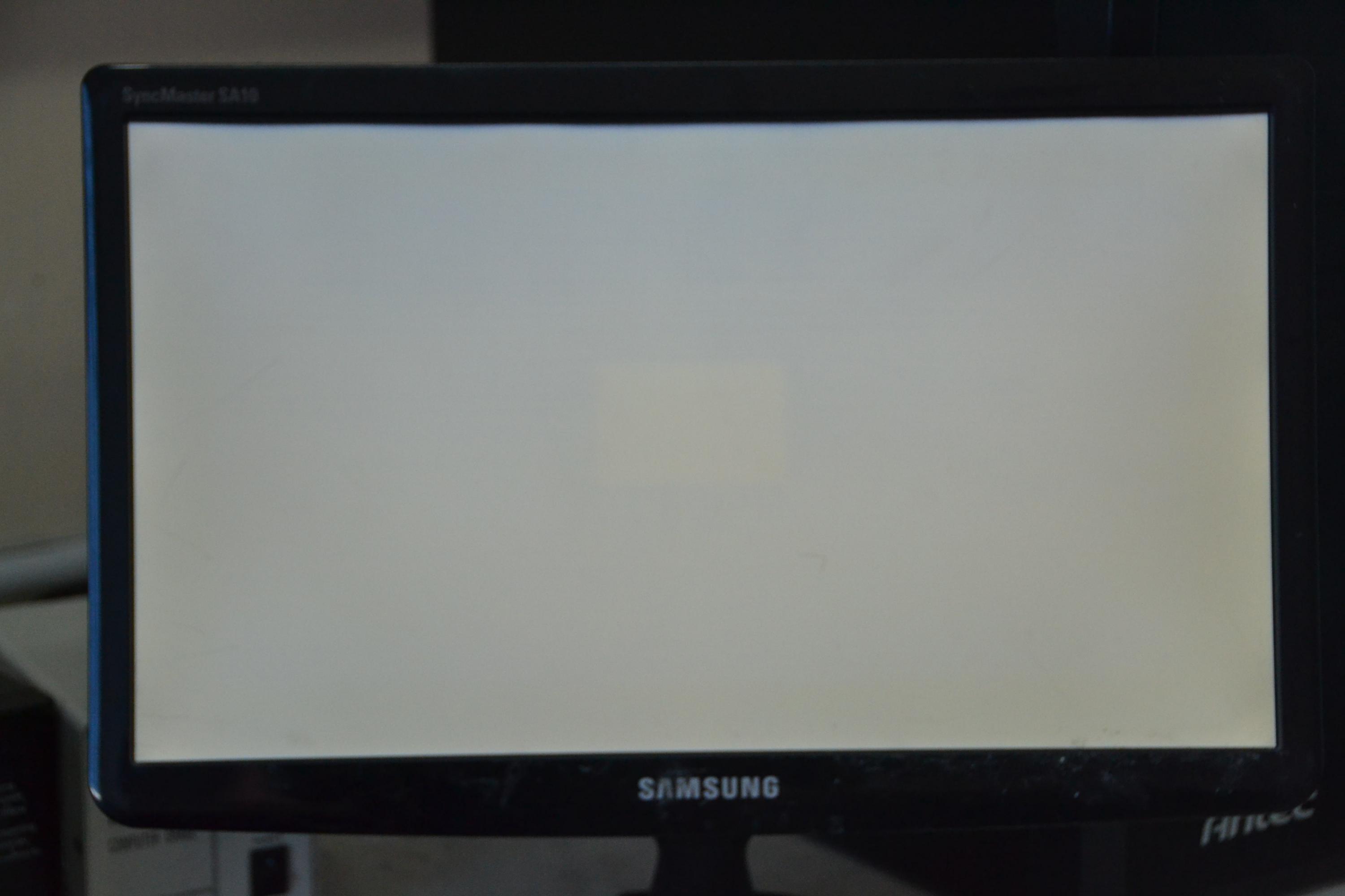

SAMSUNG SyncMaster SA10 Display Problem
  • comptech83
    • Apr 2013
    • 18
    • phillippines

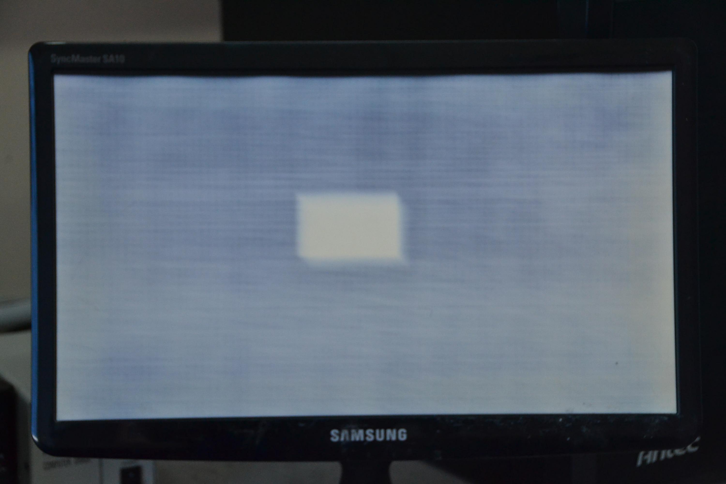

    good morning need help pls...

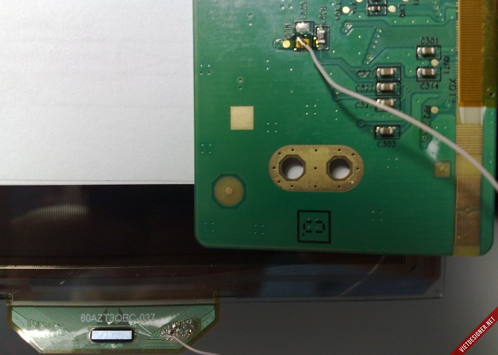

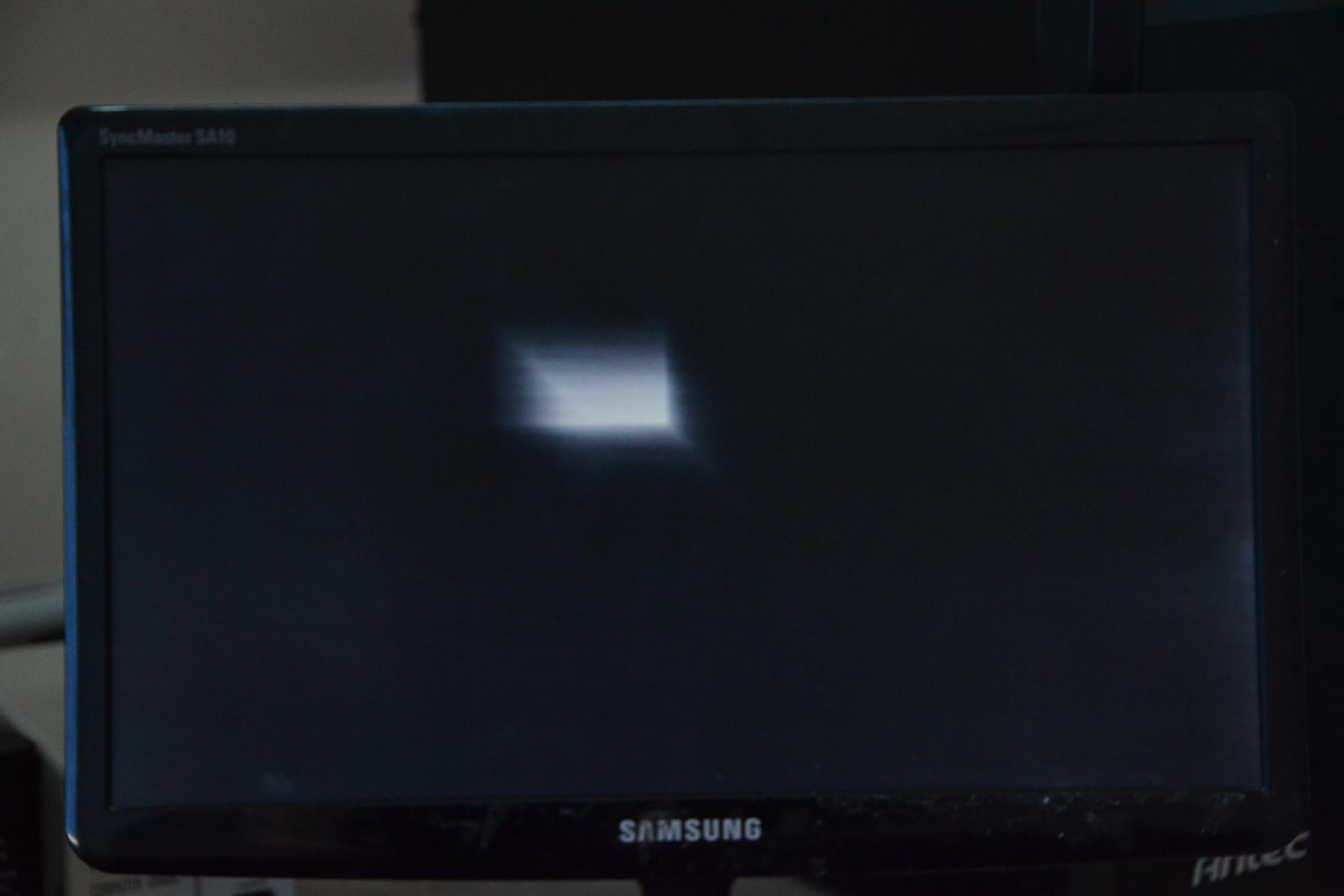

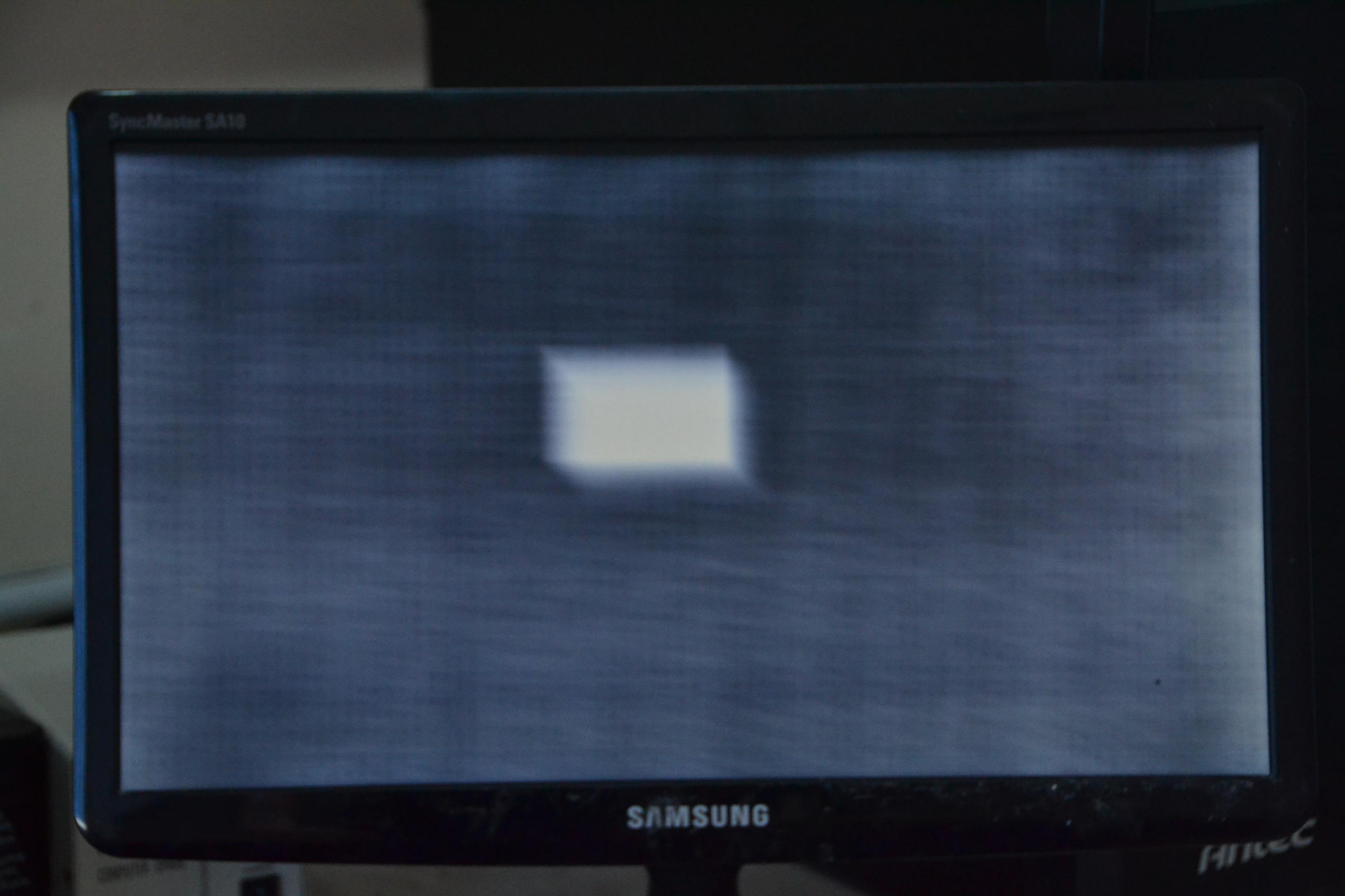

    Re: SAMSUNG SyncMaster SA10 Display Problem
    error share
    LCD Samsung SA10 received photo delay, logo is blurred
      This looks like a T-CON Bd problem. I noticed a wire connection on the picture PHUC posted, that looks like a fix for broken T-CON signal path. This is called 'bypass' method repair to restore signal to the screen.
        Thanks i tried it
