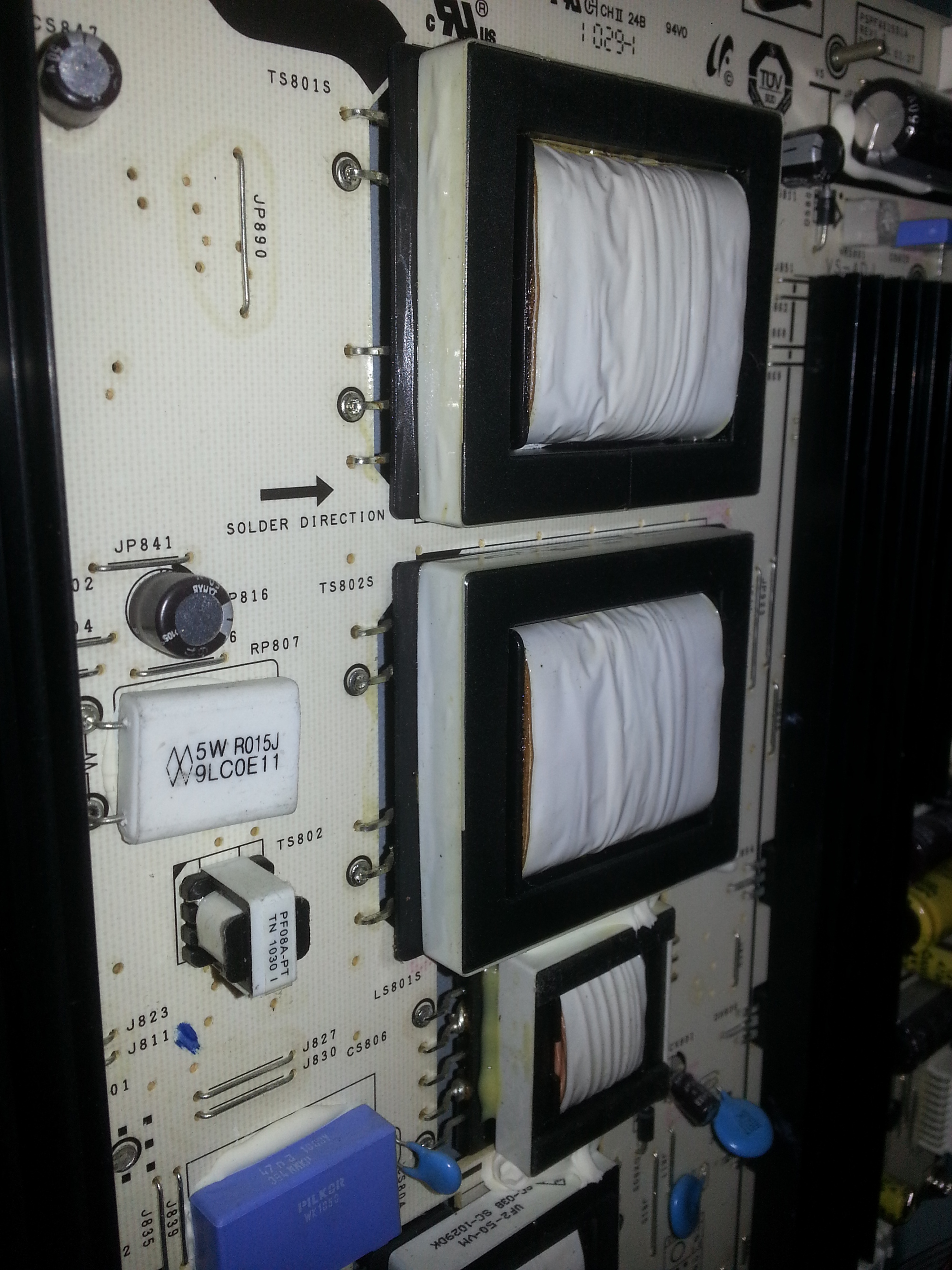

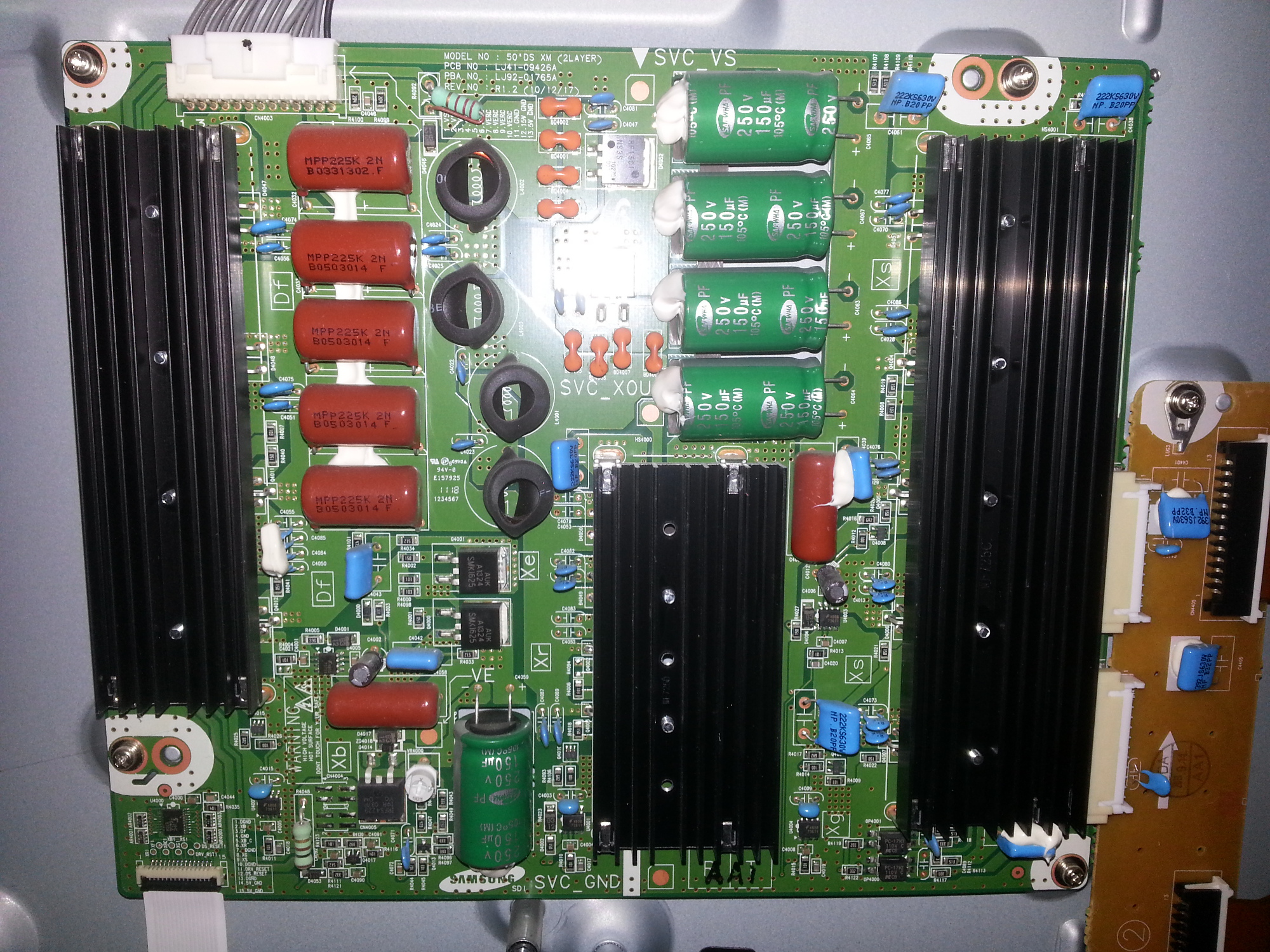

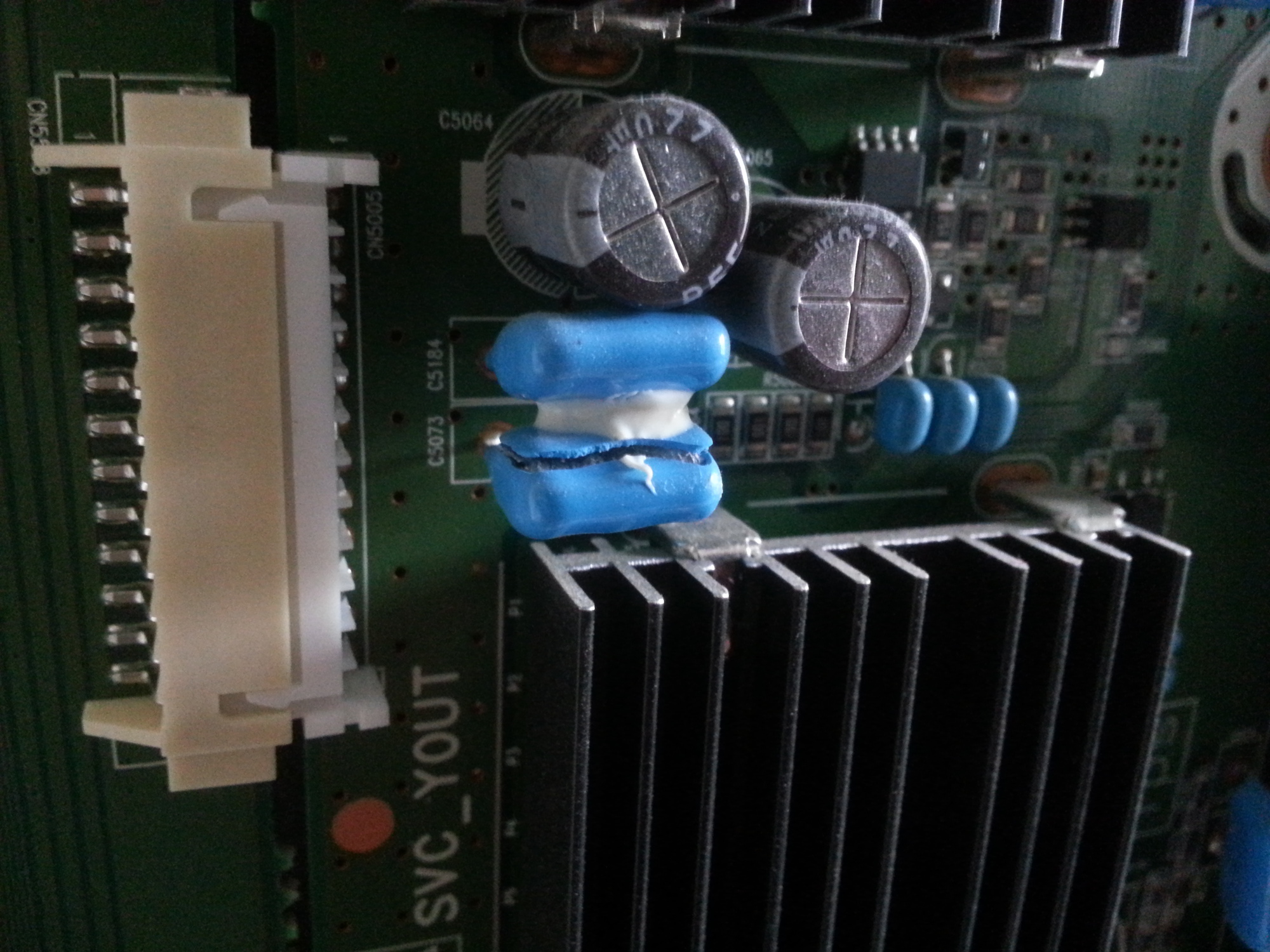

I took the back panel off and looked everything over and didn't find any bulging capacitors or burn marks. The only thing I found that looks damaged is the casing on a bright blue component on the Y-sustain board has almost completely cracked off on one side where it is glued to the adjacent component. Could this be the source of the "pop" sound?

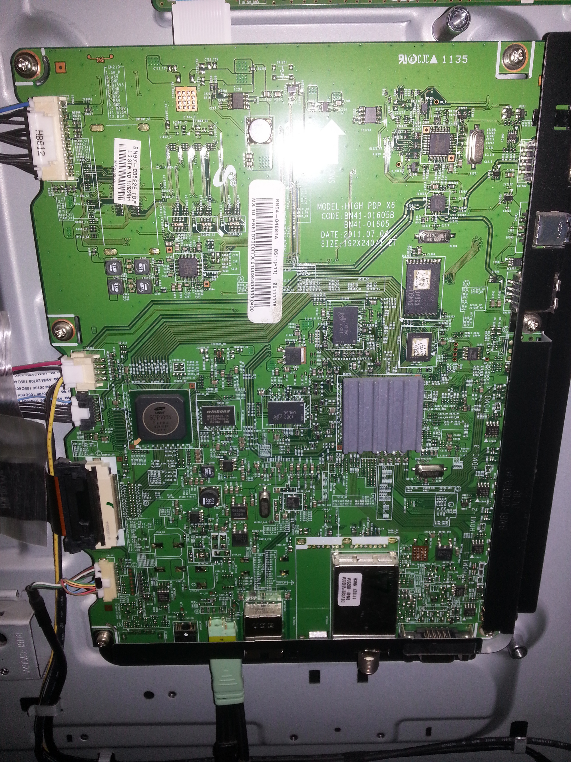

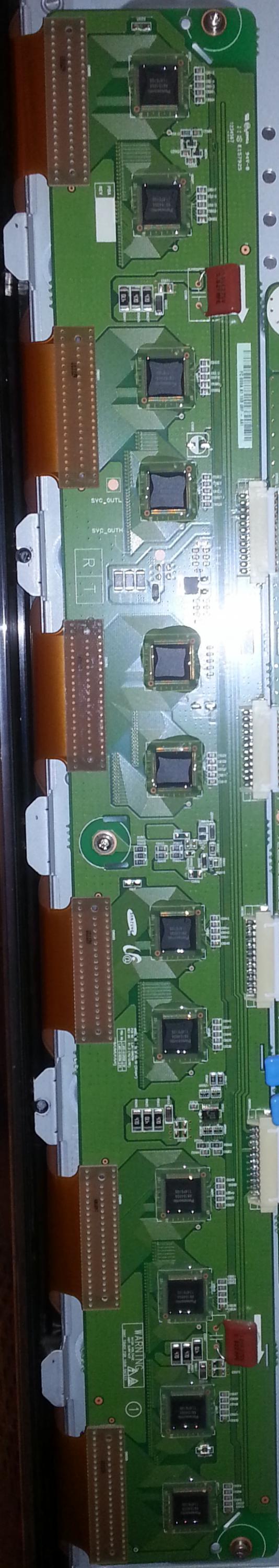

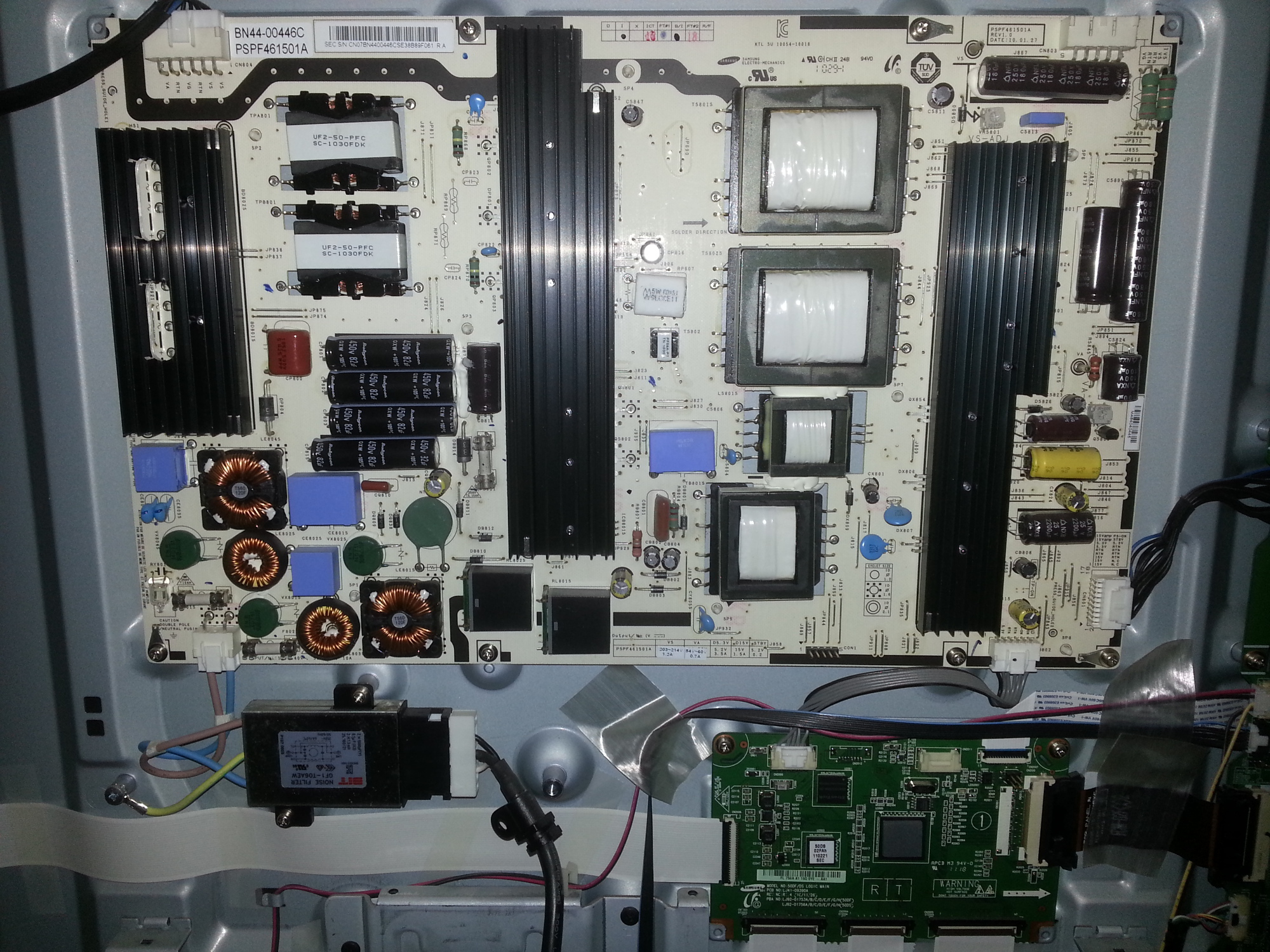

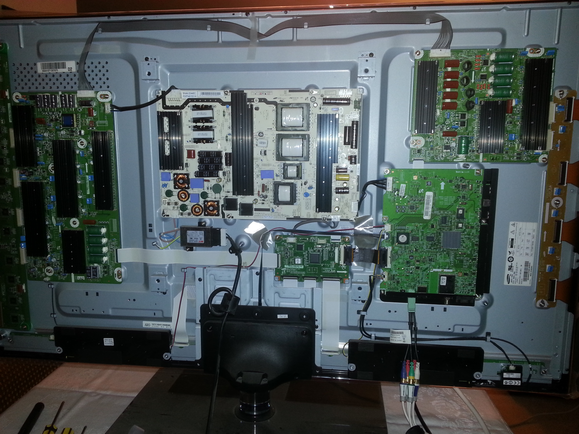

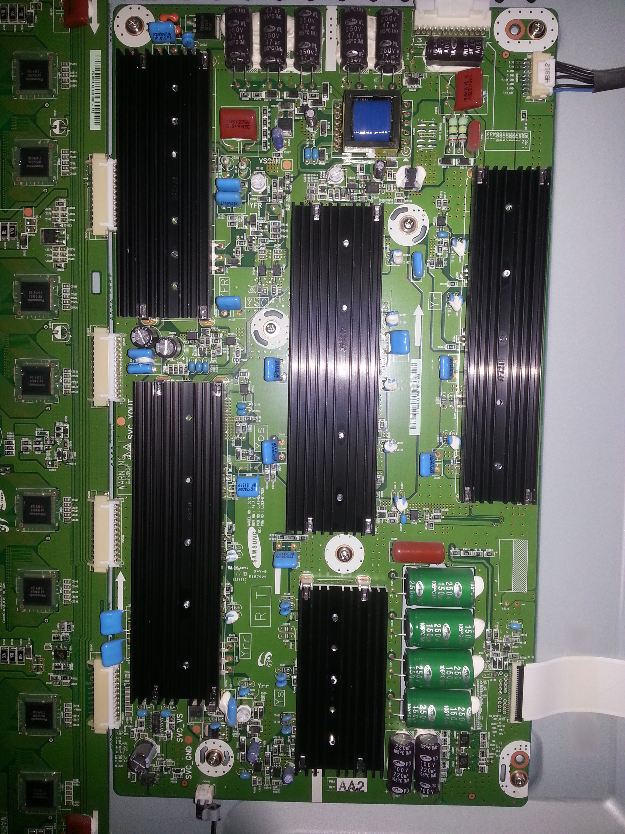

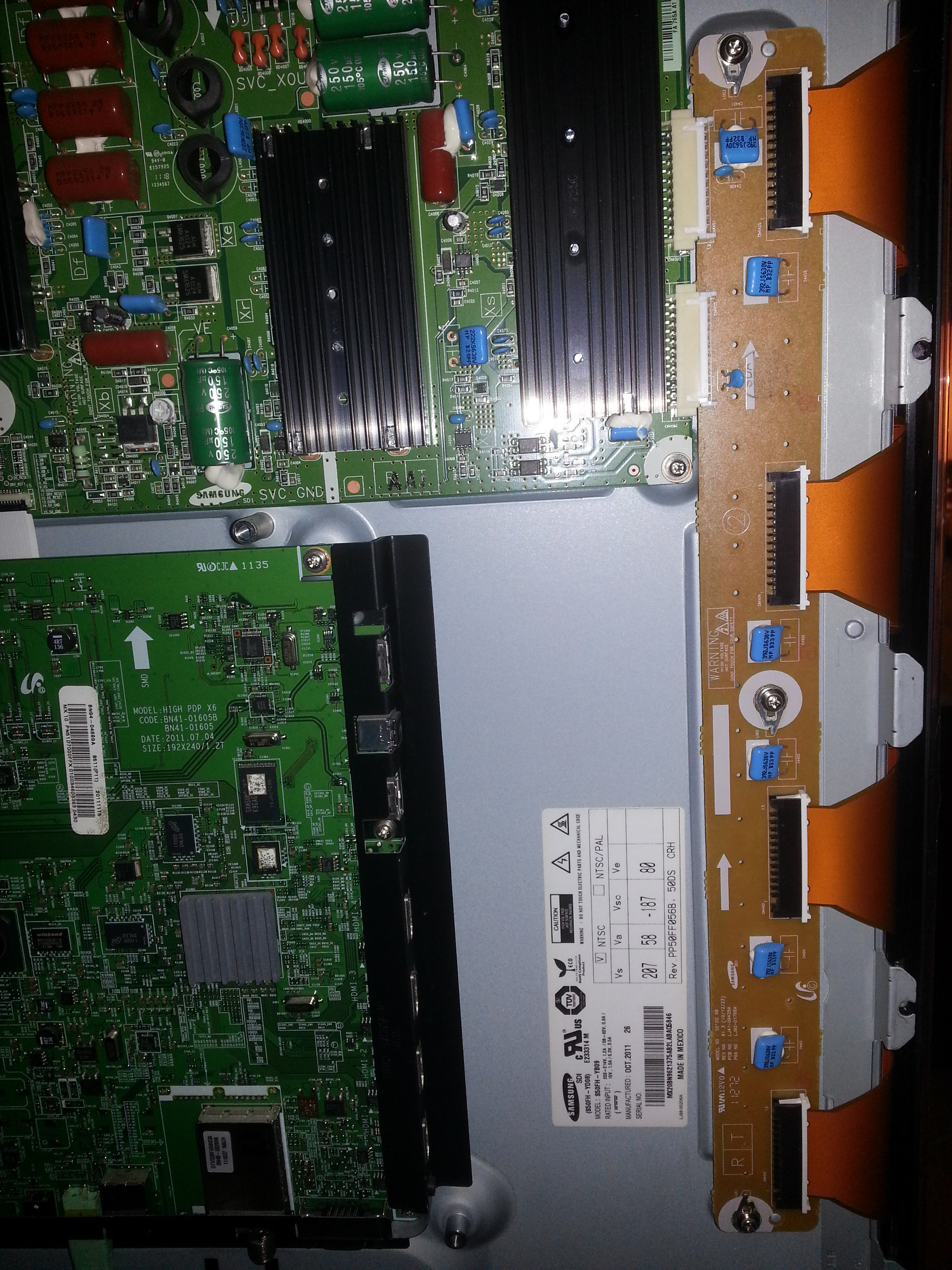

- When I plug the TV in it "clicks" on (the same "click" as, when the TV worked properly, when it was already plugged in and I pressed the POWER button) and the red indicator above the bezel buttons flashes 6 times and then stays off.
- A green LED on the logic/main board flashes in the following pattern: 3 seconds on, 1 second off. When the TV was working properly and powered on, I think this LED was always on (I could see it through the grille on the back panel), but I never paid enough attention to it to say for sure.
- The display never turns on. There is no Samsung logo, no "Searching for input" screen, and pushing the MENU button does nothing.
- The audio does work. With an input source connected and playing, after plugging the TV in the audio starts by itself; that is, without having to press the POWER button first.
- The red indicator above the bezel buttons flickers in response to buttons being pushed on the remote, just like it always did. The VOLUME UP/DOWN, MUTE, and SOURCE buttons all work.
- If I push the POWER button the audio stops but the TV does not "click" off. If I push the POWER button again, the audio does not resume. If I push any button (including POWER) the red indicator above the bezel buttons still flickers in response.
- Only when I unplug the TV does it "click" off.
