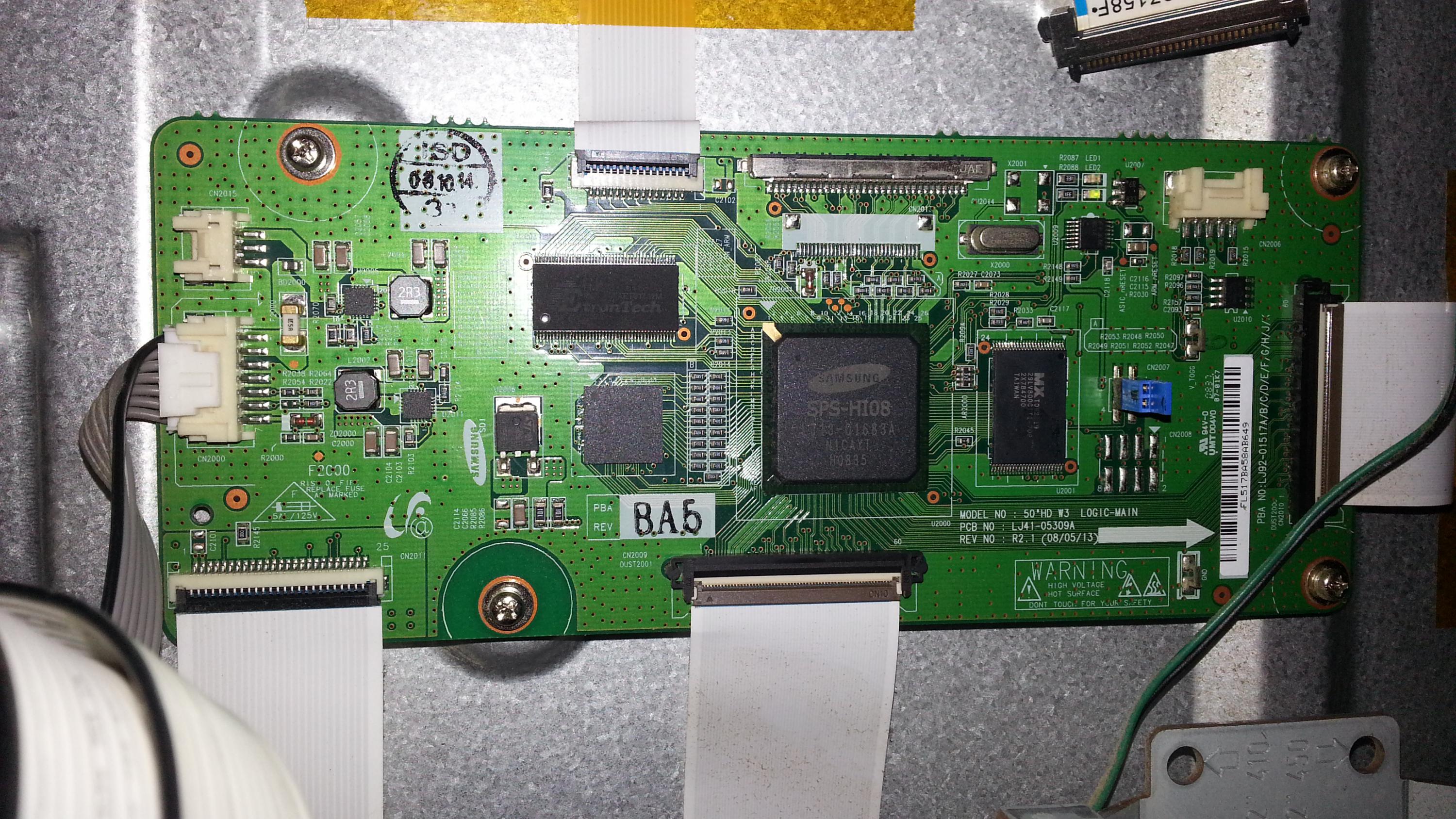

    All the Vs, Va, Ve, and Vsc voltages are correct via the test points on the boards. I've found the service manual for my TV (and I can attach it if requested), and went through all the troubleshooting steps listed in there (flow charts, voltages, etc). An internet search for Samsung plasma troubleshooting led me to the following video: https://www.youtube.com/watch?v=JjrwTZC5nVg

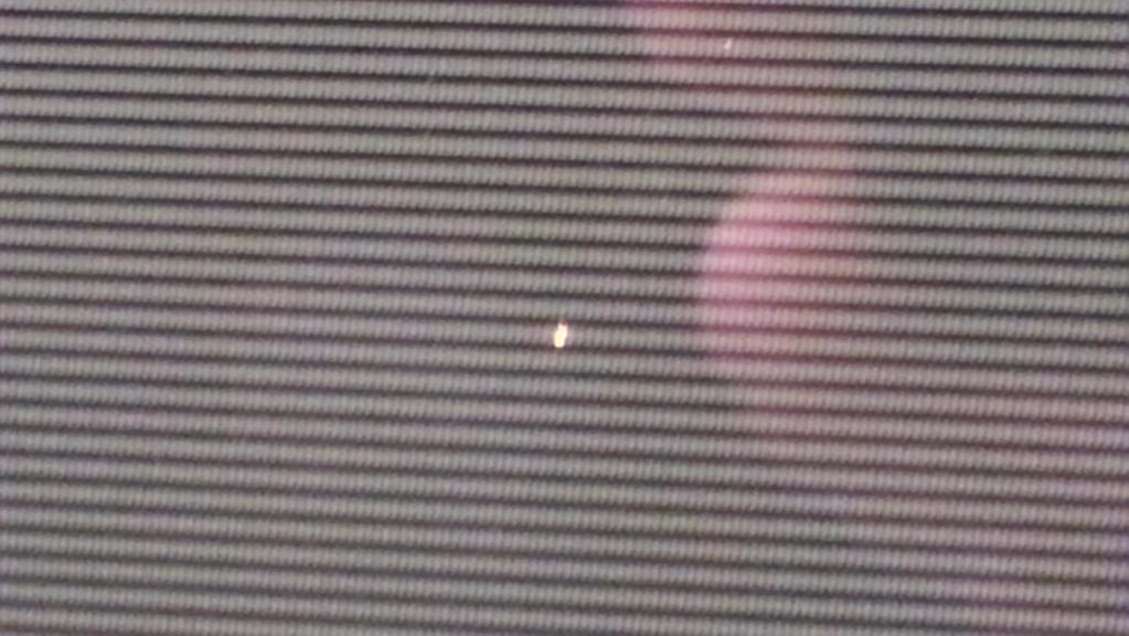

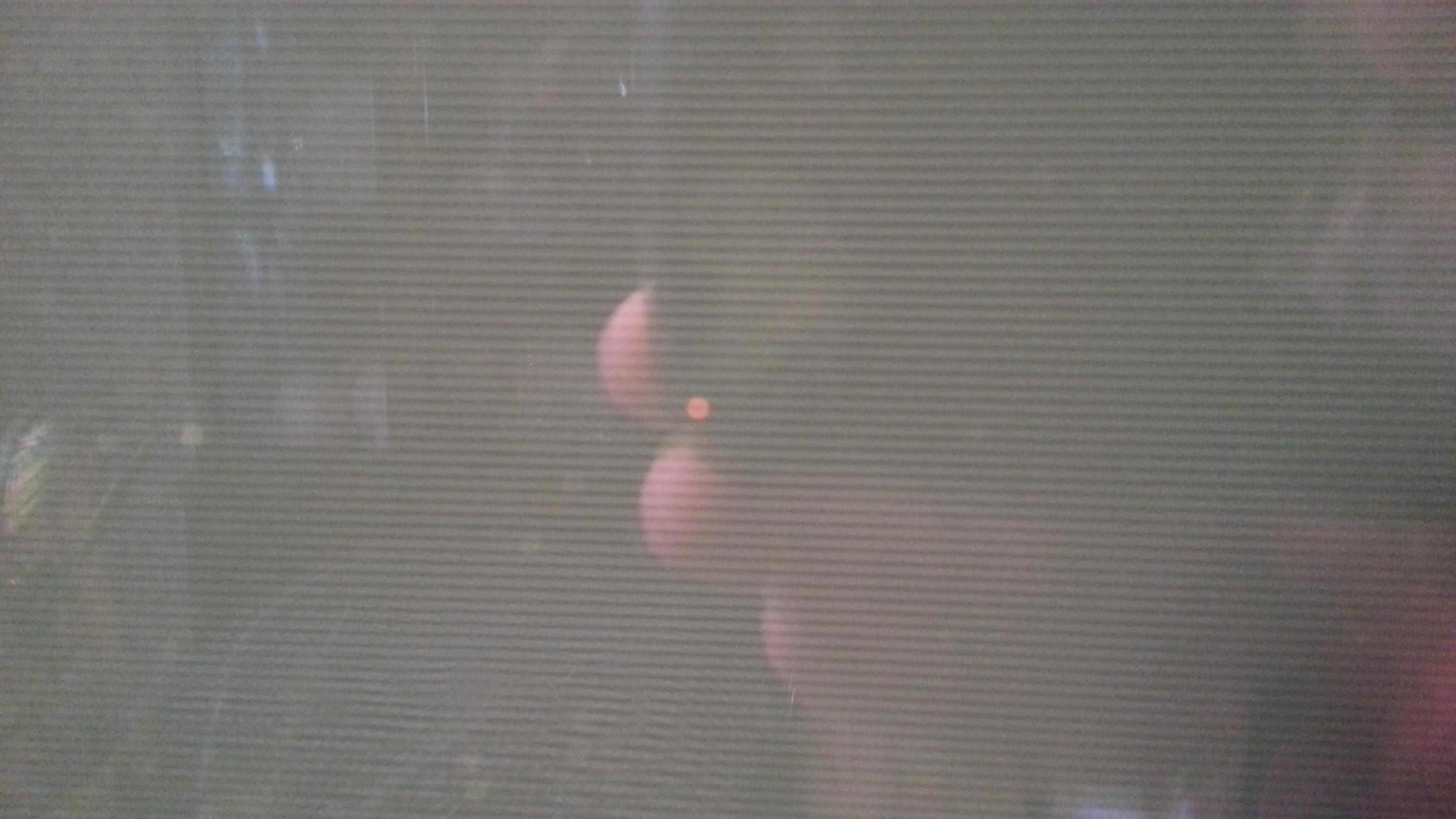

    Test patterns never showed. The only thing I could get to show on the TV was a blinking red pixel when I connected a tablet via HDMI. Picture is bad, but I tried multiple times
    All the fuses, even the soldered ones, test good. No bulging capacitors are present. On the logic board, the LED blinks about once every second (which I'm led to believe means the Xmain, and Ymain are good), so I'm thoroughly lost on this TV. I've also tried to scan for shorted buffer chips on Ymain (it's the Ysus and Ybuffer I think), by doing diode short test with ground, and all 6 buffers, both sides. No beeps. LED 2 is blinking on the logic board, but LED 1 is not.

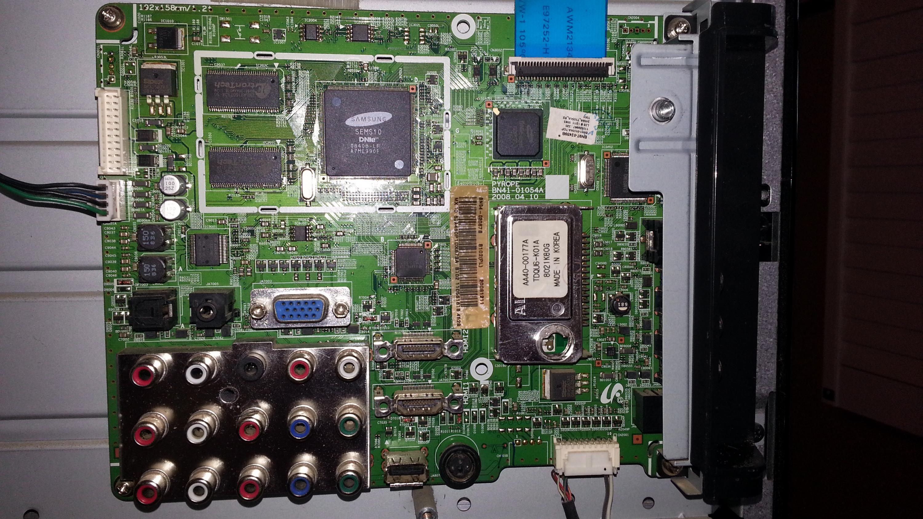

    Re: Samsung PN50A450P1D Plasma - Audio No Video
    Apologies, I missed a few pictures to upload. Here are the rest. And a quick note on this TV. To get the test patterns, you not only have to short PS_ON and ground, but also VS_ON and Standby 5V. Then short pins 3 and 4 on the test jig.
      So are you able to get test patterns?
        Test patterns never show other than that blinking LED. TV looks like it's off other than that.
          This image here looks like a faulty control board.
          • snowman0269
            • Oct 2015
            • 29

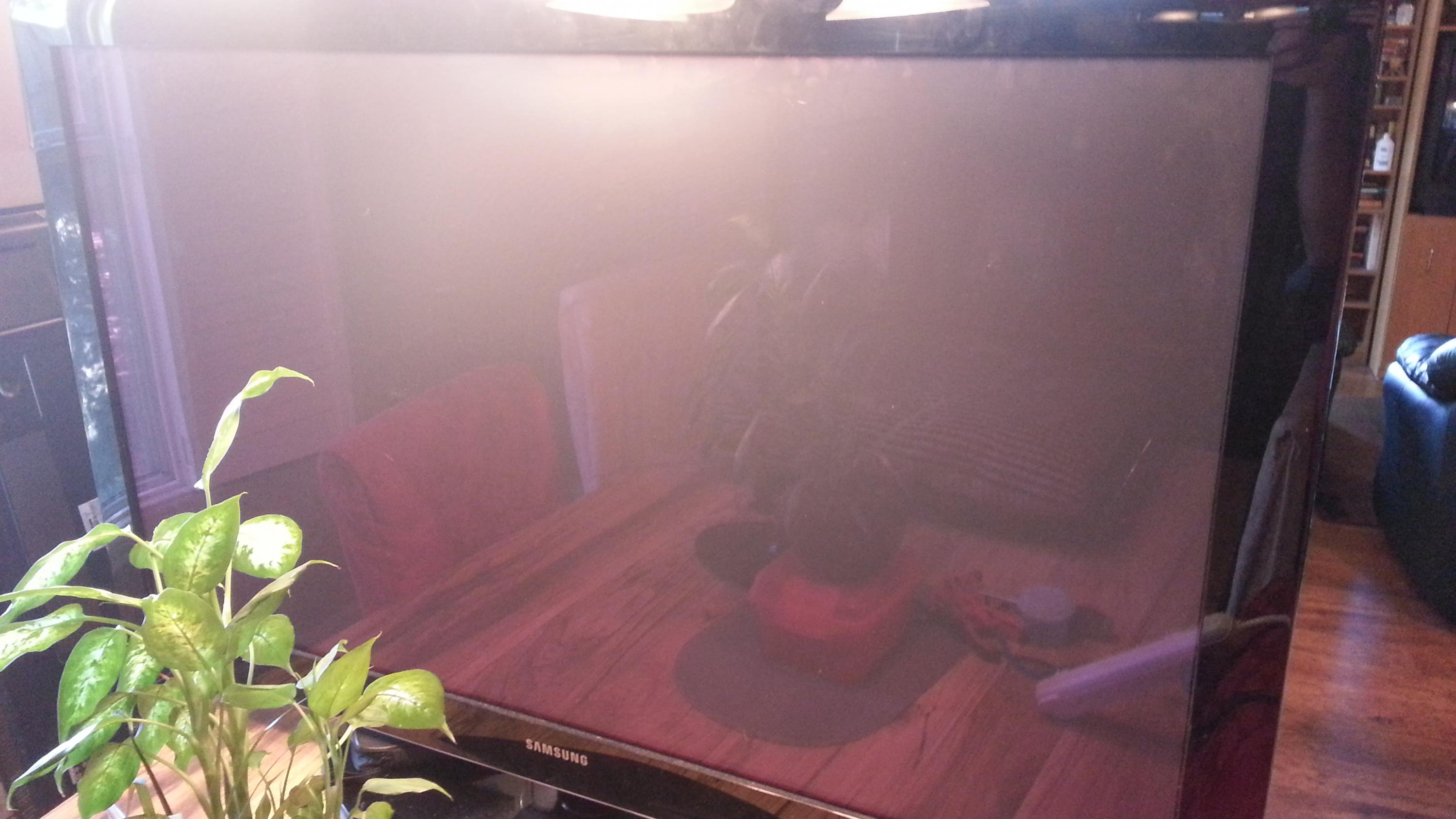

            That's the picture of the LED on the front of the TV. Is the control board the logic board? Or am I calling it wrong?
            • Hamie
              • Apr 2014
              • 1383
              Yes control board = logic board.

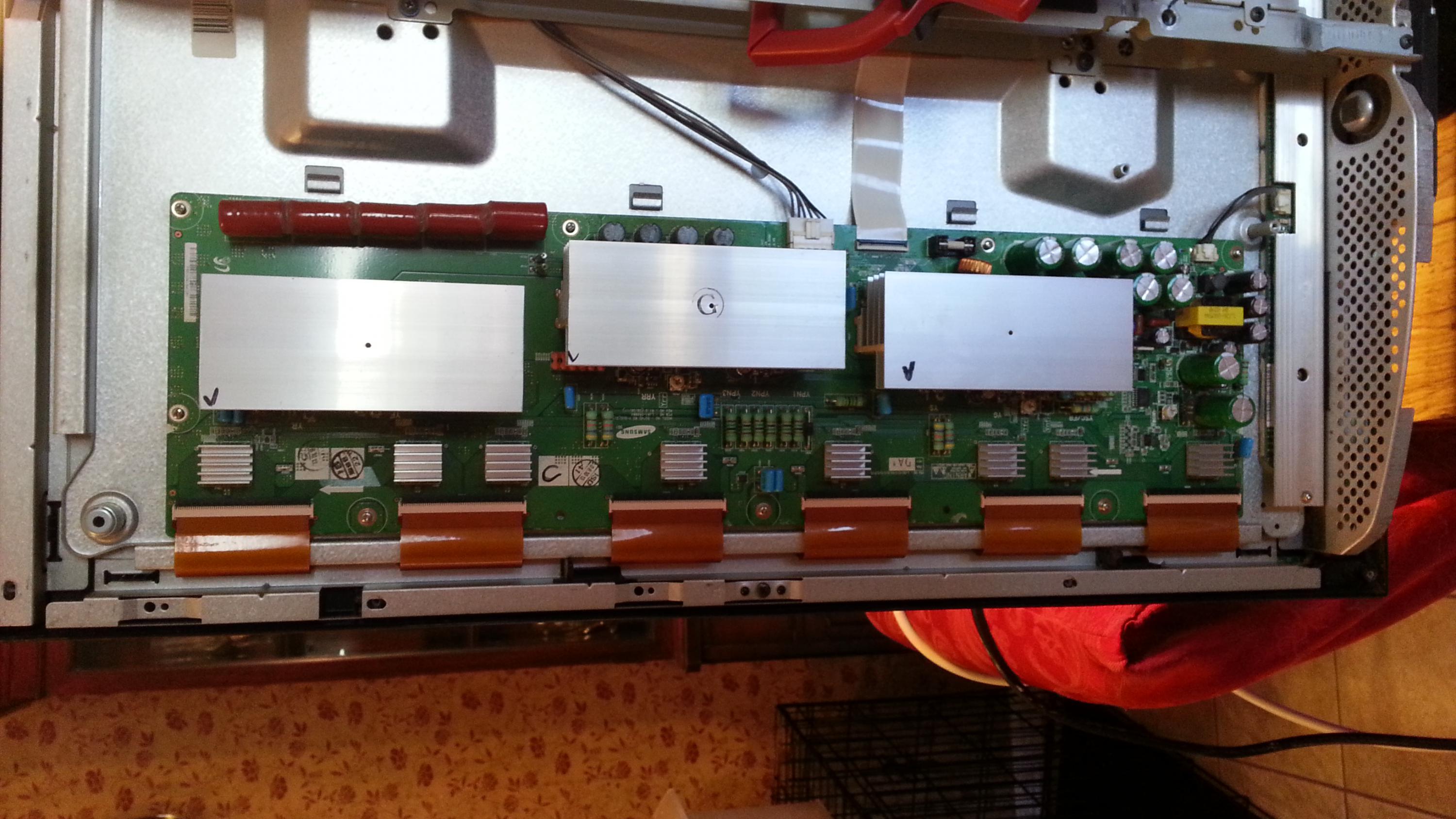

              Can you find vsch test point on the y-sus?
              • snowman0269
                • Oct 2015
                • 29
                The point I tested on the y-sus was labeled "VSCAN." Is that the correct one?
                • Hamie
                  • Apr 2014
                  • 1383
                  Yeah from your earlier post you said vscan was accurate.
                  But is there a vsch? Your picture of the y-sus isn't great.

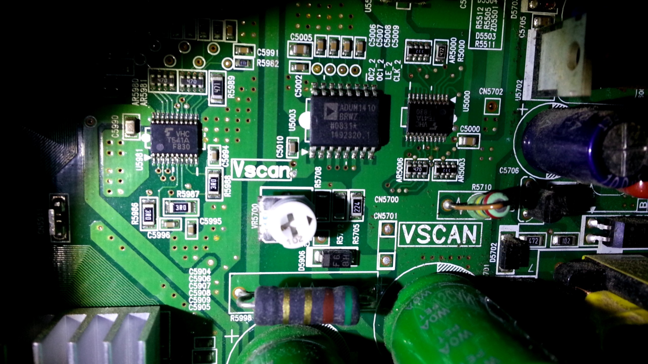

                  • snowman0269
                    • Oct 2015
                    • 29
                    Mine looks almost exactly like the one in this ebay listing. The VSCAN point wasn't big like the others, however. It just looked like a soldered point, with nothing attached. But still had the correct voltage.

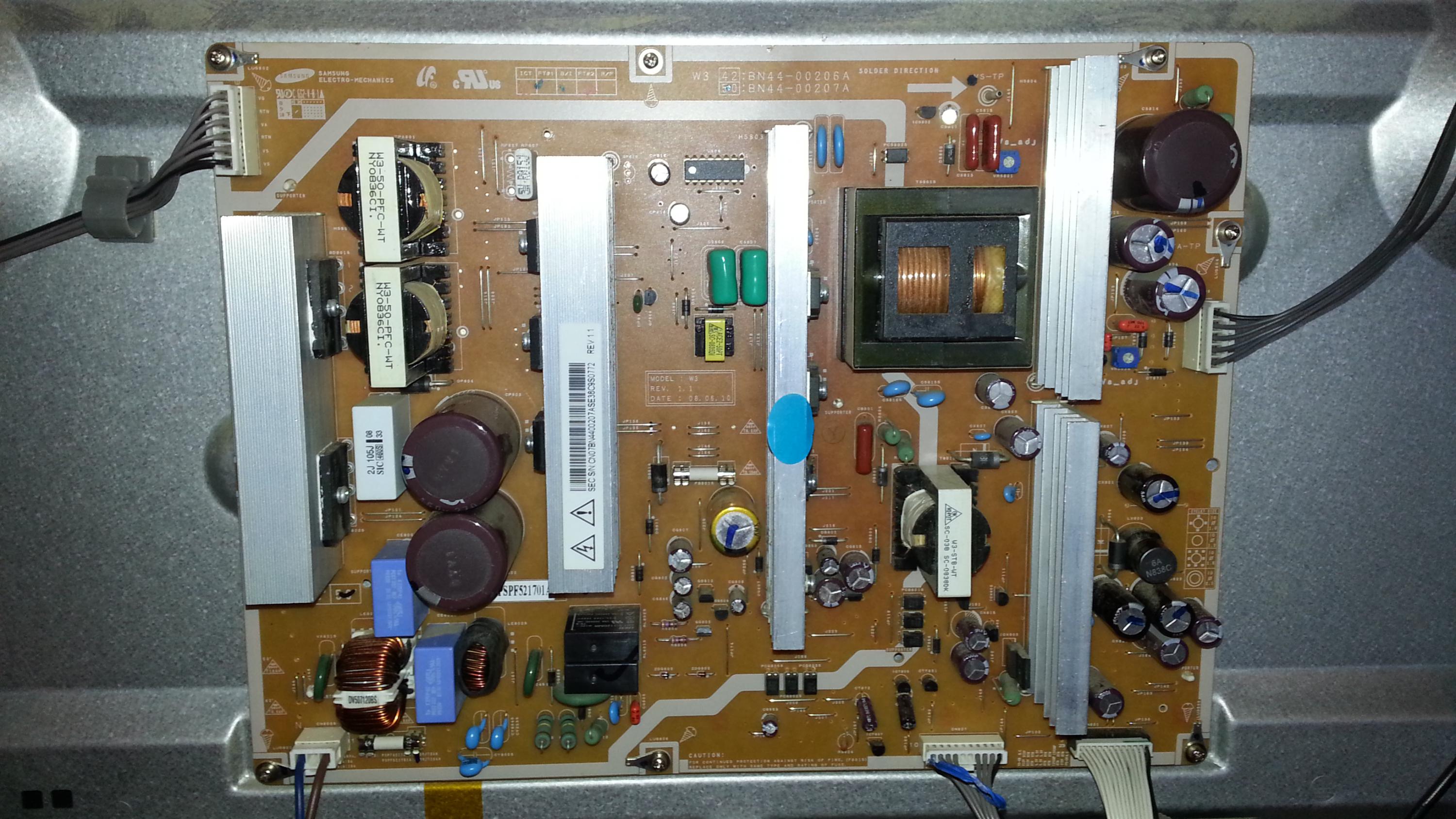

                        Also check your getting VA voltage here.
                        And check each end of this fuse for voltage.
                          No vsch, but vscan had two more test points. One reading -45 to -50 and the other reading 5.2. What side of my picture is that picture you posted? By the way, love your Heisenberg. Did you draw that?

                            Oh, I see where it is. Which of those two cables puts out VA?
                            • snowman0269
                              • Oct 2015
                              • 29
                              Fuse is good, VA voltage (56V) is good here too.
                                Ok well those vscan voltages are out.
                                Can you post a picture of where you're measuring them?
                                    The capital letters VSCAN, the top one gave me the -195, the bottom one gave me the -45 to -50. The "Vscan" gave me the 5.2. And these points are between the big green caps and the heatsink on the right side of my Ymain board picture.
                                    • Hamie
                                      • Apr 2014
                                      • 1383
                                      The small Vscan is just to mark the potentiometer.
                                      Your VSCAN is fine.

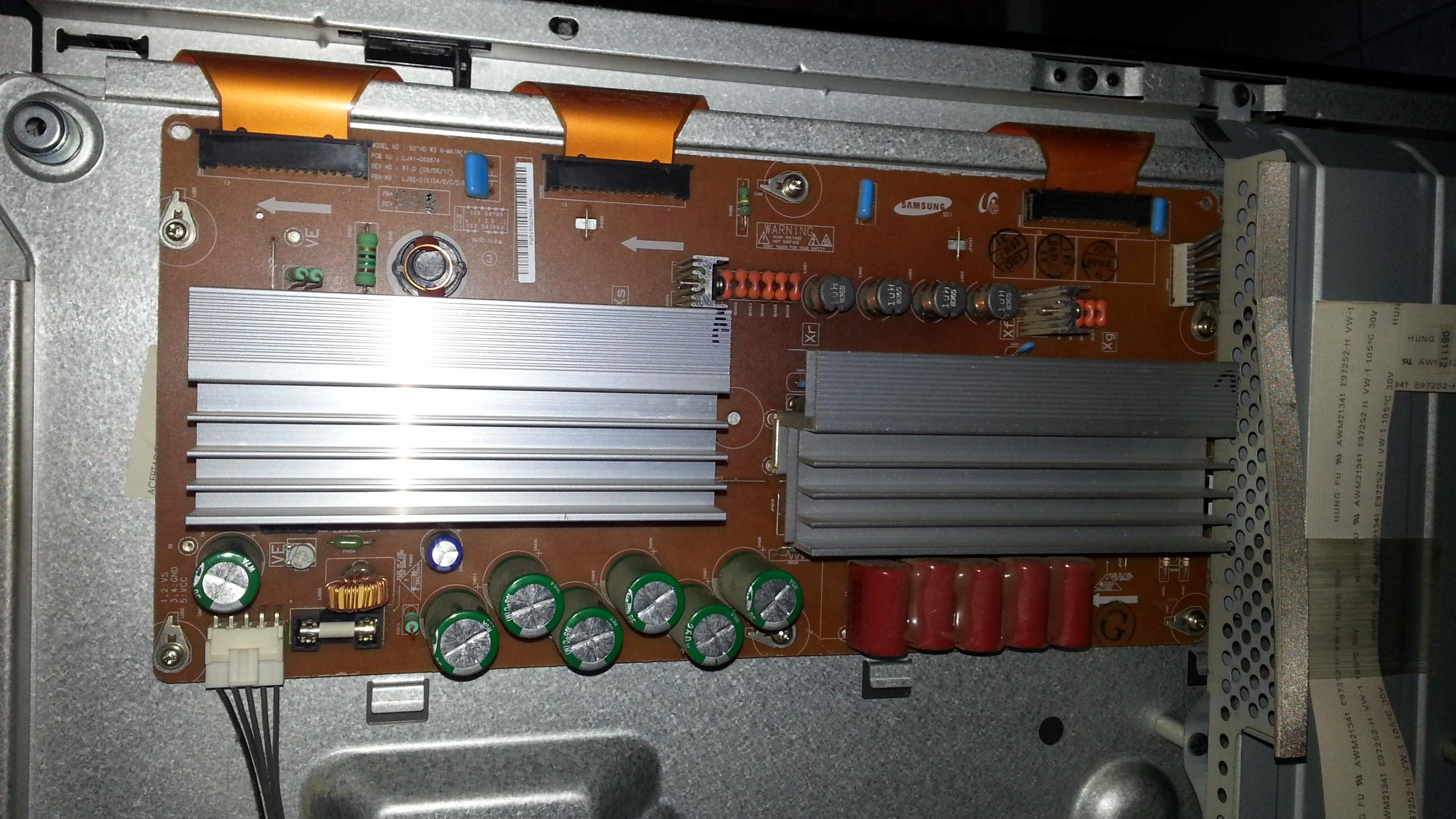

                                      If you unplug the zsus do you an image.
                                      (Zsus = Xmain)
                                      • snowman0269
                                        • Oct 2015
                                        • 29
                                        Is Zsus the one with the VE voltage? It's on the opposite side of the TV.
