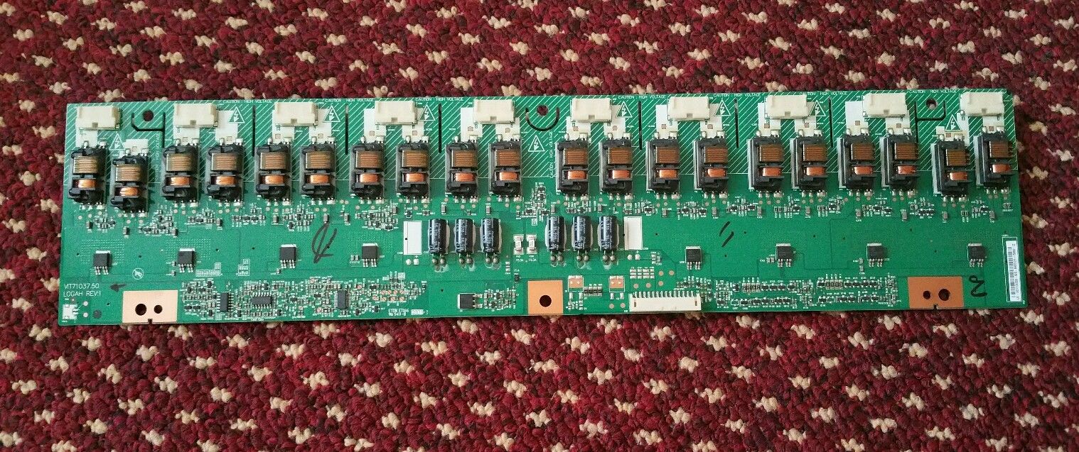

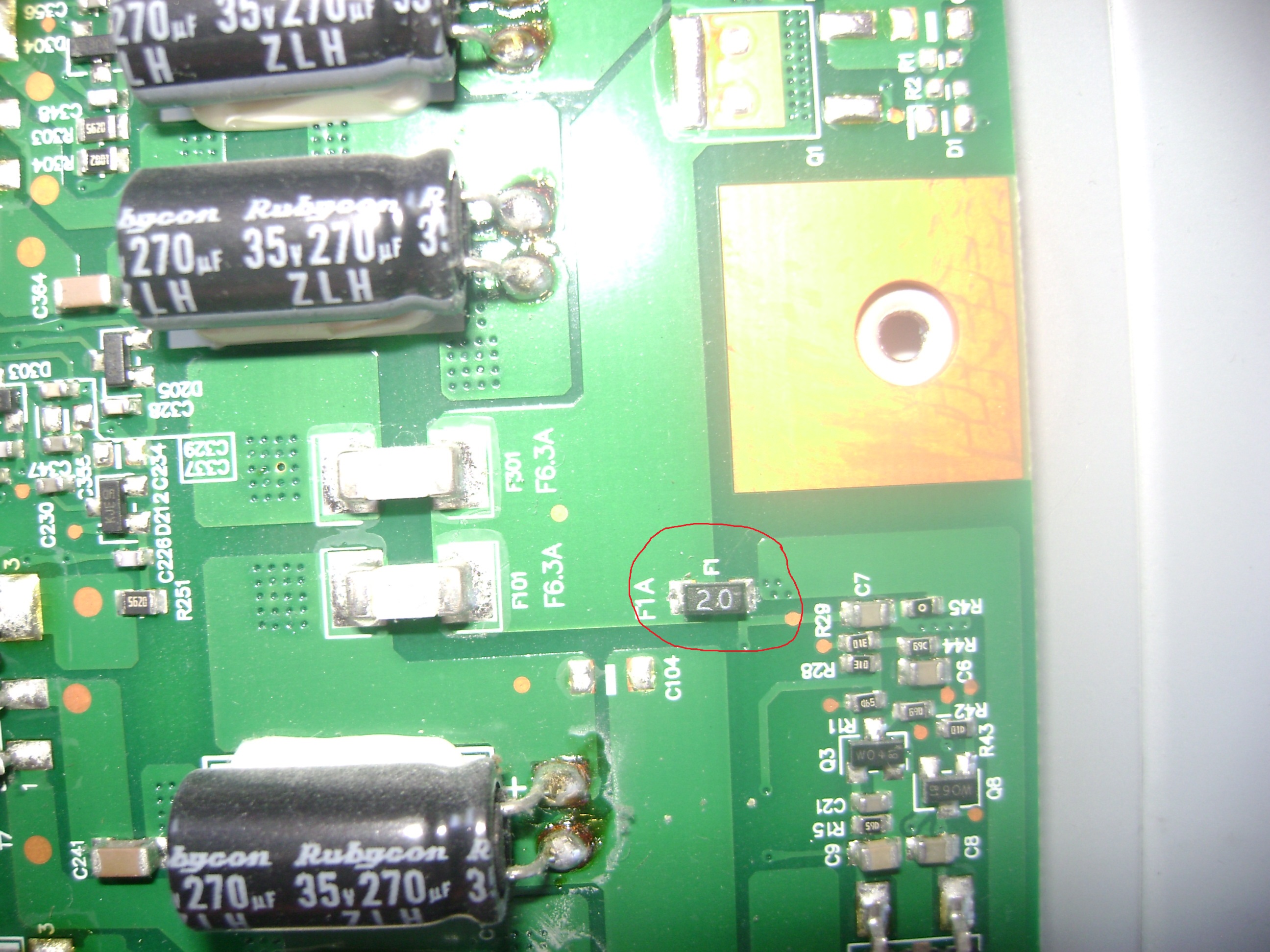

    my friend was watchin this tv yesterday & picture went sound stayed on i have looked today & with torch u can see picture on inverter board f1 fuse has blown can some1 tell me wat 20 means im presumin size ? not sure tho
    & voltage i need is 1amp correct?
    thnx for your help

    Re: samsung le37a656a1f inverter fuse
    pic of full board is in middle fuse im needin
      From what i am seeing, I will say a 2.0a smd fuse
          You could probably connect everything back and do a voltage test.....but I would guess a 35V 2A fuse will work.
            The fuse is marked F1A which is fast blow 1A, the voltage rating needs to be higher than 24V. (Anything higher will do.)
                Might want to buy a few extra fuses, just in case something is actually shorted on the inverter board.
