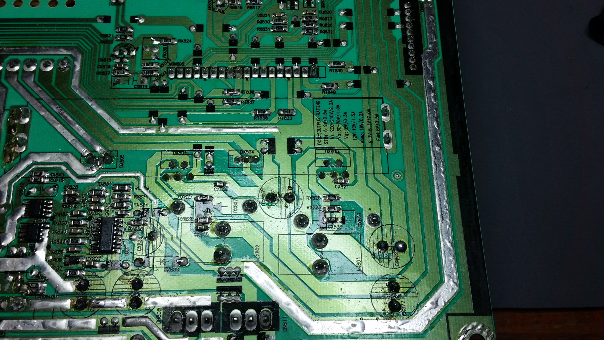

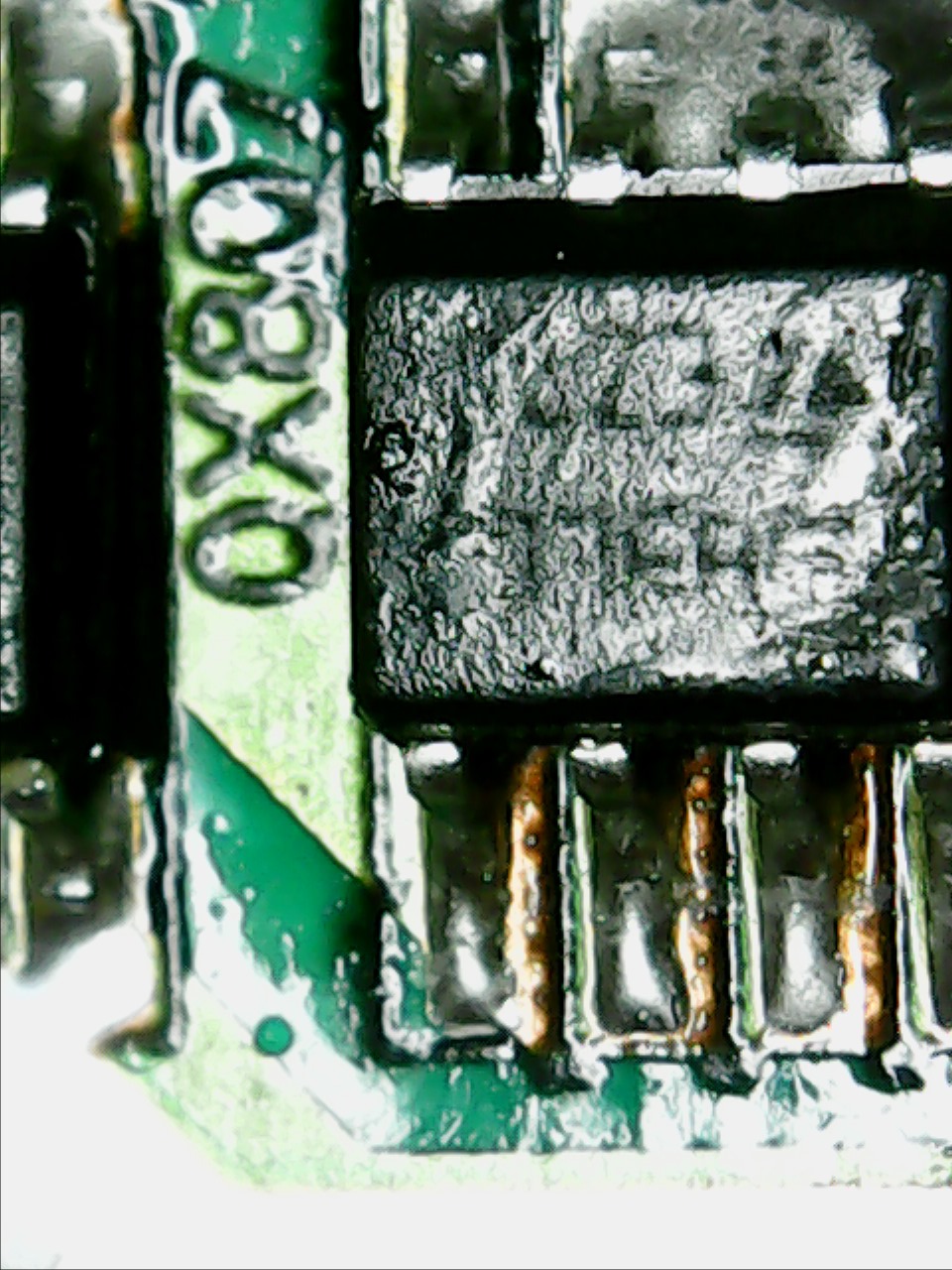

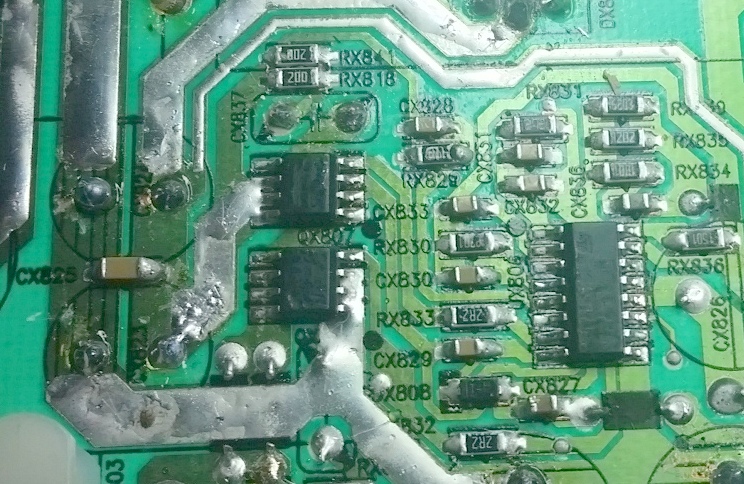

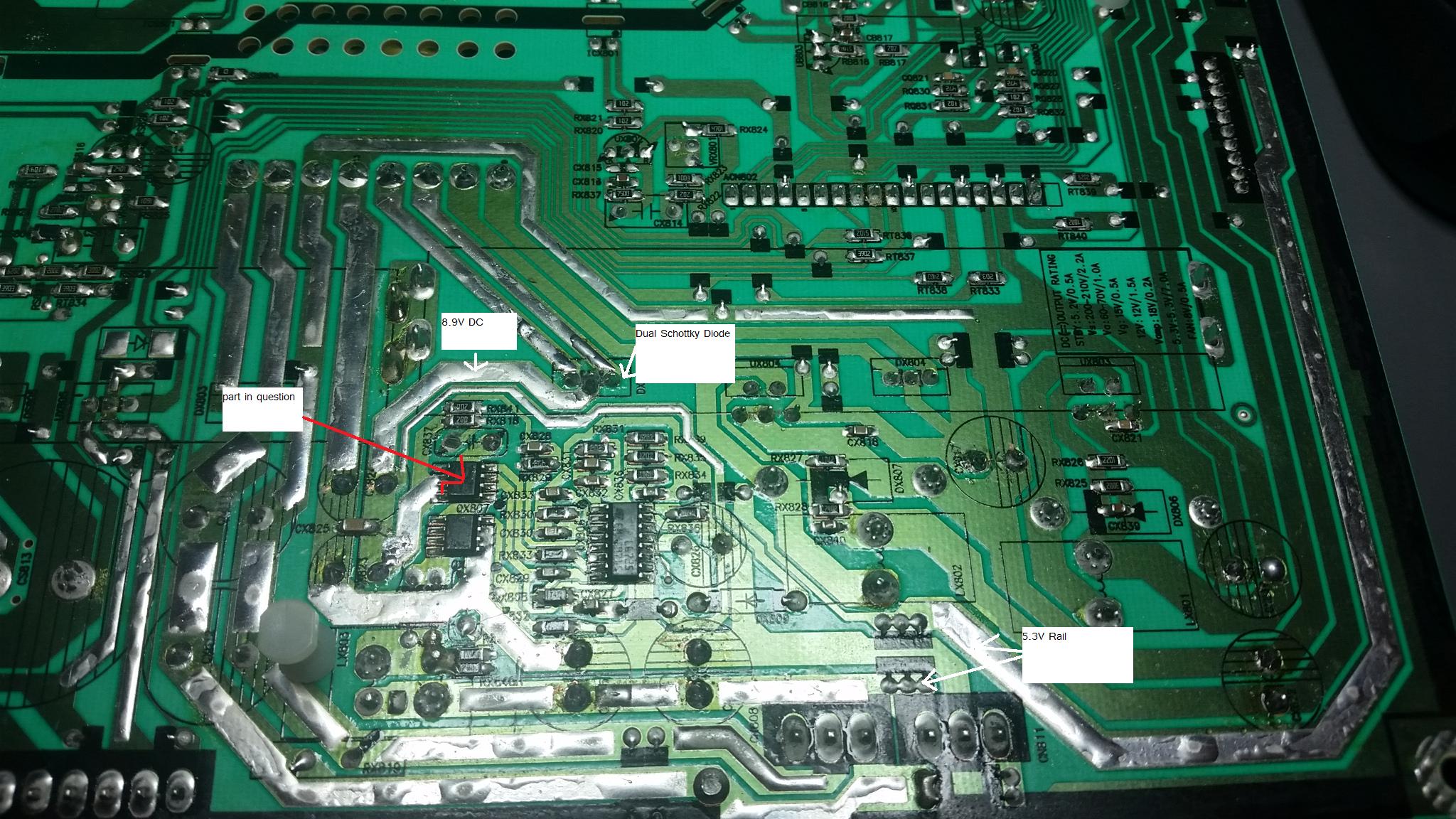

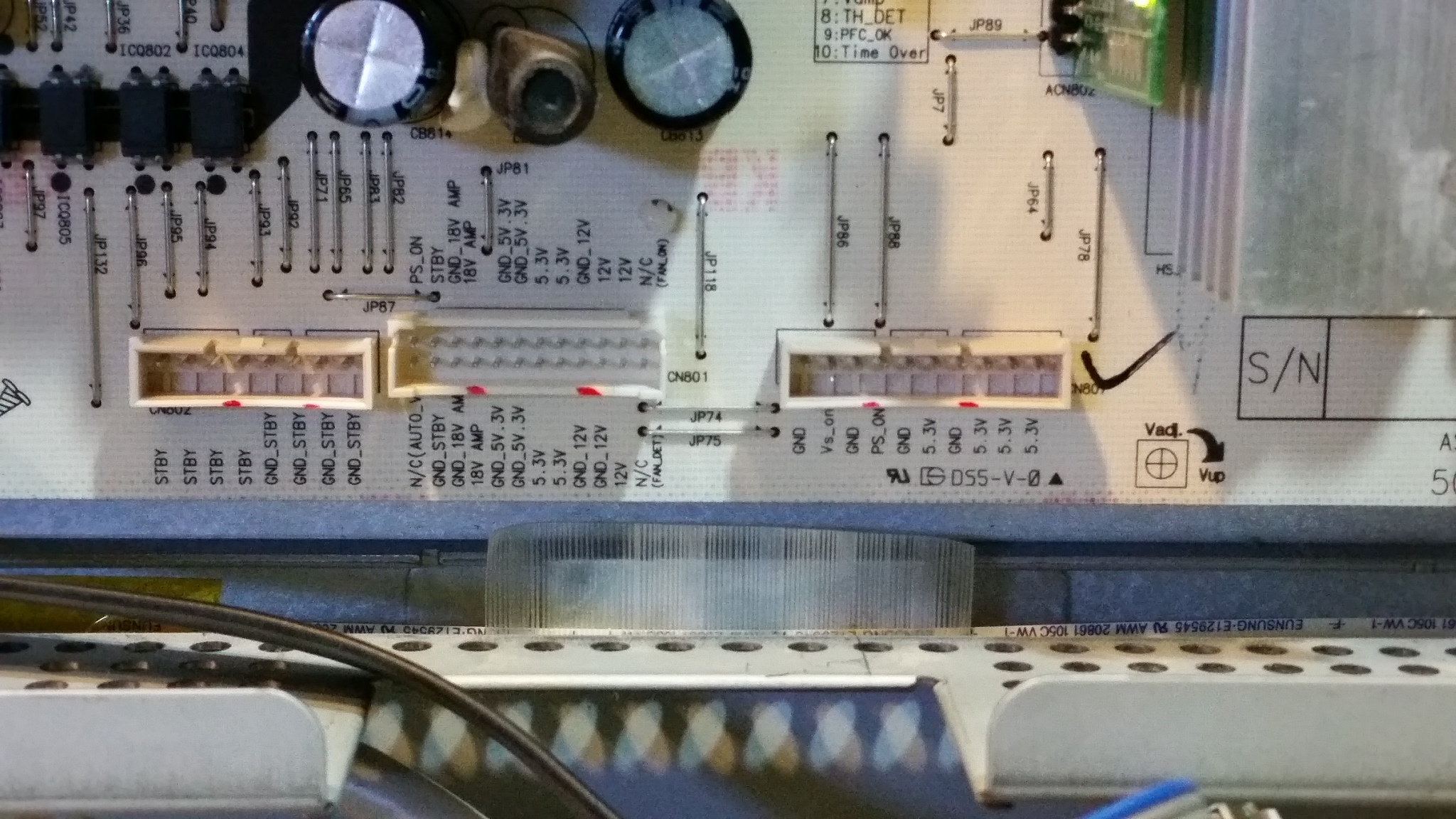

      Attached some new pics. I have a small IC that is causing the issue but it appears to have the ID removed.
      If I apply my soldering iron tip to the top of the IC for 5 sec, the 5.3V rail starts normally and the SMPS runs fine (for a while).
      PIC#1 idents the 5.3V rail and the IC in question.
      PIC#2 is a closer shot of the IC.
      Any suggestions on how to proceed or is this a lost cause?

        not 100% but by the way pins 6/7/8 are linked and tied to the - side I would say it would be a KIA393F voltage comparator , try cleaning it up a bit and see if it has A393 on it, these are used a lot on Samsung P/Bs in the detect circuits

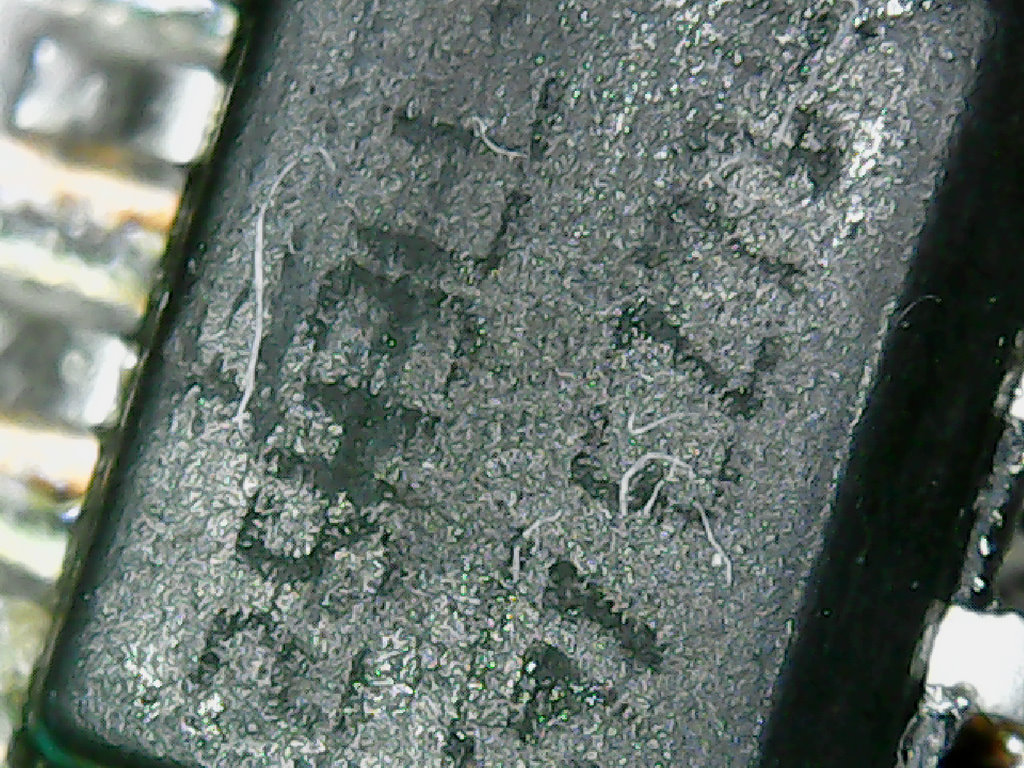

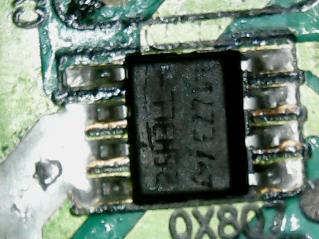

          Tried everything but the surface is rubbed away for some reason.

            It looks more like dried up flux on that IC. I would try a bit of acetone on a Qtip.

              Lookimback was right and upon better cleaning 25H3LL can been seen so they are Power MOSFET for DC/DC conversion.
              I reflowed the ICs and its working again. I am going to order the chips and have them on hand if/when it acts up again.

                    I have the same problem, I have replaced the 25H3LL with a IRF7862 from RS components part number 495-887 , and so far so good
