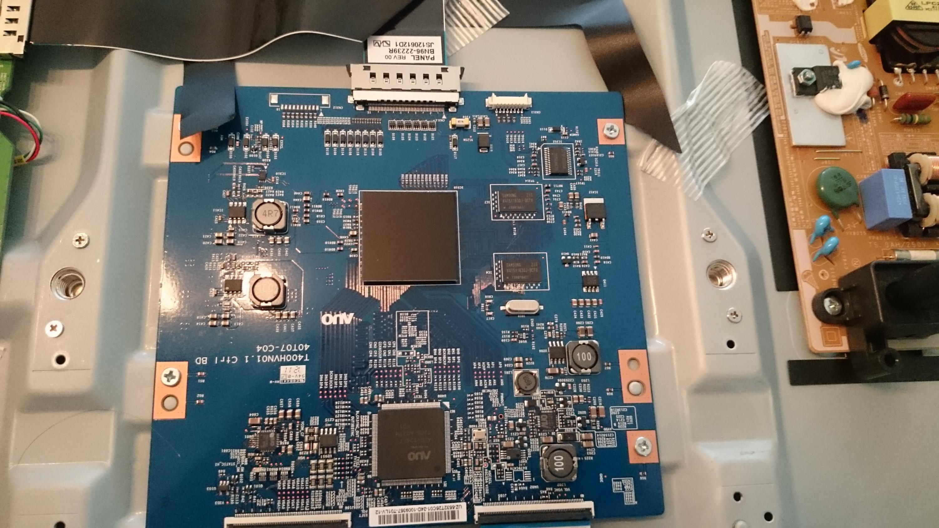

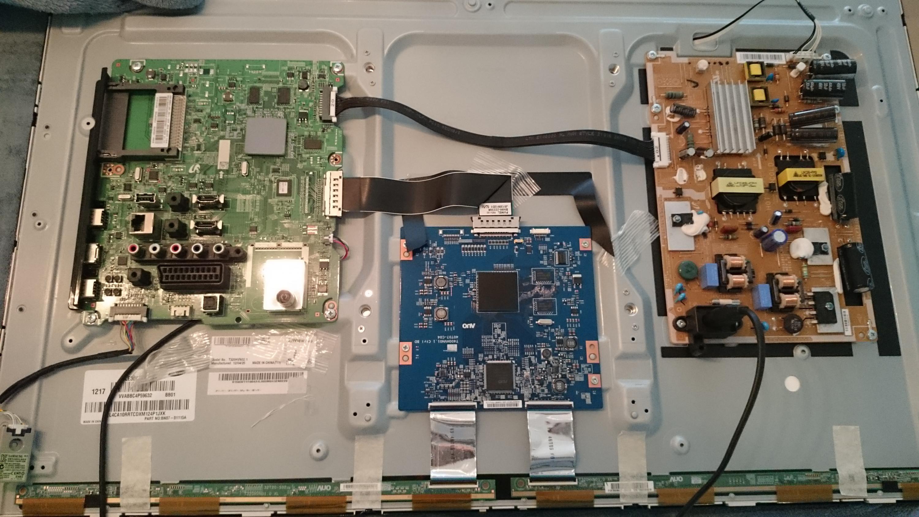

    First symptoms were that the tv would reboot on its own.
    Now it wont turn on anymore and the led double blinks 5 times.
    If i remove the tcon cable from the mainboard and turn on the tv, the backlight blinks 2 times.

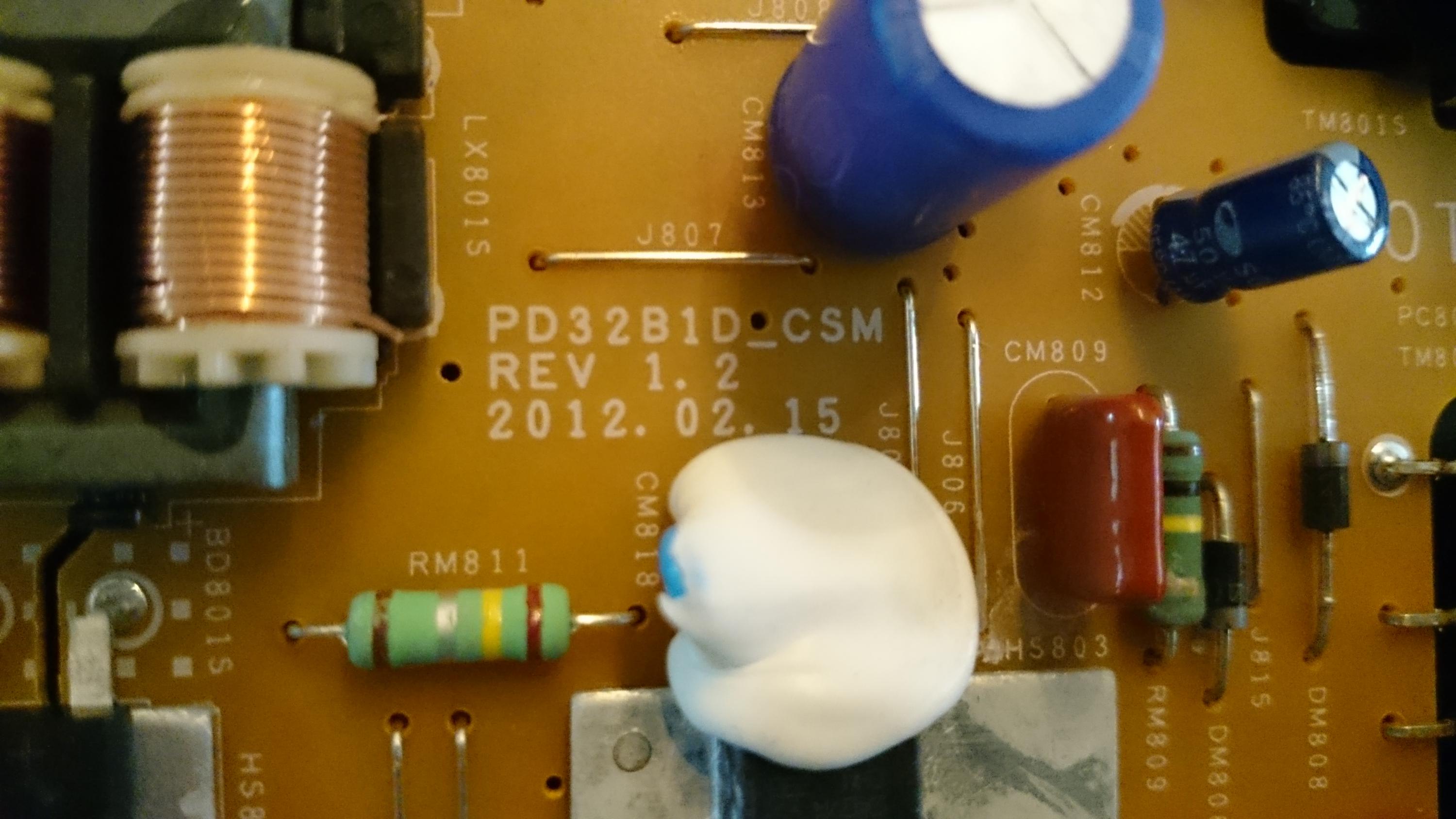

    Caps look fine....
    Service Manual does not say anything about the blinking leds.
    All backlight leds work! Any suggestions?

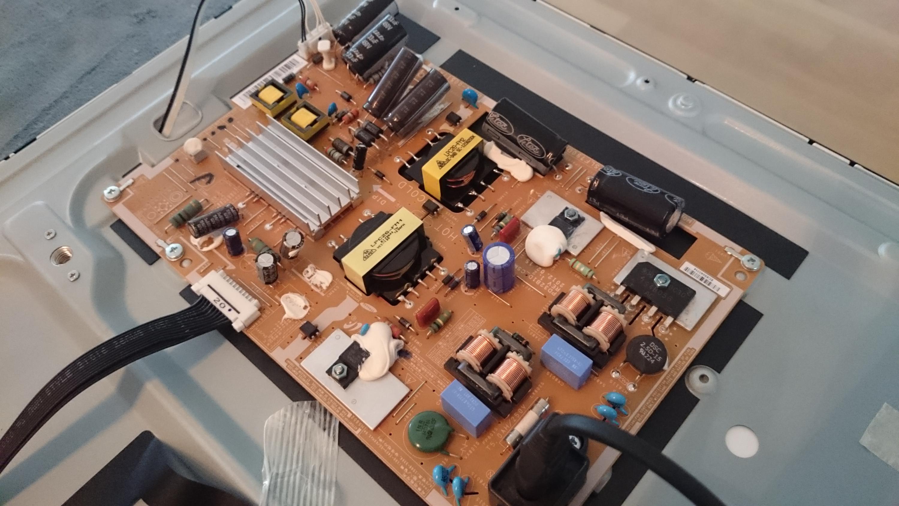

    Unplug the cable from the Power Board going to the Main Board. Plug the set in the ac and see if you are getting 5Vdc StdBy.
      Re: Samsung LED UE32ES6100 ( 5 double blinks )
      Im getting 5v stand-by
      Also reading 12v on connector going to mainboard and getting 45v on backlight connector.

        I would say you have a Main Board problem. BTW when you disconnected the main Board from the Power Board and plugged in to the AC, did the backlights come on?
          Thx for the reply!
          No with the mainboard disconnected it just stays "dead". No backlight.

              There are some checks you may need to do before buying the Main Board. Like are you getting PS-ON and BL-ON signals from the Main Board.
