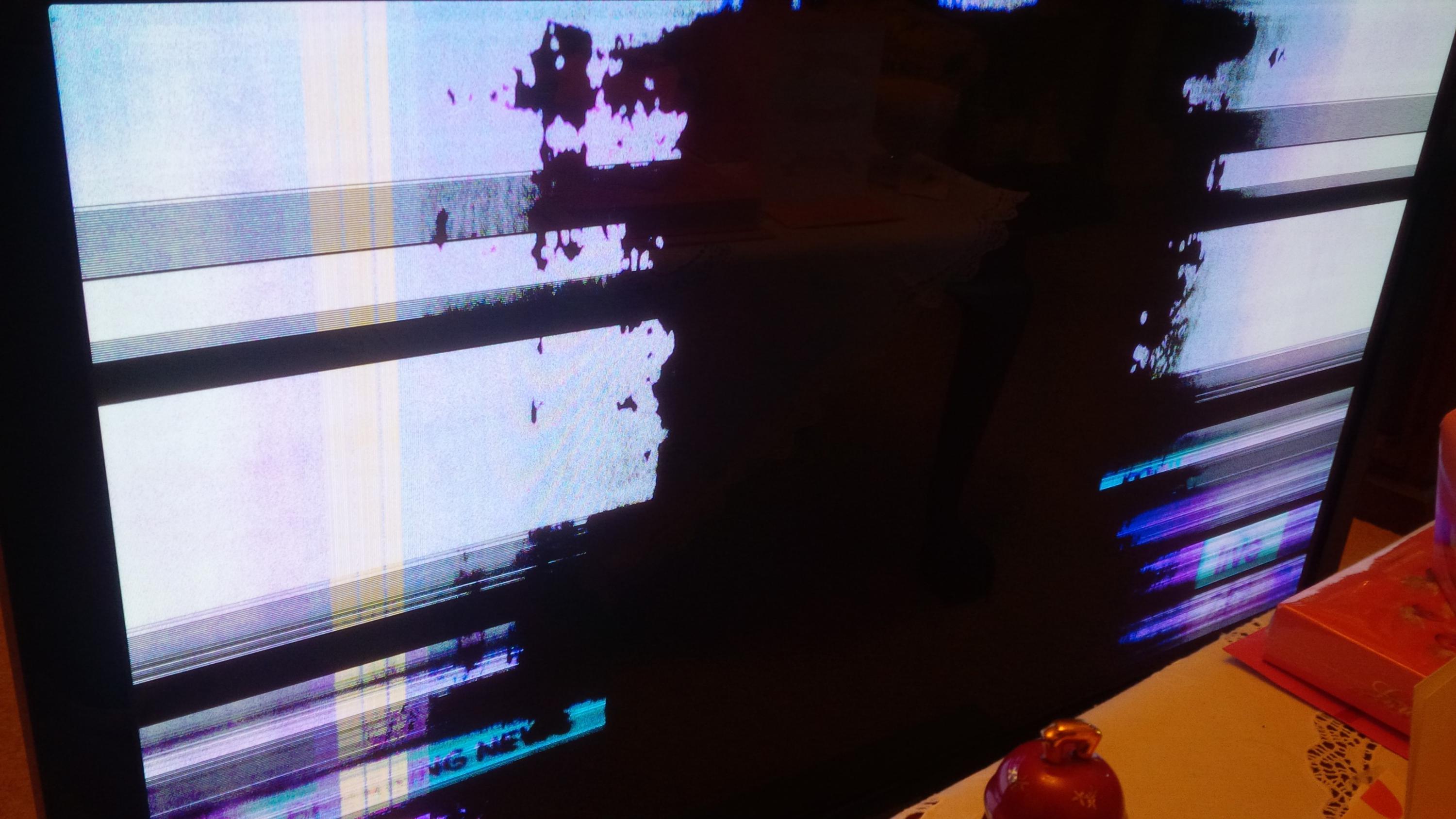

    I took a look at this plasma, it was flashing 7 blinks.
    I disconnected the SU/SD boards from the SC and connected the appropriate jumper. It powered up with no blinks and I could hear audio/adjust volume etc when I connected an input source.

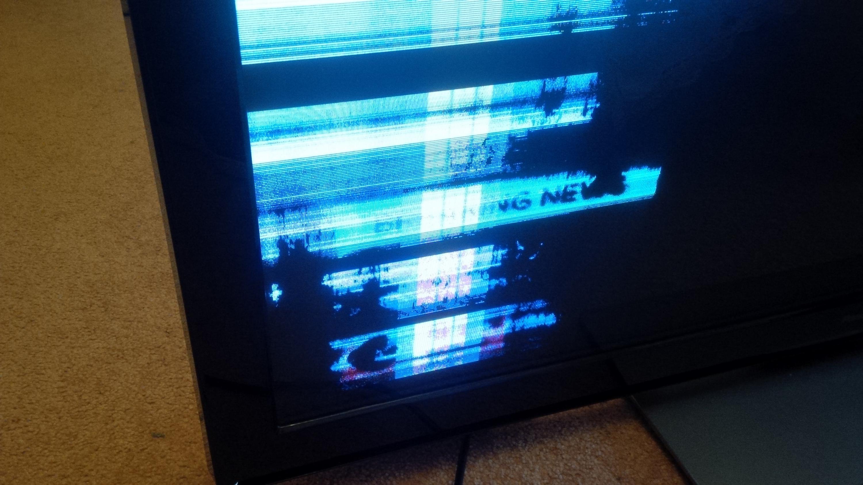

    I powered it up with the gnd screws in place only and the jumper (and the ribbons to the panel) Anyway the screen lit up with the attached image. Can somebody in the know tell me if this means the panel is physically damaged?
    It doesn't look like the photos I see on google images, but I'm prepared for the worst...
    Maybe the 'Breaking News' I see on the panel is telling me something Would this be what was being displayed when it was damaged, how come it has this static image? There is no antenna or sources connected. Is this the last thing that was in the buffers? I don't understand how it works.
    Last edited by t4796; 06-14-2015, 06:11 AM. Reason: forgot the image because i'm a stooge.
    Re: Panasonic Viera TH-P50U30A Plasma Faulty Panel?
    Panel is OK (plasma panel may do weird things when boards are not working), but I would not run this for too long, may further damage SN/SC board.
          Just following up on this.
          Replaced both the SD and SU with boards from the 3D model. The original was AB, the donor was AG.
          Whilst it would run with only one board replaced, the other half of the screen had lines missing no matter how well seated the ribbons were.
          With both boards replaced and ribbons seated runs fine. Fixed.
