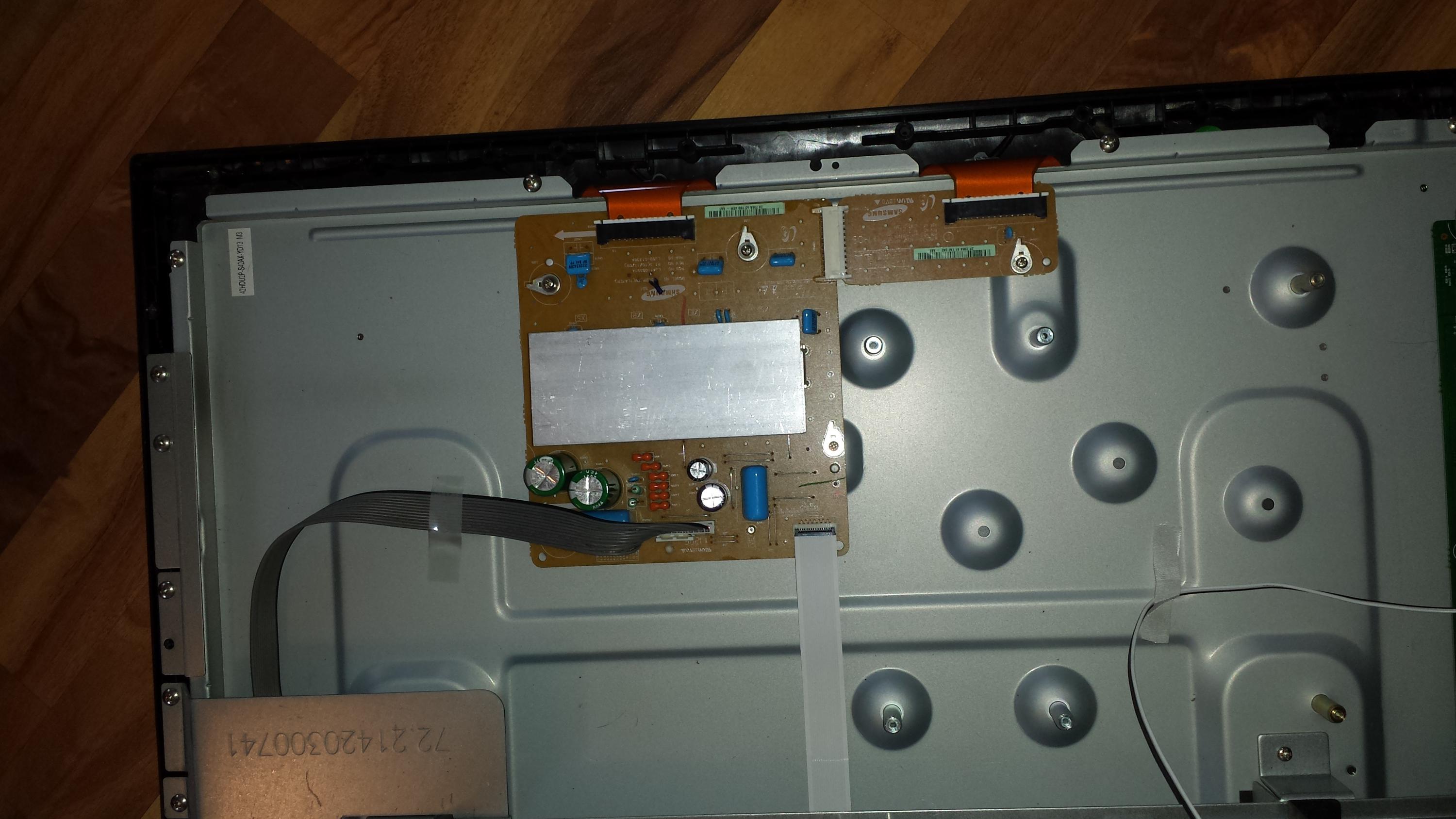

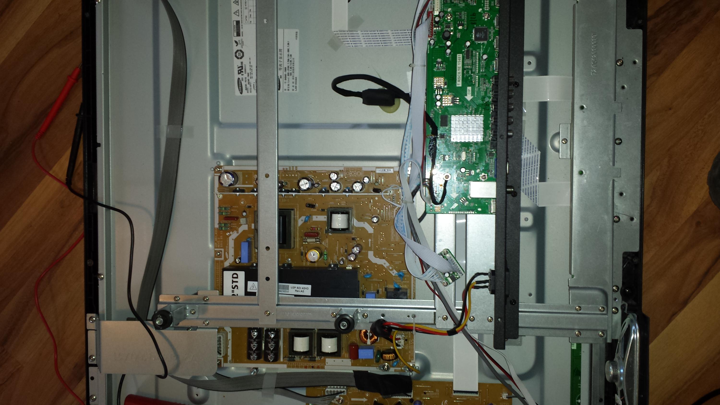

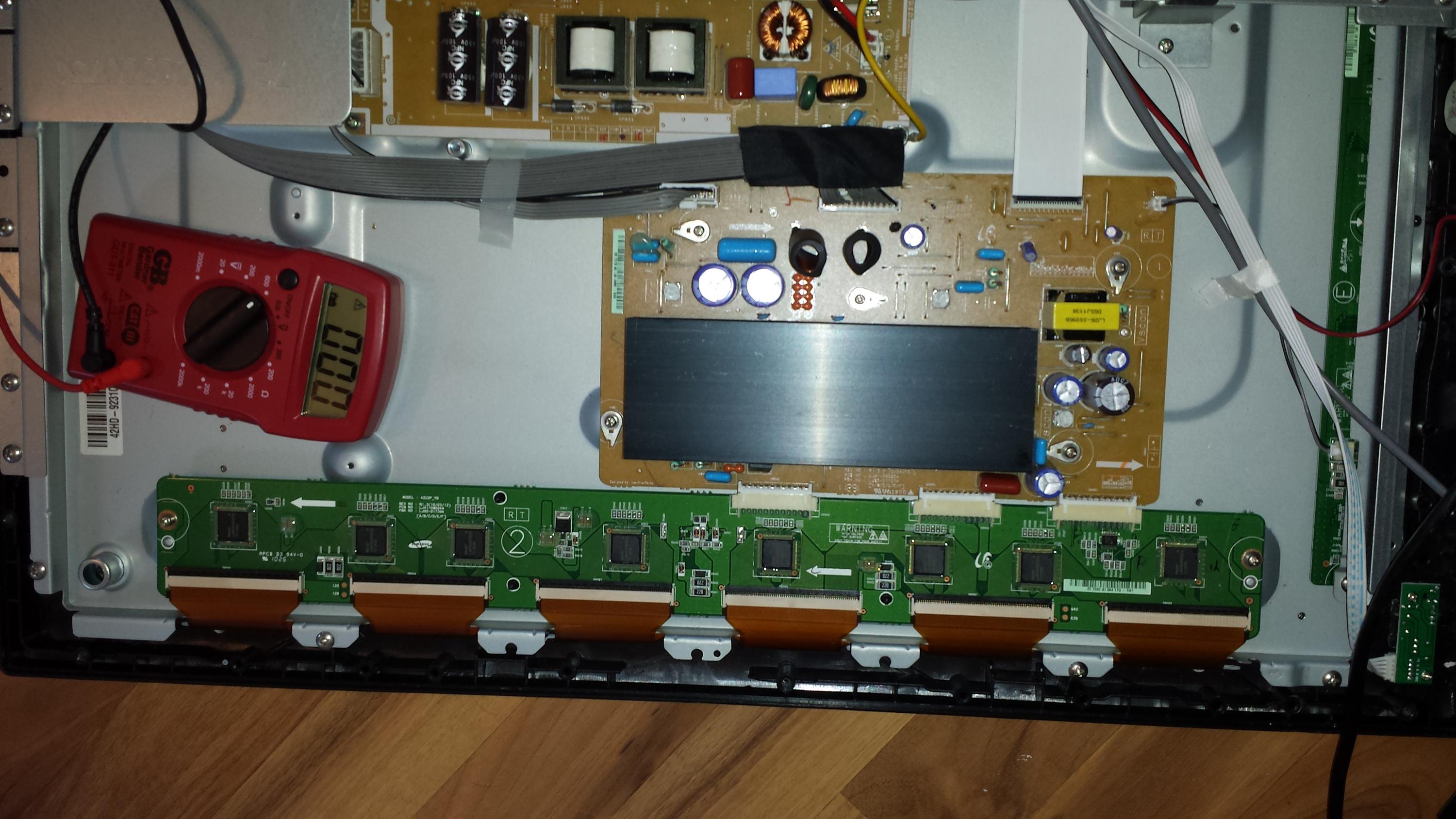

    I would like to fix this myself but have limited experience with this sort of thing. can read a meter and have patience. That said tv has no video or audio. after pushing power button can hear 3 sets of relay clicks from power supply, standby led goes from red to blue. and Va voltage starts low and quickly deteriorates to zero no voltage recorded on Vs or vscan .I found shorted y buffer and replaced. Any advice to help isolate bad components would be helpful .thanks in advance.

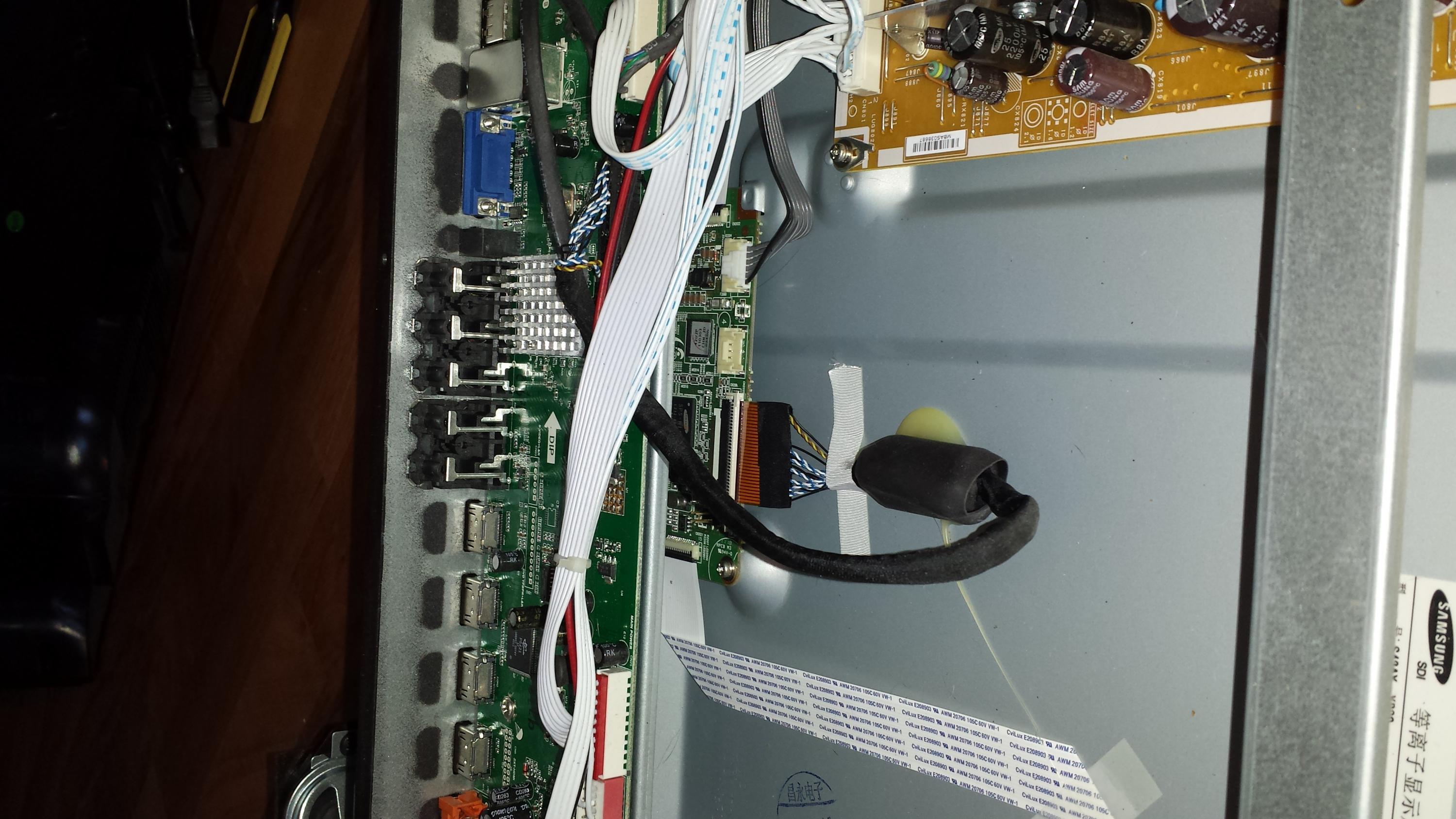

    Re: s42ax-yb09 no audio no video
    some pics of components
      Hmm--It would have been better if you had titled the thread with the Make and Model number--rather than the PDP Glass number.
      Looks like a Samsung PS-42C450--but cant tell as the pictures will not enlarge.....
      I expect you have shorts on the IGBT's of either the Y-SUS, X-SUS or (On That model set) Both!
        sorry 42pa30rq. Can you supply a good link for determining which one or both are faulty?
