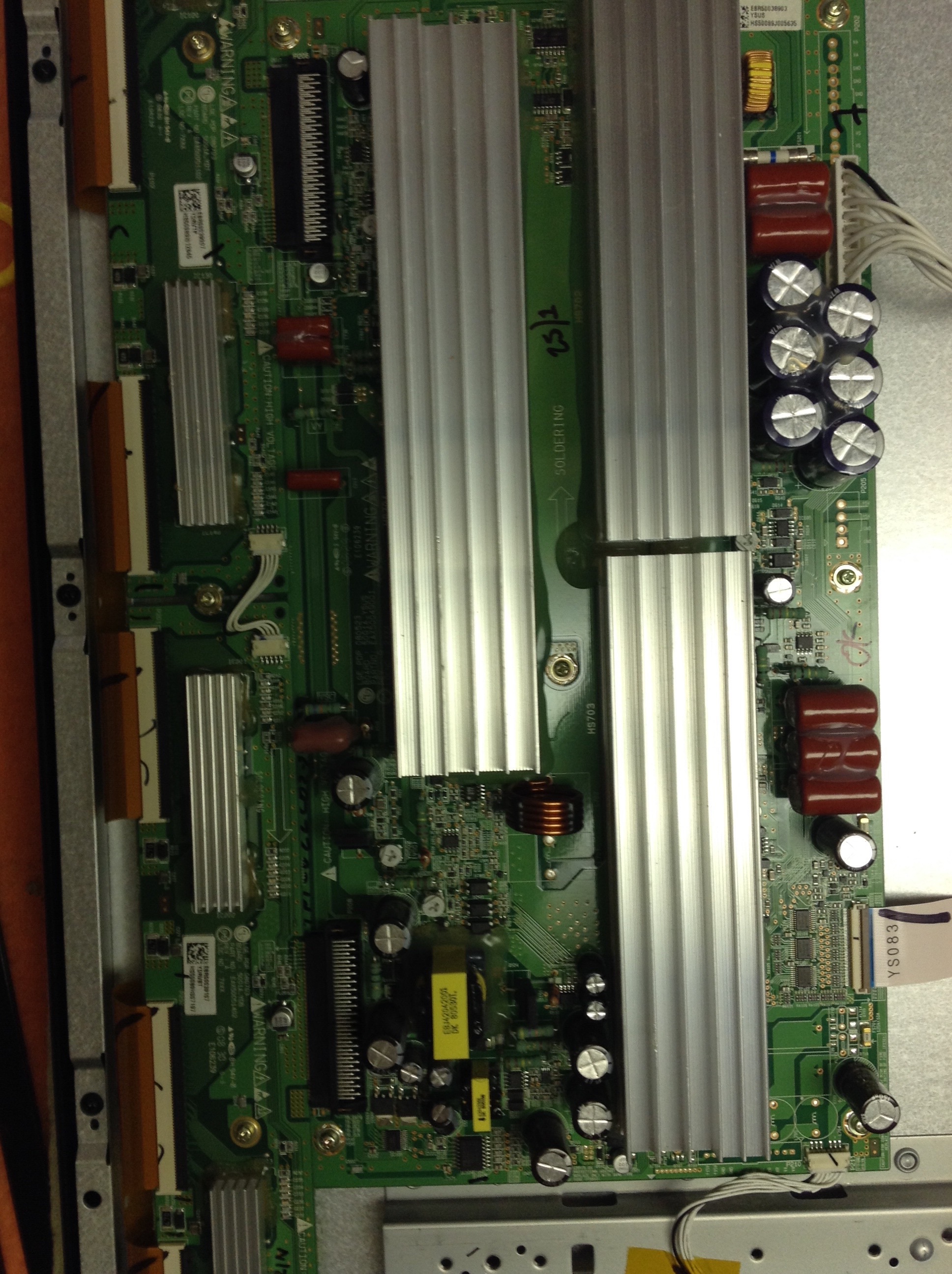

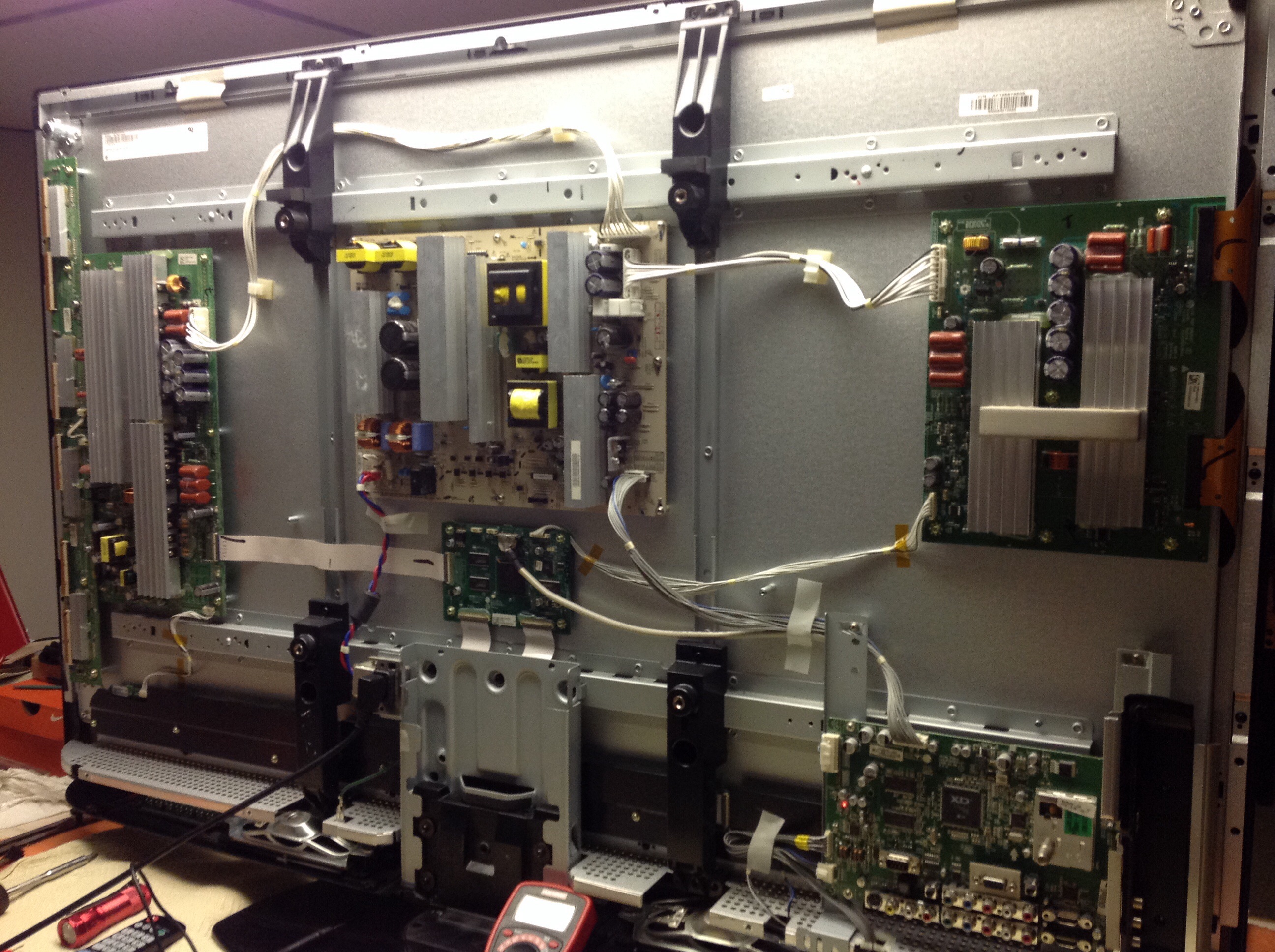

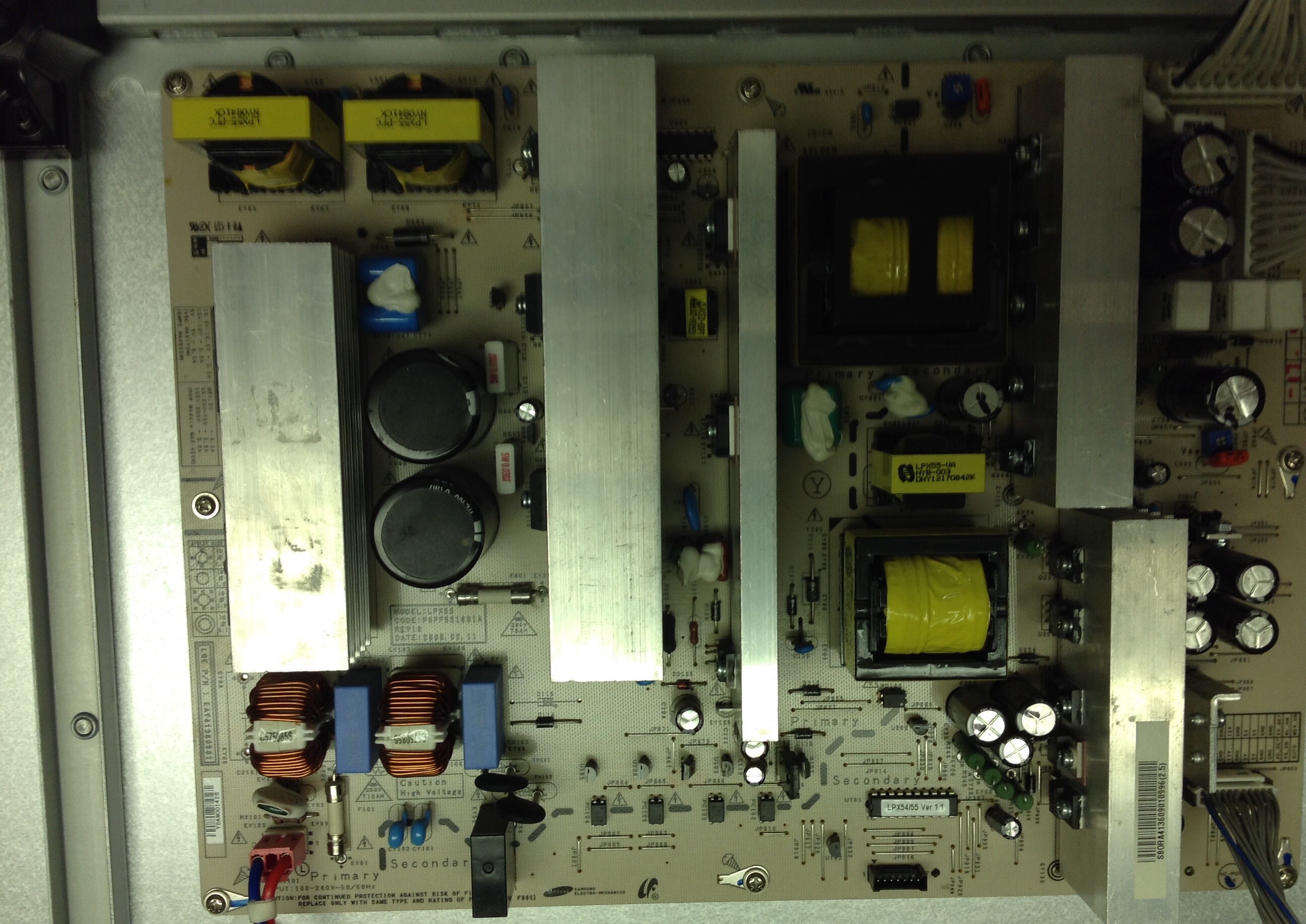

    I got this LG 50PG20 from someone who said, it did work then just shut off. Claimed to have taken it in and was told it had a bad board, don't know which one. I cannot verify if this unit has pic or sound. There is power, frt led lights red>3 blue flashes>solid red (standby I guess), responds to remote. There is no click of any relays when powered and nothing gets hot. Not sure if I am doing it right, but don't get much of any readings from VS or VA anywhere, no fuses are blown. Pulled upper and lower buffers and nothing changed on the screen. need advise on proper testing on/off & placement of probes

      Well after further review, my brother and I found 4 transistors(Trans) have been replaced on the bottom right heat sink(HS) which appear to be bad and the top trans on the left HS(is bad), bottom Trans on the next HS, & top and bottom Trans on middle HS have been replaced.
      I ordered the ShopJimmy repair kit before we found the add'l 4 bad Trans.
      It appears that this thing was repaired at least once before from the signs of the heat transfer paste, the repair kit will not cover all bad components.
      What do the 4 replaced Trans control?
      I'm thinking of buying a new board (EAY41360901) from Sears for $135.00 W/10% off as there is too much to replace and all should be good.
