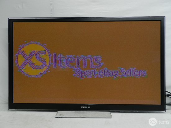

Samsung PS51D6900DK
  • newtothis
    • Mar 2013
    • 1556
    • england
    Samsung PS51D6900DK
    Any idea?
  • freakaftr8
    • Oct 2012
    • 3743
    Re: Samsung PS51D6900DK
    Lvds cable or main board fault it looks to me.
    • Satgun
      • Jun 2016
      • 2
      I have one of these TVs I am getting Sound but NO Picture at all completely black screen I read this is a common fault but I am unsure of the solution I have swapped out power and AV boards on tvs before but this has multiple of both.
      Cheers guys
