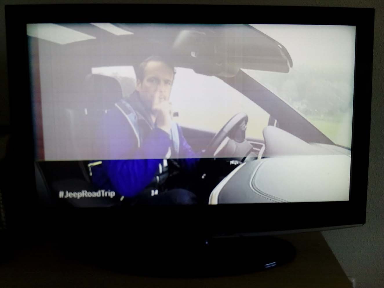

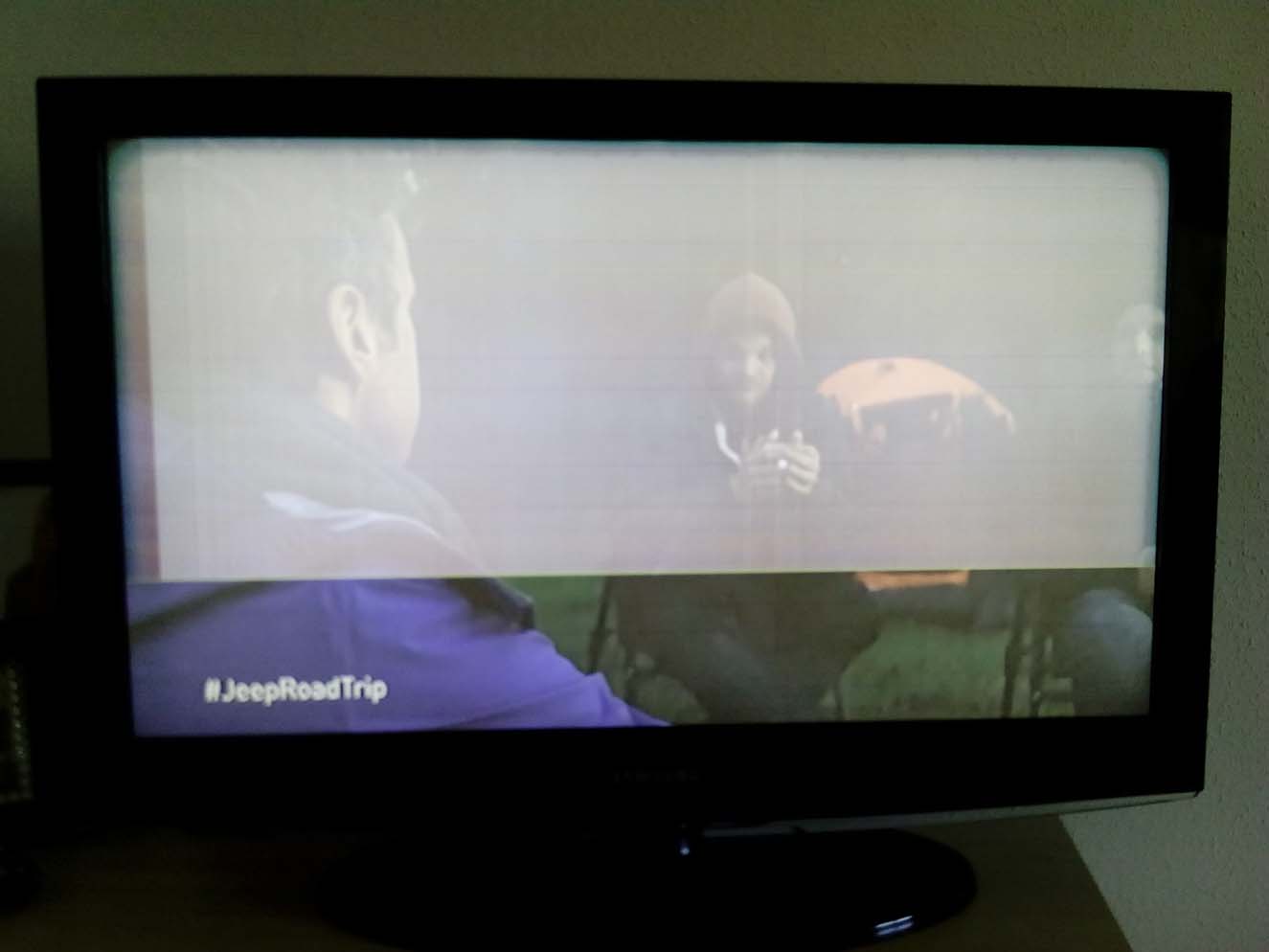

    Hi guys
    Need help diagnosing fault on T.V.
    Bottom half of display is ok but top section is washed out.
    Any suggestions please.

    Might get lucky and it'll be the t-con, but looks like the panel itself to me.

      Re: Samsung LE32C450
      try re-seating cable going to tcon board, and tcon ribbons, could be bad tcon, I always hope its the tcon board, because its usually the cheapest board to replace, video how to here, https://www.youtube.com/watch?v=hgXQYeISbq8
        I second the panel
          Thanks Guys will go buy a new tv tomorrow, Cheers
            If you are game. Try the T-CON board.....If it works let us know....If that fails....then buy new TV.....at least you will learnt something....Cheers
