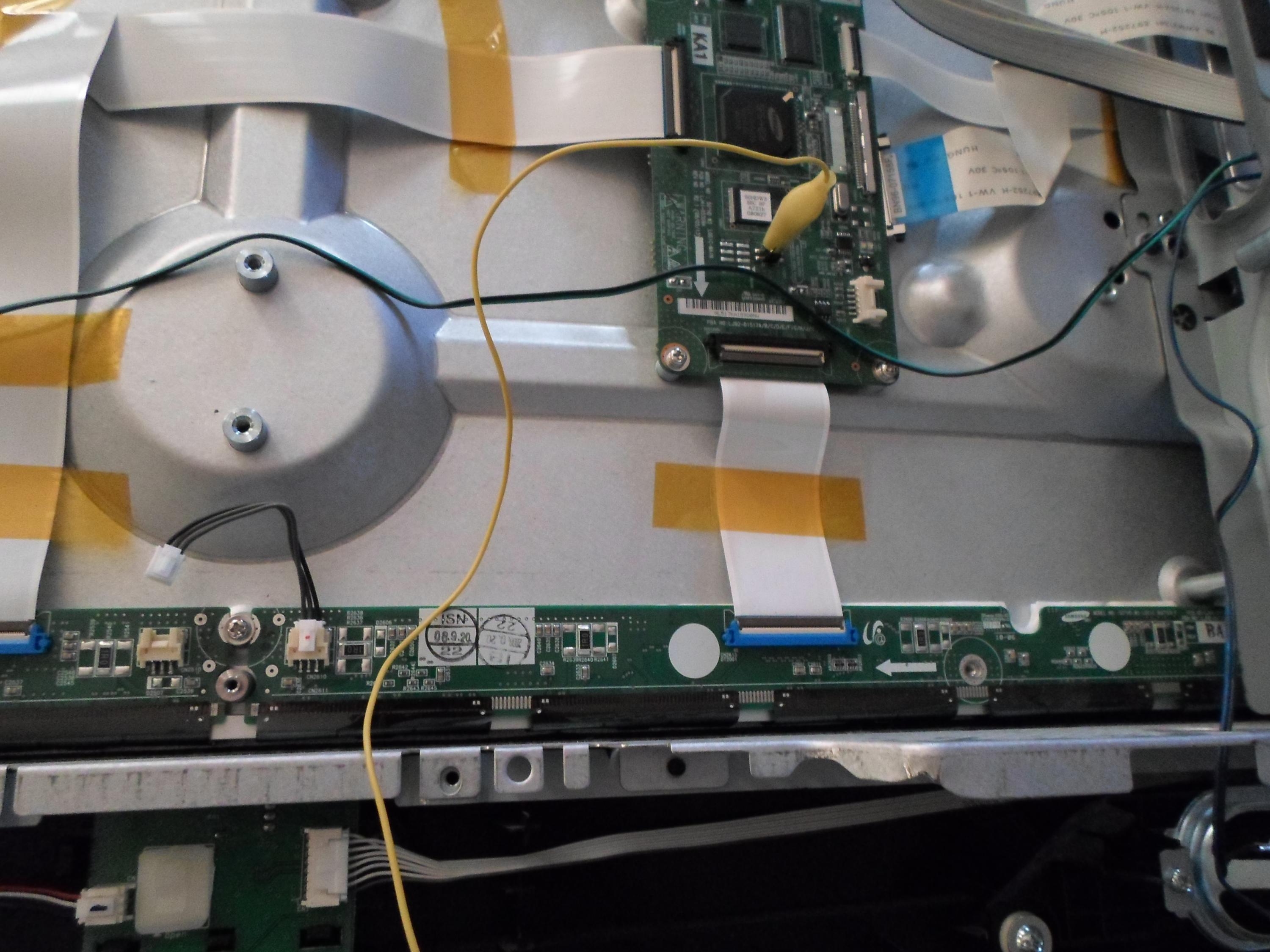

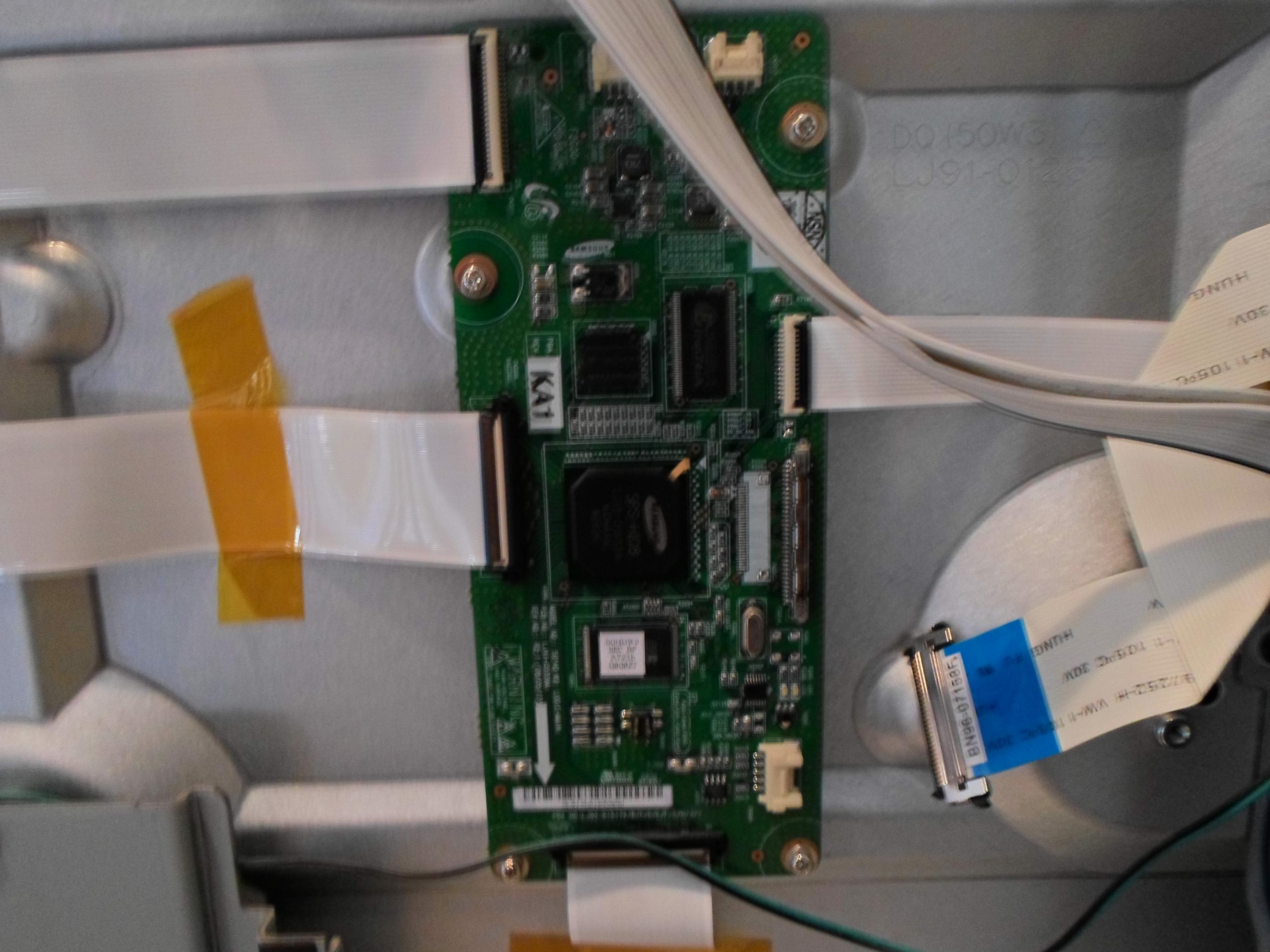

    The TV powers on normally and the screen glows, but there is no picture. I disconnected the LVDS cable and jumped pins 3 and 4 on the logic board. Turned the TV on and still nothing. I bought another logic board and same issue. Am I doing this procedure correctly, or what else could be wrong??

    Check the Va supply to the C-buffer boards, running along the bottom of the panel, if it goes missing this can cause a problem. NOTE: Do not re-plug Va connector with power applied or panel will be killed.

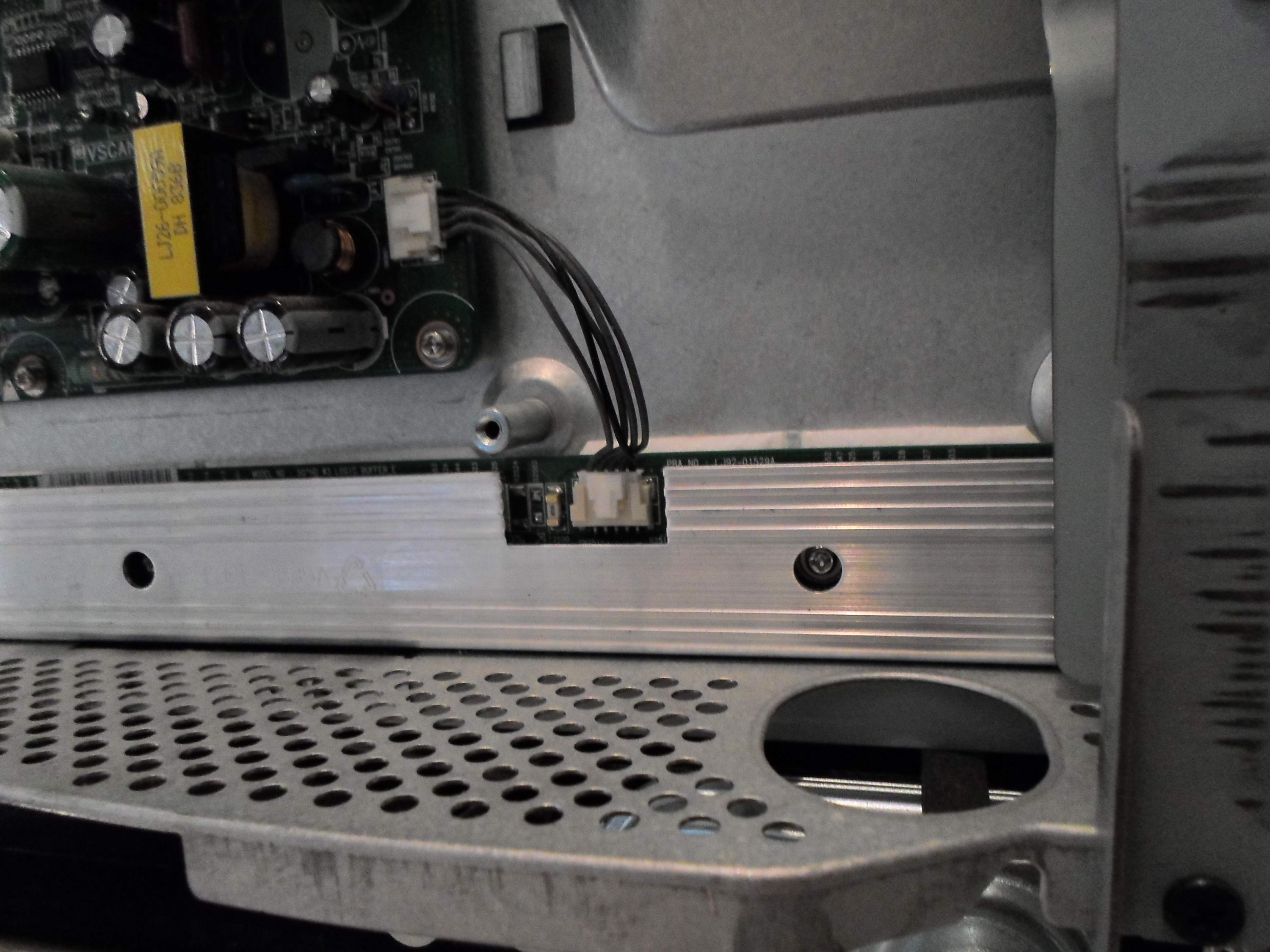

      Thanks Tom, I was looking for where to check the Va voltage and saw this SMD fuse which is open. Thoughts?

        I have 56V on the bottom of the fuse which matches the panel sticker for Va, and 9V on the top side. (That 9V is there even with the TV unplugged, and is not showing a short to ground on that side)

          Sometimes the fuses just fail with no obvious cause, try replacing it. If it blows again, the panel is probably shorting it, which would make the set scrap, this is rare though.

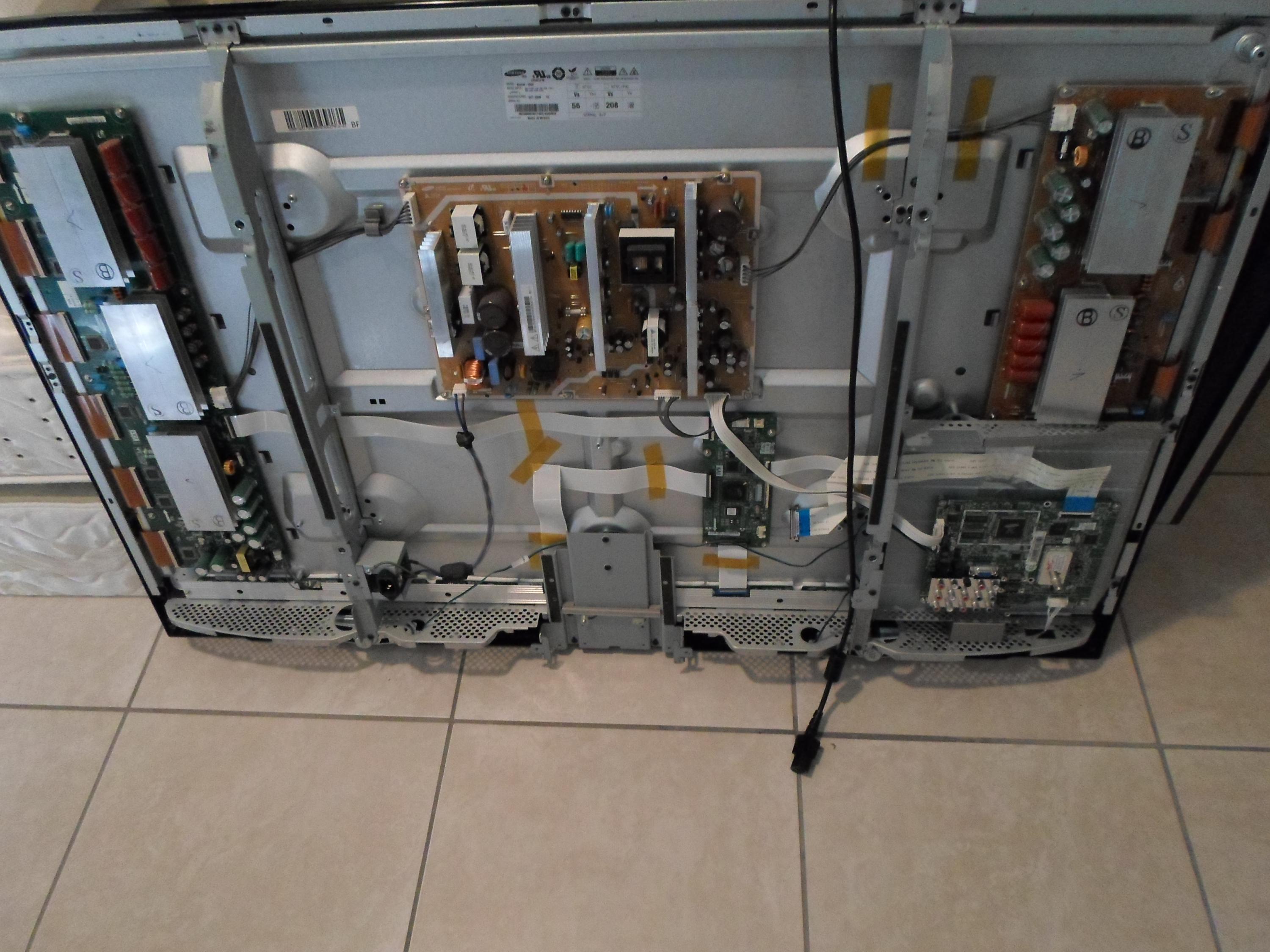

                Could be a shorted ceramic cap on the E/F boards. Or a bad panel. Panel faults are common on this model. Can you remove the address driver connections (the ones connecting to E/F buffer) - or are they soldered to the board?

                    No -- the cables from the lower buffer to the actual panel.

                        I disconnected the F buffer from logic board and E buffer, and replaced fuse. Fuse didn't blow and I get test patterns on left side of screen.

                          Wait now I reconnected F-Buffer and turned on and the whole screen is working, weird.

                            Could be an intermittent shorted capacitor... maybe try some freeze spray?
