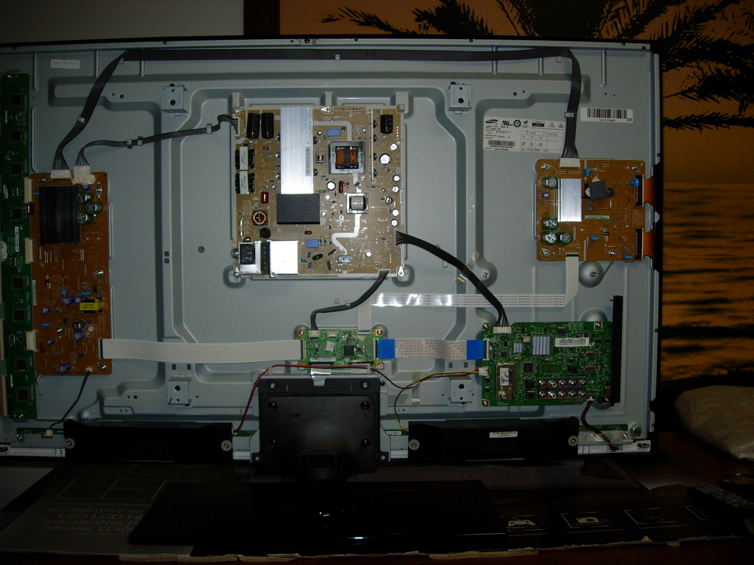

    I have a Samsung PN43D440A5D that won't turn on. I have not touch this TV for a year now. When I plug it in I can hear clicking sound on the back then it stop. Red light at the left hand corner is constantly on. The remote control is not functioning even with a new battery.
    I am thinking of replacing the power supply board. Some of the suggestions on this forum is to replace both X & Y boards. Any suggestions? I have not looked into the cost of X & Y boards but the power supply is only $20.00.
    Hope to hear from you soon guys.
    Re: Samsung PN43D440A5D won't turn on
    Can you supply some photos of the boards in your TV? There are at least two different versions of this set with different X-main boards.
        Thank you all for responding quickly. My X board does not have connection to the power supply. It has ribbon connection to Y board and the main board. I have a hard time attaching pictures to this reply. I will try again later.

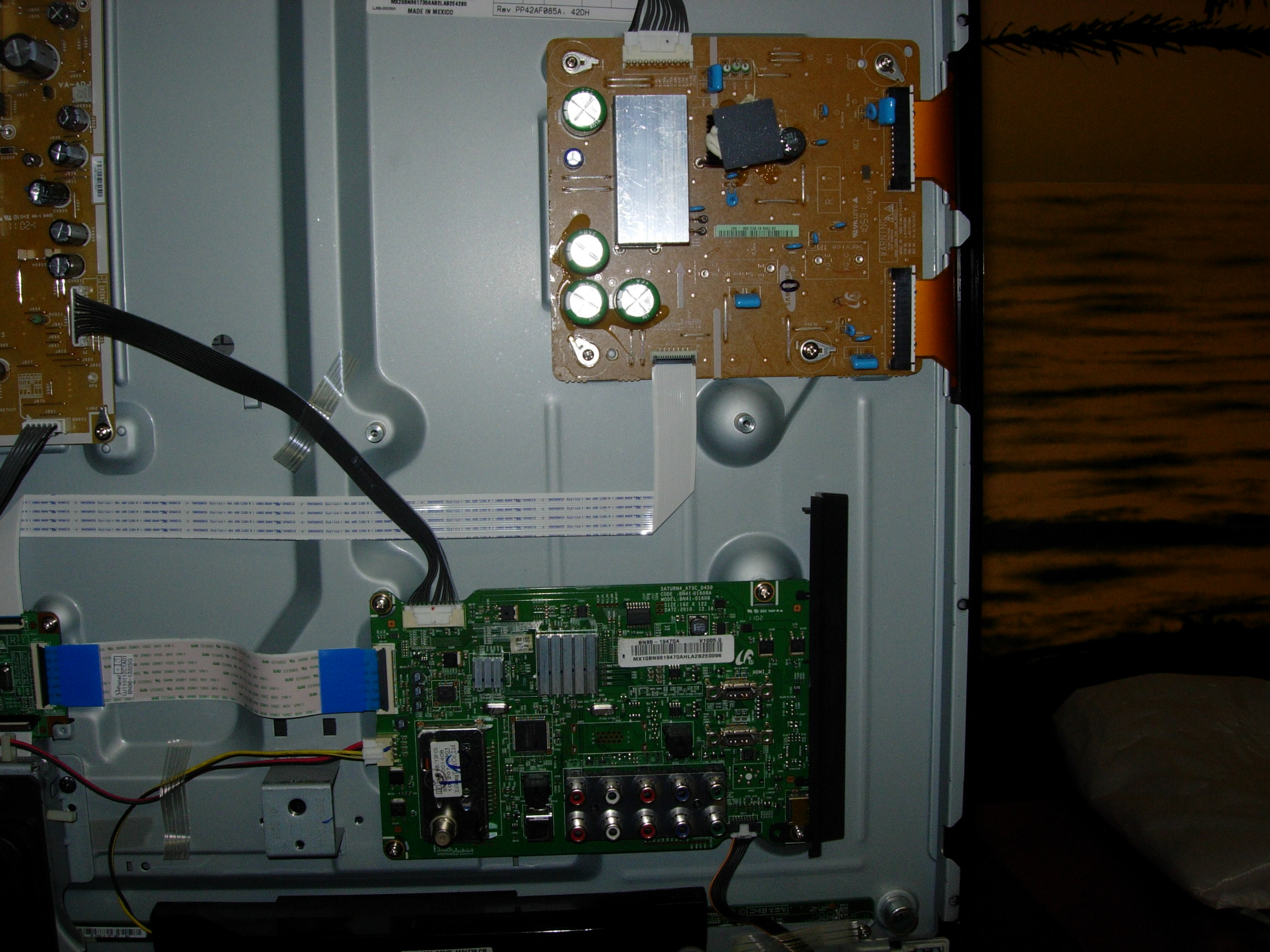

          Tom , here's the pictures of the back of the TV. Sorry the first picture is wrong. The second picture shows the X board and the main board. I will send you the right picture.
            Your Xmain power connector runs off your Ysus board.
            I have mine apart now readjusting some voltages.
            Our panels share the same Xmain board and probably others too
              Here's the right picture.
                Just like mine, disconnect the top most connecter on the Xmain and plug the panel back in and turn it on and see what happens.

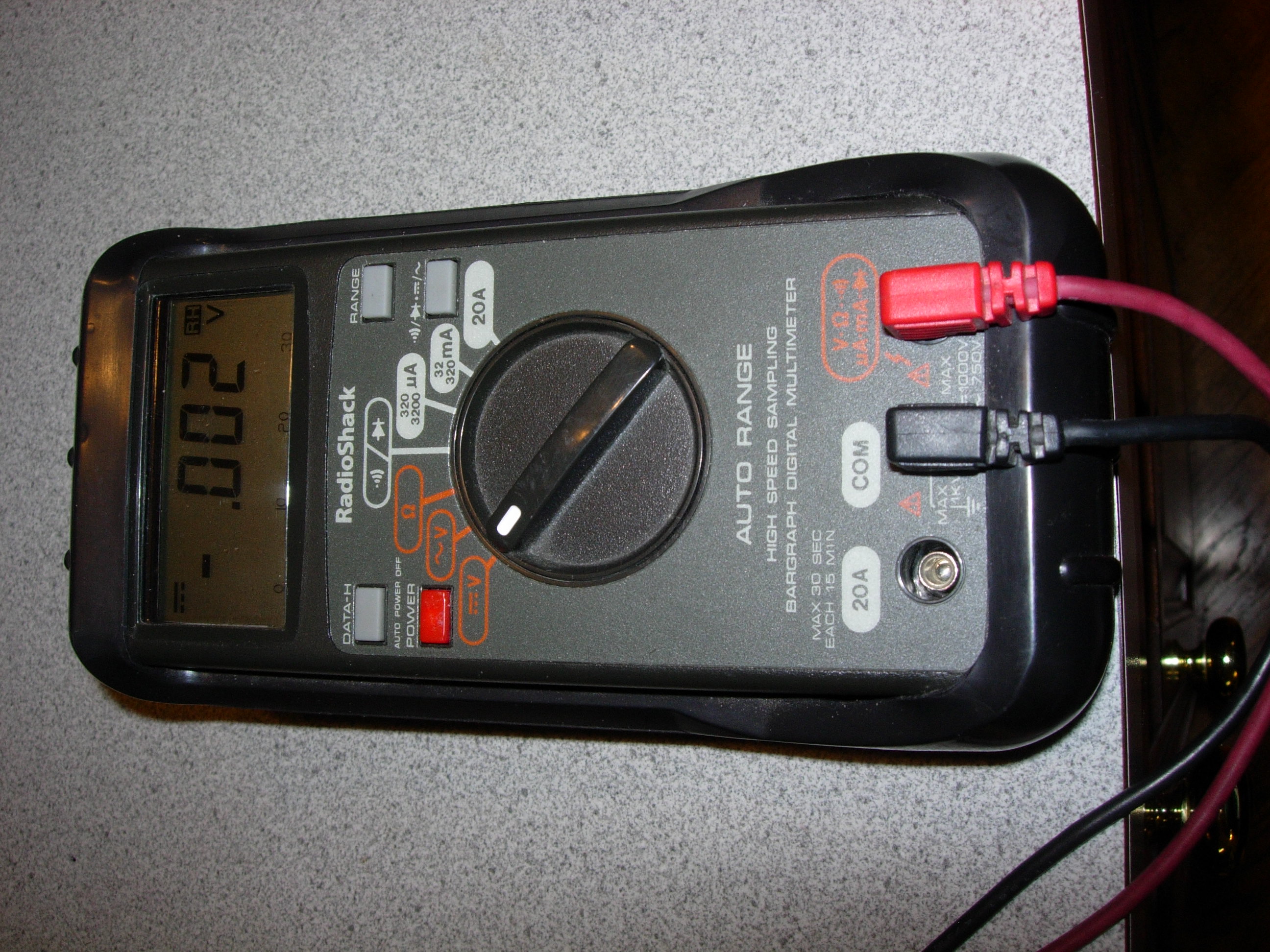

                      With the X board connected: VS-0.1 mv, VA-0.2mv,VSCAN-3.8mv Using RadioShack digital multimeter.
                        Post a picture of your DMM?
                        Put your meter to VDC 600 or the highest it can go.
                          Here's a picture of my old tester. The max range for VDC is 1000 and the AC range is 750VAC.
                            Not familiar with it, set it to VDC and get voltages.
                            What does the panel sticker tell you?
