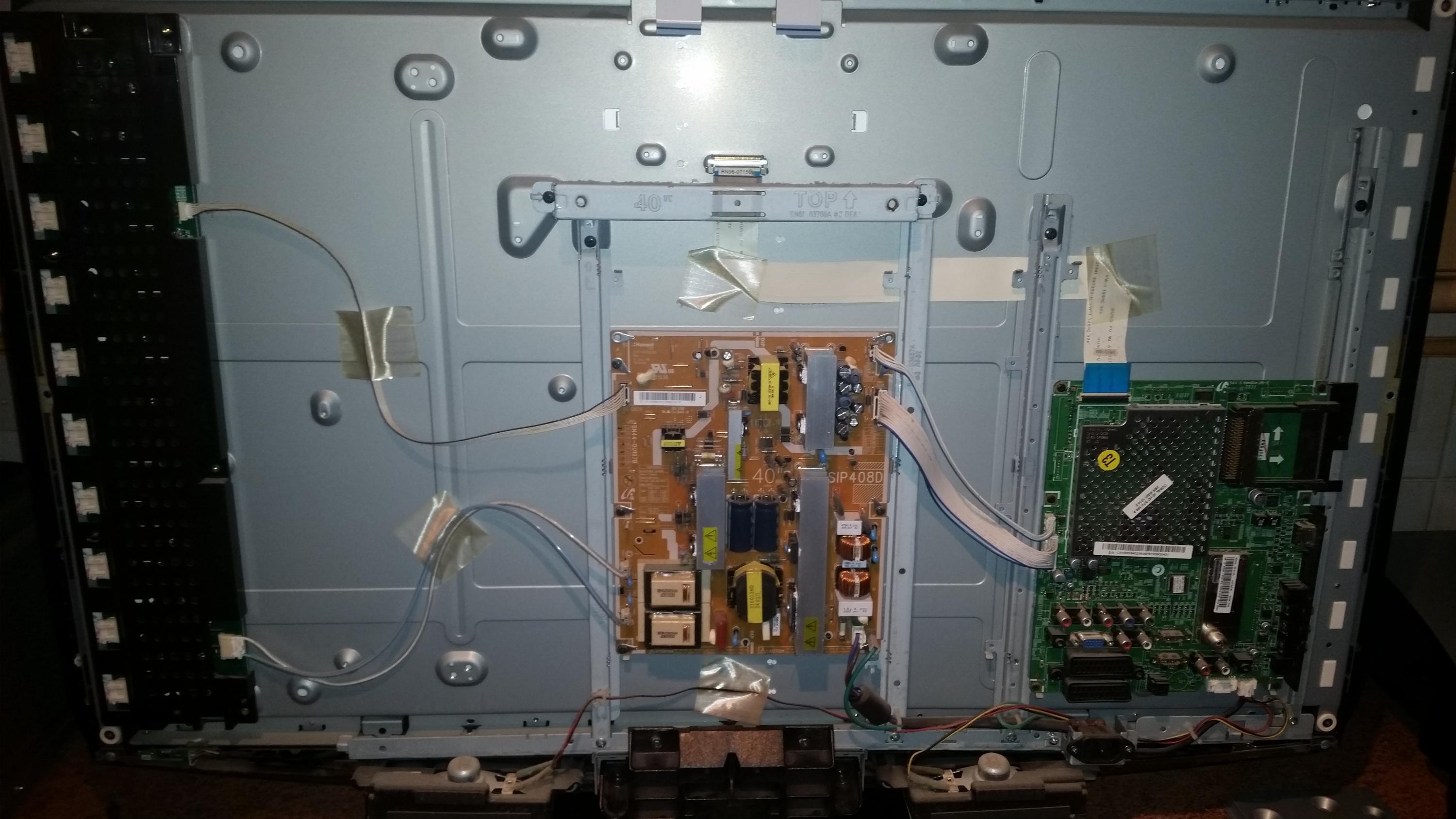

    hello guys

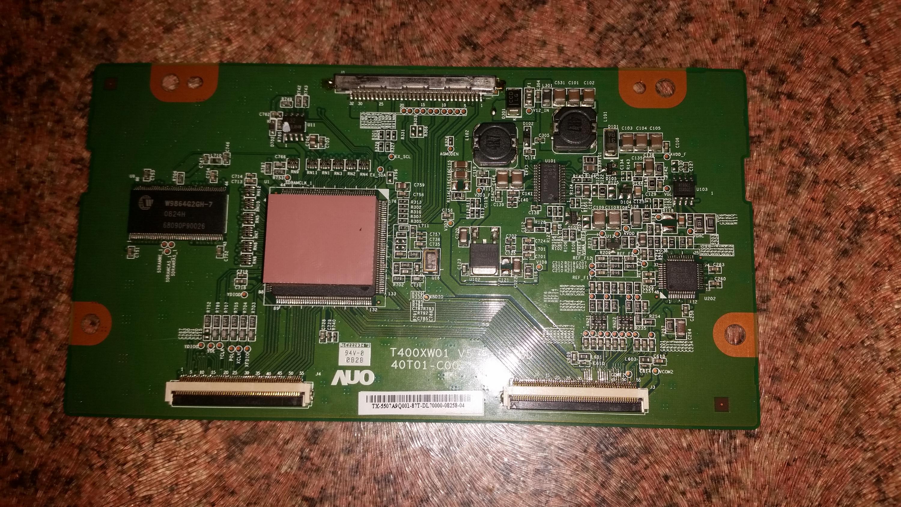

    this tv has Screen Solarization im just wondering if it has the AS15 chip ?
    tcon board is T400XW01 V5 40T01-C00
    thanks
    Re: Samsung le40a457c1d
    There's one there on the right hand side of the board... U202
      opps i must have missed that tom thanks ill get it replaced

        Good idea to check gamma voltages first. Just to make sure...
          just doing it now tom
            VGAMMA 1 15.55 volts
            VGAMMA 6 12.75
            VGAMMA 9 14.53
            VGAMMA 10 7.90
            VGAMMA 11 7.42
            VGAMMA 12 14.87
            VGAMMA 14 14.58
            VGAMMA 17 14.67
            VGAMMA 22 0.49
              Definitely bad.
                Thanks m8 ill change it
