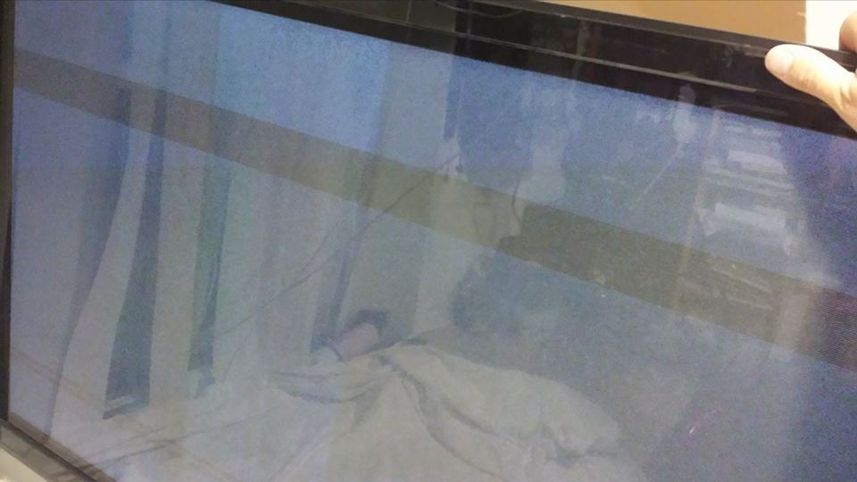

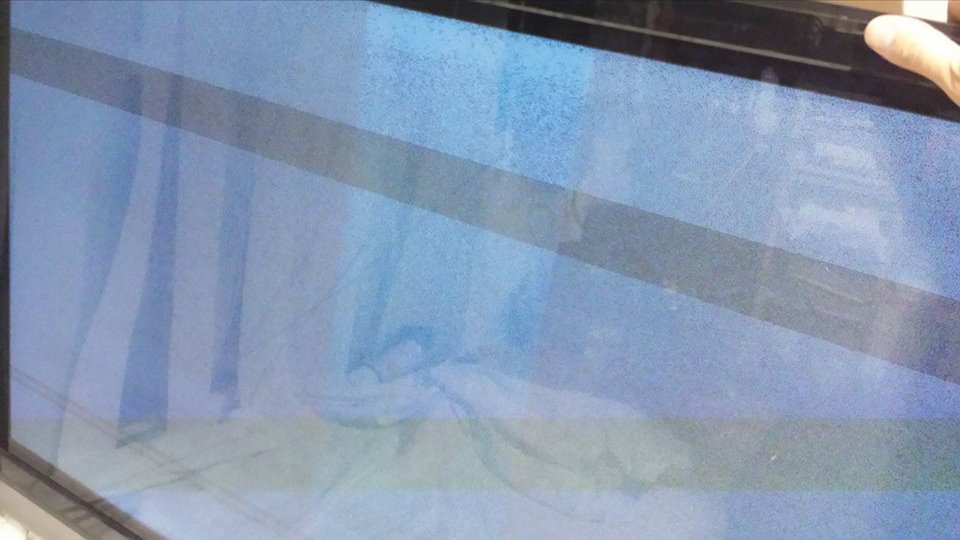

    This LG50PC1DA has a flickering screen. Im hoping I can upload the video.
    Has any got any ideas.
    Thanks.
    https://www.dropbox.com/s/nhdqek7sjz...%20tv.wpl?dl=0

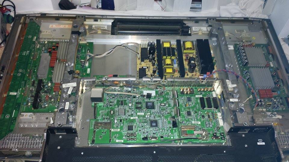

    in case this video don't work I put in some pics.

      Most likely it's the IPMs on the Y-Sustain. This is one of two faults they can cause. The other being a completely black screen. Unfortunately it's a pretty expensive repair and not an easy one if you decide to do it yourself. The modules are tough to remove since the heat sinks rob all the heat.
        Re: Lg50pc1da
        Also would be a bad Y-buffer board at the same time here
        Rarely worth fixing.
