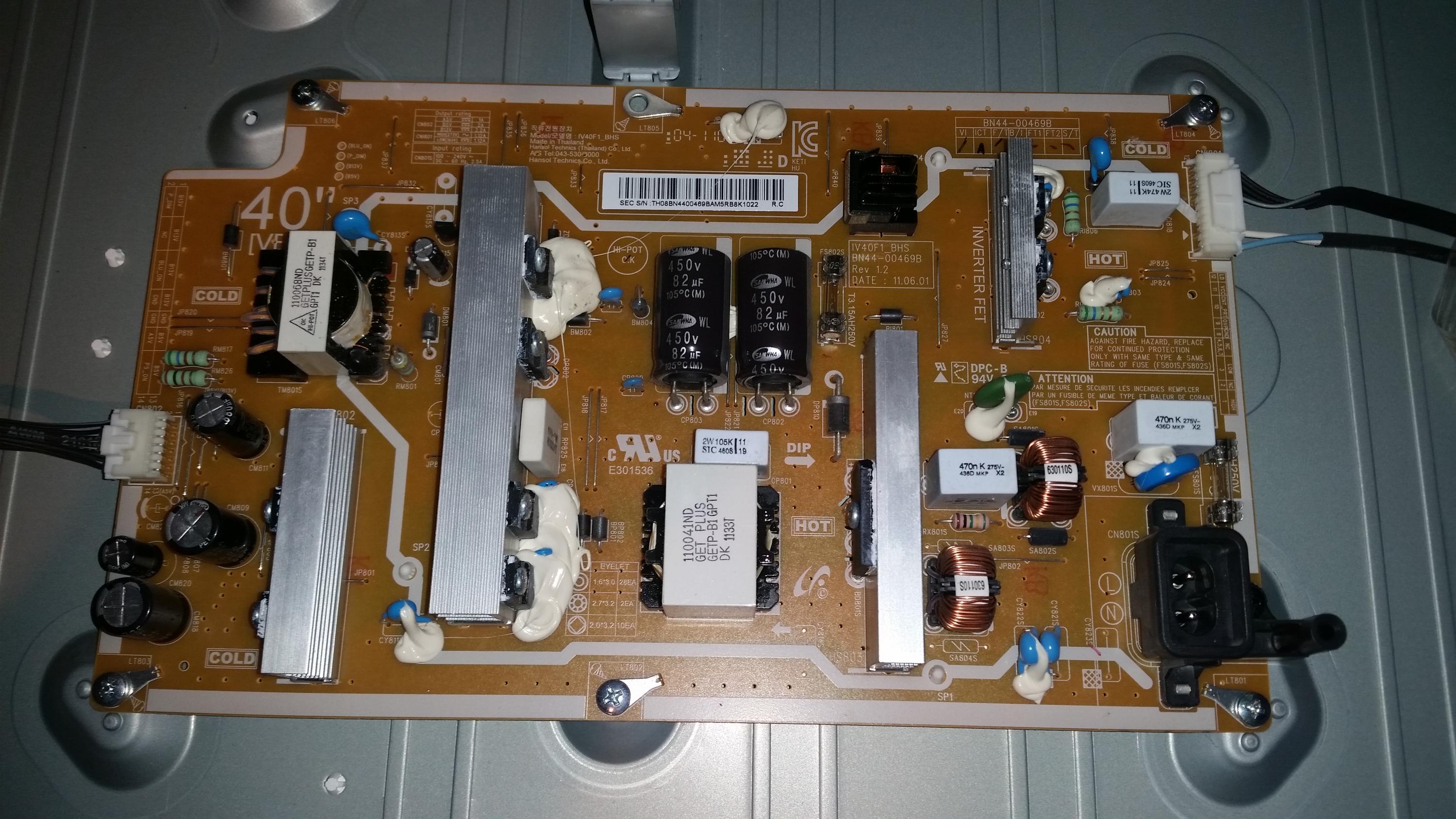

    hi guys
    trying to figure this tv out apparently stop working after a lightning strike all voltages off the power supply seem dead apart from the two main caps that read 335 volts
    BLU-ON 0.00
    B13V 0.00
    B13V 0.00
    GND
    GND
    B5V 0.00
    A5V 0.00
    B5V 0.00
    PS-ON 0.00
    B13V 0.00
    NC
    B13V 0.00
    P-DIM 0.00

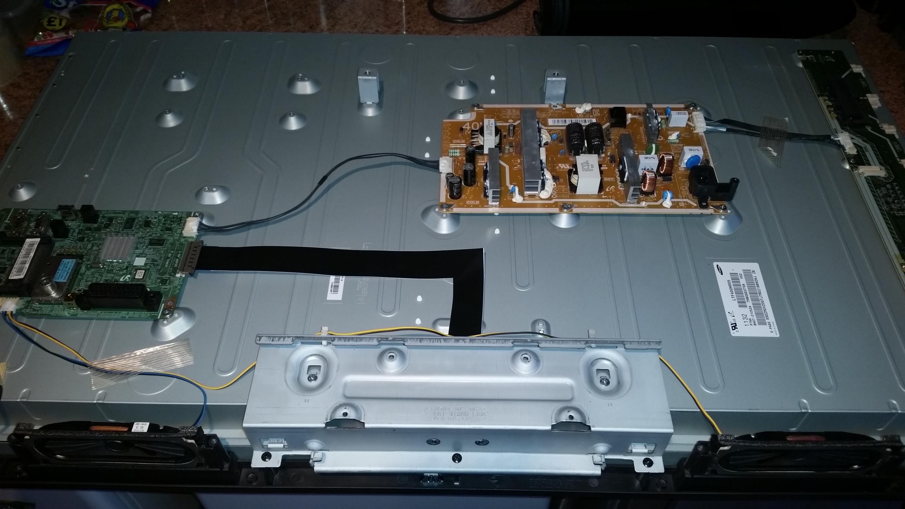

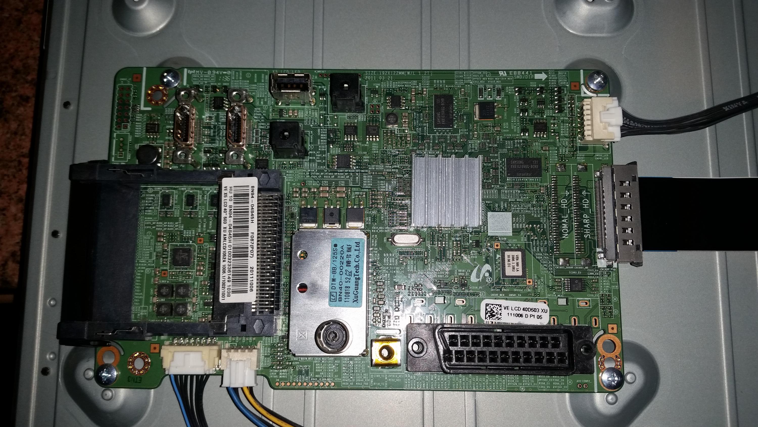

    photos updated

      http://www.chsinteractive.co.uk/elec...television.htmupdate :
      found this online already found • QI802 • QI808 shorted so ill proberly order the repair kit
      just a bit worried the main board has been damaged
      thanks
