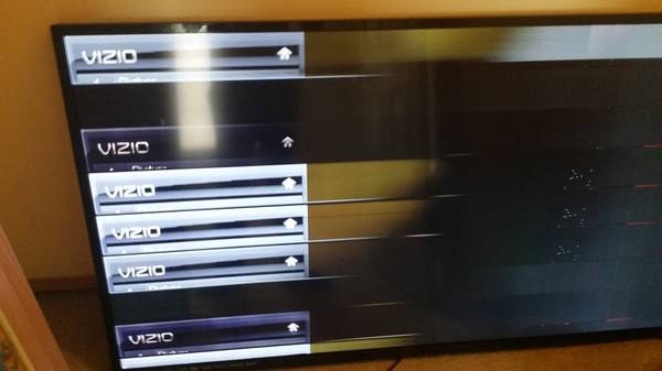

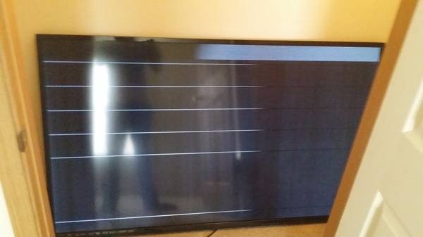

Have the opportunity to buy this for real cheap. Does the description indicate Main board problem or panel problem or tcon problem. I would think the randomness of things would mean an ok panel. If you notice the Vizio 1st picture has repeating pattern.
Vizio smart tv 70 inch

Shopjimmy pretty much summed it up in the description. Seems to be a bad panel.
IMPORTANT: The following picture symptoms indicate a bad LCD panel, and NOT a bad T-con board:
-One side of the picture is darker than the other
-Picture has horizontal line(s)
-A dark, cloudy spot spreads across the picture
Installing a new T-con board in a panel with one of the defects above will result in damaging the new board.
Look for the ZH stamped on the board.Comment
Re: Vizio smart tv 70 inch
Going to have to agree with the bad panel diagnosis.Please do not PM me with questions! Questions via PM will not be answered. Post on the forums instead!
