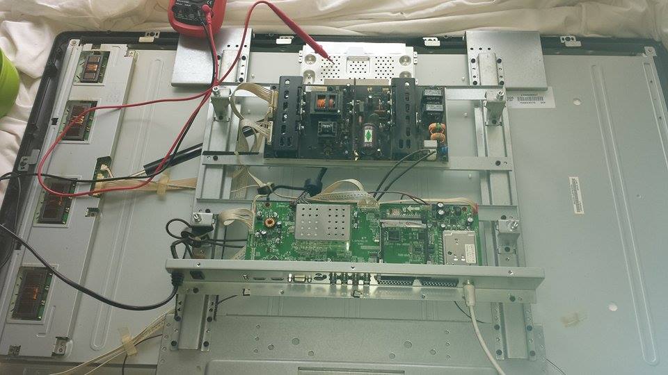

    Just bought this Digitrex CTF4071A for a tenner.
    There is no picture on it, all voltages are ok.
    Could it be the buffer board on the left???
    Re: Digitrex CTF4071A
    That's the inverter. LCDs don't use buffer boards.
    Did you check for 24V and BLON signal at it?
    • snipersquad100
      • Nov 2013
      • 297
      • uk
      24 is there, whats the BLON signal.
      some one has already posted about this set im thinking it might be a common problem.
      Anyway I think iv done a boo boo, I puled out the inverter board and instead of sliding it to the right to disconnect it from the brown plastic strip I disconnected the brown plastic strip from the bulbs. now I cant get the bulbs to slot back into the sockets.

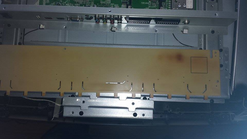

        F102 on the inverter has blown.
        • snipersquad100
          • Nov 2013
          • 297
          • uk
          and theres a burn mark on the underside of the inverter board that's also the side f102 powers.
            Looks like it's got hot, but that doesn't mean that's bad.
            Any shorts either end of F102 to ground?
            • snipersquad100
              • Nov 2013
              • 297
              • uk
              Yes, I got a 1.5 ohm reading at the side of the fuse that runs towards the hot spot.
