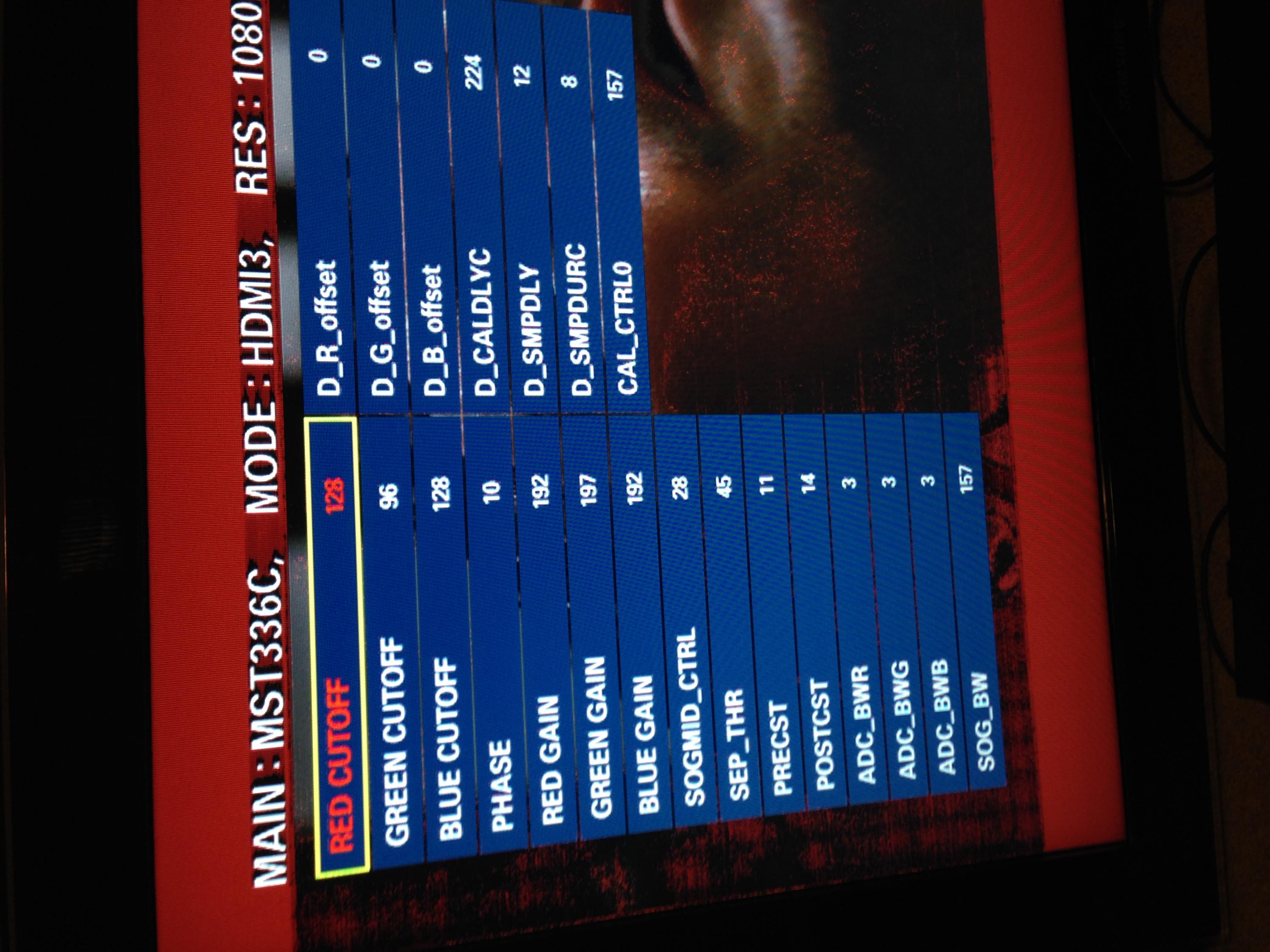

    For example I have a LN55A750 that has severe reds in the black/dark areas of the video feed/idle screen.
    When I run test pattern DDR pre/post the picture is perfect no reds in the blacks ect. This panel only has those 2 test patterns.

    DDR before - data before tcon FRC (frame rate converter, 120Hz etc)
    DDR after - data after tcon FRC
    It's probably a main board fault. Do you have a picture?

      This is the only photo I have. As you can see the black bars got a red hue to them.
      Funny part is when I smacked the back of the panel the issue disappeared, came back for awhile and I did it again and now its been working fine.
      Makes me wonder if there is a dirty connection or a ribbon cable snap lock that is warped/broken due to heat. Panel has 12,000 hours on it.
      The DDR tests were ran while the Panel was in its "Red HUE" state, clear as day when DDR/Post/Pre were ran.
      This Panel is a beast, and a early adaptation of FRC and has a huge metal shield covering all the boards behind the piano black plastic rear cover. Not looking forward to breaking this one down!
      (Not sure why the photo is turned, its not that way when viewing it outside of the site)

        Is the LVDS cable OK? I've had failures caused by that cable that look similar.
