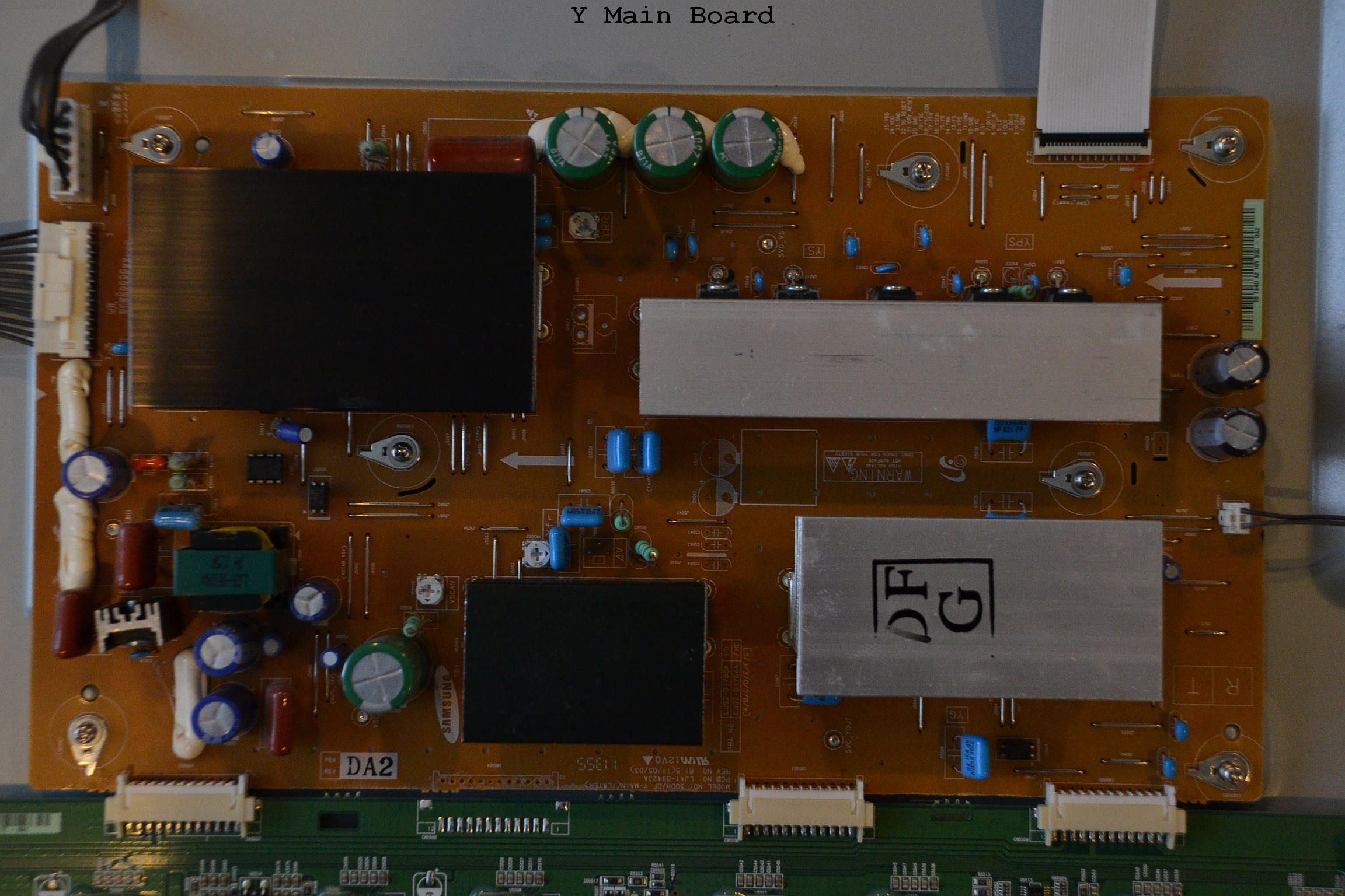

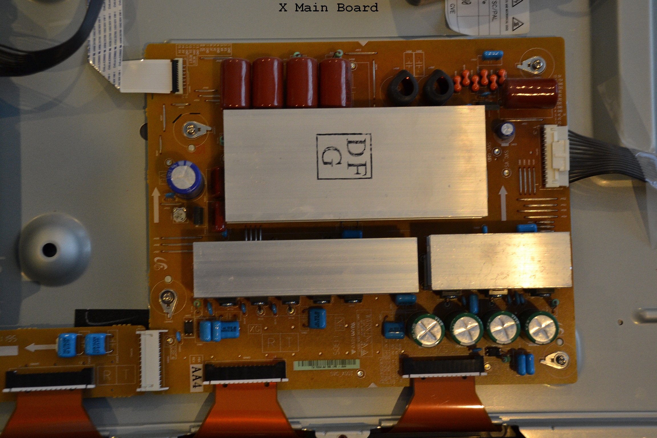

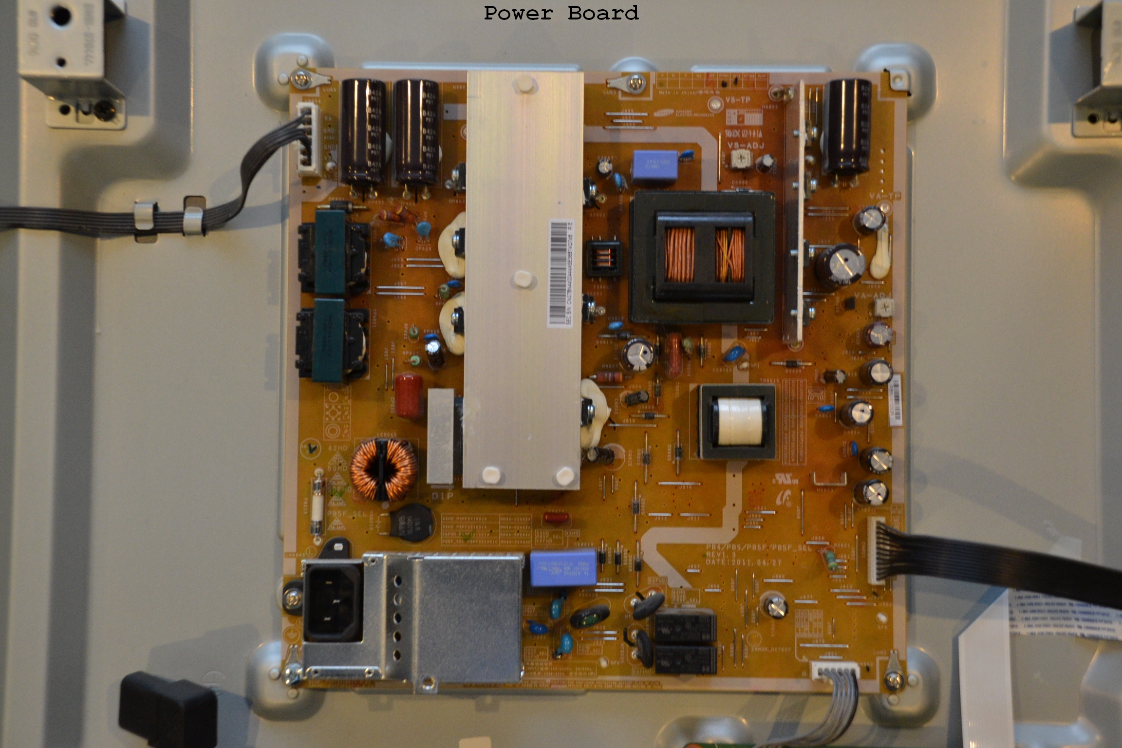

        OK, can you provide some pictures of the power supply board, the Y-main board, and the X-main board?
        Power supply board - AC power connects to this
        Y-main board - On the left hand side of the TV looking from the rear
        X-main board - On the right hand side of the TV looking from the rear

              Re: Samsung PN51D550C1F died, won't turn on, clicking
              Here are the 3 boards, tom66. Thanks.
                OK there is a test point on the Y-main marked VSCAN... can you measure the voltage on this point (highest DC range or auto-ranging DC volts) using a digital multimeter. Place red probe on the point and black on the chassis. Note if it changes while powering up/clicking.
                  I have no movement whatsoever. The needle is still at 500DCV.
                        Can you remove the Y-buffer board (connected to the Y-main) and see if the voltage on VSCAN rises
                            I get no movement on vscan at 500 dcv. There MIGHT be a slight movement, but it might be from vibration...
                                    It would seem like your Y-main board is bad, then.
