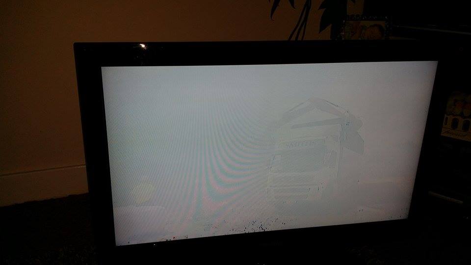

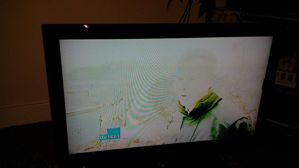

    what you think guys bad panel again ?
    p.s i have not got the tv yet
    Re: Samsung le37a456c2d
    Panel looks ok... probably AS15-F IC fault. Picture of the T-con board?

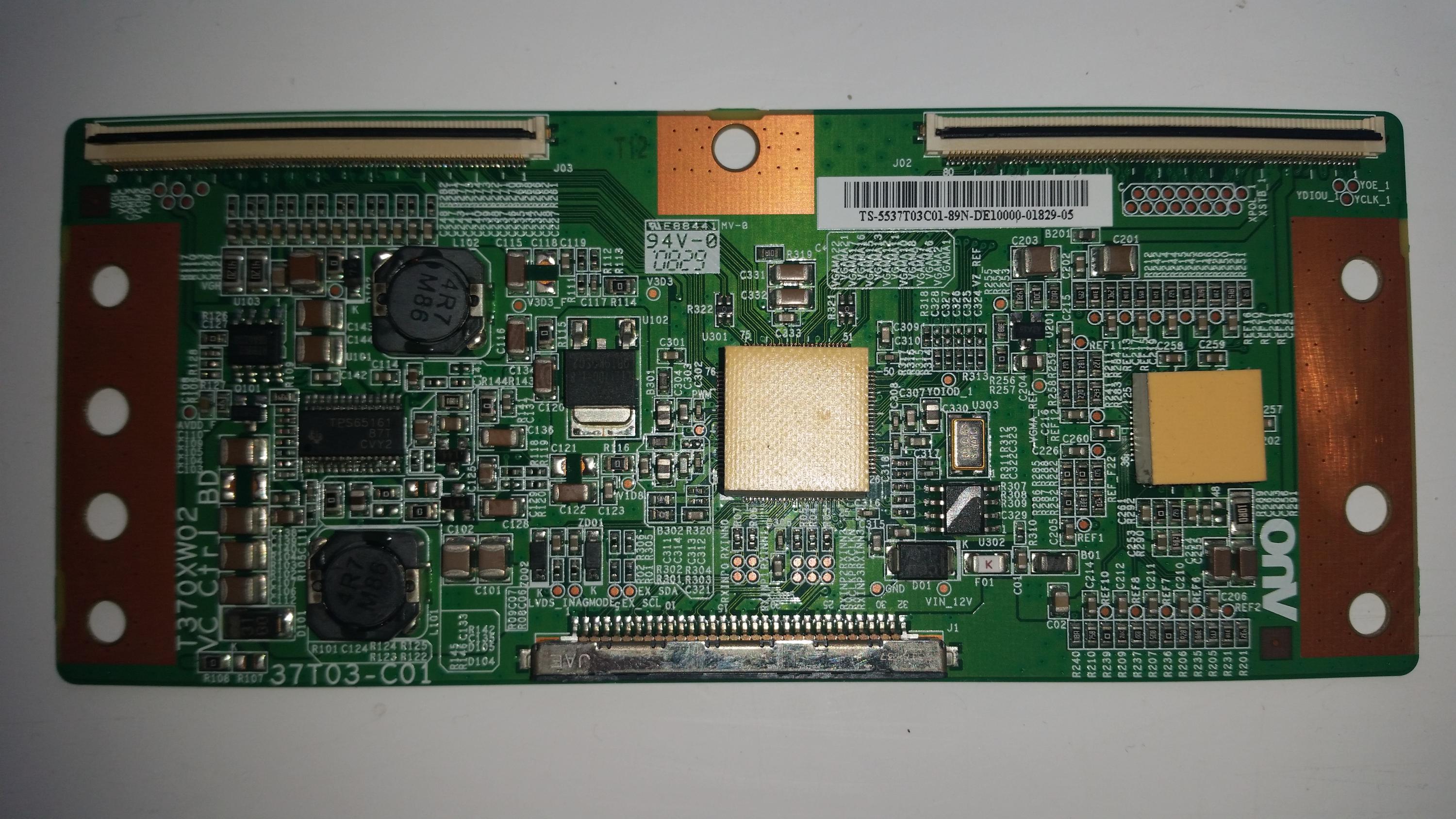

      im collecting hopefully tommorow so ill update a picture then
        picture attached
          OK you can see the block of test points marked VGAMA1...VGAMA2... etc.? With board installed & TV displaying image, test voltage on each point. Red on test point, black on chassis, 20V DC range.
          • sordids999
            • May 2013
            • 2161
            • uk
            VGAMMA 1 0.15
            VGAMMA 2 1.63
            VGAMMA 6 1.54
            VGAMMA 7 15.5
            VGAMMA 8 13.9
            VGAMMA 10 14.0
            VGAMMA 11 1.43
            VGAMMA 12 7.75
            VGAMMA 13 6.42
            VGAMMA 15 4.69
            VGAMMA 16 4.43
            VGAMMA 17 6.89
            VGAMMA 21 0.35
            VGAMMA 22 0.47
            so faulty it is tom
              Yep, replacing that ought to fix the issue.
