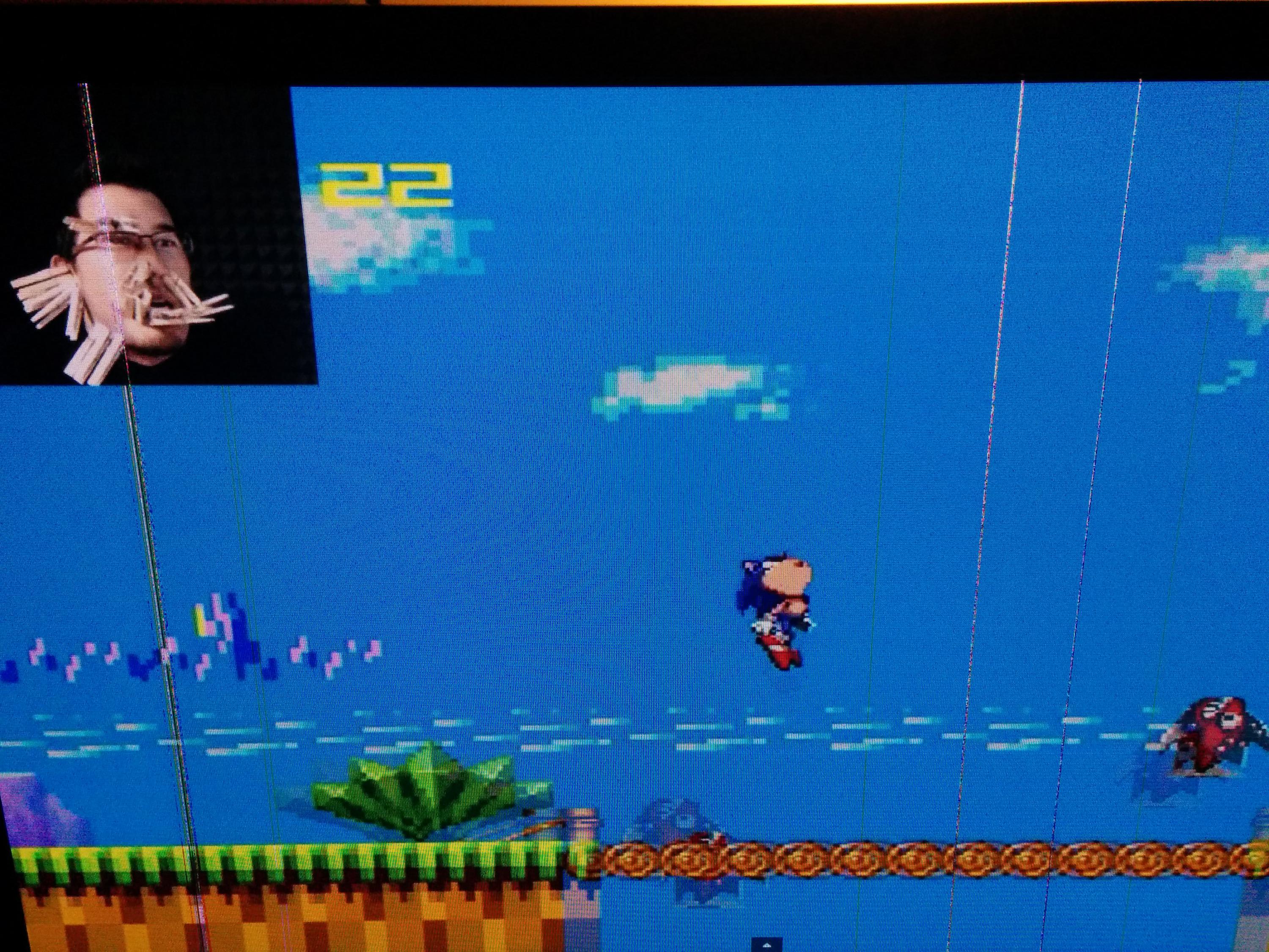

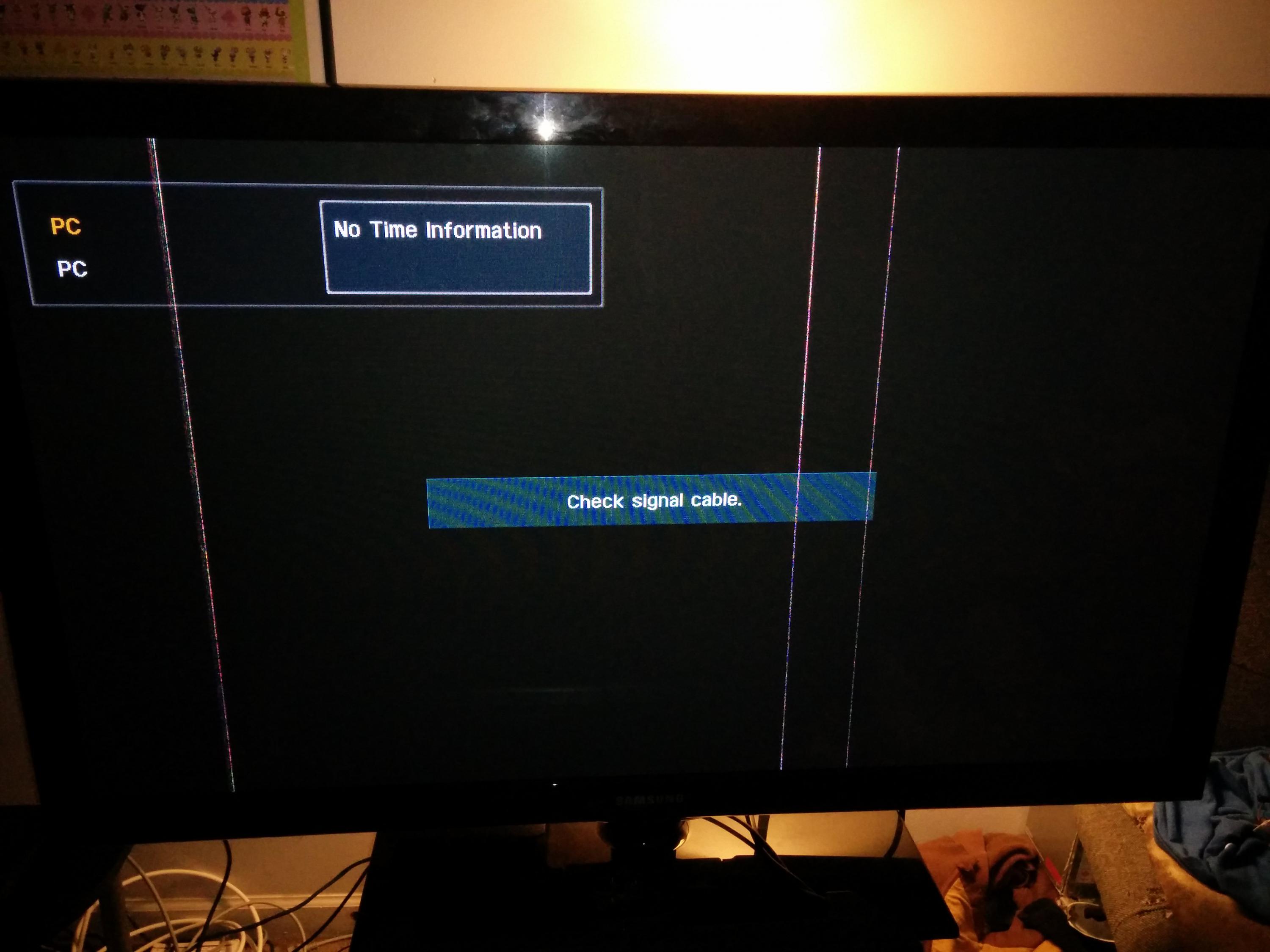

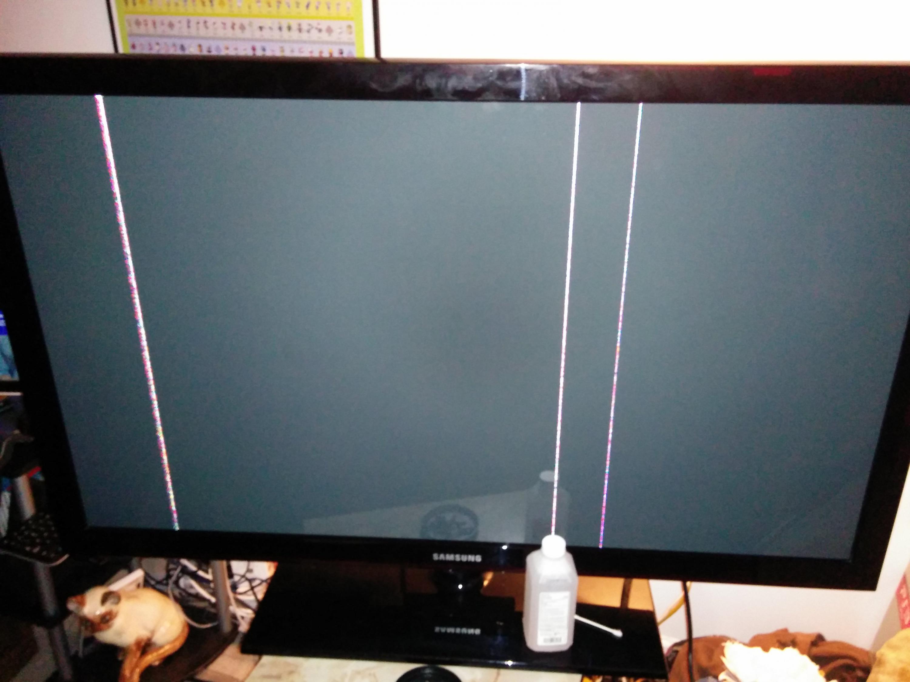

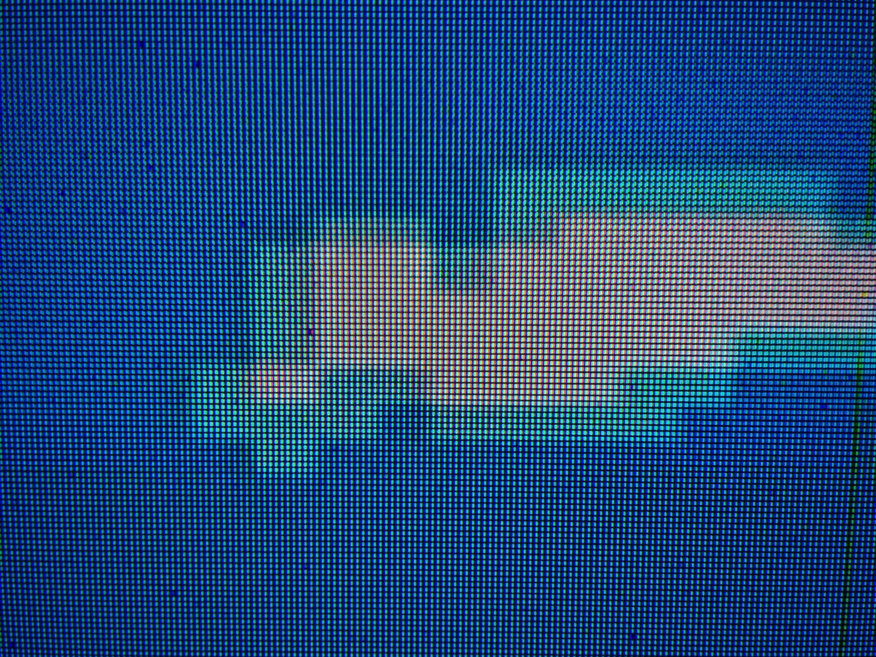

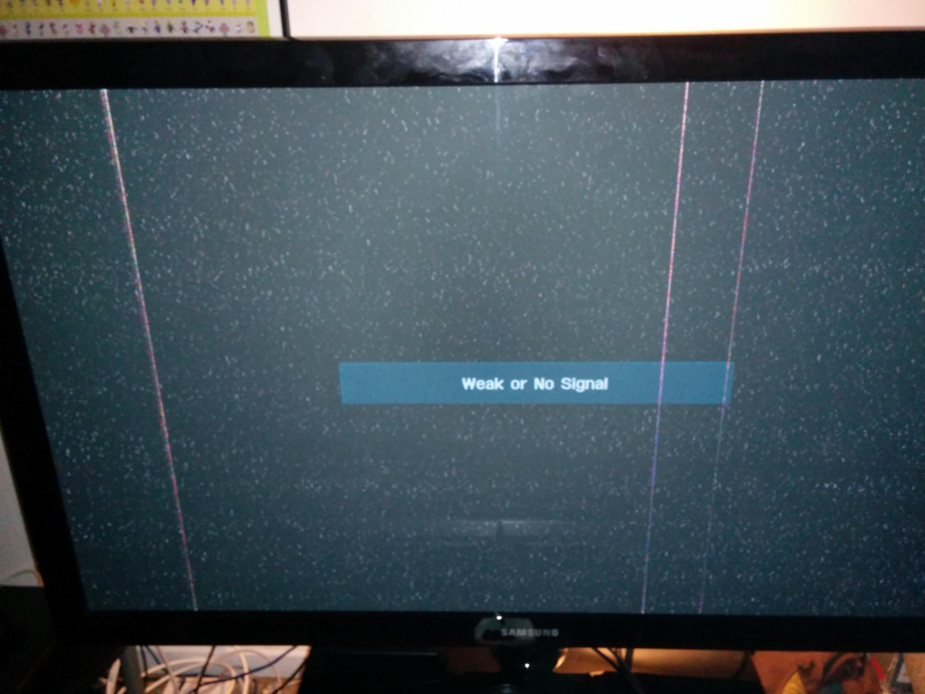

Hello all I recently bought a Samsung 50 inch plasma from a friend because he described a y main board issue but now I look and see burn in a can't fix and sometimes the sides of my screen when I open my on screen keyboard the sides get dimmer suggesting to me that the plasma panel is dying. I also hear a cap buzzing as well as rbg snow and the TV clicks when it turns on. I Dont care if the plasma panel lives its all good but should I fix the other problems? Hopefully someone can help thank you for reading
pn50c450b1dxza problems
Re: pn50c450b1dxza problems
Sorry, that's a bad plasma panel there, it isn't going to be fixable. The dead pixels would be fixable, but the vertical lines aren't. It's pretty common on C-series Samsung plasmas.
Where you see the screen dim on bright scenes is normal for the technology. It is called Automatic Brightness Limiting. CRT TVs and monitors had it too. Any emissive technology (like plasma) will...
Clicking when turning on is normal, as is a slight buzz in operation (should not be audible from ordinary distance.)
It's not burn in... it's just a crap panel... Samsung are well known for their panel issues... mostly on their LED-LCD TVs but also on plasma.Last edited by tom66; 09-03-2014, 08:01 AM.Please do not PM me with questions! Questions via PM will not be answered. Post on the forums instead!
