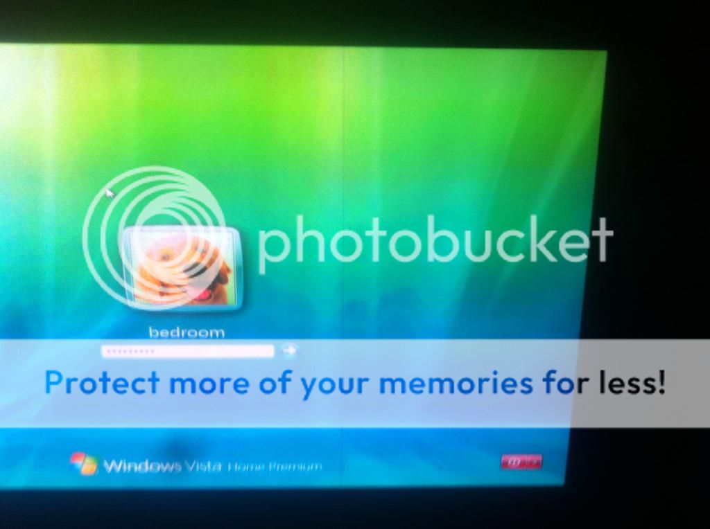

    Yesterday I noticed a fine line on my plasma is this a bad panel or does a ribbon need reseating? [/URL][/IMG]
    Re: 50ps3000 bad panel?
    Bad panel... happens sometimes with these unfortunately. (LG plasmas have higher panel failure rates than any other manufacturers.)
      Really....??
      Ive not ever had a properly duff one yet--while Ive had loads of Samsung Plasma panels stuffed one way or another! (I don't count the Mal-Discharge issue which is curable more or less....)
      There's pretty much no doubt in the case above however, its the panel/COF/Tab issue....
      TELEFIX
        Just from what I've seen, new LG panels dying with vertical line > Samsung panel >>> Panasonic panel.
        For older models, they are pretty good though. It's the newer models that are worse.
