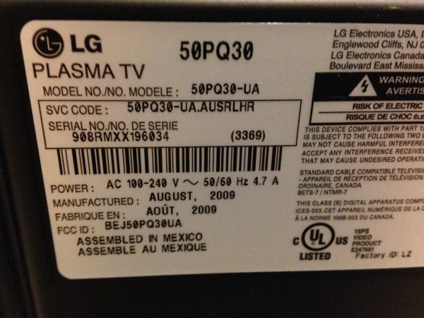

    Lg 50pq30

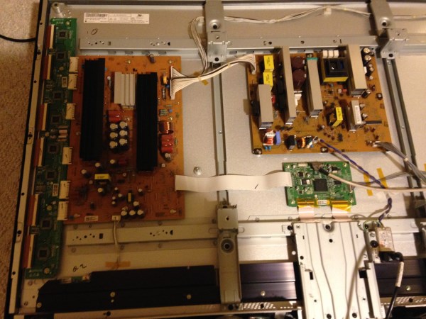

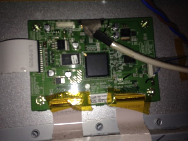

    I got this one for free and trying to figure out how to solve the no video. I turn it on and the light goes to blue and then flashes blue and then turns red. I hear the relay kick on and then clicks again.
    I am not sure where to start checking. I can make a small video if you would like . Here is the pictures and going to include manual.
    Oh there is no video at all. Which i am sure you know.

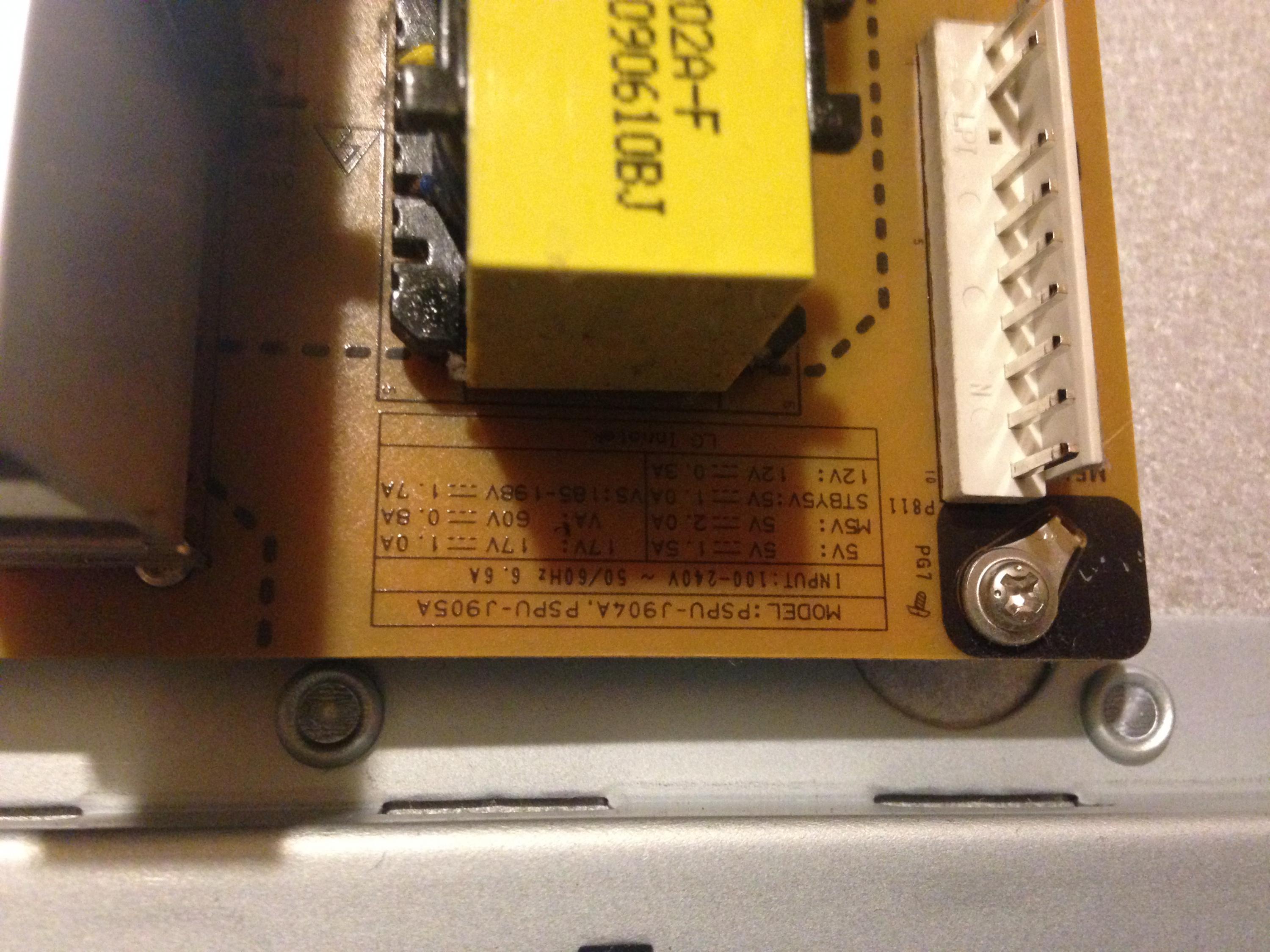

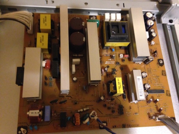

        I have taken some voltages on the power supply. If I unplug point 1 and take voltages I have the following voltages.
        VS = 193 V
        VA = 59.5 V
        M5V = 0 V
        FUSE 801 =320
        If i plug in point 1 then fuse 801 goes to 123 volts. I assume that is standbye . Also with point 1 unplugged the light stays blue on front. So i assume only with a load I have issues ? I seen in the manual I should make two 100 watt light bulb in series and go to pin 1 and pin 4 . But I am not sure if that is right or how to do it.
        I hope that helps. Not sure where to go next.

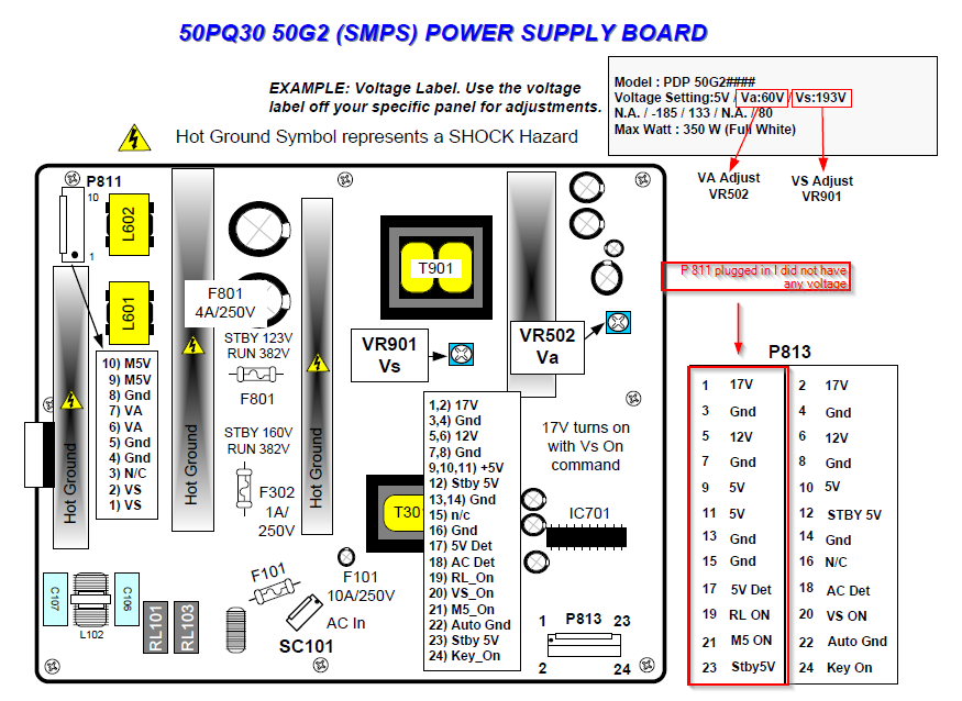

          Here is a pic of what the board says the voltages should be.

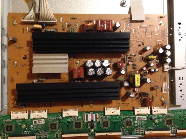

                  I have gotten some more voltages which i thought was odd. At the connector going from the power supply board to the main board I have some of the voltages. That connector is p813. I have the voltages not in the red square.
                  Then i have voltages if i unplug the connector p811. P811 is going from power supply board to the ysus board. I then and only then get the rest of the voltages in the red square. If i leave the ysus plugged up I do not get those voltages in the red square.
                  Please let me know how else i can help and if i need better pictures. I find it odd i have no voltages until i unpug the ysus board.

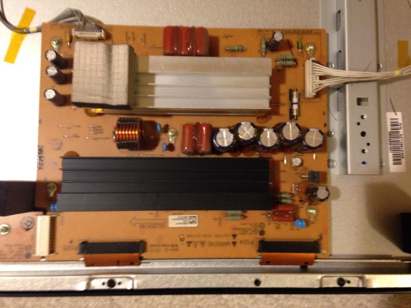

                  Not sure what else i can give to help. I am not sure which board is bad and which one to replace. I did try to unplug the zsus board and those voltages did not show up in the red. So i do not know which board to replace or how to test ysus board and zsus board . Who knows i might be on the wrong track and please correct me if i am wrong. I always love learning . I am at a loss. I will wait to hear from smarter people.
                  I have included a pic to help show what i am getting. The voltages are almost on the dot too.

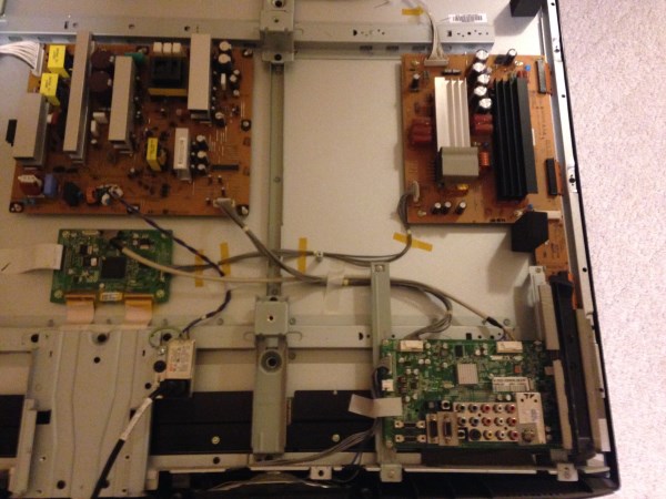

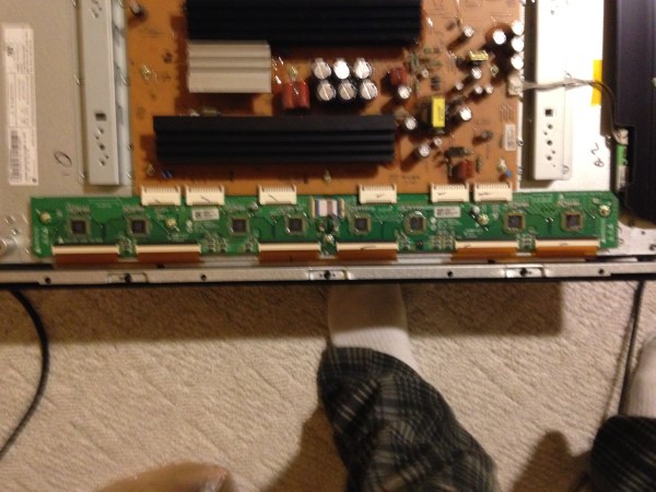

                    It probably your upper y buffer that is bad. I had an LG50PG20 doing the exact same thing, and it was the upper buffer board. LG's have a lot of issues with the buffer boards going bad. carefully remove your upper buffer board, turn on set and see if you get half a screen. I'm no authority by any means, but with the help of a few guys on here I fixed a few plasma's My LG I tore the ribbon cable going to the Panel, so be careful. If you damage it, its scrap!

                        If you disconnected the cable going to y- sus and you got your voltages back, then your y sus is probably the problem, or y buffer. Now you have to determine whether your y sus is good. If your VSC is to panel label voltage. then y-sus is good and buffer is problem. Go to Quick links and put in LG 50PG20 Plasma tv, and follow the instructions there.

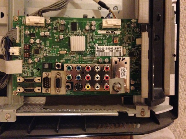

                              I got the boards in and replace the Ysus board and buffer boards. I had sound come on and it was static. I was like well this is a good sign and then it went back out again. Now i am back to nothing. Not sure where to look. I am still missing the m5v. I can uplug the ysus board and get most of my voltages back except m5v. I am not sure if this is a bad part or not.

                                  I got a new mainboard in today and same issue. I am still missing the m5v. I am wondering if it was the power supply. I tried to invite tom66 but have not heard from him. UGH . The tv that will not turn on.
