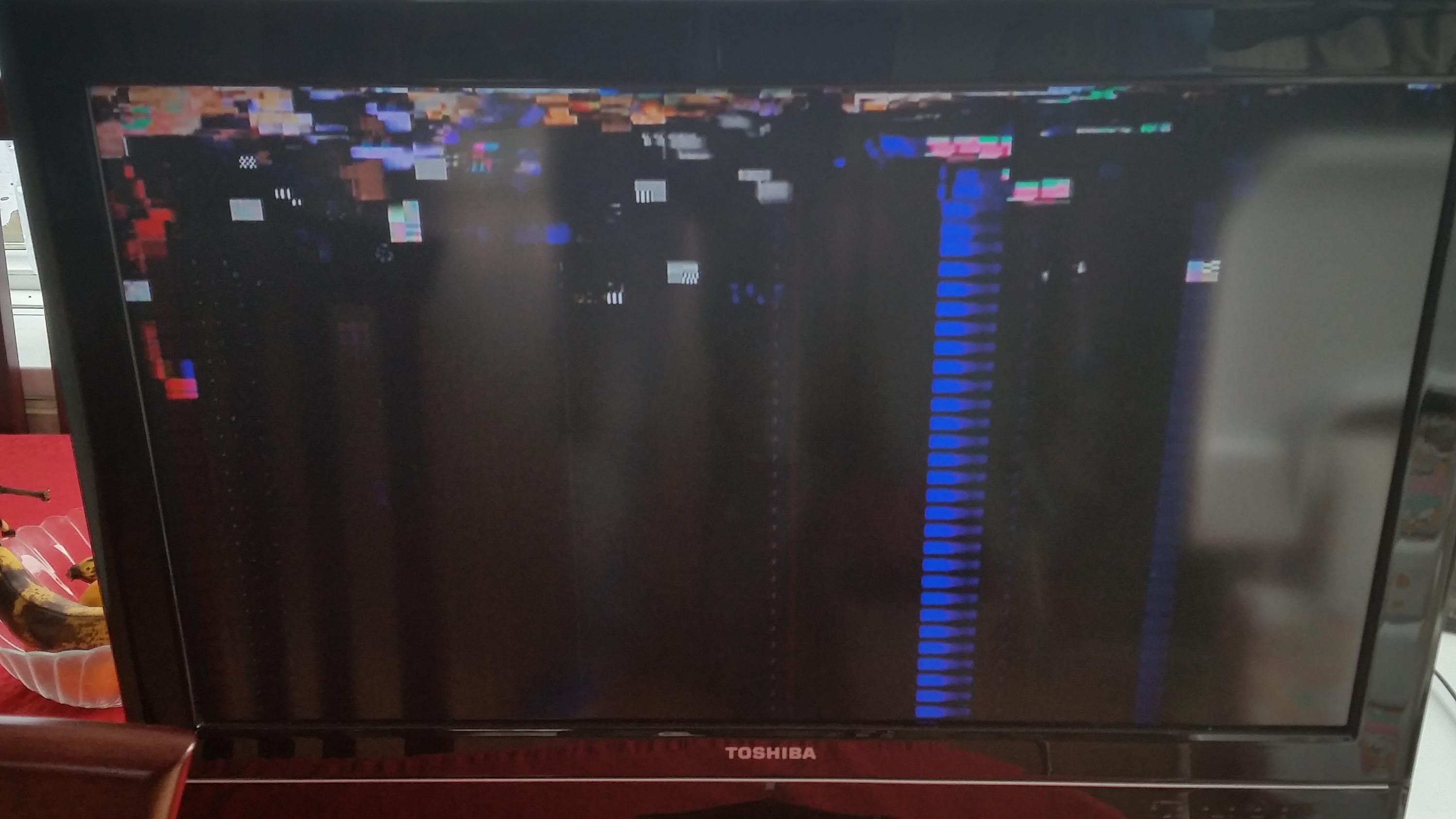

    hello
    testing this tv at the moment HD,SCART is fine but freeview im getting this picture problem its on all free view channels,has anyone had this problem before ?
    thanks
    p.s ive attached a video of the fault

    To me, that just looks like a weak signal. Vestel sets aren't well known for their excellent tuners. Have you retuned the TV?

      yes tom i have tried everything retuned etc

        i have tried a second tv on the aerial and thats fine tom
          Re: Toshiba 32bv801b
          What does the signal meter in the menu show?

            the signal is showing good i have another lg 32 just tried thats working fine on DTV

              just this picture now is the best i can get
                That is just poor MPEG signal. Maybe try a software update? It could be just a limitation of this TV, if your signal quality in your area is poor. These Vestels usually have basic tuners that don't work great with weak or poor signals.

                  how or where can i software update this tom ?

                    Previous updates for the Toshiba 32BV801B are as follows:
                    Firmware V0.57
                    im on that now
                      Does it occur on all channels?

                        yes on all DTV channels
                          Is the PSU a 17PW25-4? Maybe bad tuning voltage if 33V low or missing..hmm.

                            yes tom 17pw25-4
                              Unfortunately, I thought it used 33V tuner but it does not. So I don't know, sorry. I still think it is normal for a Junky Vestel...
