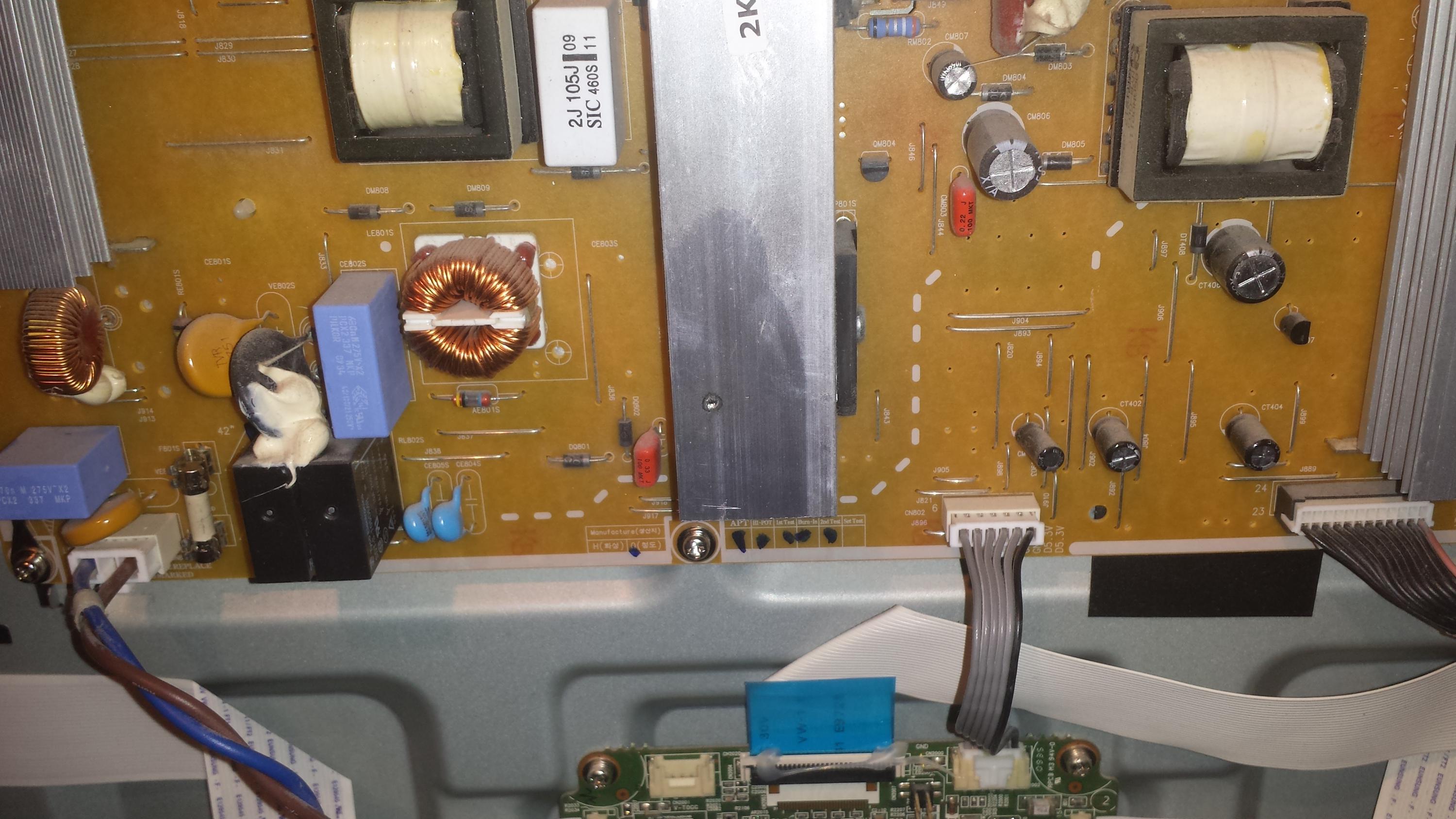

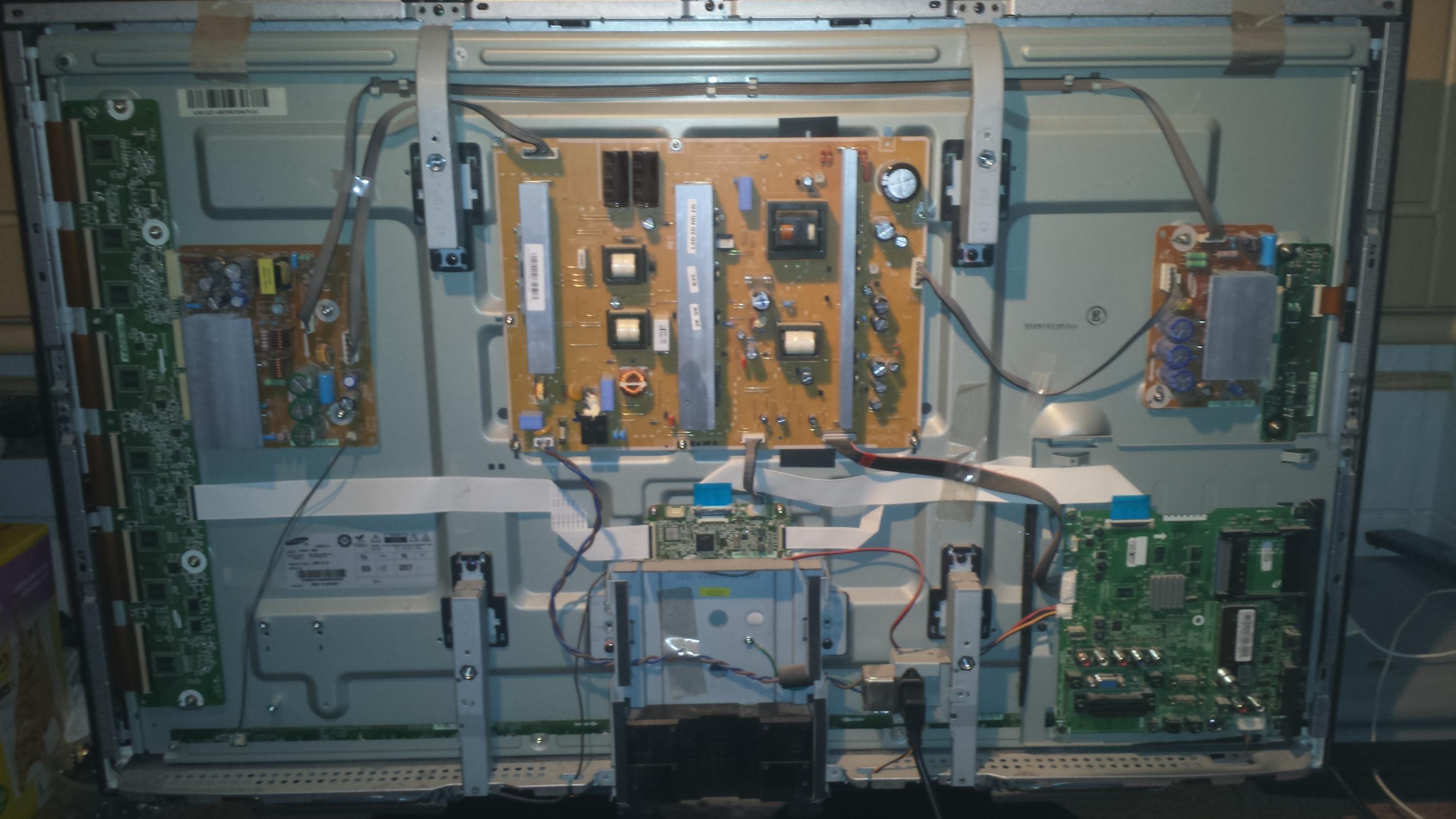

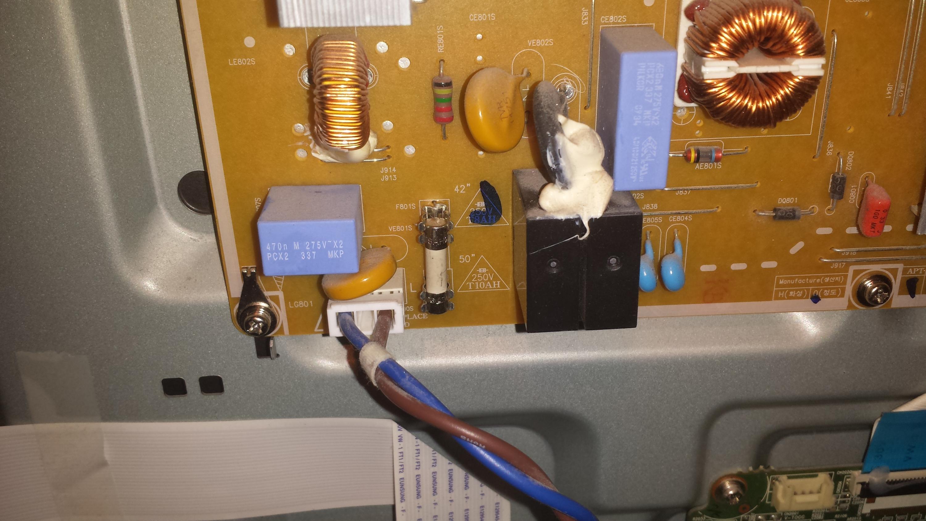

    Ok got this tv today totally dead found the fuse bottom left on the psu had blown changed it and had a popping noise round that area when I tried to turn the tv on
    Any ideas

    By the way if you look at the heat sink it seems there has been some sort of arcing it's inside also on the back cover
      Re: samsung PS42B450B
      Fuse popping - check bridge rectifier, MOSFETs on heatsink, etc.

          Try removing other fuse on PSU and just leaving main one on.
          Also do you have a bulb tester/lamp tester jig for testing PSUs built yet?
          ...Wait, is the fuse actually blowing or not?

            Hi tom yes I got one made at work but it's still there and it blew the trip switch in the house but the fuses in the psu are still ok

              hi tom i have checked the bridge rectifier thats shorted im in the process of trying to find a replacement board anyway thanks

                Tested bridge rectifier which was shorted luckily had another on a previous board tv working at the moment so testing at the present moment......
