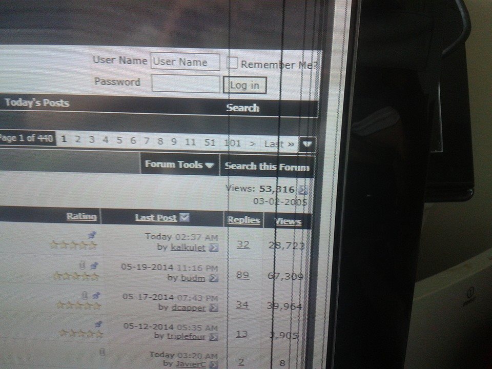

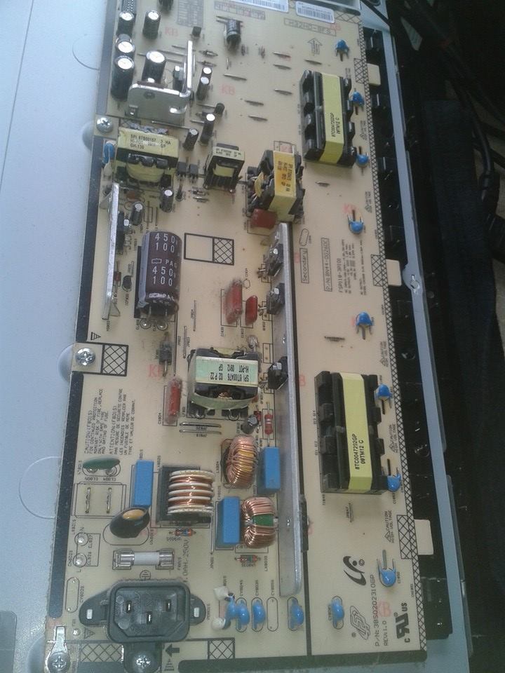

    Hi I got this Samsung LE32B450C4W Its got some vertical lines down the left side of the screen see pic. the power supply is one of those power/inverter combo type so don't want to pull it out unless I have to.

    the good news is you wont have to.
    the bad news is i suspect that's the panel - specially as it's in the corner
    that's the right btw, not the left!

      Might be the ribbon cable going to the panel as it ok when it first comes on. Goes funny after about 5 mins when switched on.
        Re: samsung LE32B450C4W
        almost certainly bad panel there.

            you may restore it if your lucky,
            it may be a poor connection on the ribbon from the glass to the panel-pcb.
            if it is, puting a bit of foam between the cable & case to apply presure may help.
              I will give that a go, thanks stj. If it works ill post some pics.
