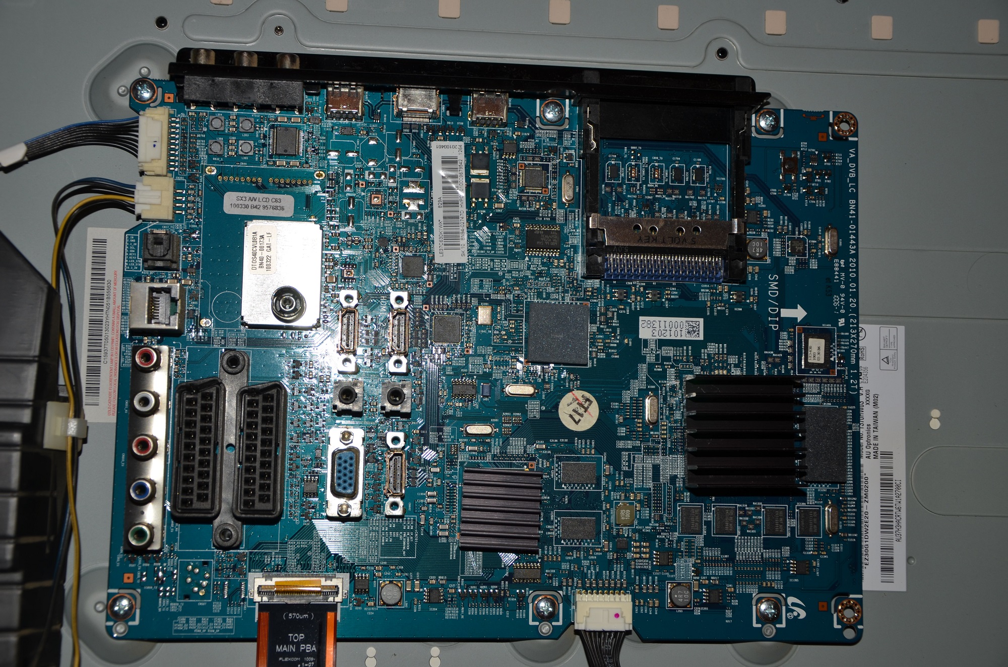

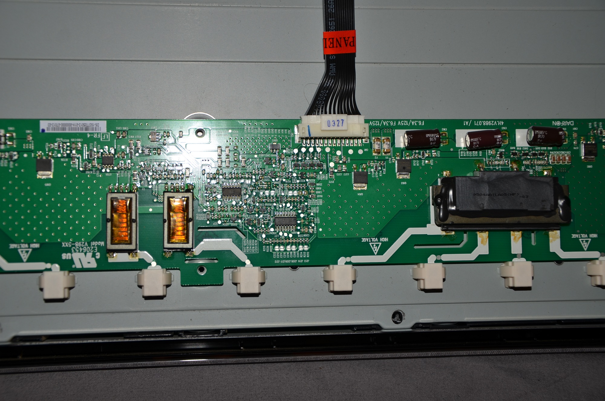

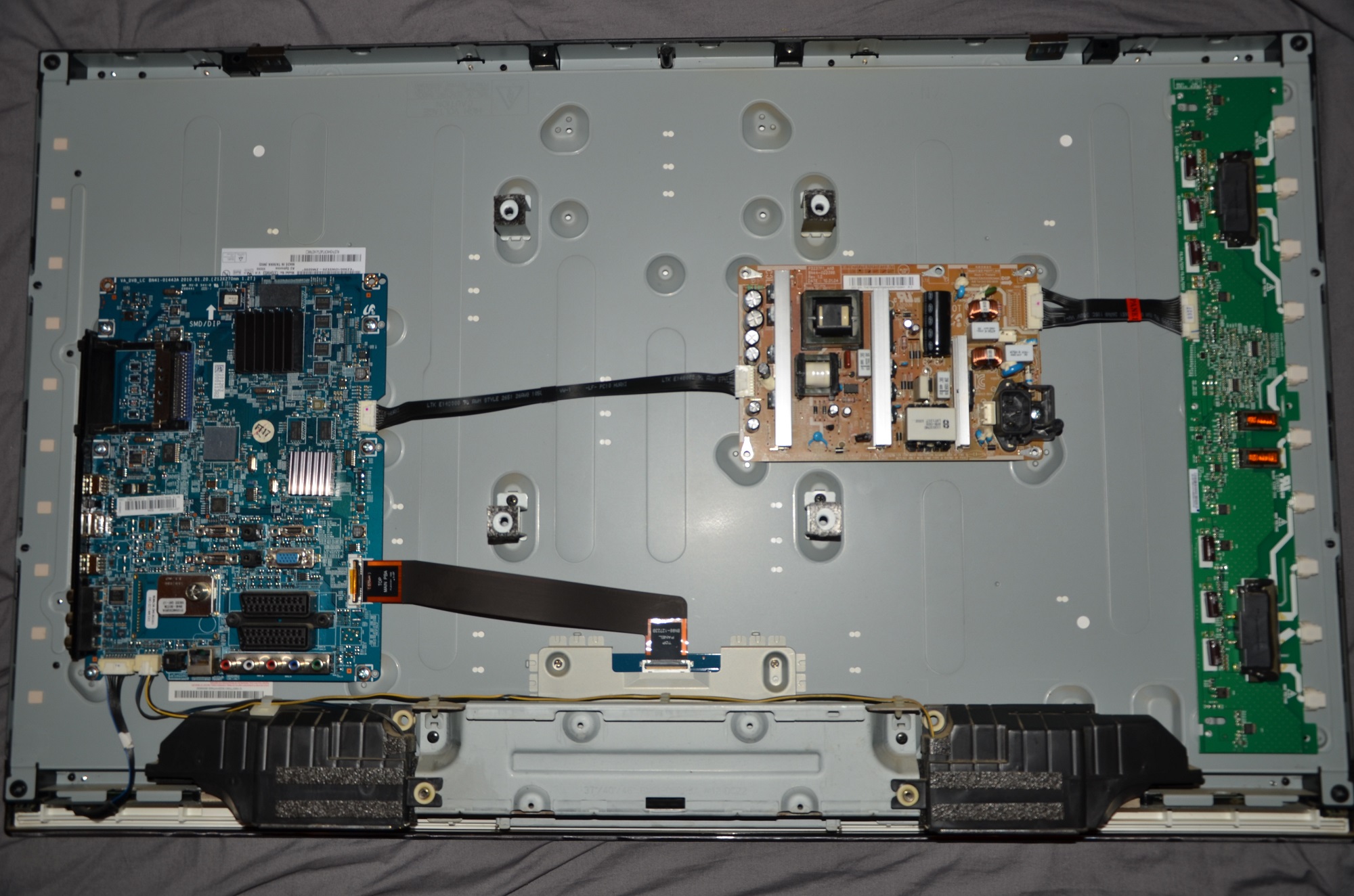

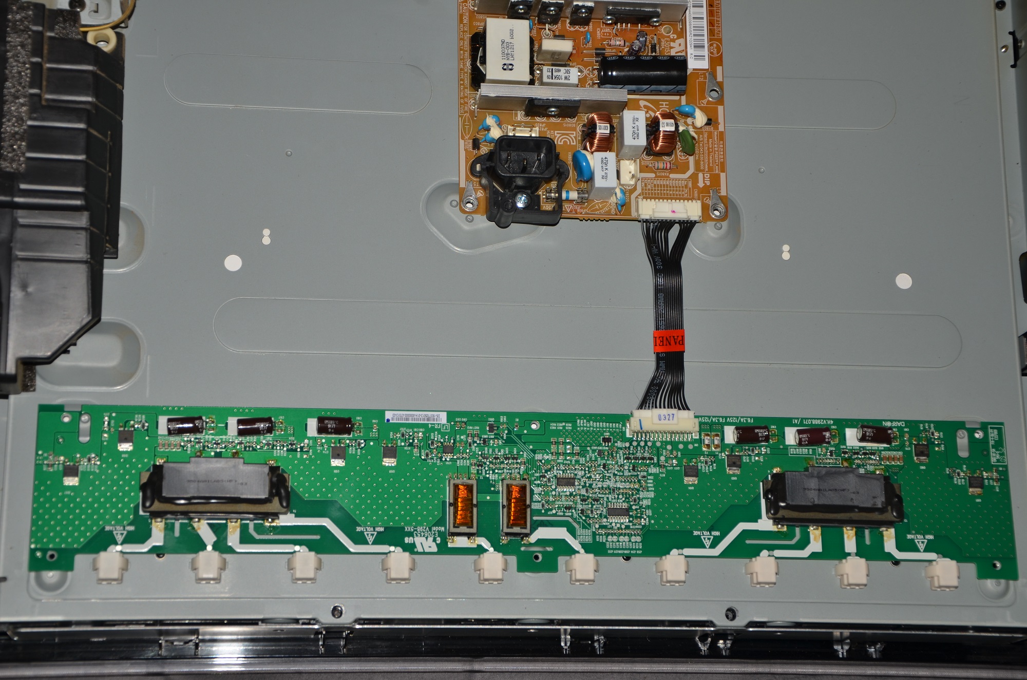

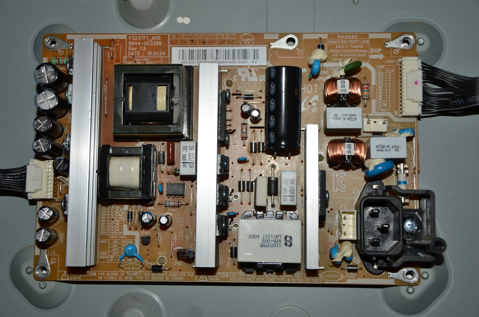

    clear pictures of the boards from the back of the tv might help
    • JavierC
      • May 2014
      • 11
      • España
      Re: Samsung LE37C630K1W - Random power on
      There you go

            Today I went back to my repair project. After a few days disconnected, the TV started on the first attempt. I Actually managed to turn it on and off some 5 times,and took a few more measures. But then the problem came back.
            With the TV on, the inverter board makes a buzzing noise, which I believe is louder than it should be. Couldn´t identify which of the inverter transformers is the culprit of the noise though.
            The electrolytic capacitors on the inverter board measured the same voltage, around 20 V when the TV worked fine.
            The resistance on the inverter transformers secondary is (From Pic 5):
            Bottom right transformer 1,2K 1,2 K
            Bottom middle tTransfromers 2,47K
            Bottom left transformer 1,16K 1,16 K
            Does the middle transformers have a higher resistance for any specific reason? Is the bulb they feed different from the others?

              I re-soldered the joints of the transformers and MosFETS of the Inverter board, and now the TV turns on more frequently. Sometimes Tv starts at the first attempt, other times the backlight blinks two or three times during the startup cycle, and eventually stays on
              I took some more measures and found that with the Power Supply board disconnected from the Main and Inverter boards, there are 1,2 Volts on the INV_ERR pin. Shouldn´t this be 0V ?
              Then, when I connect the Main and Inverter Boards, and plug in the TV to the mains, INV_ERR measures 1,8V for a couple of seconds, while the backlight is still off, and when the backlight turns on , it drops to 0,7 V and stays there.
              Is probably QM802 (MMBT2222A) on the Power board not working properly? How can I test this?
              Regards,
              • JavierC
                • May 2014
                • 11
                • España
                Today I decided to do some more testings on my TV.
                With the Power board only connected to the Inverter, and not he Main, I disconnected the INV_ERR cable from the ribbon and didn´t connect it to anything.
                Then I plugged the Power board to the mains, and could verify that the INV_ERR pin on the Inverter side measures 0V, but the same pin on the Power board measures 1,2V.
                Which means the problem is definitely on the Power board.
                Now, from here I´m lost. What should I do next?
                Any help would be appreciated.

                    After reading some PDFs about diagnosing PSU and LCD TVs, and studying some basics about switching power supply, and after analysing the PSU schematics, I think the problem could be the Half-Bridge Resonant Converter, which is the FSFR1700US.
                    Have anyone experienced a problem with this power switch before?
