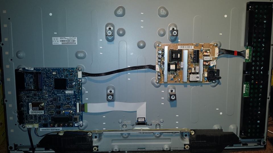

    Samsung le37c550
    TV restarts itself any ideas guys checked voltages
    PIN 14 24V =24.7V
    PIN 13 24V =24.7V
    PIN 12 24V =24.7V
    PIN 11 24V =24.7V
    PIN 10 24V =24.7V
    PIN 9 GND
    PIN 8 GND
    PIN 7 GND
    PIN 6 GND
    PIN 5 GND
    PIN 4 INV-ERR
    PIN 3 BLU-ON 5.19V
    PIN 2 NC 7.99V
    PIN 1 EWPM
    PIN 1 13V =12.19V
    PIN 2 5V-DET
    PIN 3 13V =12.19
    PIN 4 BLU-ON 5.19V
    PIN 5 13V =12.19
    PIN 6 E-PWM
    PIN 7 GND
    PIN 8 H-SYNC =2.19V
    PIN 9 GND
    PIN 10 GND
    PIN 11 B5V =5.21V
    PIN 12 GND
    PIN 13 B5V =5.21V
    PIN 14 B5V =5.21V
    PIN 15 13V =12.19V
    PIN 16 A5V =5.21V
    PIN 17 13V =12.19V
    PIN 18 PSON =1.58V

    restarts itself........right away when it's still cold,or only after it ran for 15 minutes,or completely random...or.......restarts once and is fine for another period,or keeps restarting every 5 seconds....or.....???? lol..Kinda saying,we need a bit more info,as detailed as you can describe the fault...

      sorry got it today the guy told me it restarts im testing it now so....
        Re: Samsung le37c550
        Probably main board.
        • sordids999
          • May 2013
          • 2161
          • uk
          Resoldered the psu for cold solder joints been on all day at the moment so fingers crossed...........
