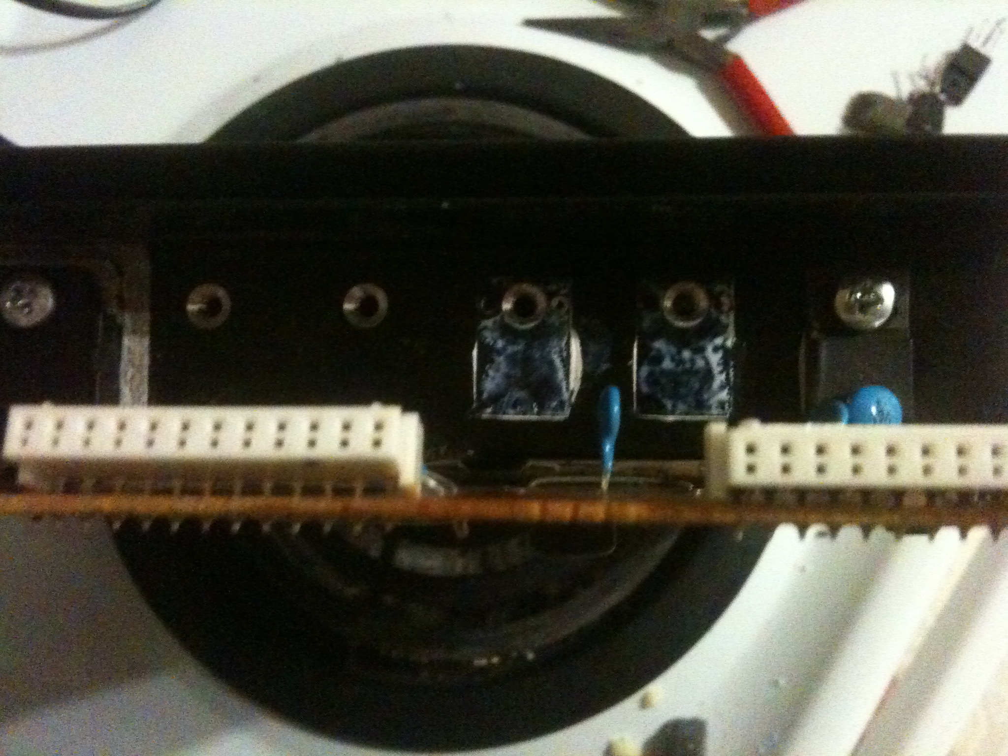

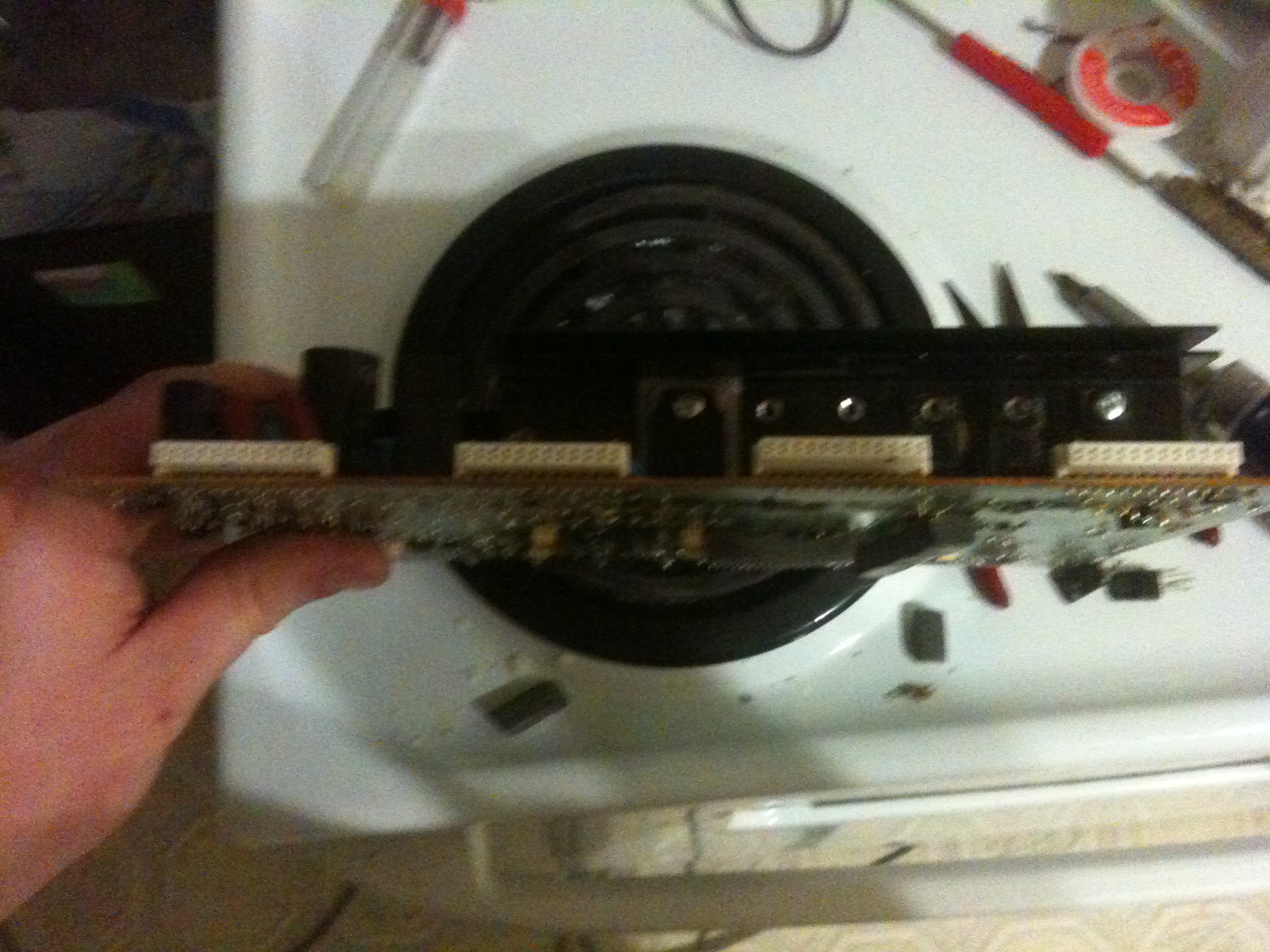

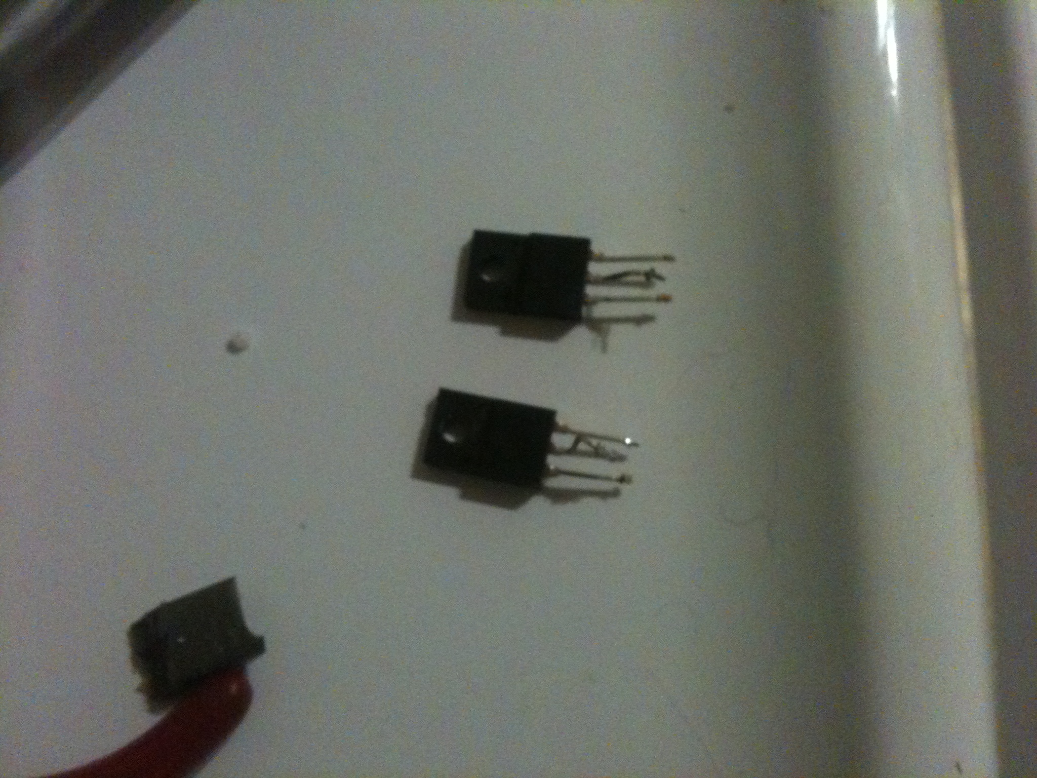

    Update: I traced the y-sustain short to 2x 30F123 mosfets, under the heatsink near where the y-buffer connects.
    I'm looking for replacements, but it appears china is the only source - I was hoping for a Canadian dealer so I could get the parts within days..
    If I can get the y-sustain fixed, I have the old semi-working y-buffer to put back in (until I can afford to replace with new ones).

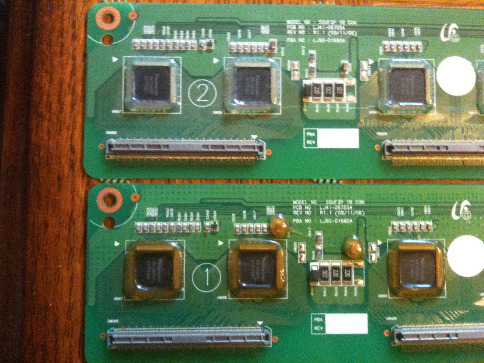

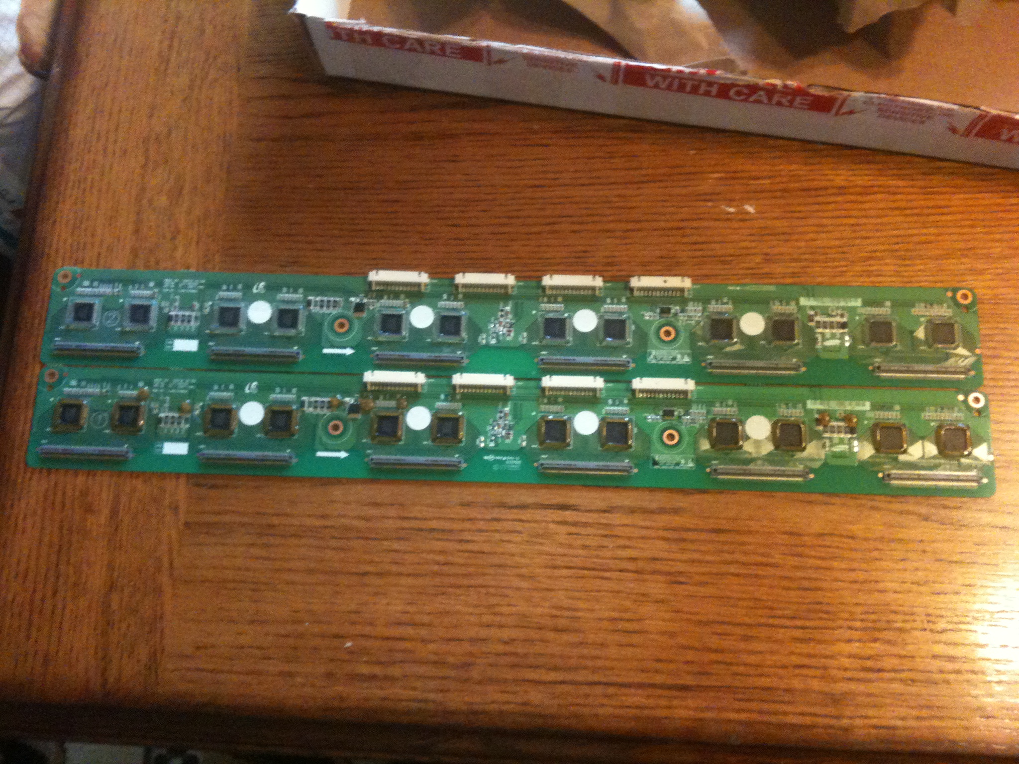

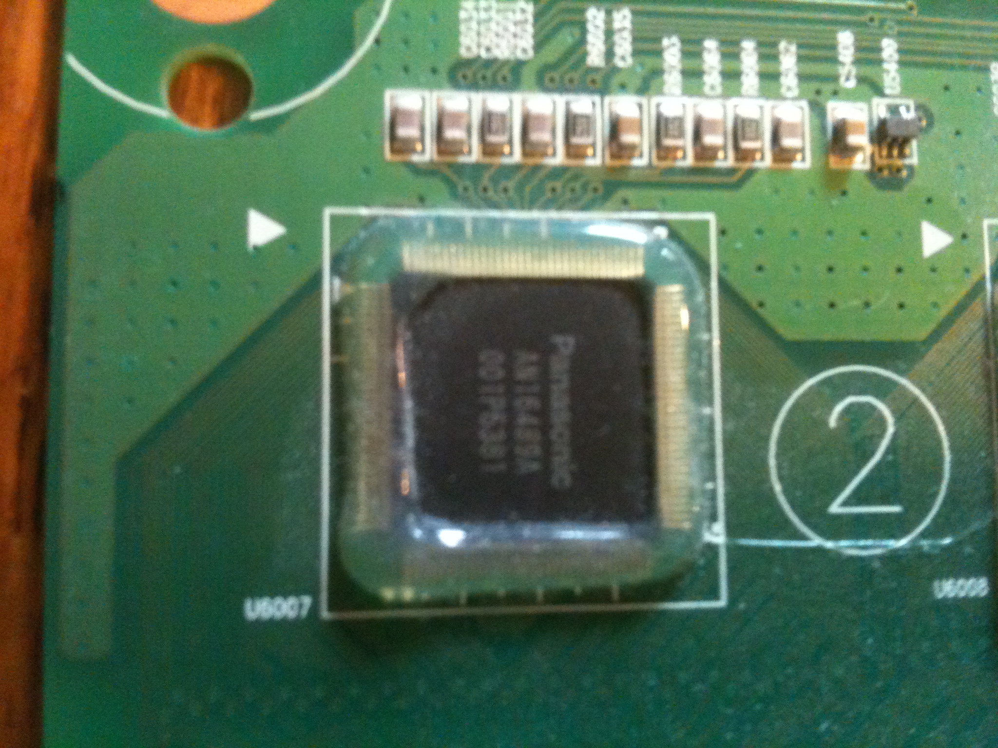

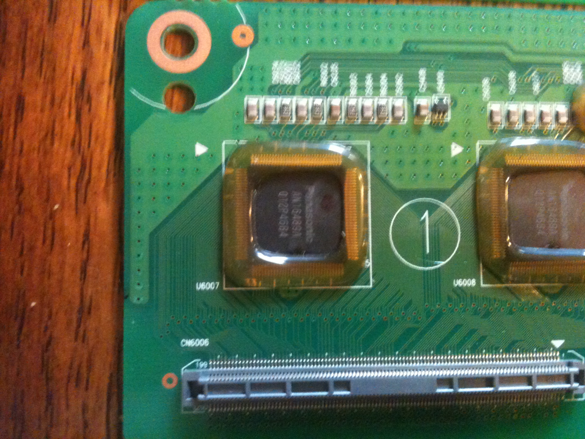

            Looking closely at the new buffer, it has a the same part and revisions, but it has the number "2" in a circle on the left, while the original has a number "1". Also the ICs are slightly different (the second set of numbers on the chips are different) and it looks like a refurb, because the chips are sealed with clear silicone, not that yellow glue.
            Here's the part numbers:
            Y-buffer
            Model No: 50UF2P YB CON
            PCB No: LJ41-06755A
            Rev No: R1.1 (09/11/06)
            PBA No: LJ92-01680A
            Buffer IC No: Panasonic AN16489A / 012P46B4

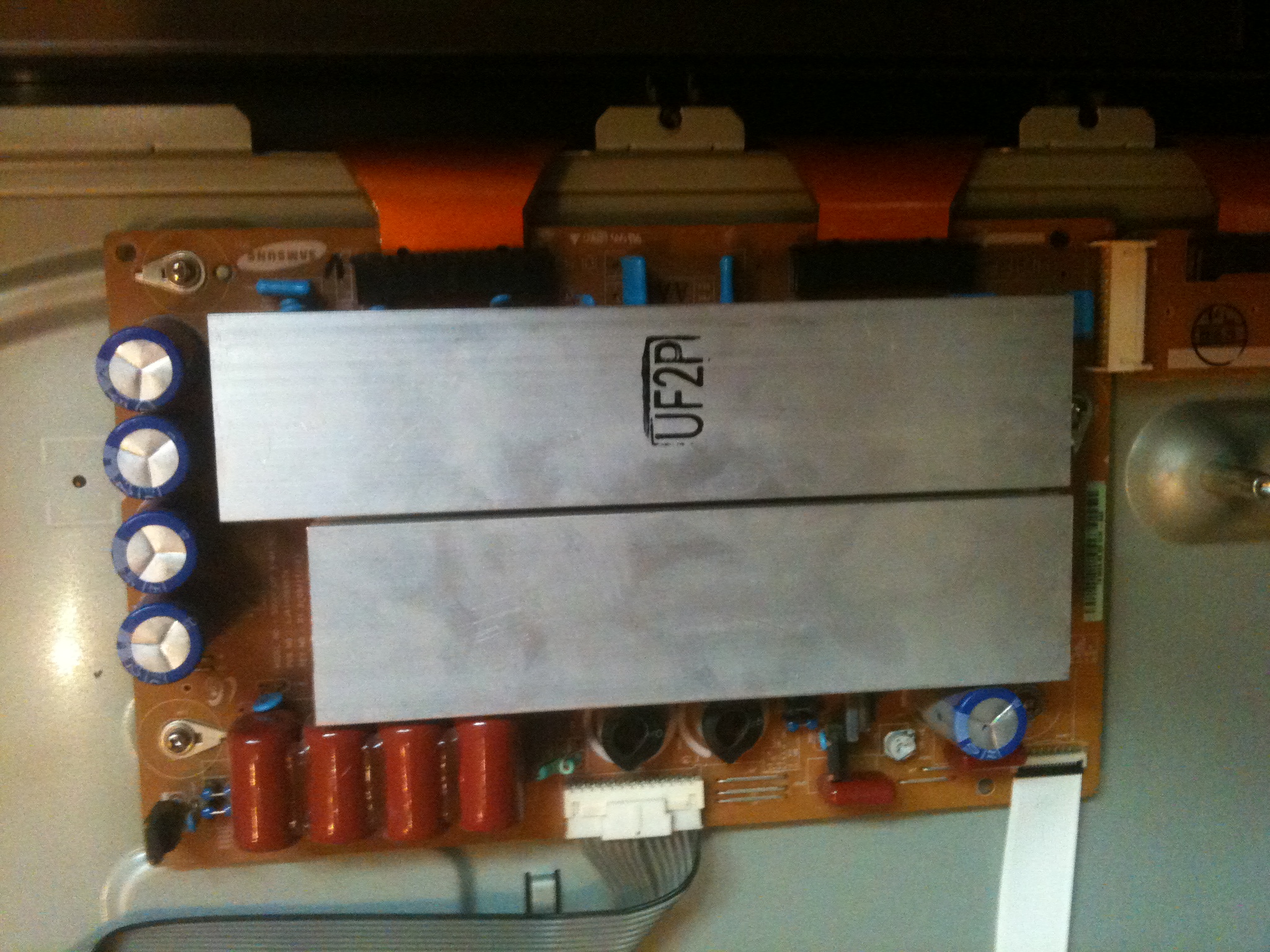

            X main:
            Model No: 50U(F)2P X-MAIN (1LAYER)
            PCB No: LJ41-08457A
            Rev No: R1.2 (09/11/18)

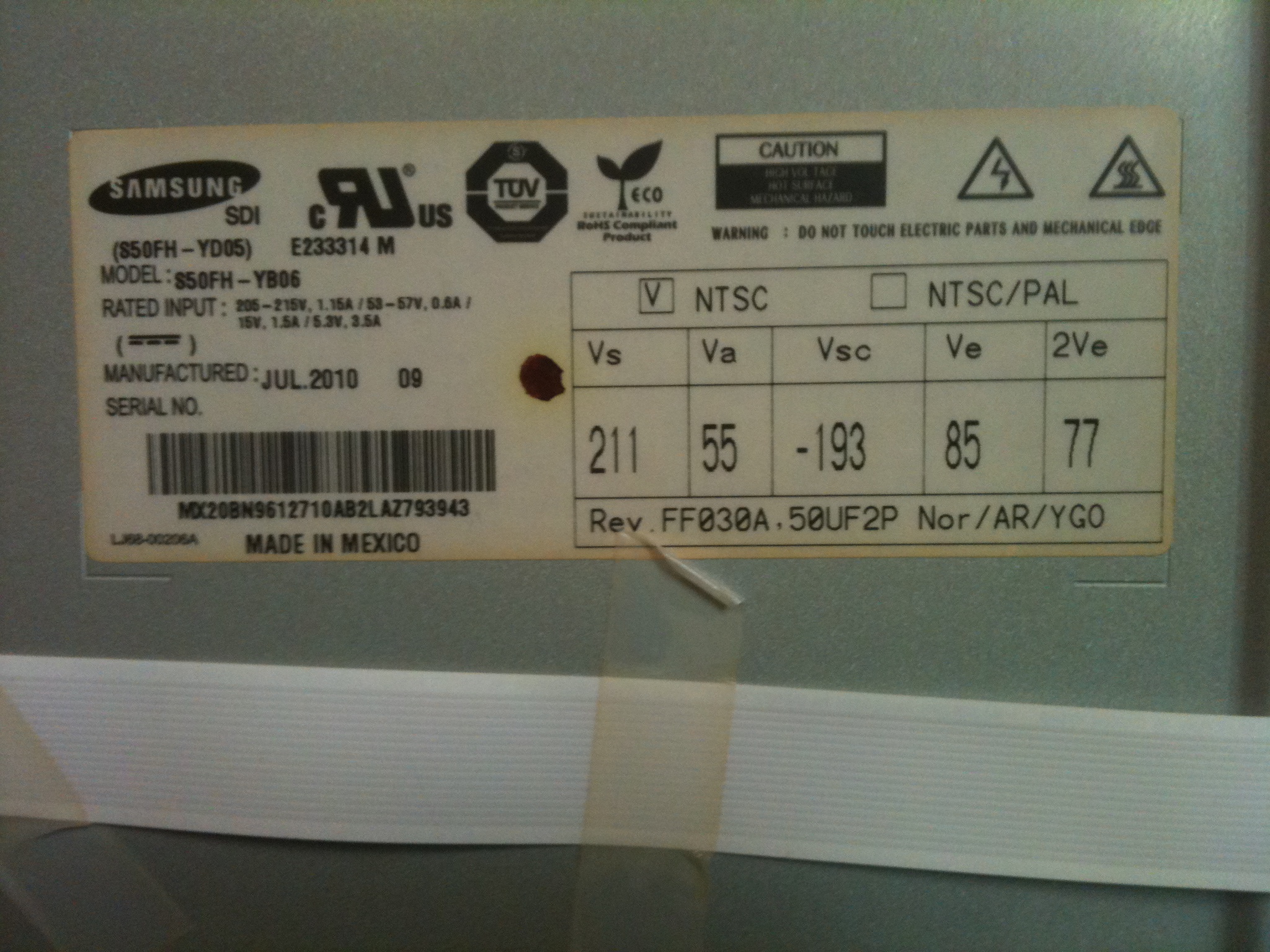

            PDP:
            Model: S50SH-YB06

              If I'm replacing Y main/buffer and X-main, should I replace the X buffer also ?
                Re: Samsung plasma PN50C550, fried Y-sus/buffer
                The X-buffer is just an extension board, no need to replace it. (It's a plane of copper with a single poly cap on it...)
                                  There's a definite difference between the LJ92-01729A (2010 dated)& LJ92-01680A(yours 2009), connectors and number of buffer ICs.
                                  The ribbon connectors on yours , is it still just a flat ribbon inserted and lever down action or plug type?
                                  your panel model is listed for the other buffer, but I'm starting to think that is a plug in connector on yours.
                                  Will have to be careful, looks like Samsung did a revision on these. I was going to use the panel model in SJ but unsure if their info is 100%
                                  This buffer is the same as your image
                                  http://www.paylesscomponents.com/sam...41-06755a.html
                                  I'm thinking this for the X
                                  http://www.paylesscomponents.com/sam...41-08457a.html
                                  This is one of the hardest TVs I've seen for cross referencing parts.
                                  On the X and Y boards, there's a green barcoded sticker, can we see that and some clear sharp shots of the x and Y boards.
                                  I'm hoping this is your Y board
                                  http://www.paylesscomponents.com/sam...41-08458a.html
