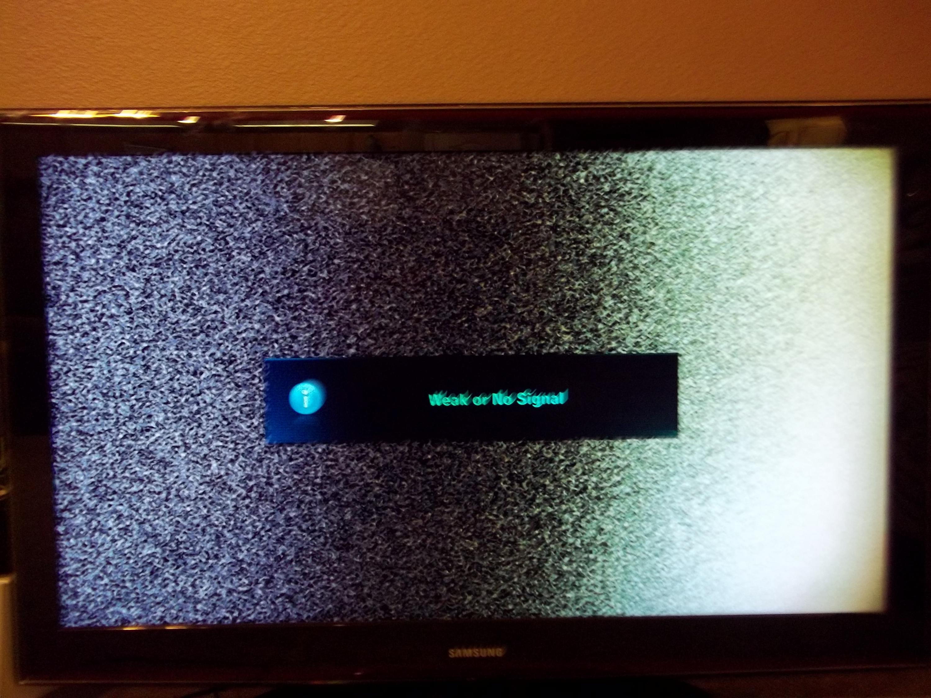

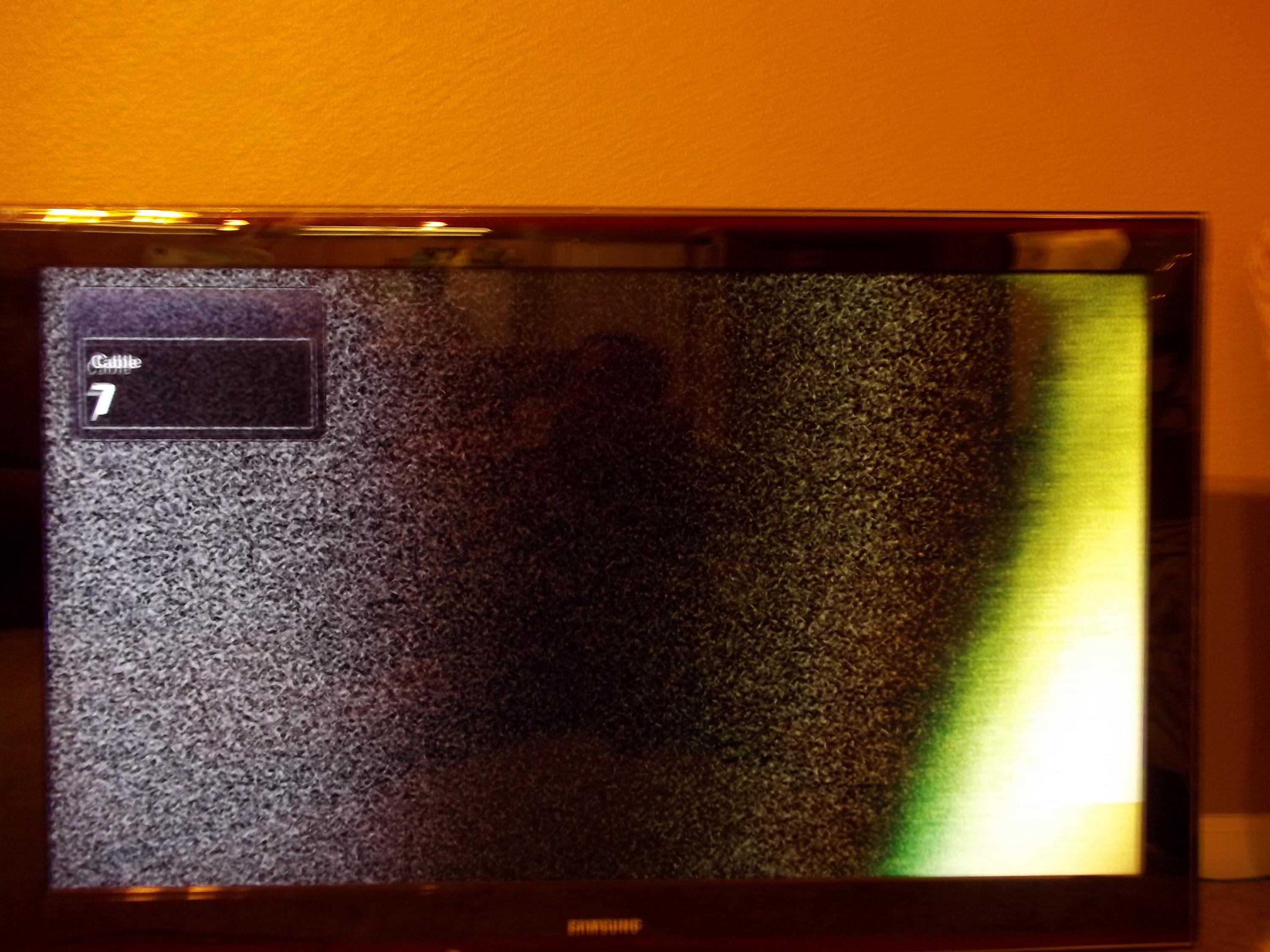

    samsung LN46A650A1F ghost and color issues
    have this samsung and after all the research it looks like either a tcon or tab issue. thought I would post a video to show what it is doing hoping for some confimation of which way to go with the repair..
  • Glitcher
    • Mar 2013
    • 673
    • USa
    Re: samsung LN46A650A1F ghost and color issues
    I would say tab bond issue.
      Agreed, at least on 46" panels it's not too hard to fix.
      • hamptons5
        • Apr 2014
        • 6
        Thanks, I was thinking the same thing after reading all the posts about Tab bond issues, I will try the heat sink pads that I have read about before I try the TCON. The TV was gave to me since they were going to throw it out so I figured I would try a couple of things to fix it. I have been able to repair a tv and projector in the past by using the forums and though I would give this one a try... Thanks for your thoughts on this....
