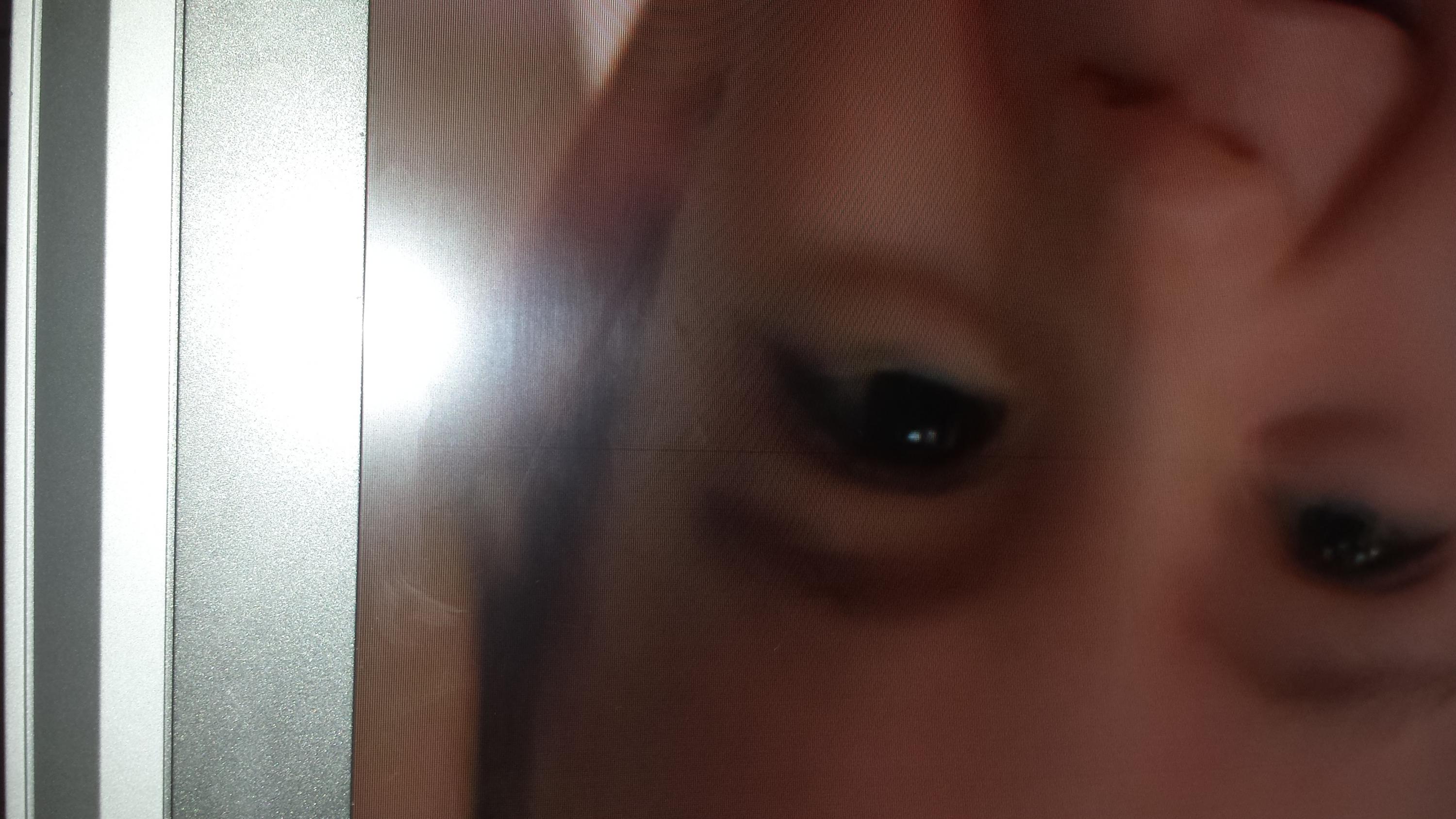

    Hi guys any idea what's causing this ?

                Just measured voltages on psu seem fine plus voltages on main board regulators but never tried a scart lead last night but I can get a picture which looks terrible with audio working but I'm still getting faint black horizontal lines about 2 of them going in the center of the screen

                  Picture of the fault...? HDMI affected too?

                    im not sure if you can see the black line theres about 4 of them and the same with hdmi
                      Re: Bush idlcd32tv22hd
                      Yeah, that looks like a bad panel to me there :/
