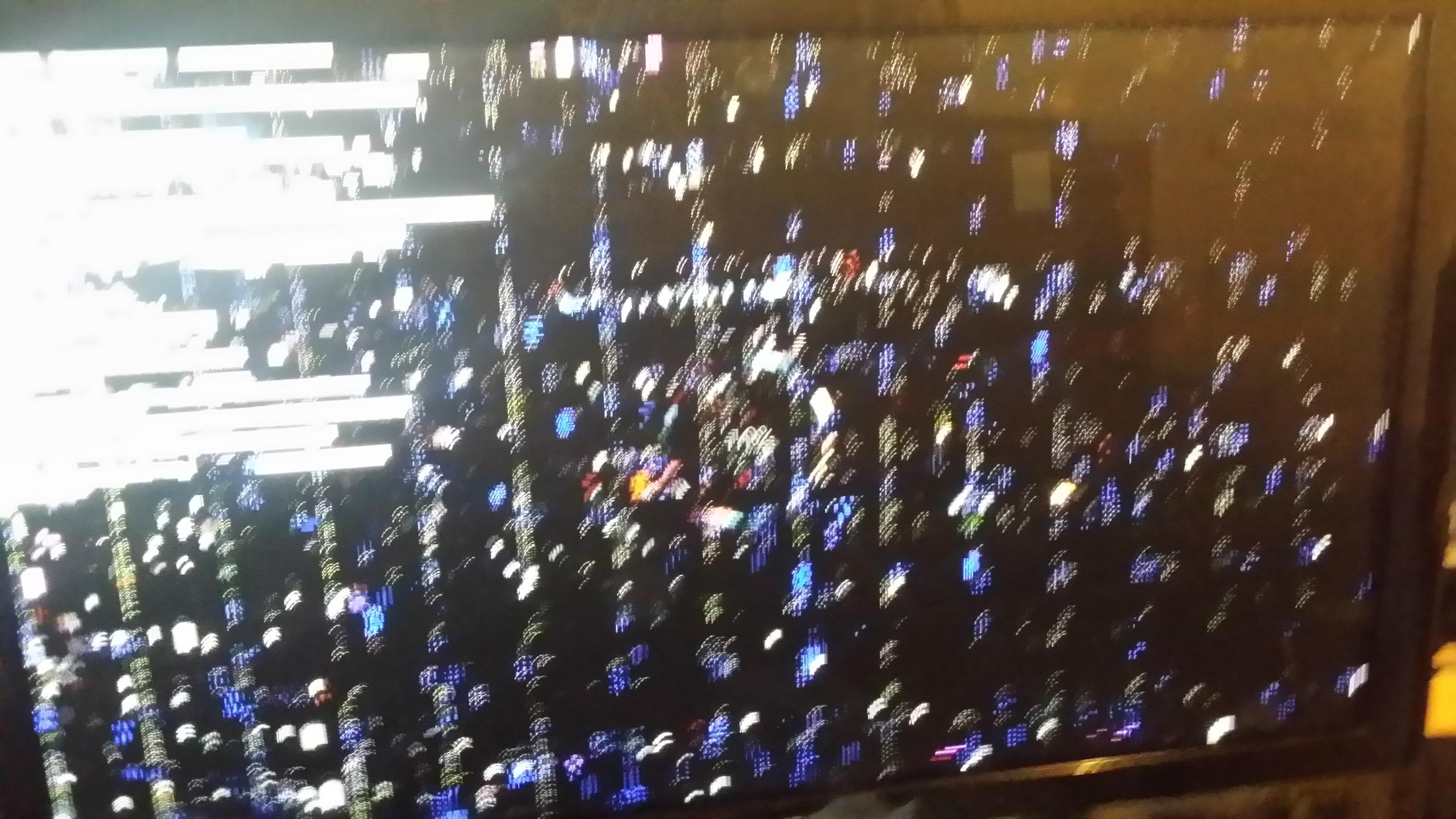

    Hello all,
    I am looking for some help with a TV I picked up the TV off Craigslist, it looked like an easy fix. Here is my issue

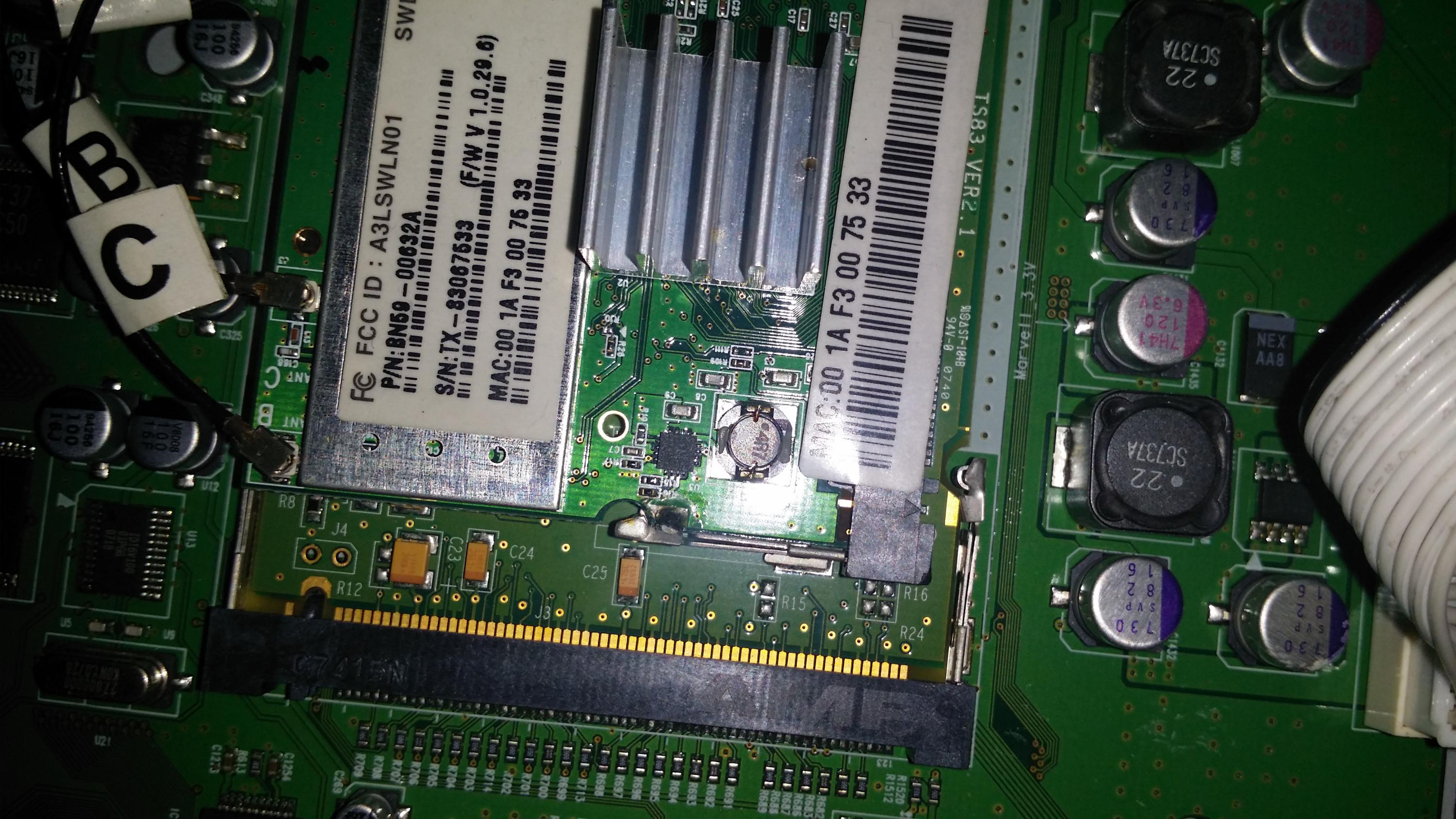

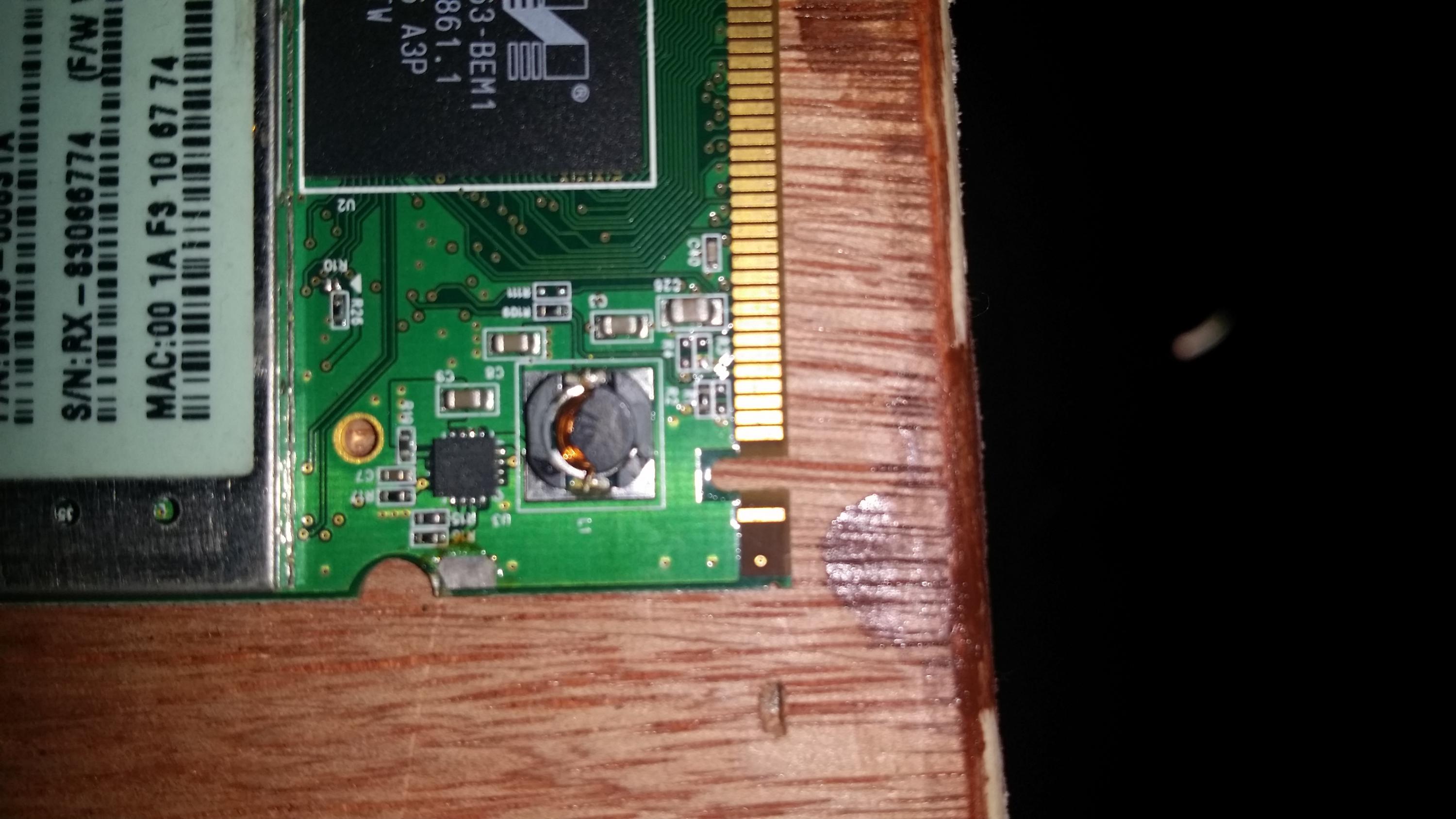

    - When the TV is first turned on it connects to the wireless receiver and works fine for a while. 10 minutes or so into playing the video starts to break up in a digital pattern but the audio is working fine... I checked the wireless cards on the AV Transmitter box and the TV and found the inductor looks is broken at the top of the receiver card on the TV. I checked the resistance and both are they same for the broken one and the good one.
    The problem is that i am not sure what the inductor does or if that could affect my the TV. Please Help
    The pictures below show The broken inductor on the TV's card versus the Inductor on the Wireless transmitter card and what the TV actually looks like.

    Do other functions do this too, or only digital tuner?
    While TV does this, do the OSD volume controls work?

      All the other functions do it as well.. When that digital pattern pops up i cant see the OSD. it's' almost like it's frozen until i restart it, then it works fine for a few minutes.

          Tom,
          thanks for your help..
          I read through the posts but it didn't seem to fit my problem.. I took a chance and changed that inductor on the WiFi card and BAM!! its working fine.... Well for the last 12hrs anyway!! Normally it would have gone out by now.. Thanks for your help again!
