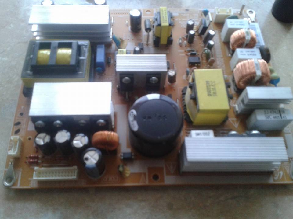

    Hi, I got this Samsung LE32A457C1D. it comes on for a few mins then go's off.
    PSU Number is bn44-00214a. All electrolytic caps have low esr. IVE CHECKED MOST of the fets except the 4 at the lower left hand of pic as I cant see the part numbers, if anyone got a schematic id by greatful. the voltages are all there during the few mins of on time. Any idea's please.

              I've changed CY804S as circled on the schematic. so far it's stayed on, its been on for 15mins. touch wood.

                      Im only getting 5.2v st.by pin3 and 3.3v on pin 1 of the CNM802 plug, and the 24v detect at pin5 of CNM801 im only getting 4v whitch says 5v on the silkscreen. Stuck in standby now.
                        Re: Samsung LE32A457C1D
                        This PSU is different to normal SAMSUNG. A logic HIGH at Pin 1 should cause P/S outputs to be active.
                        Check following voltages (all measurements ACROSS component, all on primary side of PSU):
                        - CB806 50V/47uF
                        - CP811 50V/47uF
                        - CP803 450V/150uF (The 450V cap)

                            CB806 was 23.8v, CP811 was 12.3v, CP803 was 383v.
                            I turned it off after a while after that it was stuck in standby. Two long red led flashes followed by 4 short flashes.
                            I measured the cap in this state and are as followers:
                            CB806 was 33.5v, CP811 was 0v, CP803 was 336v.

                                Check pin 1 when stuck in standby...
                                Also check voltage across primary and secondary side of PC802S optocoupler.
                                QB802S might be bad.
                                  Check QB802 solder joints. In fact hit them with an iron even if they look good.
                                  Just fixed an LN32A450 with a BN44-00214A yesterday. Found the tip in a thread here after searching the board number.

                                      It's turning on and off ok now, I will solder those joints.
                                      The voltage across the pc802s opto while working is 0.2v hot side and 1.16v cold side.
                                      I've been waiting for it to get stuck on stand by to get the other voltages but its coming on now even when warmed up.
                                        It's working now, for how long I don't know as I didn't find an actual fault. I resolded those joints on QB802 just to make sure, but it seems to be one of those self fixing tvs lol. fingers crossed.
