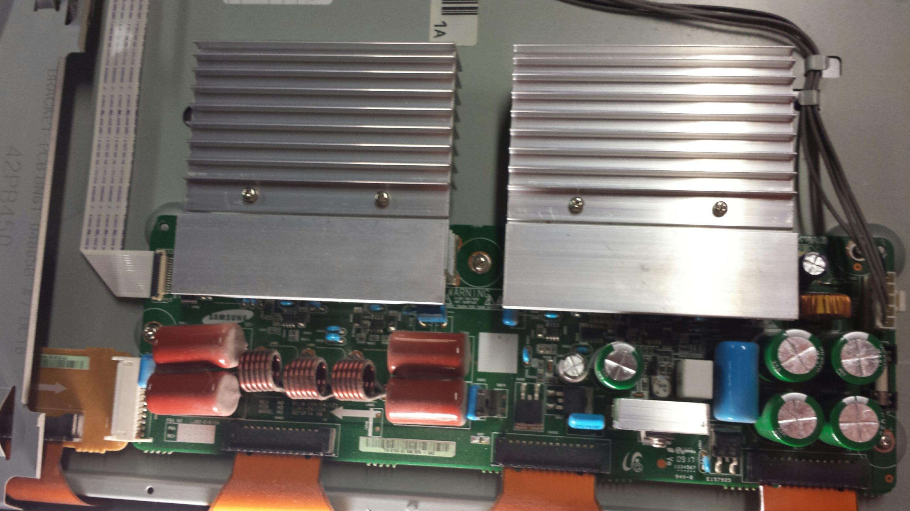

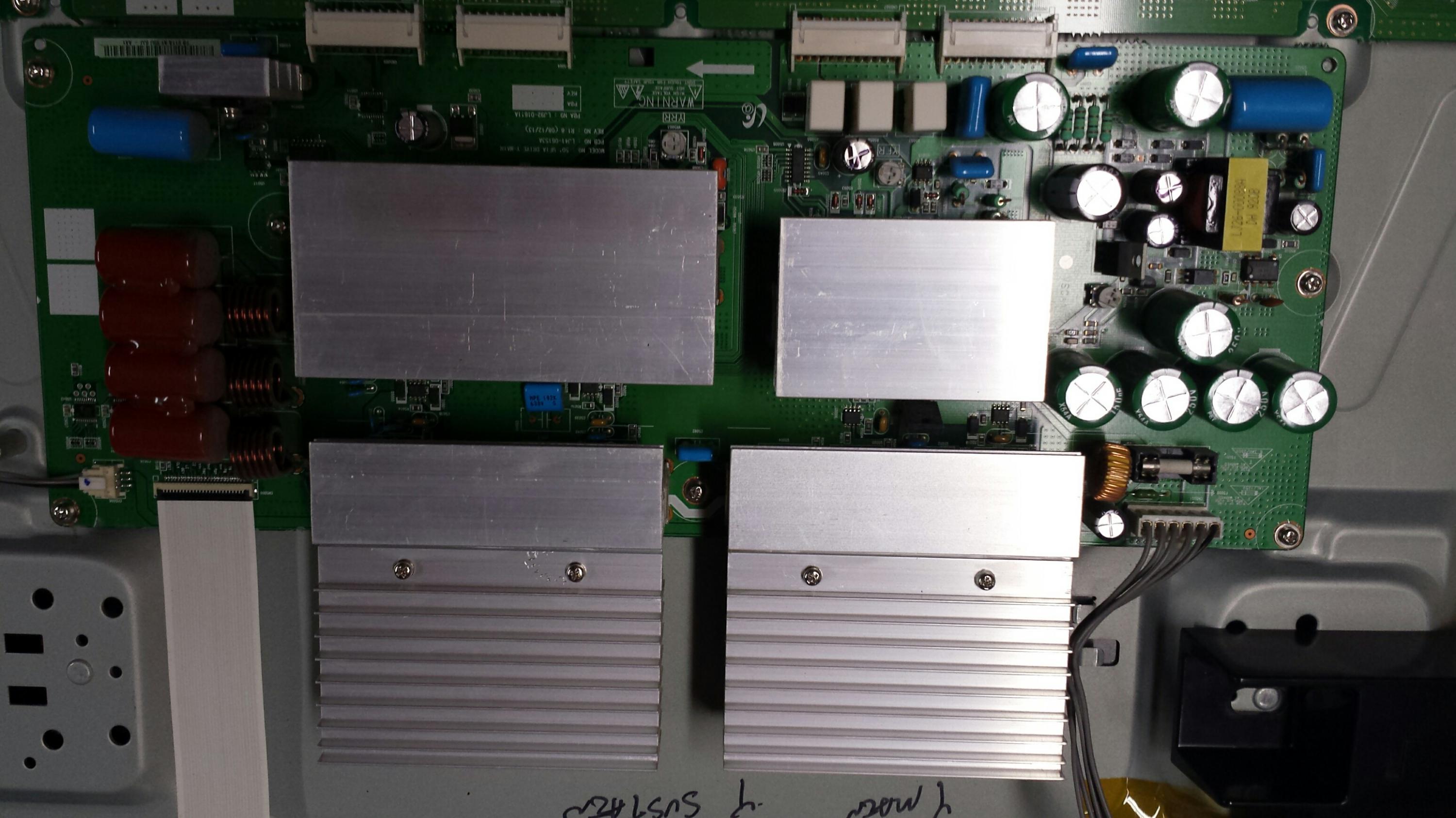

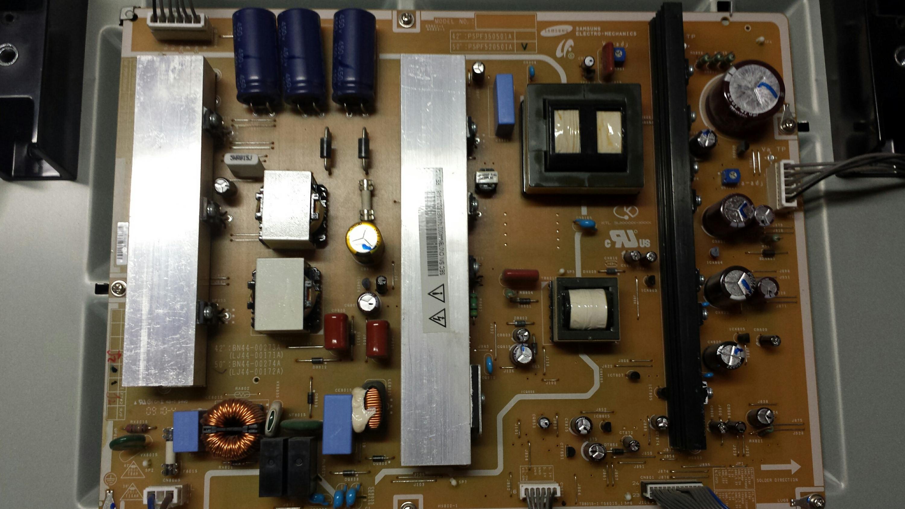

      Pics attached. If I need to take closer ups, or any others please let me know! I truly appreciate your time!
      • Digglr
        • Mar 2014
        • 30
        Re: Samsung pn50b550t2fxza
        Xmain/Xsustain

          First, try disconnecting that plug near the fuse, from the X-Sus board, and re-try starting set up.
          If it comes out of stby, its likely theres a fault on that X board.
          If not, try disconnecting the Y-Sus in the same way.
          Re-try again....
          --Let us know.....

            OK... tried that.. nothing changed each time... either with just X or just Y, or both... clicks...ticks 5 times, led's flash on the pcb.. then nothing.

                      Hello. In Samsung TVs there are no error code blinks. In modern Samsung plasma TVs you cannot just unplug your SUS board as microprocessor on CTRL will get the feedback info via I2C bus line that power was disconnected (Vs/Va line) For example if Y sus was to be faulty, CTRL boards sees it and disables PSU board (but you should still get around 200V of Vs voltage for a second before this voltage drops). Even if buffer board is faulty or the PDP, CTRL board can still shut down SUS boards+ Vs/Va lines in PSU.
                      What you can do is first check if you get Vs/Va voltages ok. If they come up for a second and drop, you can put your ear close to Y sus or Z sus board and listen for a short buzz (confirming SUS board come up for a split of the second.) You could actually use your oscilloscope to capture a subfield waveform for a second but I understand you are not engineer, so you may not have one.
                      If apart form Vs/Va the rest of the voltages stay on (5V, 12V to motherboard), it means the AV board is working fine.
                      If you ruled out MB, and power supply is working, I would start looking for a fault from cold resistance checks (check if there's any shorts in Vs line to GND, FET transistors on both SUS boards, check buffer ICs for shorts etc.)
                      good luck!

                          OK... I did a little research, and found out how to test Vs and Va. Only problem is.. the voltage spikes up when i turn it on, but shuts down right away. I could only get a reading of 20.6V on either, but then it clicked off and decreased to 0.
