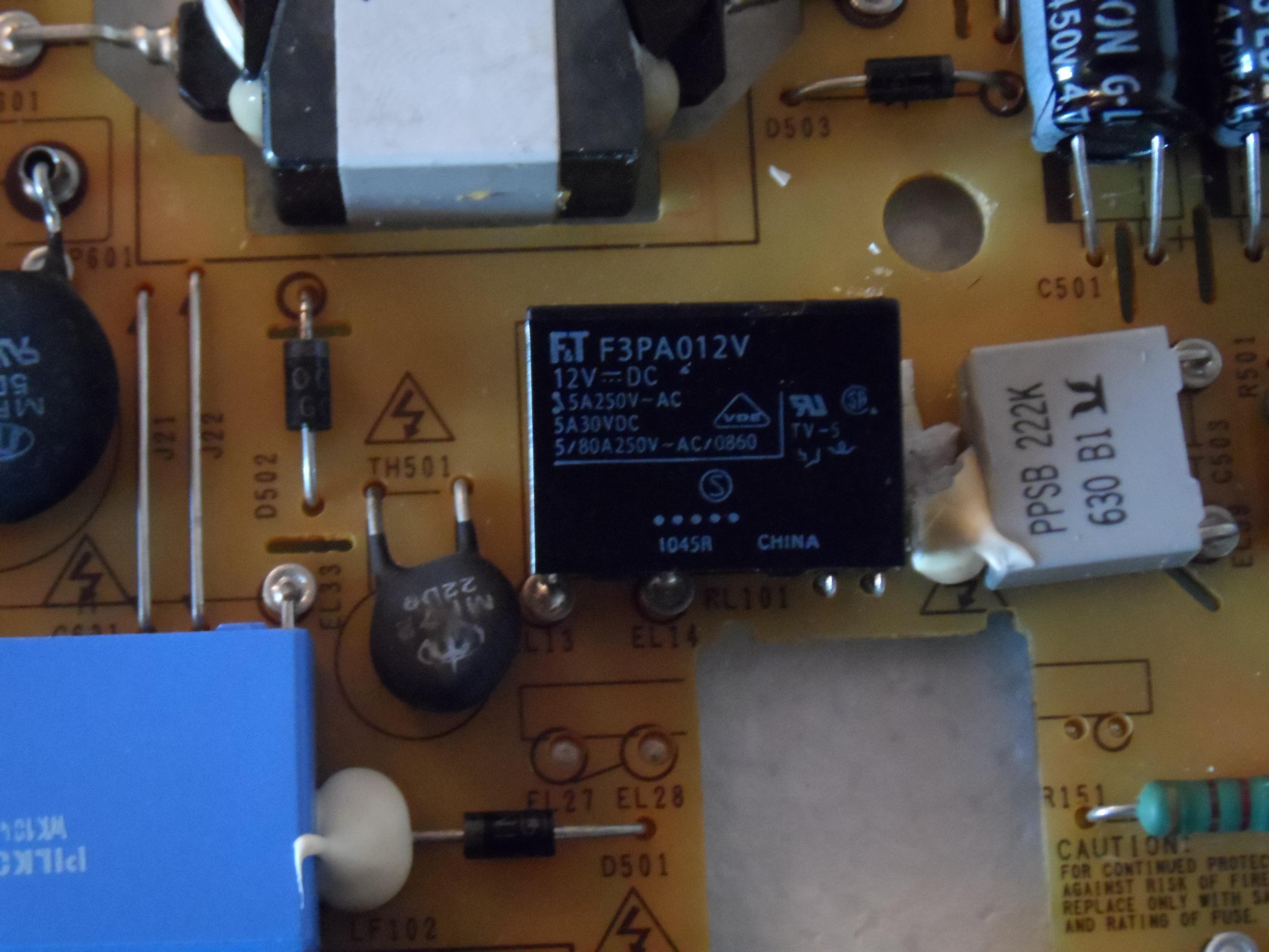

    Hi all I have a LG32LV450U LED tv that is not switching on. Initially when I opened it up I could see two very bulged 47uf 450v caps on the power board which I replaced along with two fuses (5A & 1.6A). With these replaced the power light flicked on but off again. I decided to replace further electrolytic caps but all I can get is a very faint sound from the relay. The power board is EAX62865601/7 rev1.0
    Sadly I cannot find a diagram for this power board.The chassis is LD01U
    and although I can find the LG service document the schematic for the power board is not included.
    After some measurements I can see that the Bridge rectifier is not getting an input and tracing the tracks I can see this is due to the relay not powering.
    Does anyone have a diagram at all for this model or any tips on where I go next?

      Hi Multimeter many thanks for the reply.
      The replacement caps are all G.Luxon caps. The original fuses were of the coloured bar ceramic types so were not blackened but they were both blown.
      With the new fuses and caps in the fuses are OK now.I get the mains AC through the 5A fuse to the one leg of the relay but the relay isn't being powered so it isn't switching through to the rectifier.Strangely though I am getting the 3.5v DC on the secondry side????
      I will post a picture later to try to help matters.
      Many thanks

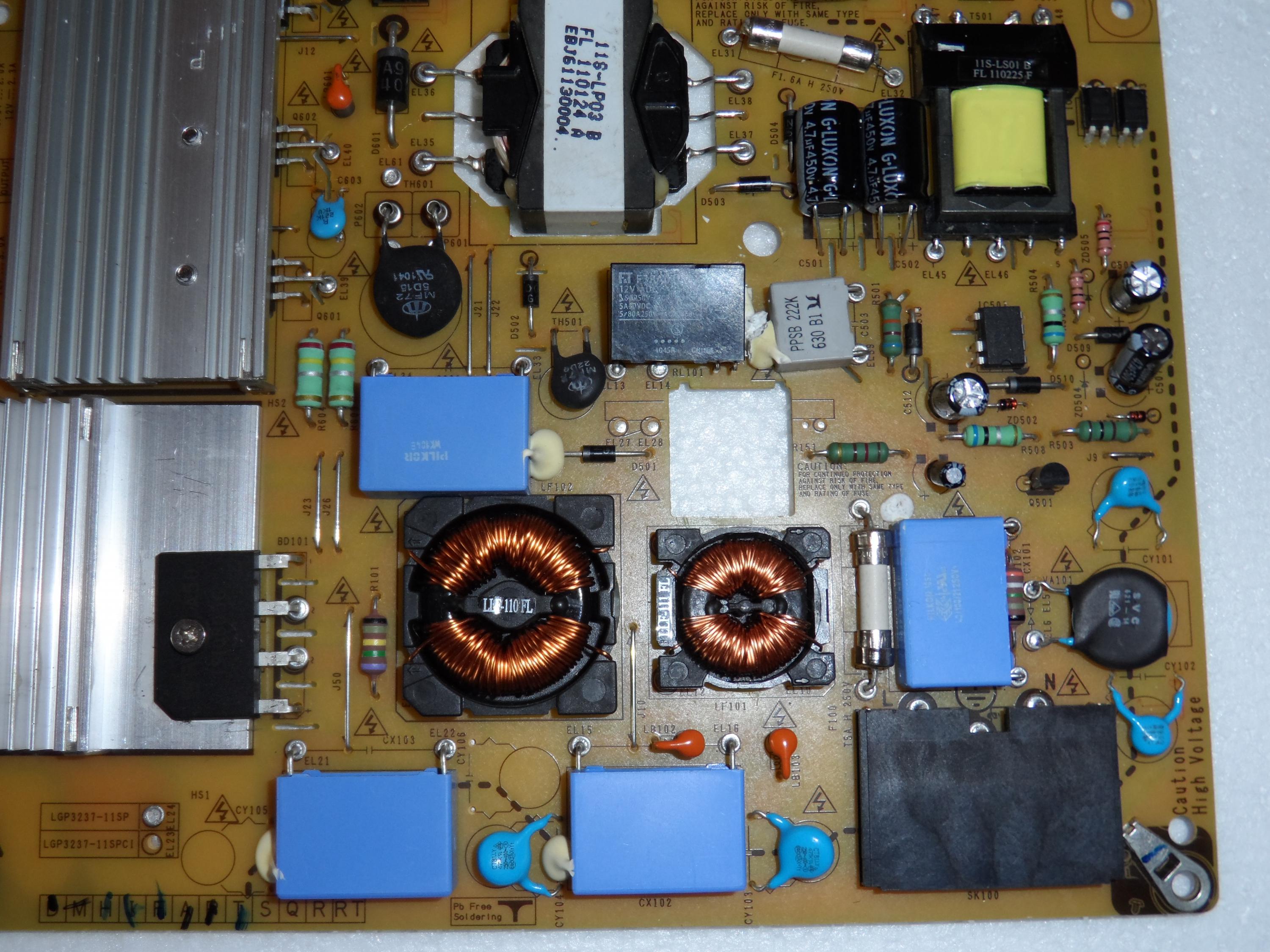

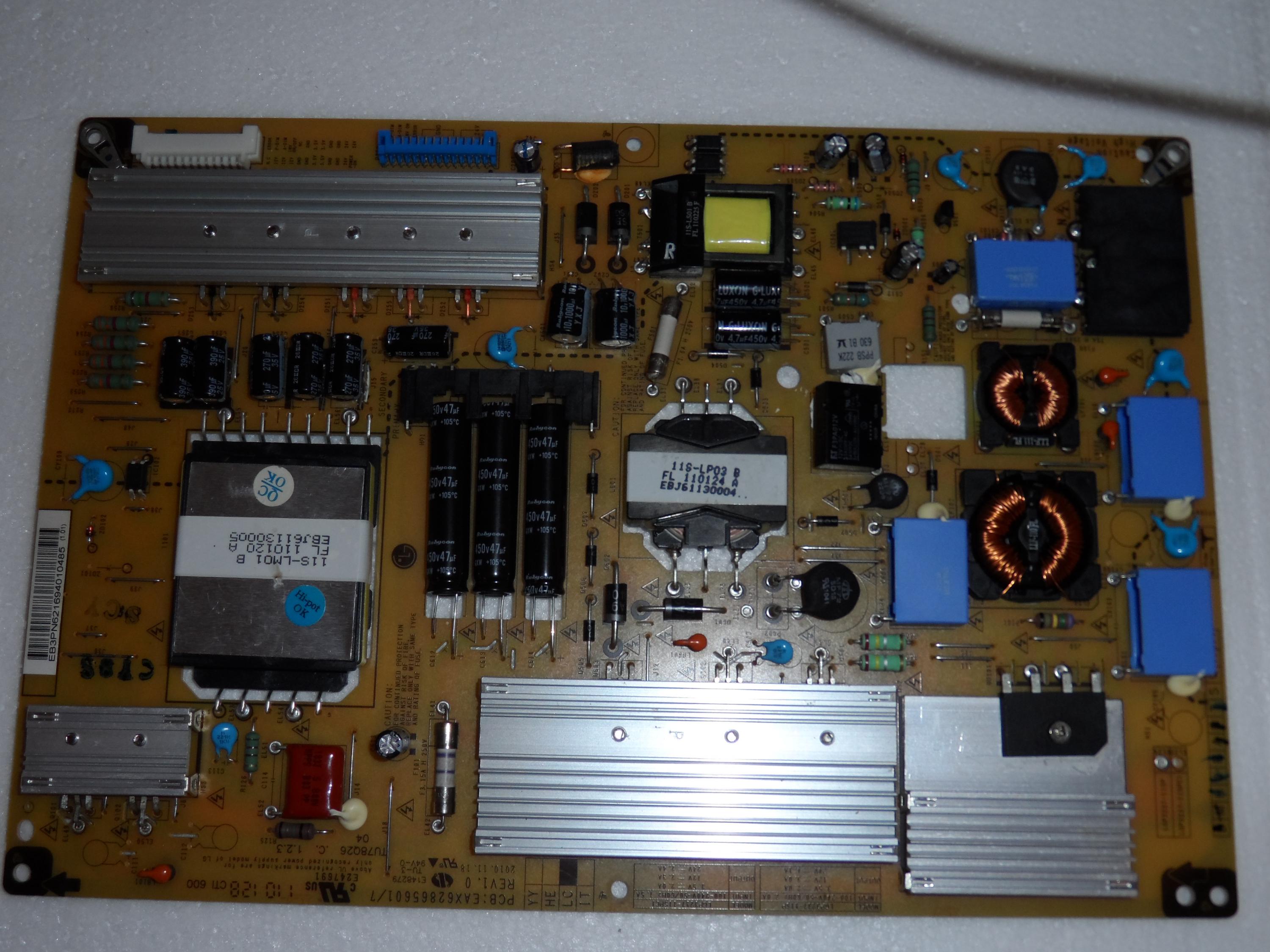

        Here are some pics of the power board.
        I hope they turn out OK.

          what series were the g luxon's?,personally id have put panasonic fc/fm/fr series as they are low esr.
          actually,looking at the other caps there are good brand caps there already (rubycon's)
