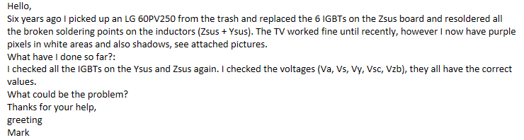

LG 60PV250 Plasma Purple Pixels in white Backgrounds
  • DoubleM257
    • Aug 2024
    • 4

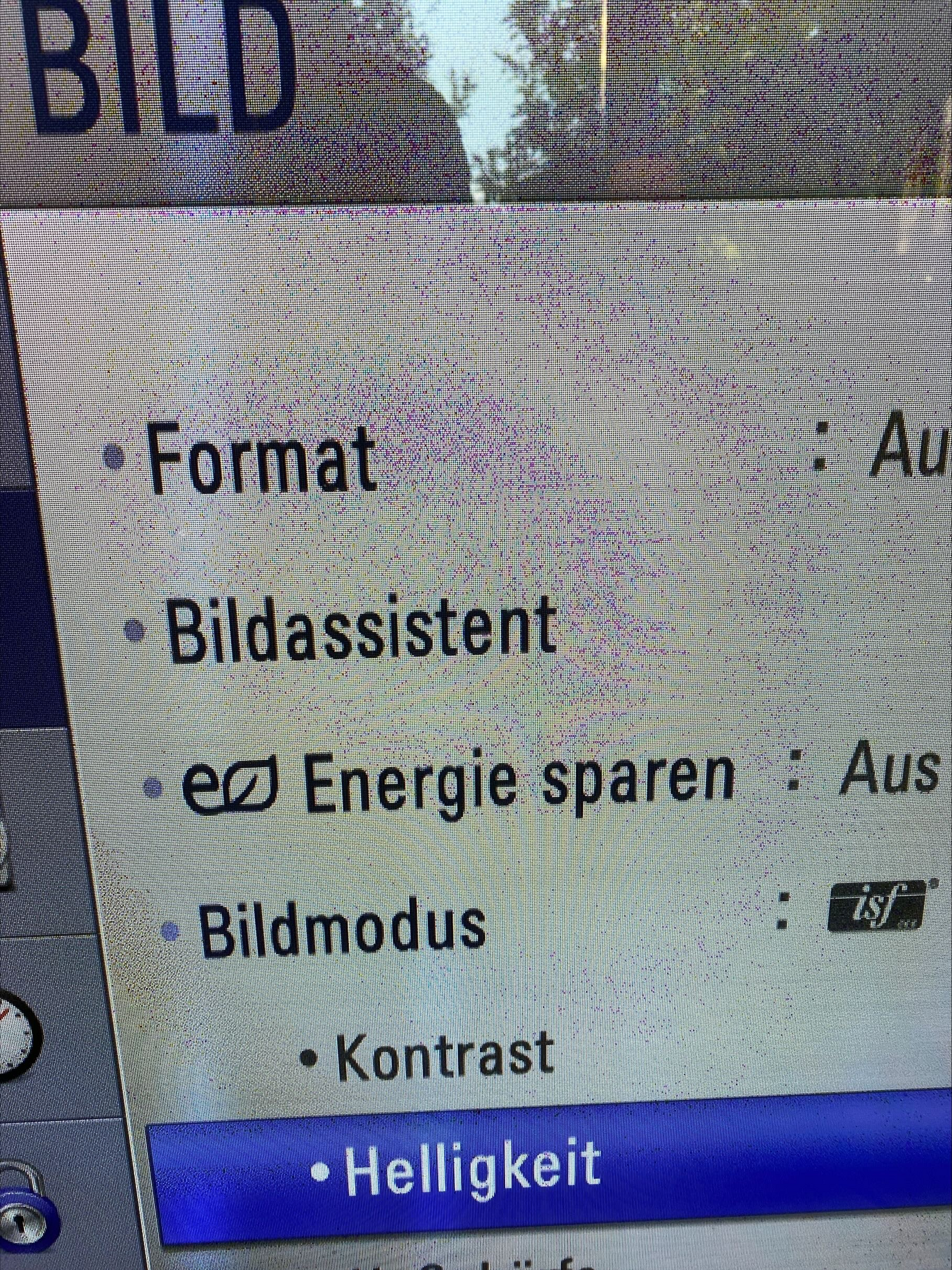

  • R_J
    • Jun 2012
    • 9588
    You can try slightly adjusting the SET_DN and SET_UP controls (mark original position with felt pen) while watching the screen speckles. You can also try adjusting the Vsc by a couple volts to see if that helps, the panel is aging so there is not much you can do
    • Diah
      • Feb 2013
      • 6439
      +1 but before you go for adjusting... do hard reset from service menu.. as the main fault trick values
      • DoubleM257
        • Aug 2024
        • 4
        Thanks for the help. I turned the controls and the Set_UP control had no effect at all. No matter whether I set it to MIN or MAX, nothing changed in the picture. I turned up the SET_DN control a little, which brought another minimal improvement, but if you turn it up too much, the image becomes completely distorted.​ By turning up the VY control fully, the picture improved. There are fewer purple pixels, but they're not completely gone. Is there another setting that I could use to improve the image?​
