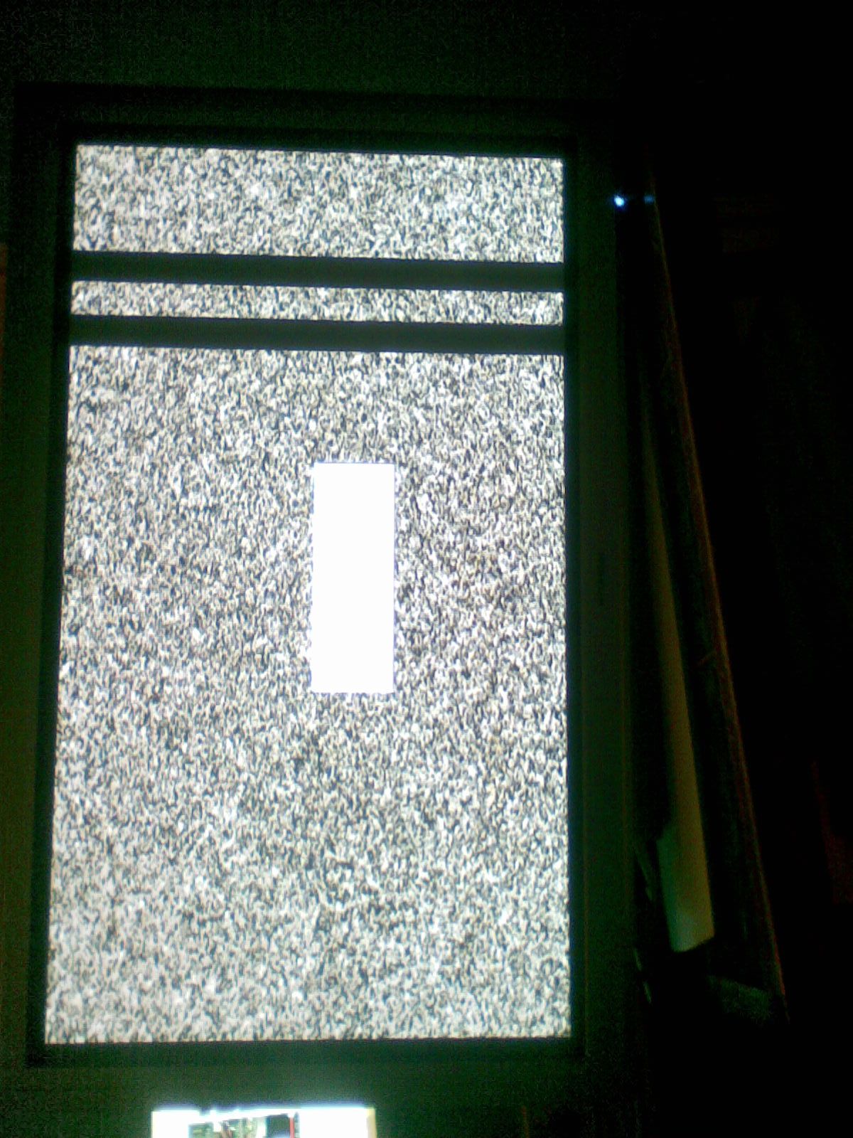

hello i have this plasma lgpdp42v6 with next defect two black lines ! thanks

Could be cold solder joints on the X-driver connectors, they run along the bottom edge of the plasma display panel.Please do not PM me with questions! Questions via PM will not be answered. Post on the forums instead!

If that is not the cause, there is a good chance it is the plasma panel, which is not economical to repair, sorry.Please do not PM me with questions! Questions via PM will not be answered. Post on the forums instead!

You cannot change the COFs. They are bonded to the plasma glass.
If the 10 ohm resistors are open circuit, that indicates the COF has probably failed.Please do not PM me with questions! Questions via PM will not be answered. Post on the forums instead!

so far every one of those i have seen with lines like that were just cracked solder on the x ribbon cables.iirc there are 2 resistors on each that get cracked joints.
all the ones i have repaired are still running too.fairly common.Comment
