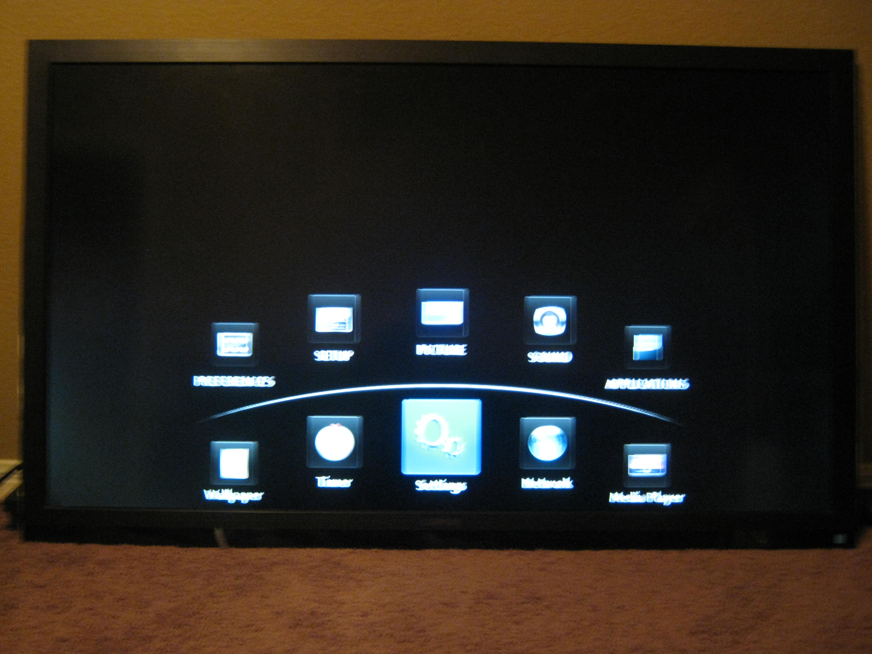

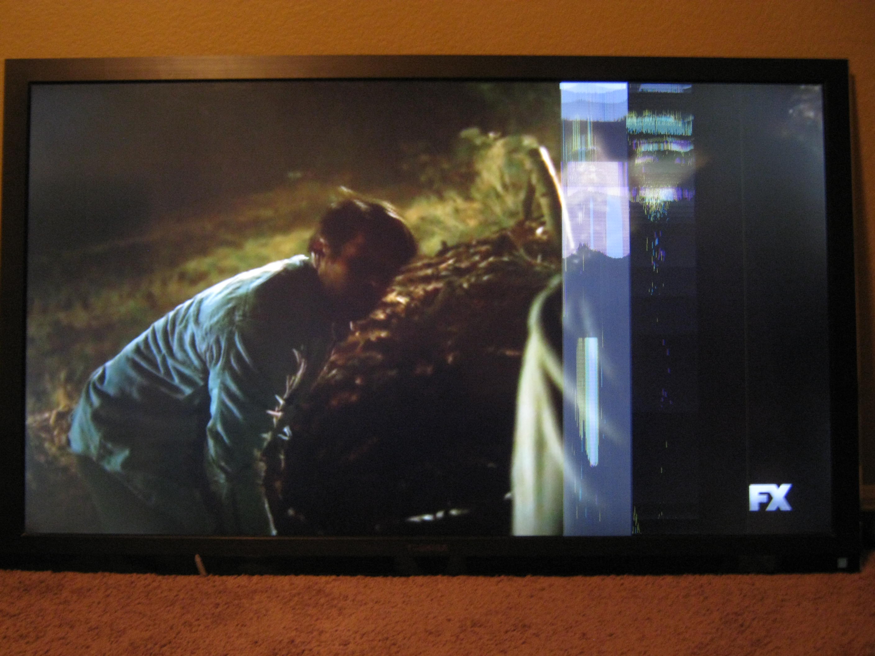

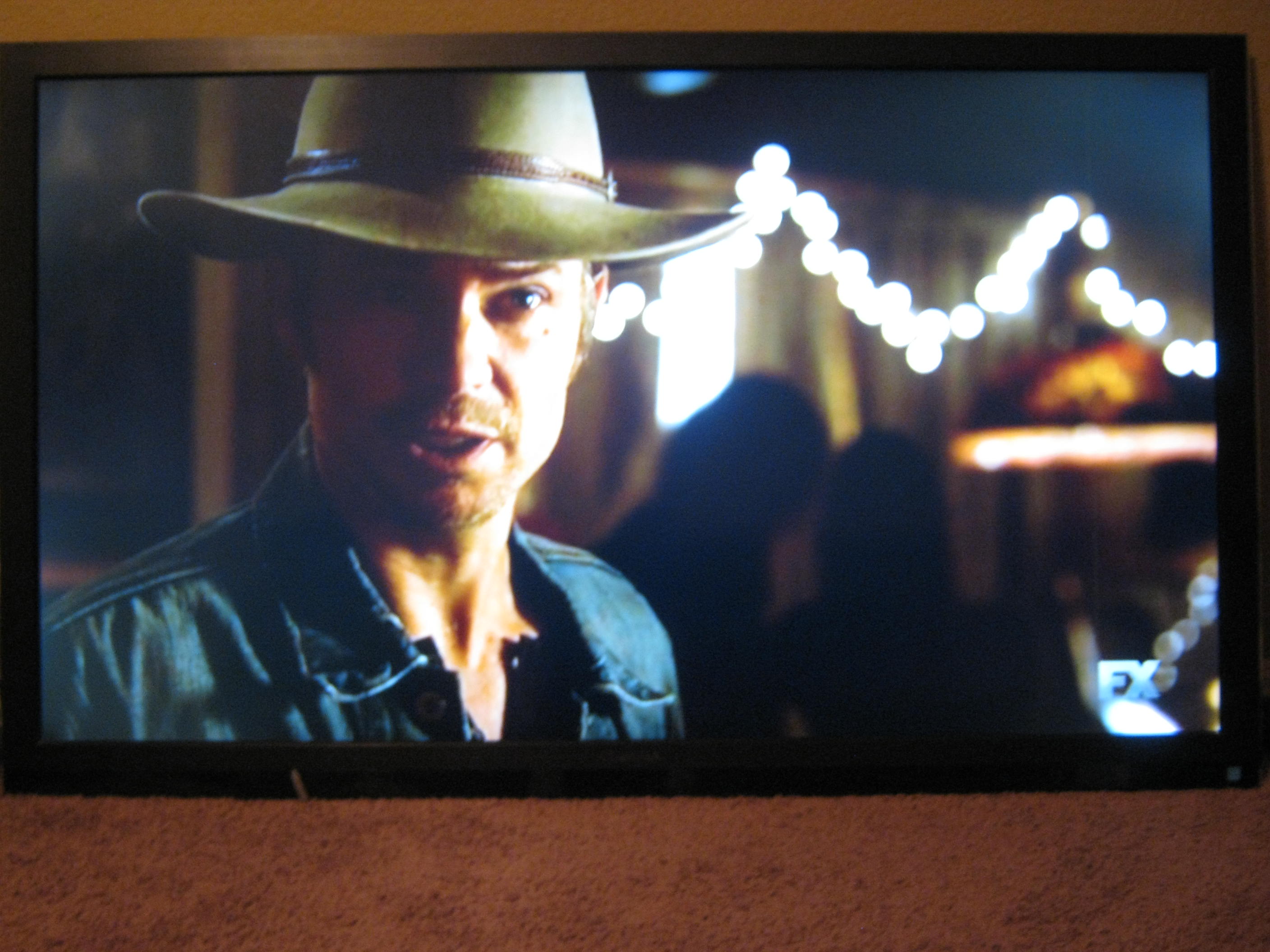

    When the screen has darker video playing or even a darker menu screen up, there are no vertical bars. When there is bright white (text for example) in the area of the two bars, the bars show up.
    I've had the back off and the T-con ribbons are on the bottom, so liquid damage possible. It's going to be a PITA to get a close look at the ribbons but am preparing to go there.
    Any opinions before I get in that deep on bad-T-con or bad-panel?

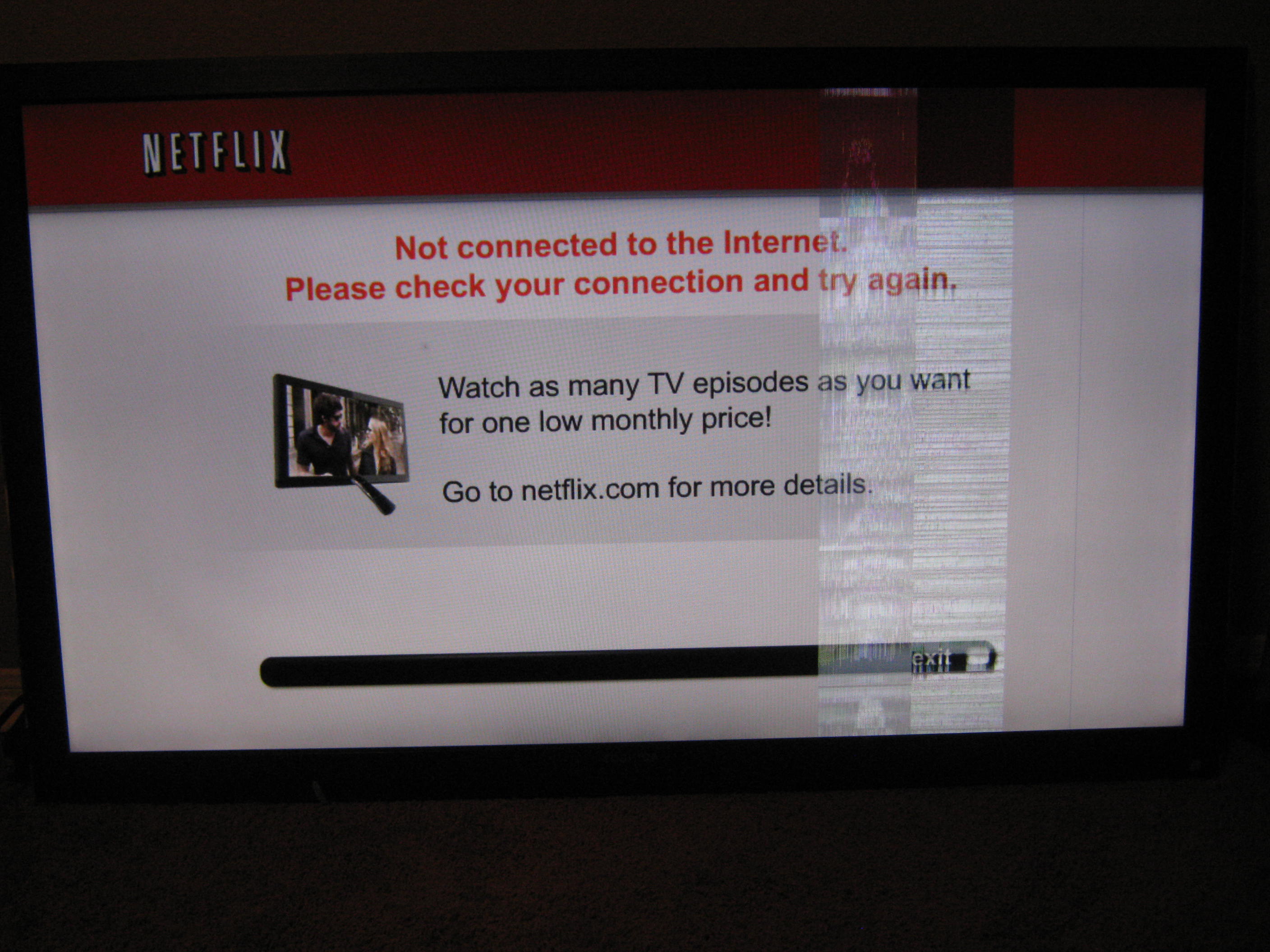

    I took the front off and got to the panel ribbons. They look good. I stood it on its side, powered up, brought up the network page in the first image, tapped on the ribbons to see if any change, and no change. I removed, cleaned both ends of the T-con ribbon for that half of the screen, and reinstalled, no change.
    Any opinions?
