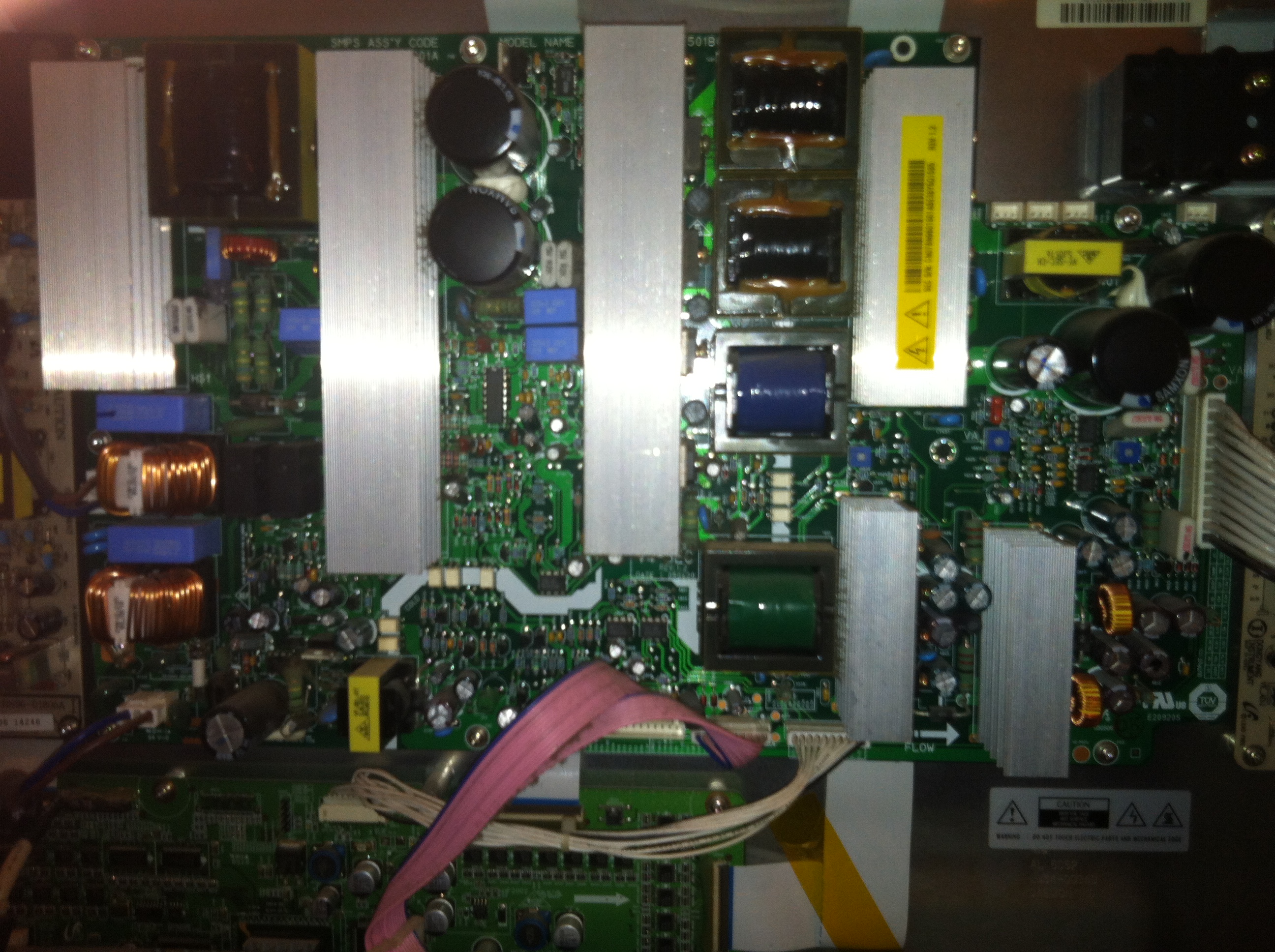

      Re: Samsung HPR-5072 Plasma- "crackling pop" then cycles off/on
      Thanks tom66,

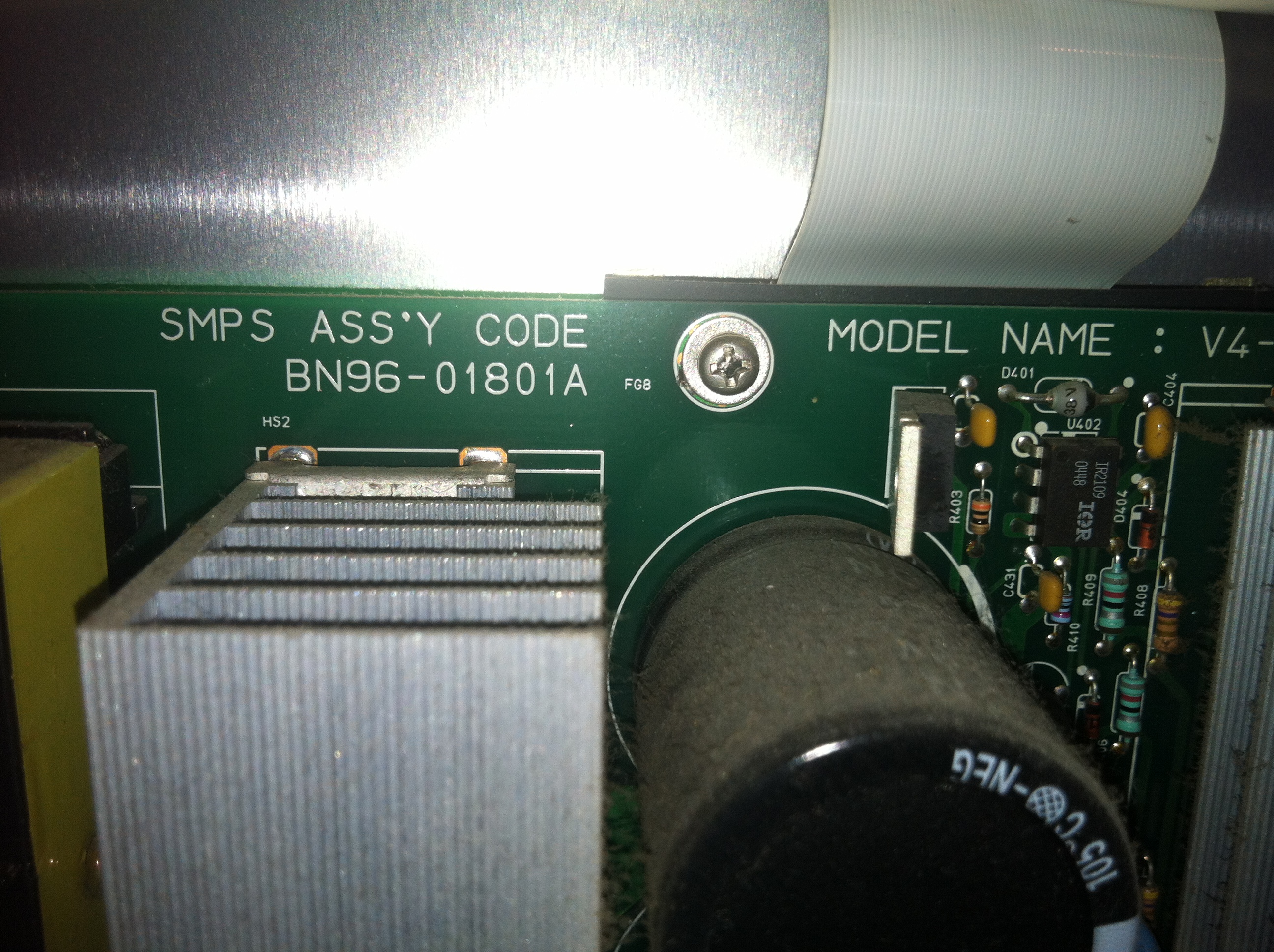

      Finally got this beast off the wall.
      It' rather dusty. Use some air to clean then remove PS board?
        I would clean after removing board. Lots of dust gets under PSU. Not a major issue in most cases though.

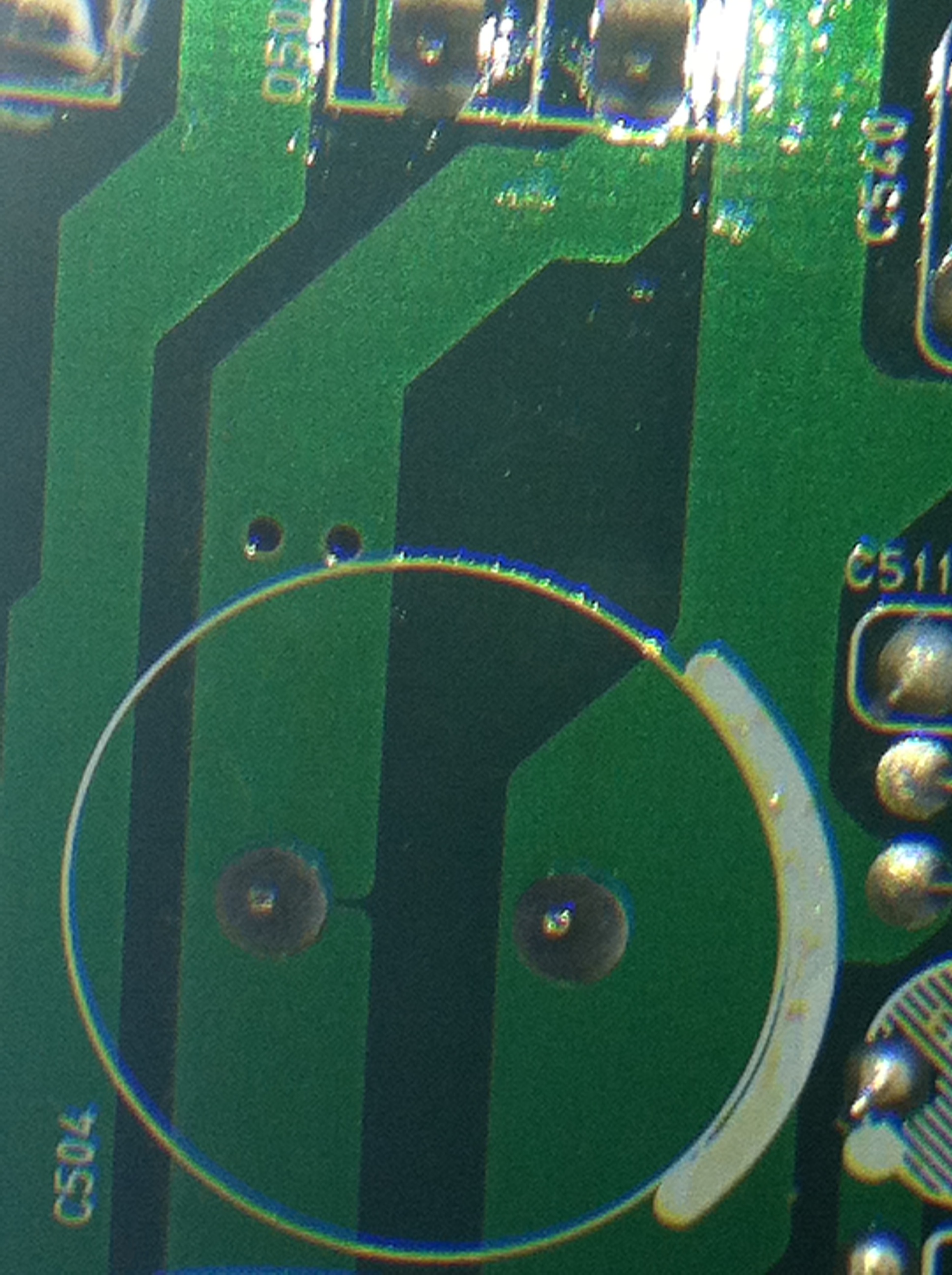

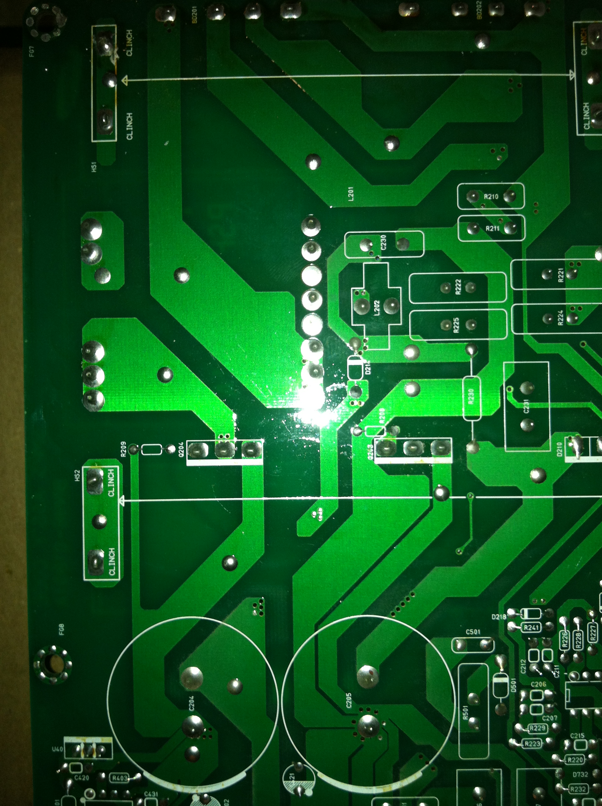

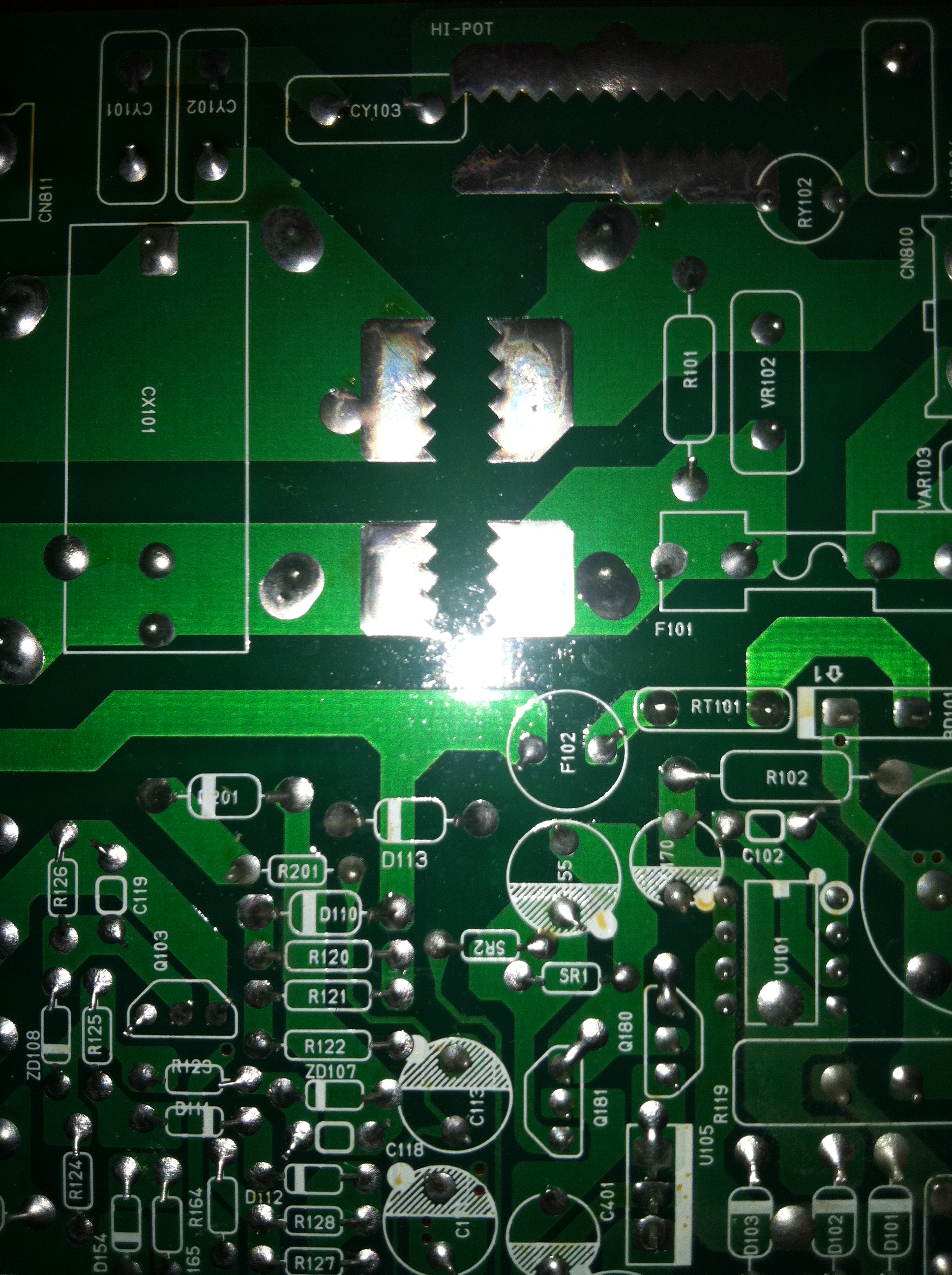

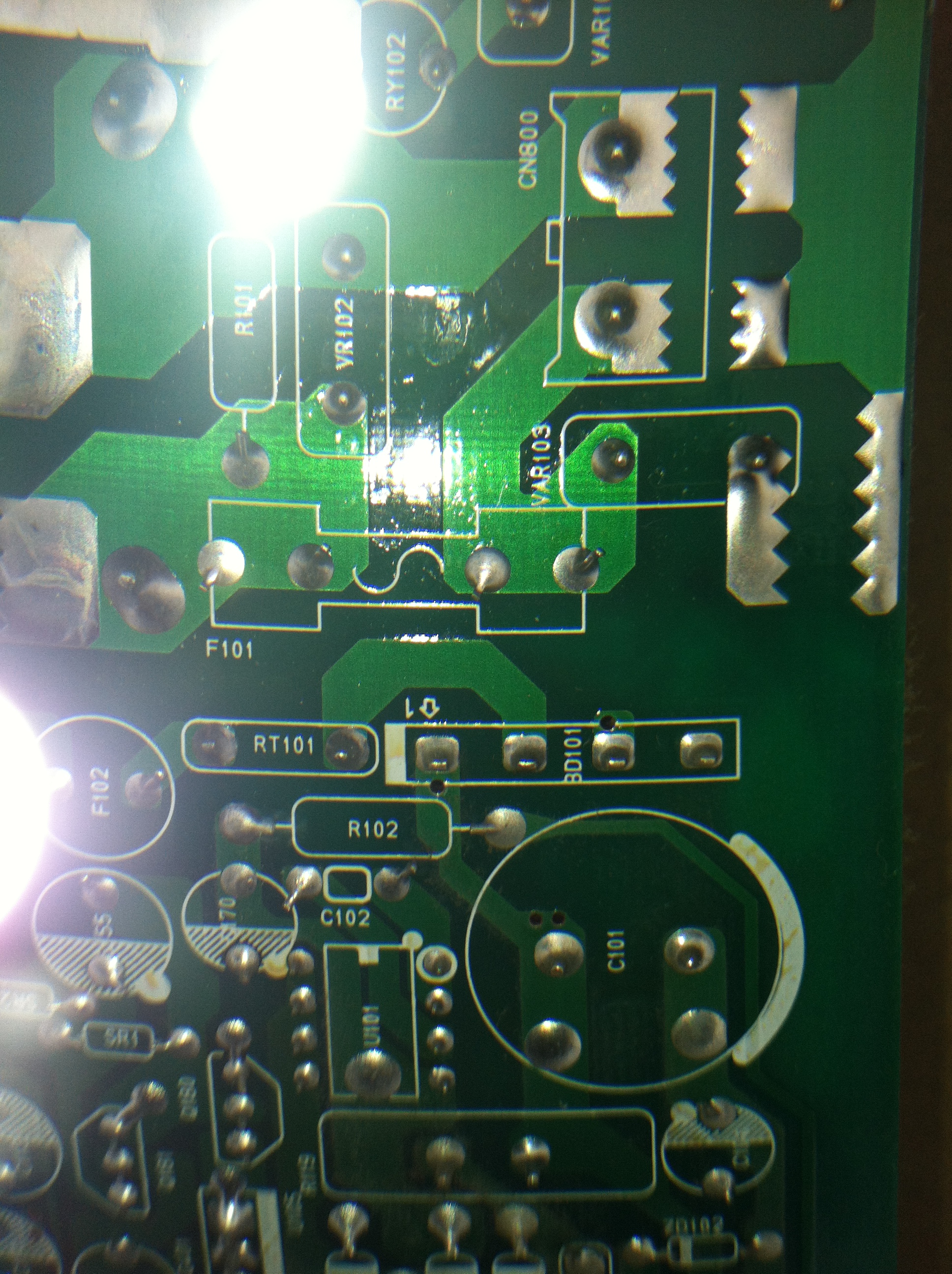

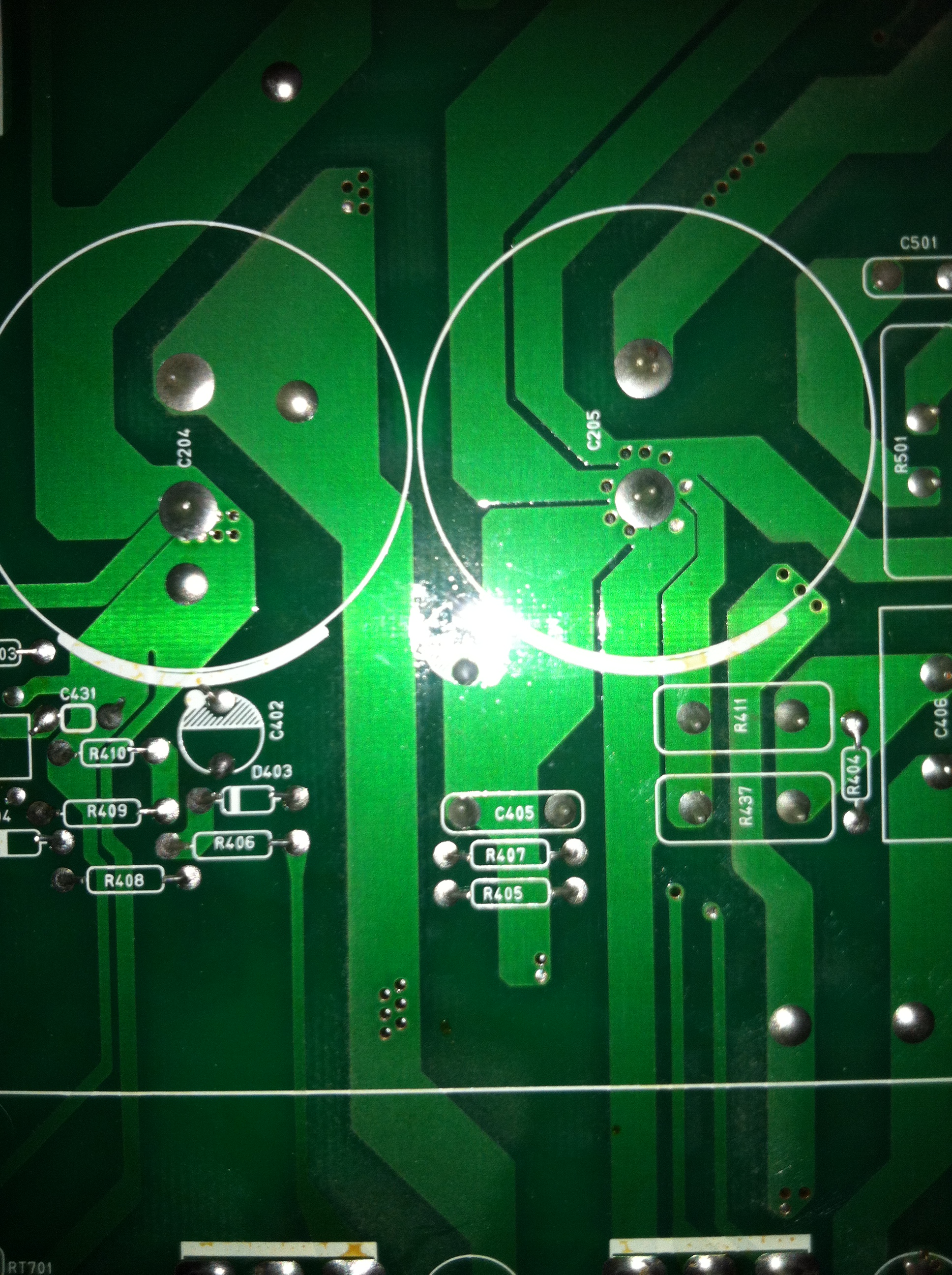

          To an untrained eye...looks flawless? One pic looks like there was heating, but it's more of a residue. I wouldn't object to swapping with a new one, or is only remanufactured available? I would be apprehensive about having to send mine for an exchange. I did this once for a non-related electronics part and what they sent me was more problematic than the core I gave them. Also, if it matters, I may have been incorrect on the DOM. Might be 2-3 years older than 2007. Sure appreciate your guidance. Thanks.

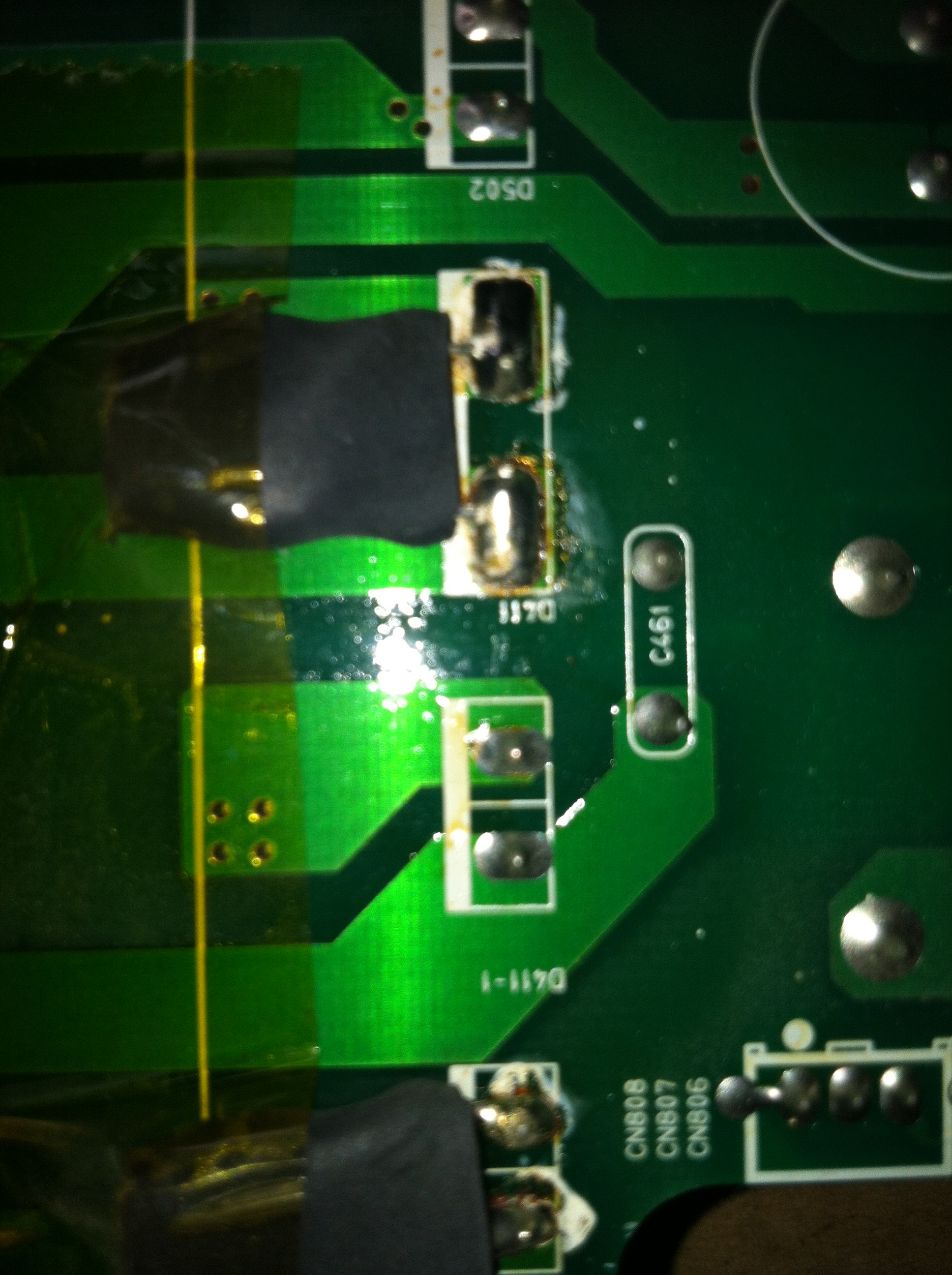

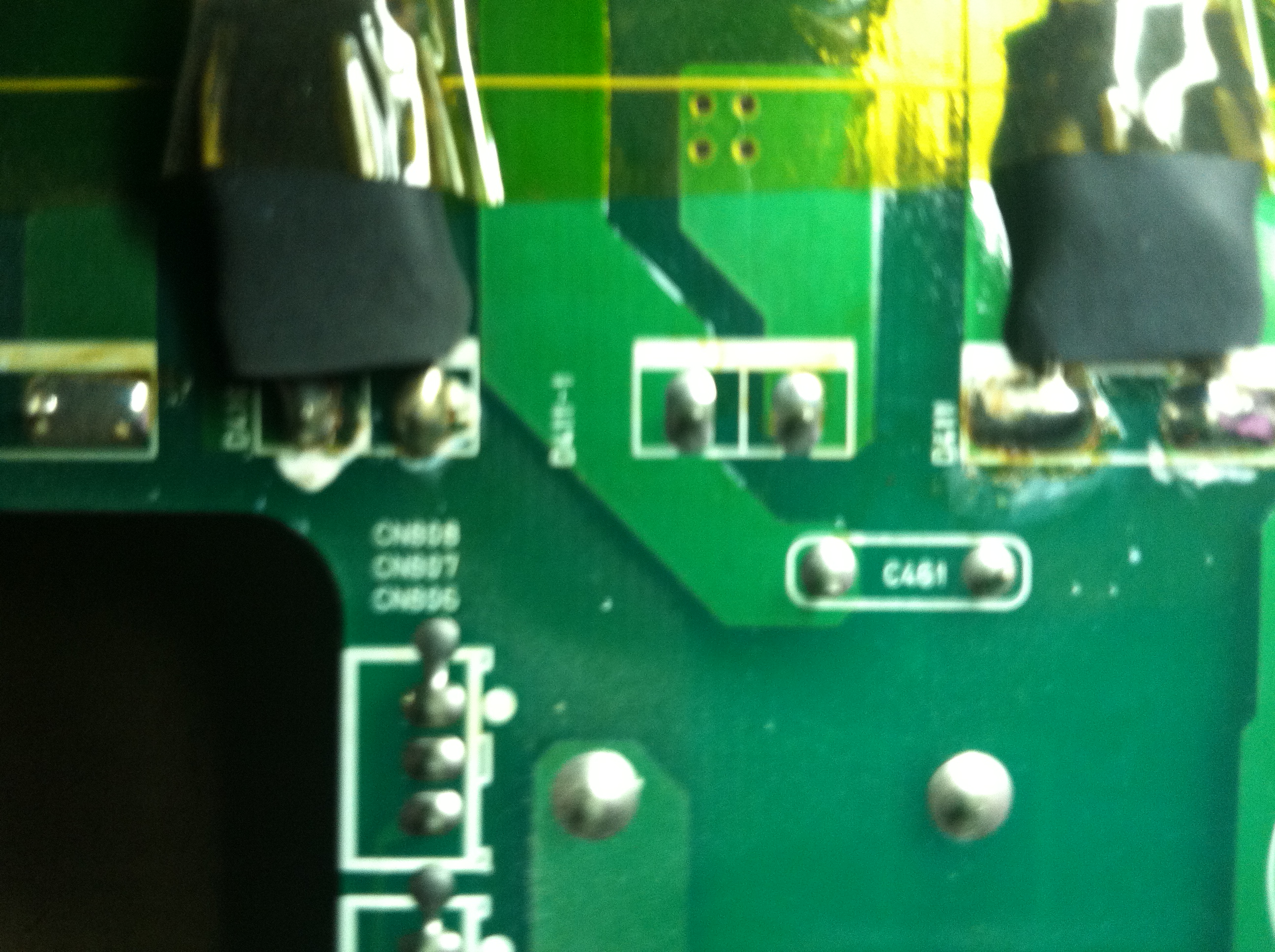

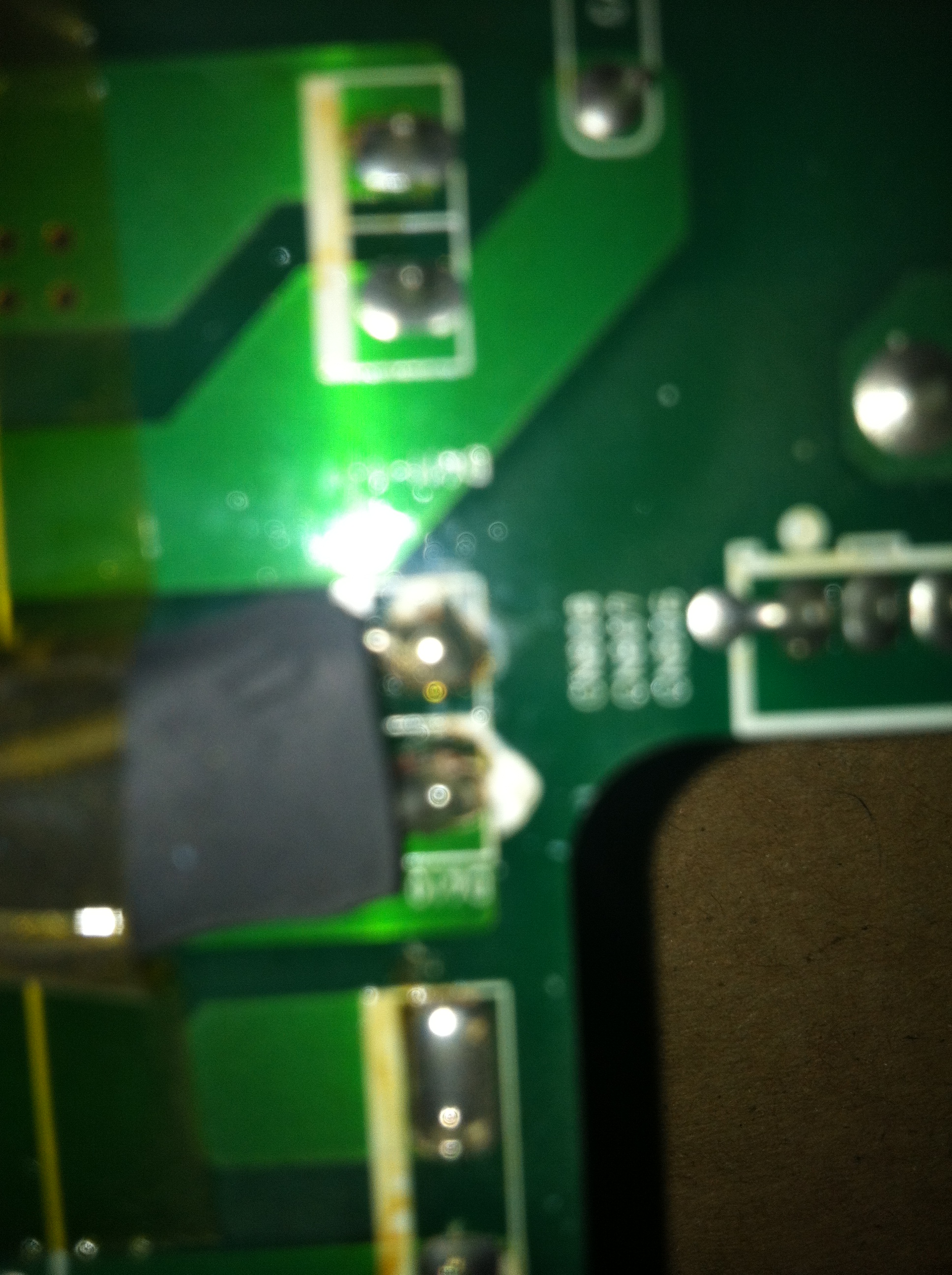

            Ah Ha! May have found something on one of the heat sinks. Appears to be some heating? Unsure about the white residue. What's under the shrink tube? Should I try a re-solder here? I have a small butane iron that works well.
