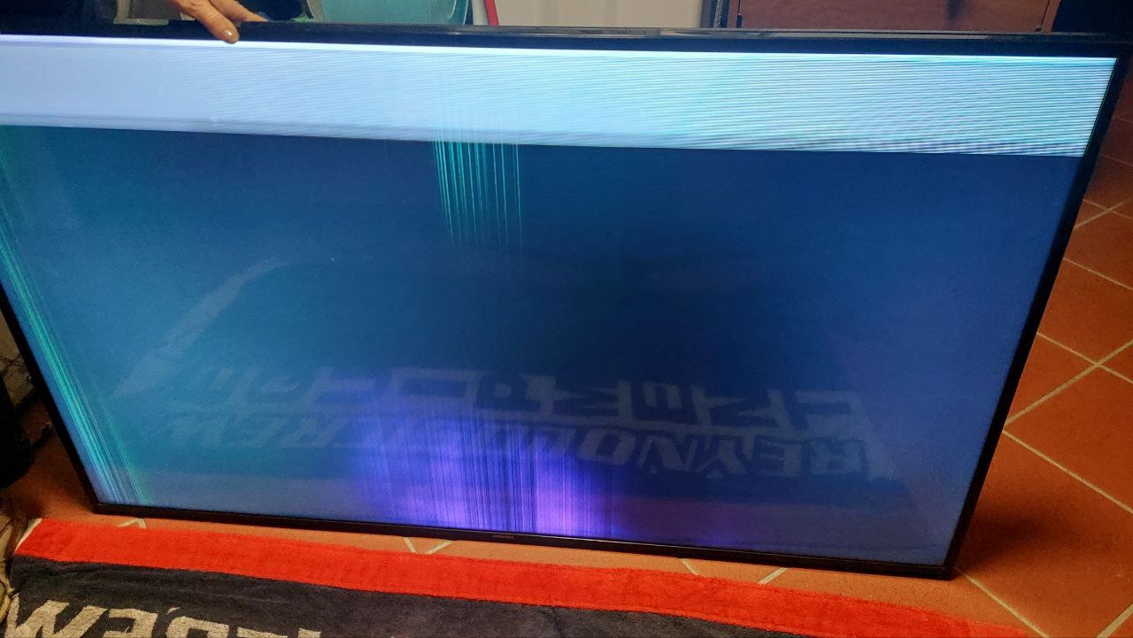

                  BUT I can't see anything because it's full of horizontal lines, what could it be due to?​
                  • lotas
                    • Jan 2016
                    • 4900
                    • Russia
                    Originally posted by fedeRaider
                    BUT I can't see anything​
                    I don’t see anything either, post a photo.
                    • fedeRaider
                      • Apr 2024
                      • 10
                      • Italy

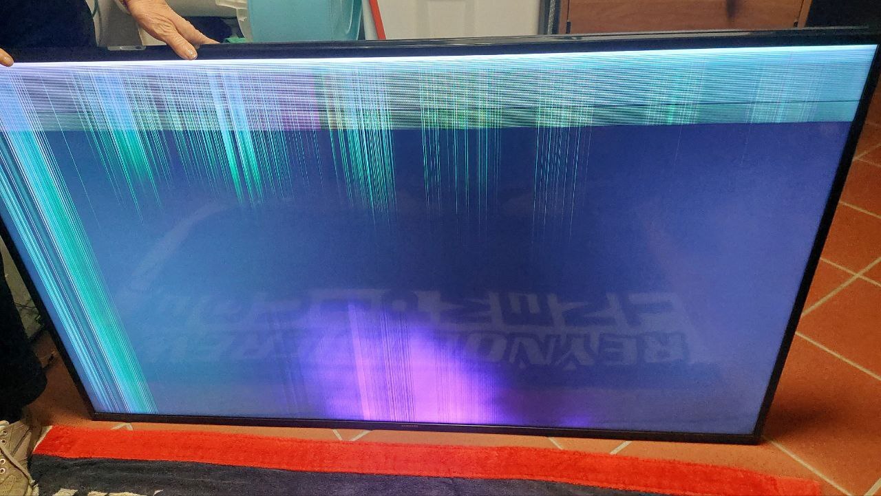

                      You are right 😂
                      Everything is black but occasionally some text is drawn (for example the Source):
                      And I don't see any cracks on the lcd
                      • lotas
                        • Jan 2016
                        • 4900
                        • Russia
                        This firmware has nothing to do with such a defect, was the picture good before?
                        How many lvds cables go to panel 1 or 2? Did water or liquid get on the panel?​
                        • fedeRaider
                          • Apr 2024
                          • 10
                          • Italy
                          Yes, it may have taken some water, I thought only the motherboard memory was ruined 😭
                          The cables to the LCD are two
                          • CapLeaker
                            Leaking Member
                            • Dec 2014
                            • 8352
                            It’s the tab bonds…. I try to stay away from “washed clean” TV’s.
