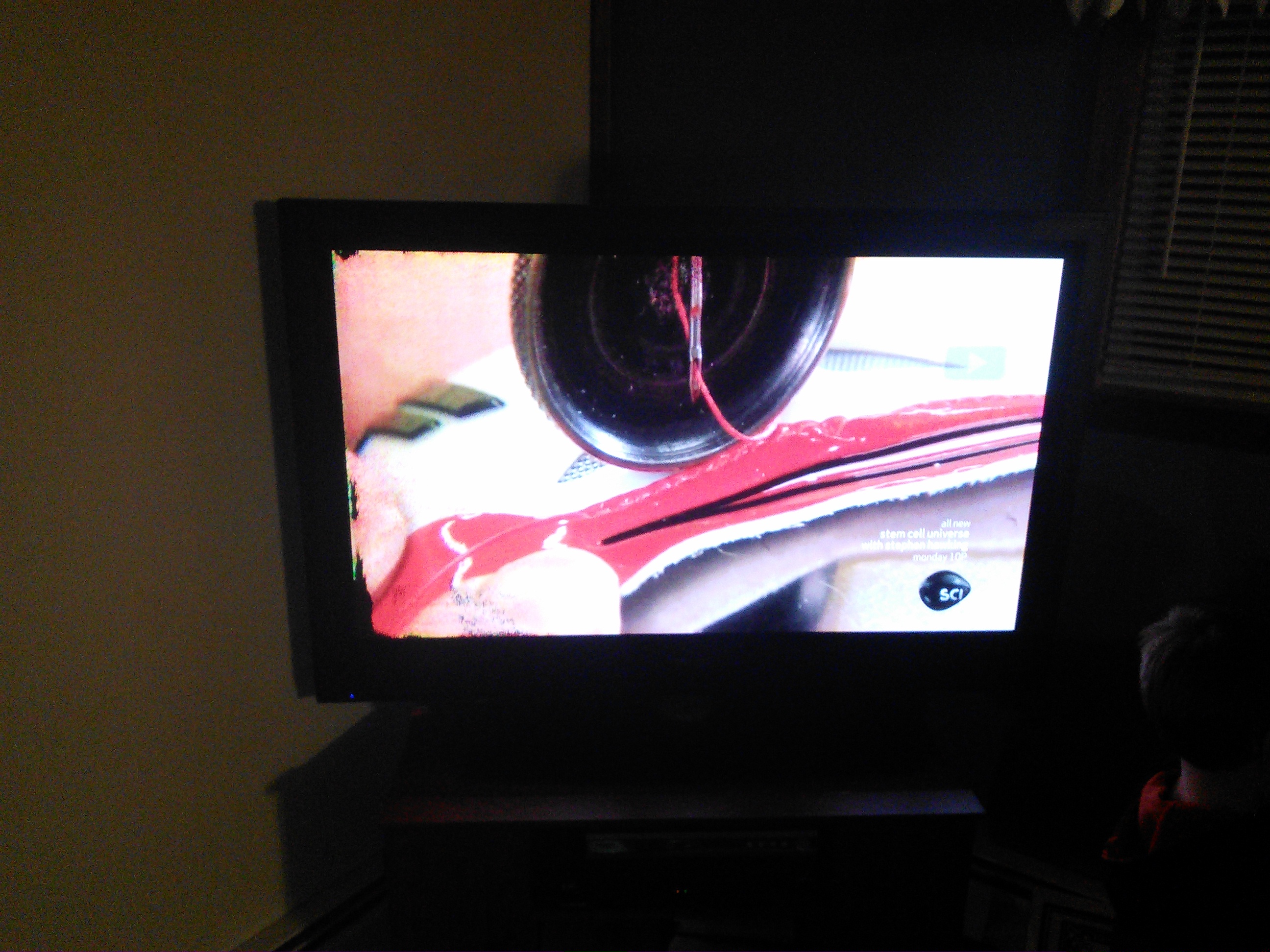

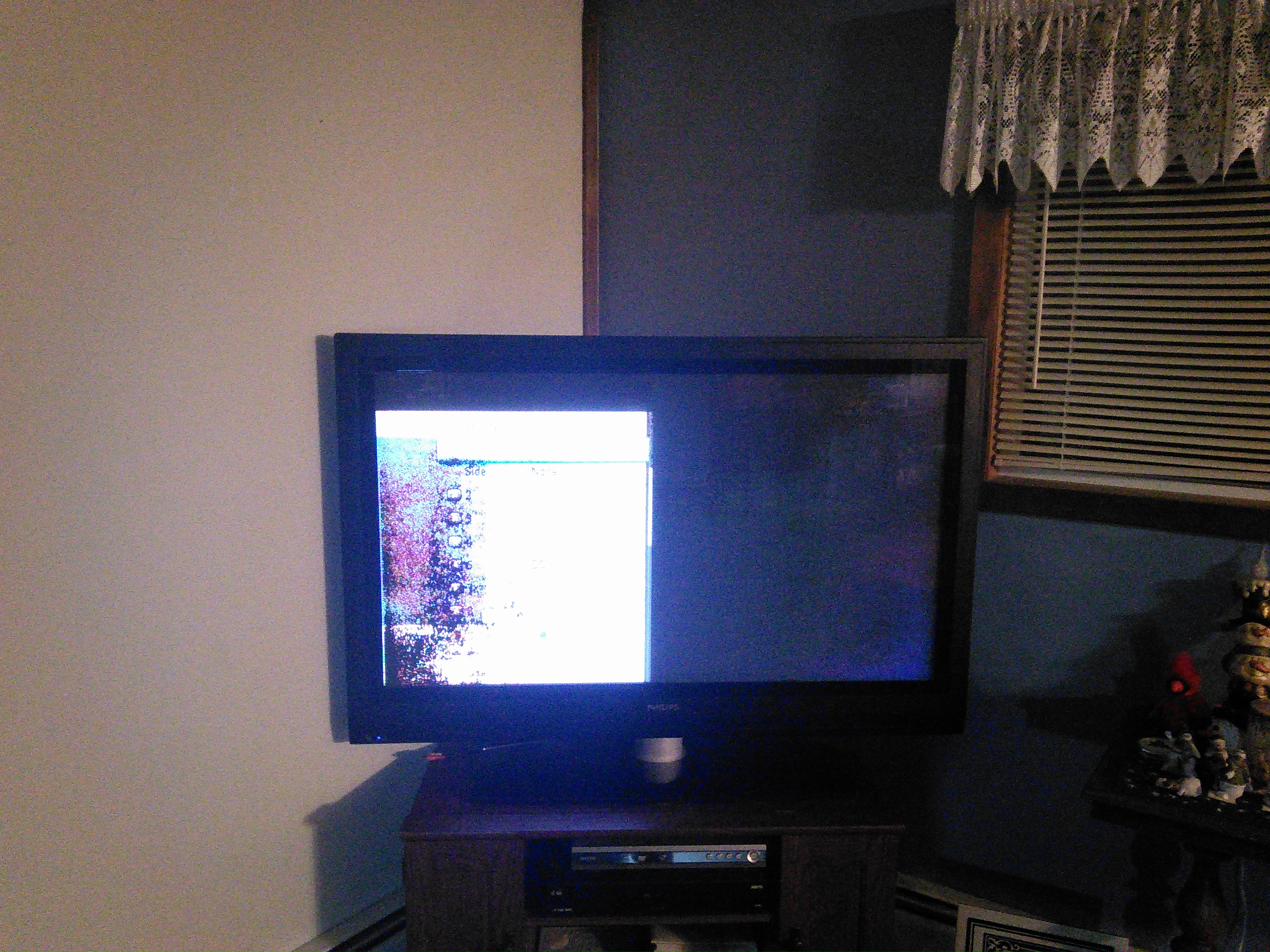

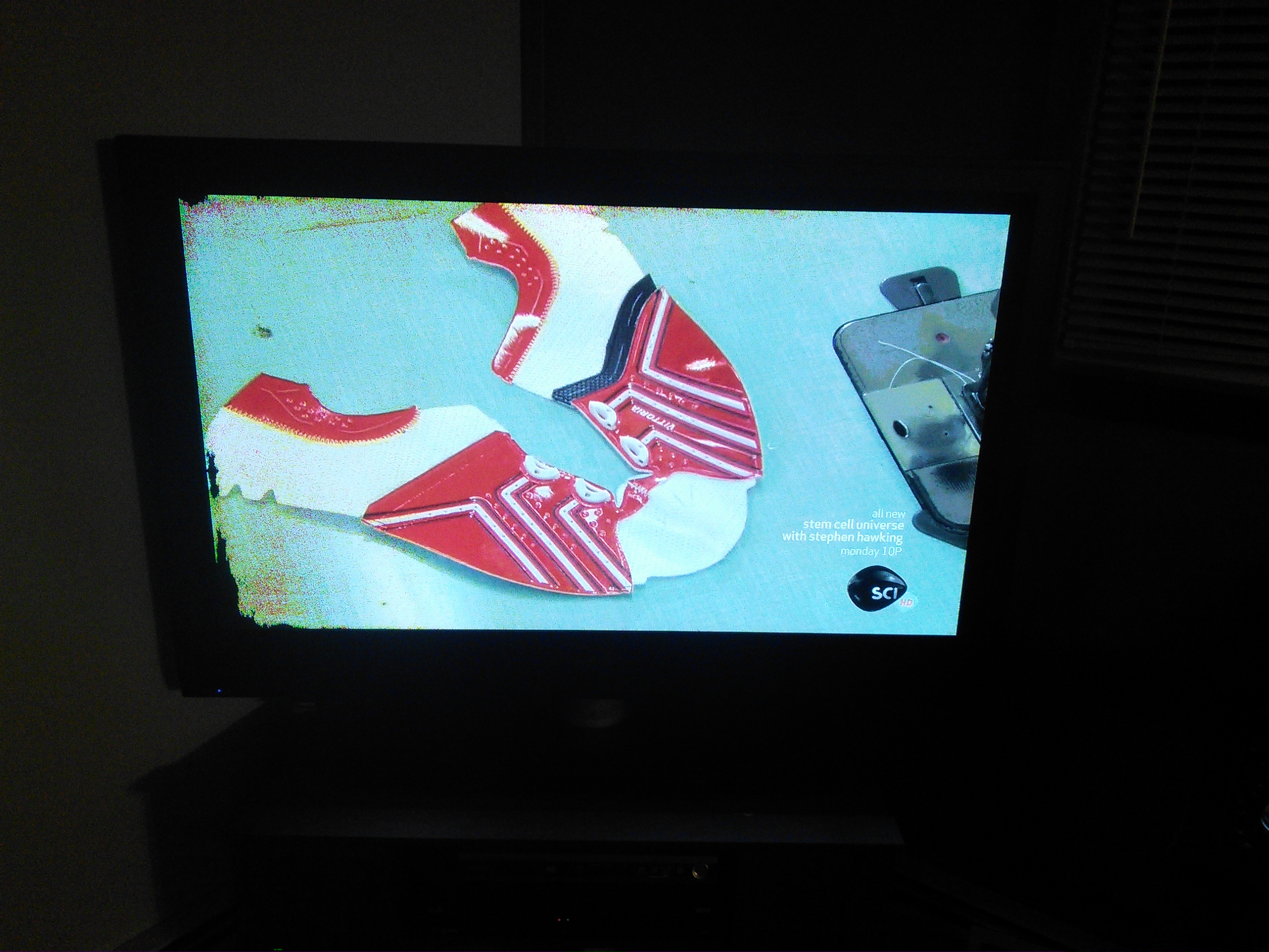

    Got this free TV from a friend. It is a 50" inch plasma. When first turned on from cold, the picture is overly bright and grainy. After 10-15 minutes that stops and then most of the picture is normal. Main problem is redish/brown pixels on the left side of the screen that never go away. As the scene changes so does the pixels, but slowly. In the top and bottom corners on the left is solid brown/black areas. They dont move. I have included some photos. If put on a pause or menu display, the red will slowly improve to a degree. Any thought on if it is fixable?

        Regarding the fault, it looks like the reset ramp on Y-main is poorly set.
