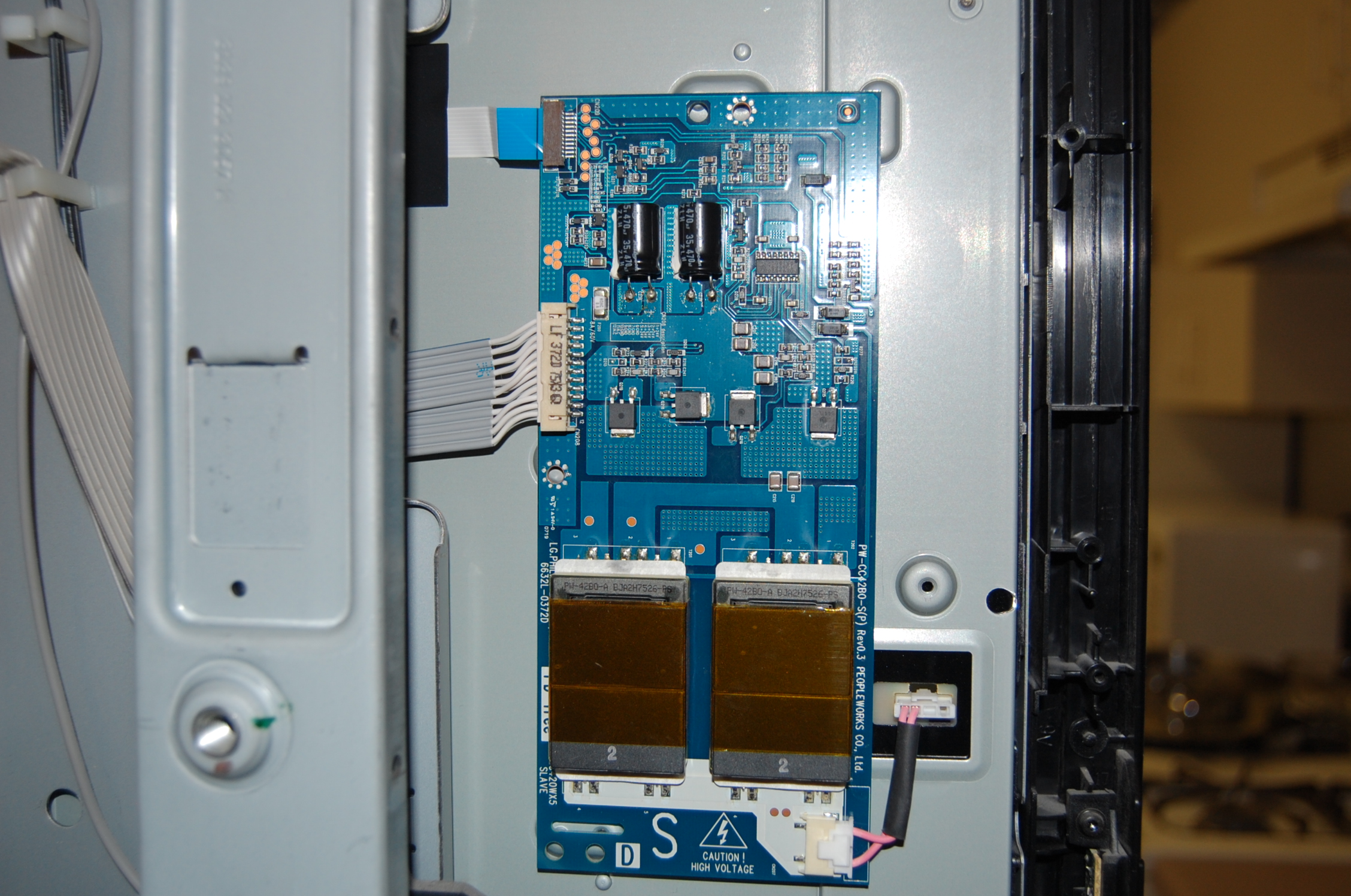

    Hey guys.. i have a 42pfl5332d/37 Philips that's playing tricks on me.. when i press the power button from either the remote or from the tv, the backlight comes on...assuming everything is okay. Tired of watching tv, i then turn the power off. five minutes later, I turn the set back on, but there no backlight. I just can't figure it out, and was hoping you guys can guide me in the right direction. I provided a link to my video showing the symptoms.. Also, if someone can show me the right setting on the multimeter for testing would be helpful.

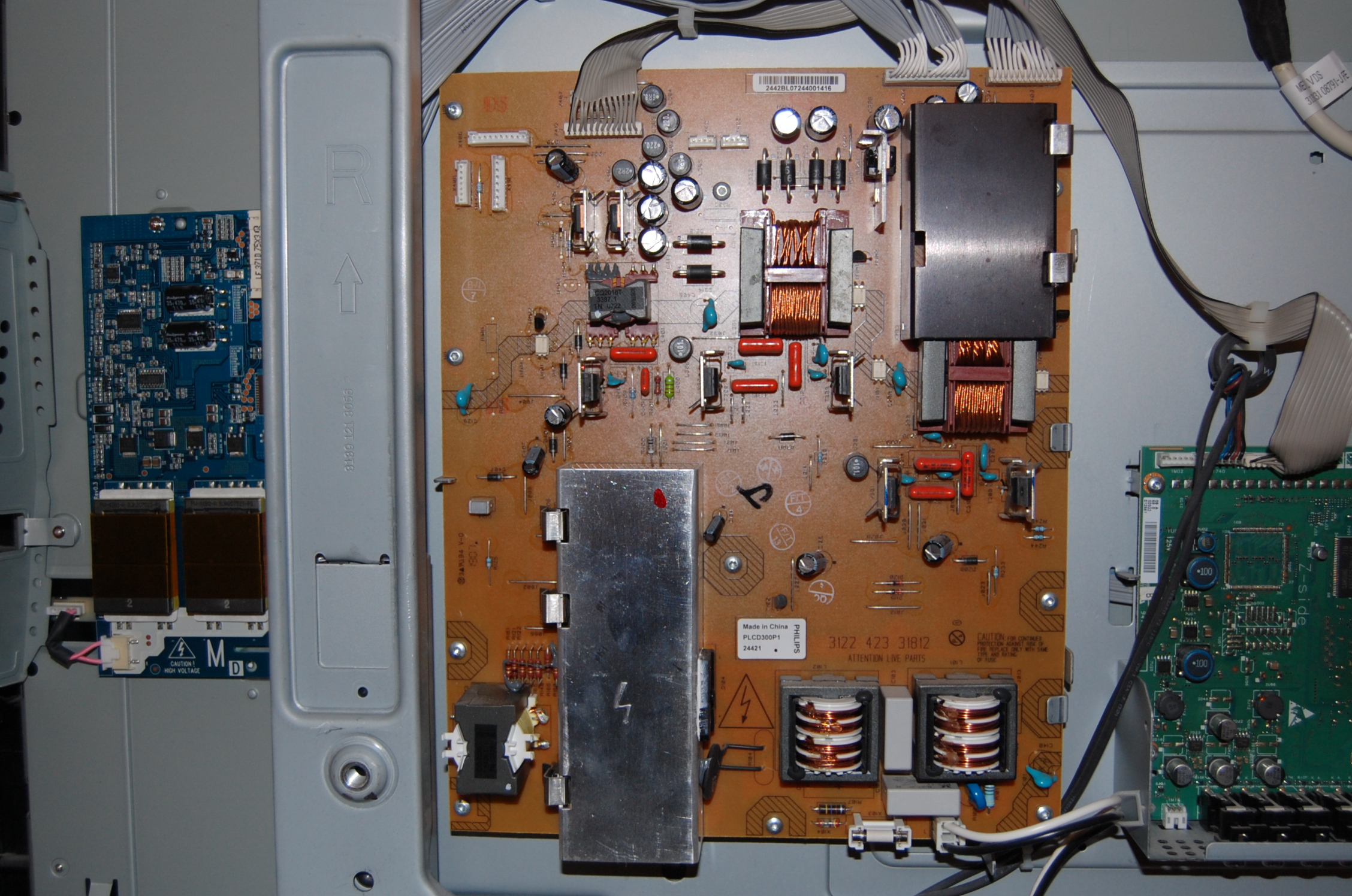

    you have it on the right setting for testing anything under 200 dc volts. your slave inverter is working intermittently i am assuming. when it does work did you get the 24 volts on the slave? the 1 on the right looking at it from the back.

        Yes. When the backlight does come on, the first five pins read 24 on the slave inverter, as well as where it's connected on the power supply board.

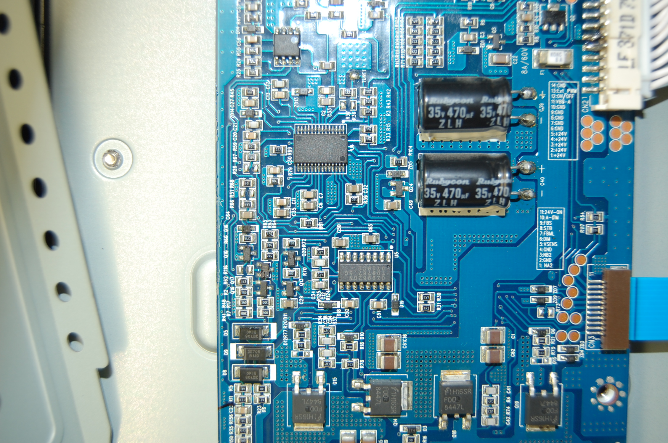

            check the ic with 26 legs located to the left of the caps in your pic of the master inverter board to see if it has any tiny pin holes or the legs are broken i can't really tell my looking at it in the pic but this problem doesn't state it is intermittent but check to make sure

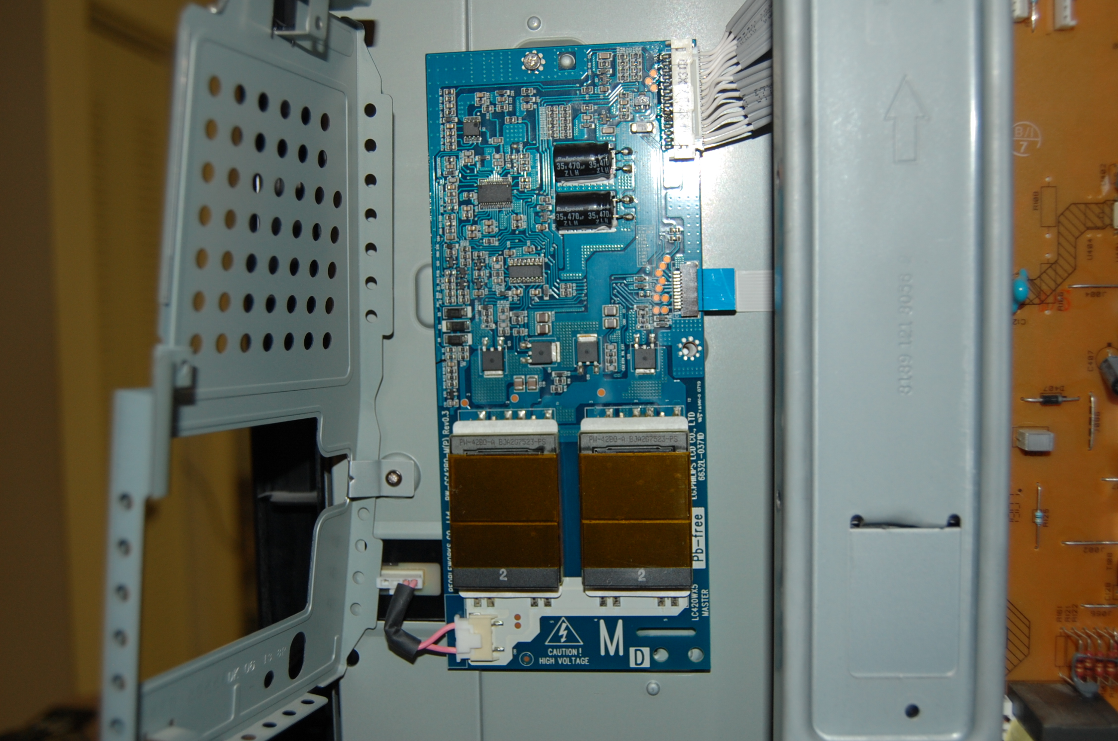

                    in that pic you just took the connector on the master board is it just the pic or does it look like the 6th pin from the bottom got hot at 1 time?

                      yeah.. i made a mistake and touched it with the multimeter point, and it made a spark, but the backlight issue was still present even before i did that..

                          Also those 35v 470mfd ccapacitors on the slave and master inverters in the lg philips tv's have been known to cause issues. Can't tell from the pics but do they look domed at the top, leaky? I would replace them first.

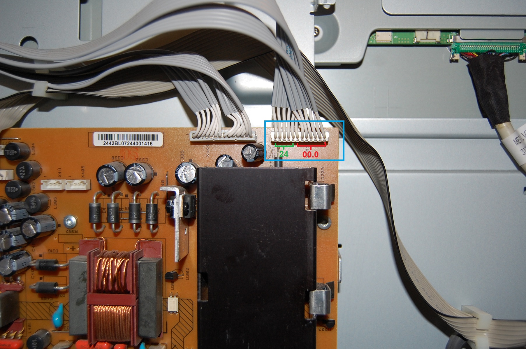

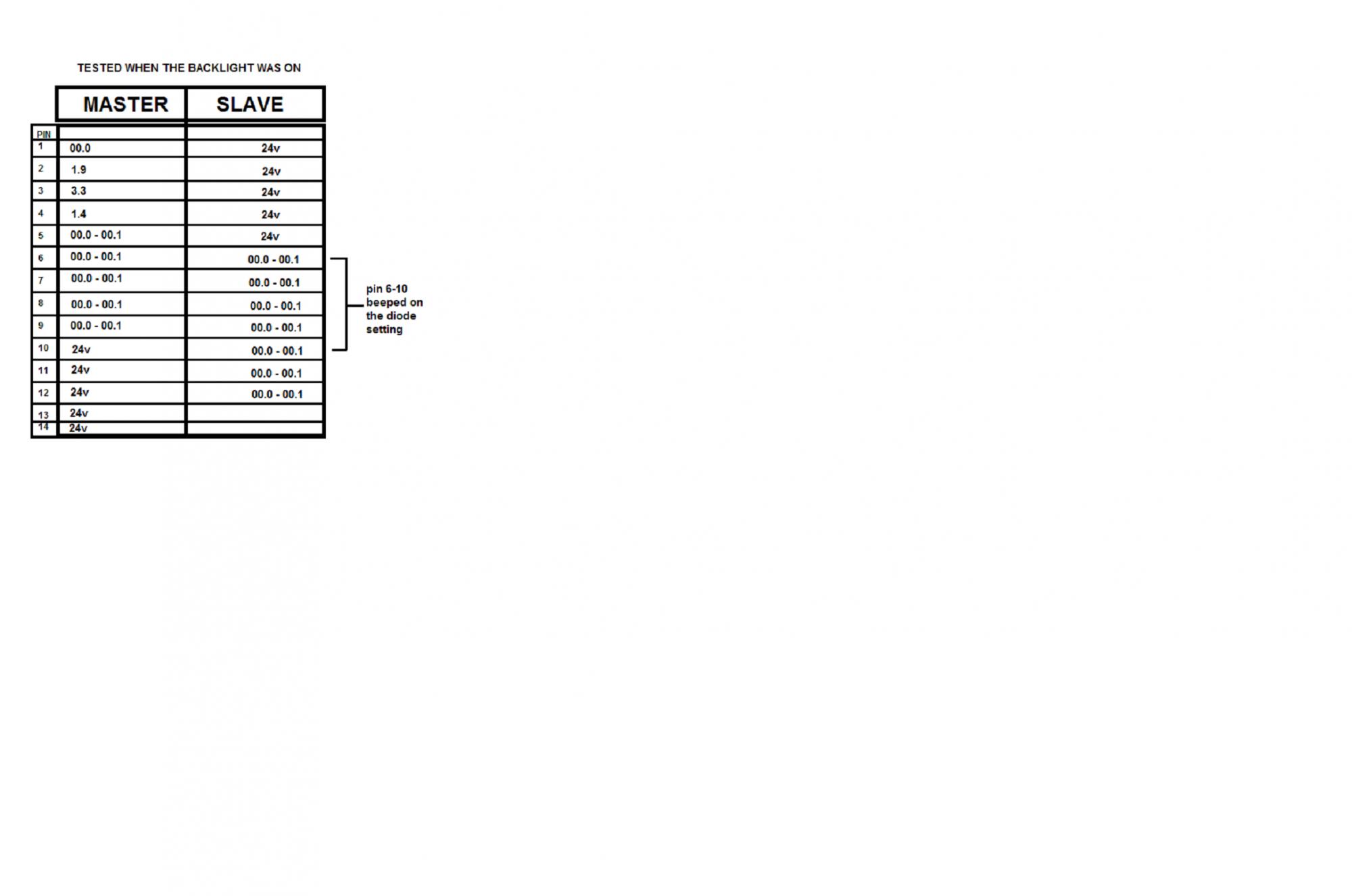

                                  The power supply board doesn't have any labels at all.. Or maybe i don't understand.. In any case, i get 24v from both master and slave when the backlight decides to come on or not. That test was done from where the inverter plug into the power board.. The only difference is that the slave only gives me 24v in the first five pins, and the rest of the pins reads 00.0. thanks guys for responding.

                                    I believe the other pins that Give you 0 are grounds. But there should be a reference pin for backlights to turn on there somewhere. Ohm the pins that give you 0 against ground. One of those that have no power but does not ground out may be your backlight on pin. That should be like 3.3v thereabouts
                                    Best to measure with your meter set to diode range so you can take black lead and use a ground point on the TV red lead on each of those pins that give you 0 see if your meter Beeps

                                      either Pin 11 or pin 12 on the right-hand board should be your backlight on signal

                                        here is a picture of the test results..The test was done while the blacklight was on.
