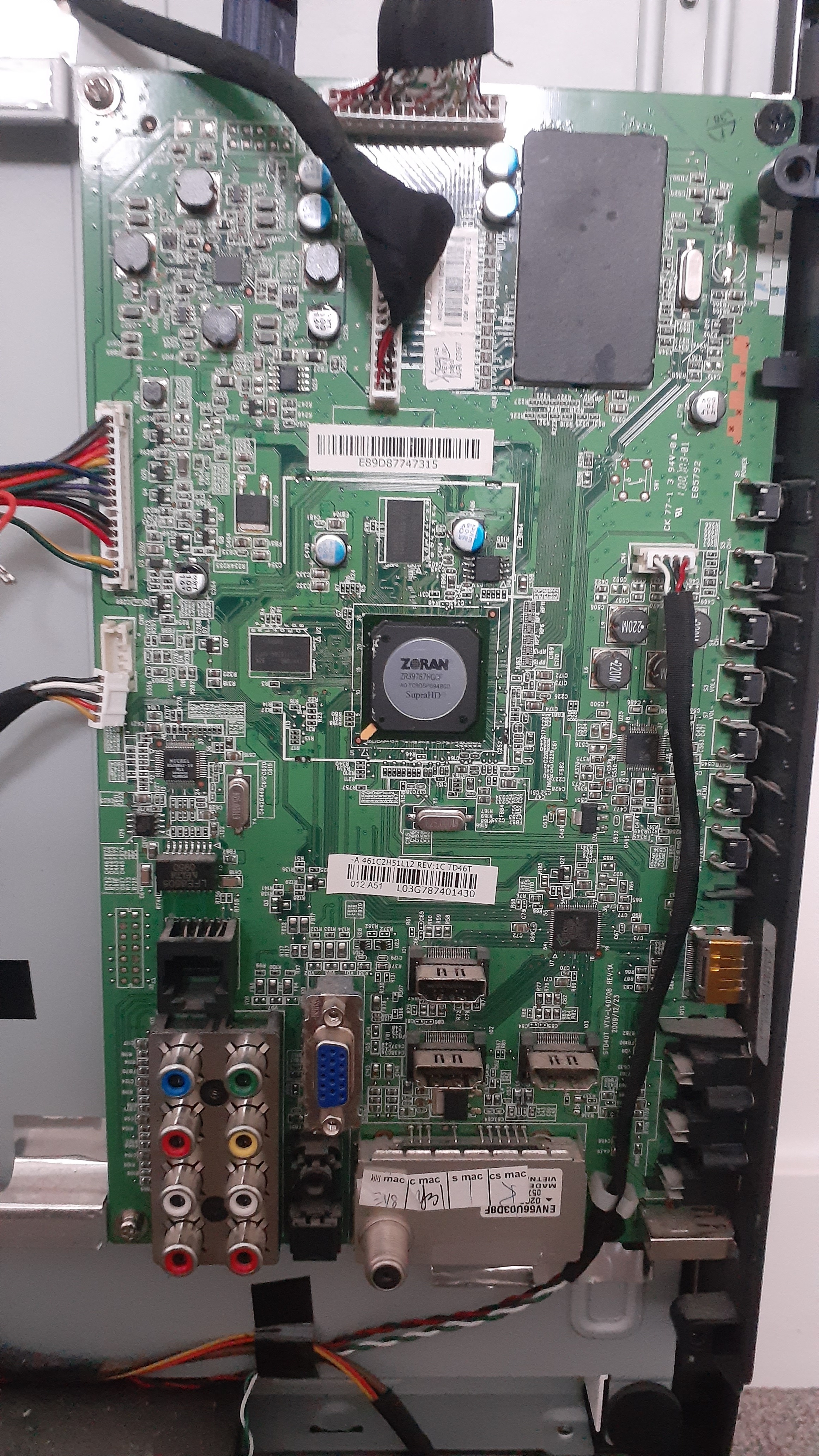

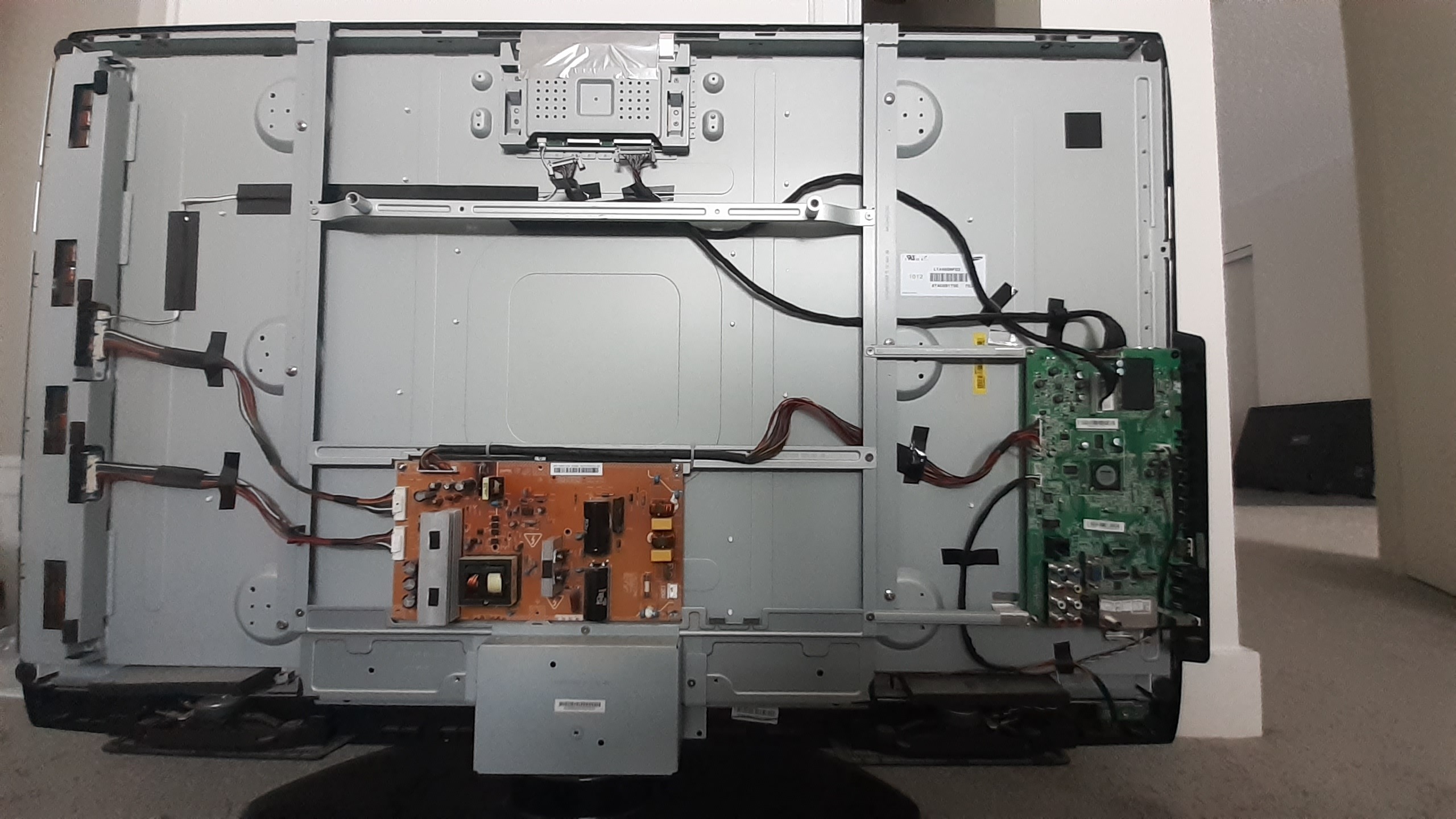

My friend requested to fix his faulty Toshiba LCD TV model #46G300U1 (461C2H51L12 Rev:1C TD46T).
When I plugged it to a wall socket the front Toshiba logo white LED flash once.
I have extended the 5v with a resistor to Inv pin and backlight is good.

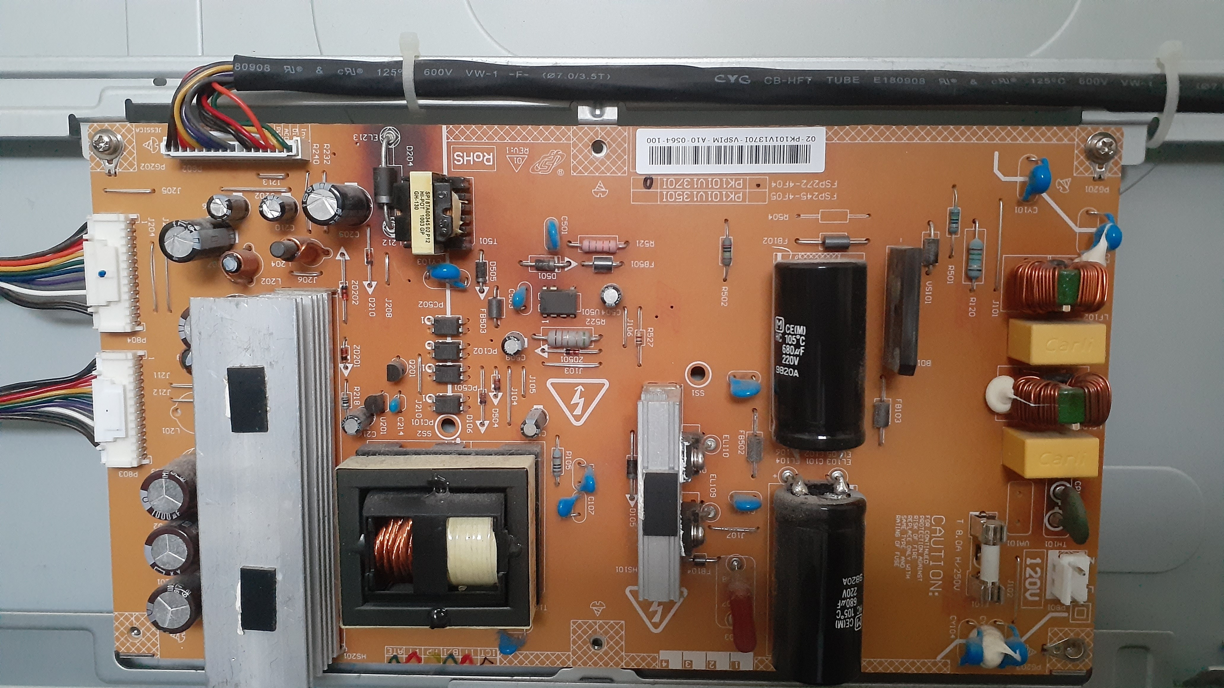

I checked the voltages in power board P802 as below and attached the photos for reference.
BIOS chip above CPU has VCC 3.3v
PSU P802

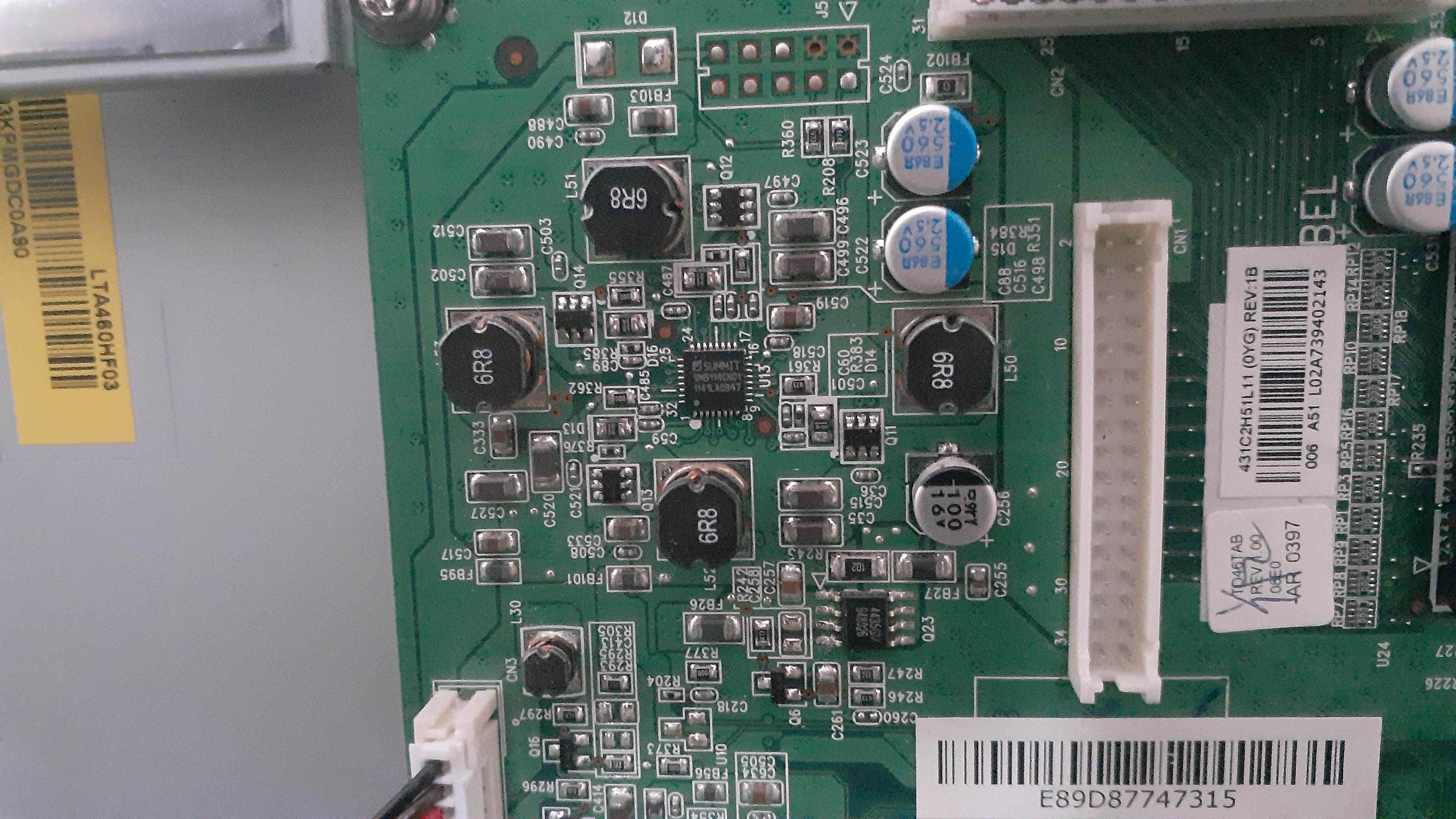

Regulator IC
Inductor
Regulator ICs 1.2v/1.8v/3.3v/12v are present.
Panel / T-CON fuse - 12v not present
status LED indicator - not Lit
Removed the BL Inverter / LVDS cables to narrow down the issue and measured those voltages.
I can upload more images if close look of any specific area is required.
Is there any way you can help me with the TV? It will help us to avoid E-waste.

PSU P802
Pin# | Voltage | W/o MB | With MB |
1 | GND | 0 | 0 |
2 | GND | 0 | 0 |
3 | 24V | 0 | 24.1v |
4 | 24V | 0 | 24.1v |
5 | GND | 0 | 0 |
6 | GND | 0 | 0 |
7 | GND | 0 | 0 |
8 | 12V | 0 | 11.8v |
9 | 12V | 0 | 11.8v |
10 | NC | NC | NC |
11 | 5V | 5v | 4.9v |
12 | 5V | 5v | 4.9v |
13 | PWR | 0 | 3.6v |
14 | ACD | 5 | 0.06v |
15 | Dim | 0 | 0.08v |
16 | Inv | 0 | 0.01v |
Pin# | Q11 | Q12 | Q13 | Q14 |
1 | 3.3v | 3.3v | 1.28v | 2.8v |
2 | 4.9v | 4.9v | 4.9v | 4.9v |
3 | 4v | 4v | 1.98v | 3.5v |
4 | 1.13v | 1.13v | 3.1v | 1.8v |
5 | 0v | 0v | 0v | 0v |
6 | 1.13v | 1.13v | 3.1v | 1.8v |
Coil | Voltage |
L50 | 1.15v |
L51 | 1.15v |
L52 | 3.1v |
L53 | 1.8v |
