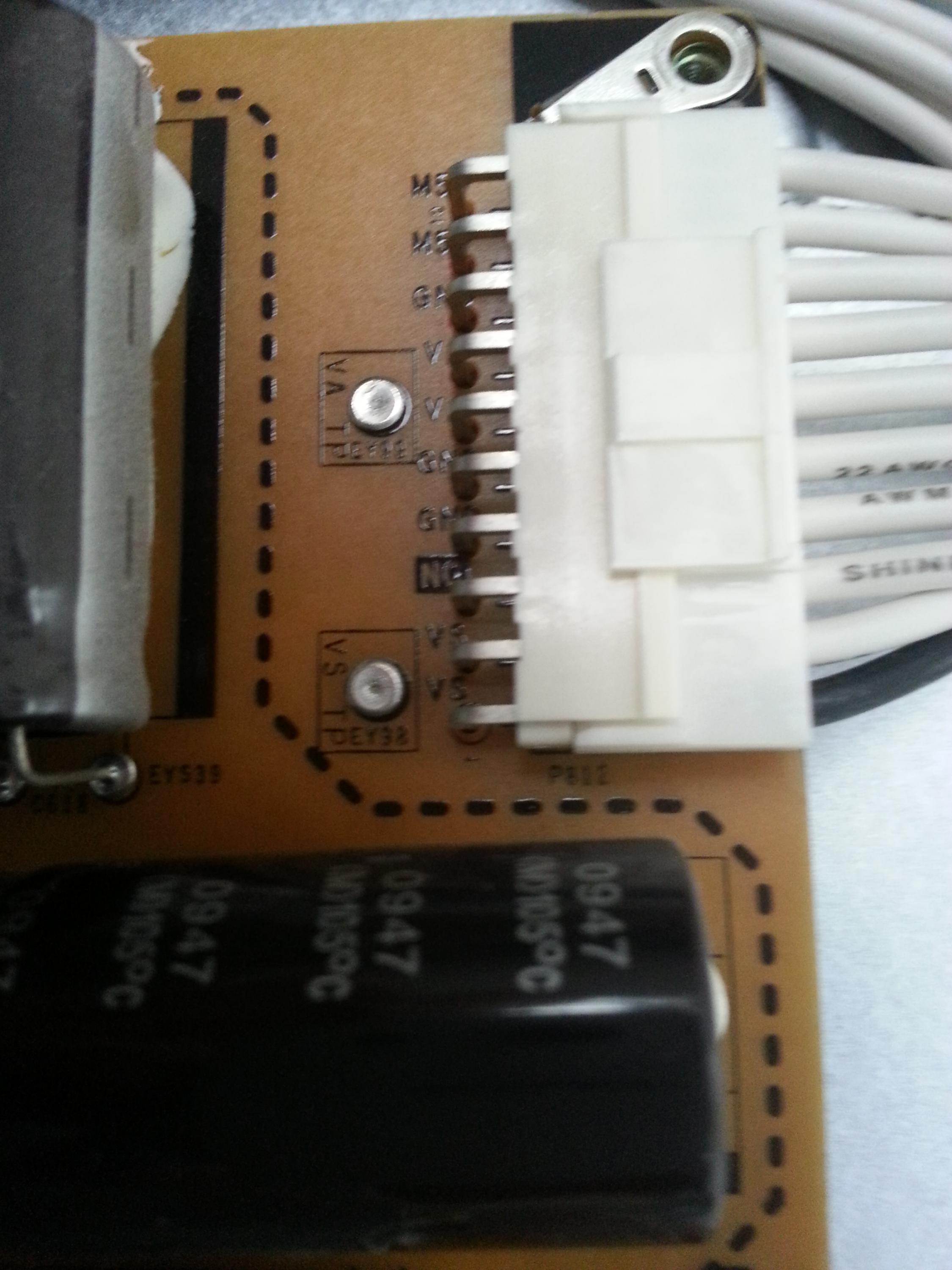

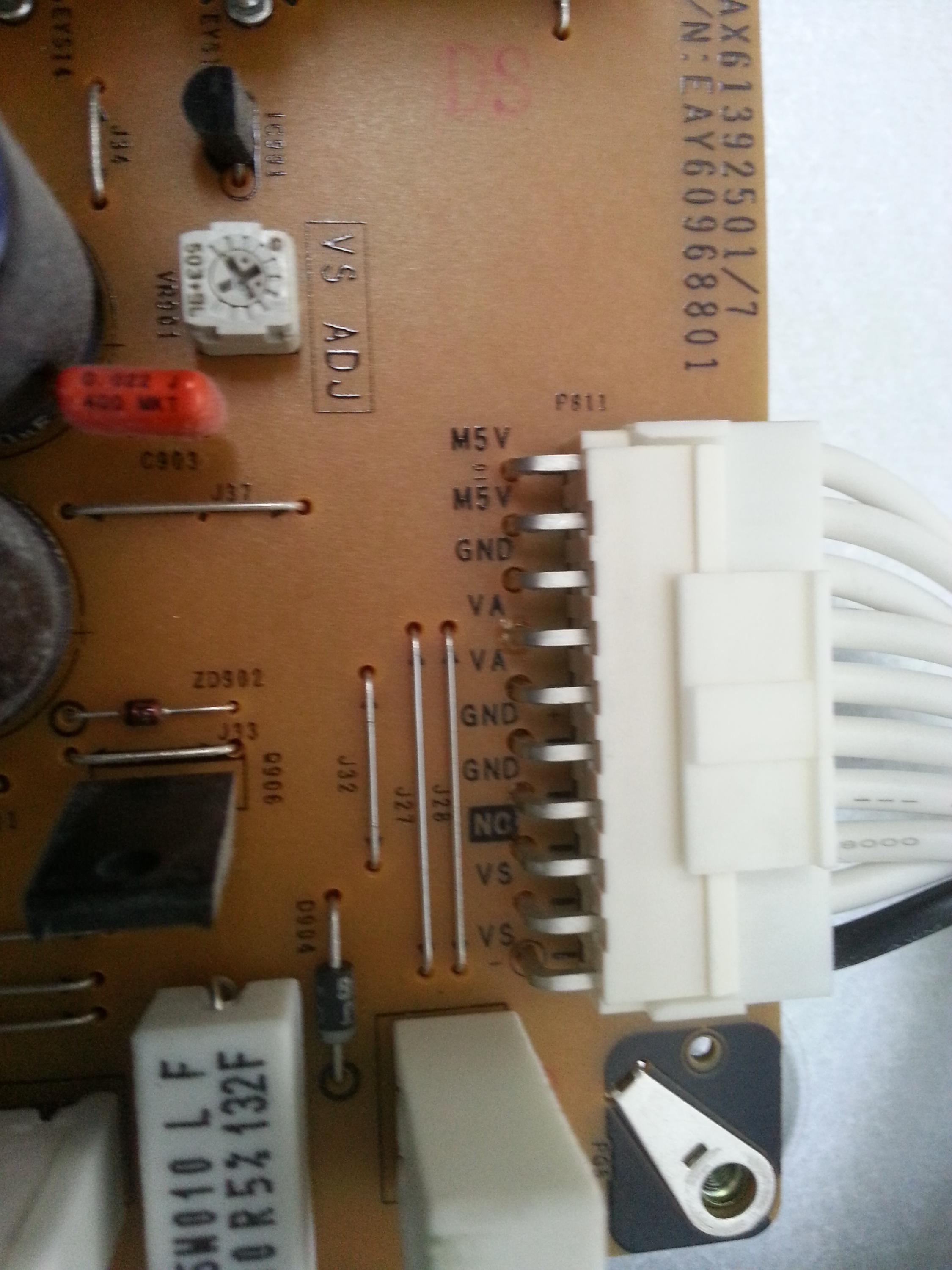

    To troubleshoot, I disconnected the Z-SUS and Y-SUS from the power board, and I was able to measure the voltages. They are as follows :
    On the power board (A)I measured :
    P811 to Z-SUS (B) :
    (M5V=5.4V, M5V=5.4V, GND=0V, VA=60.8V, VA=60.8V, GND=0V, GND=0V, NC=0V, VS=202V, VS=202V)
    P812 to Y-SUS (C) :
    (M5V=5.2V, M5V=5.2V, GND=0V, VA=60.7V, VA=60.7V, GND=0V, GND=0V, NC=0V, VS=202V, VS=202V)

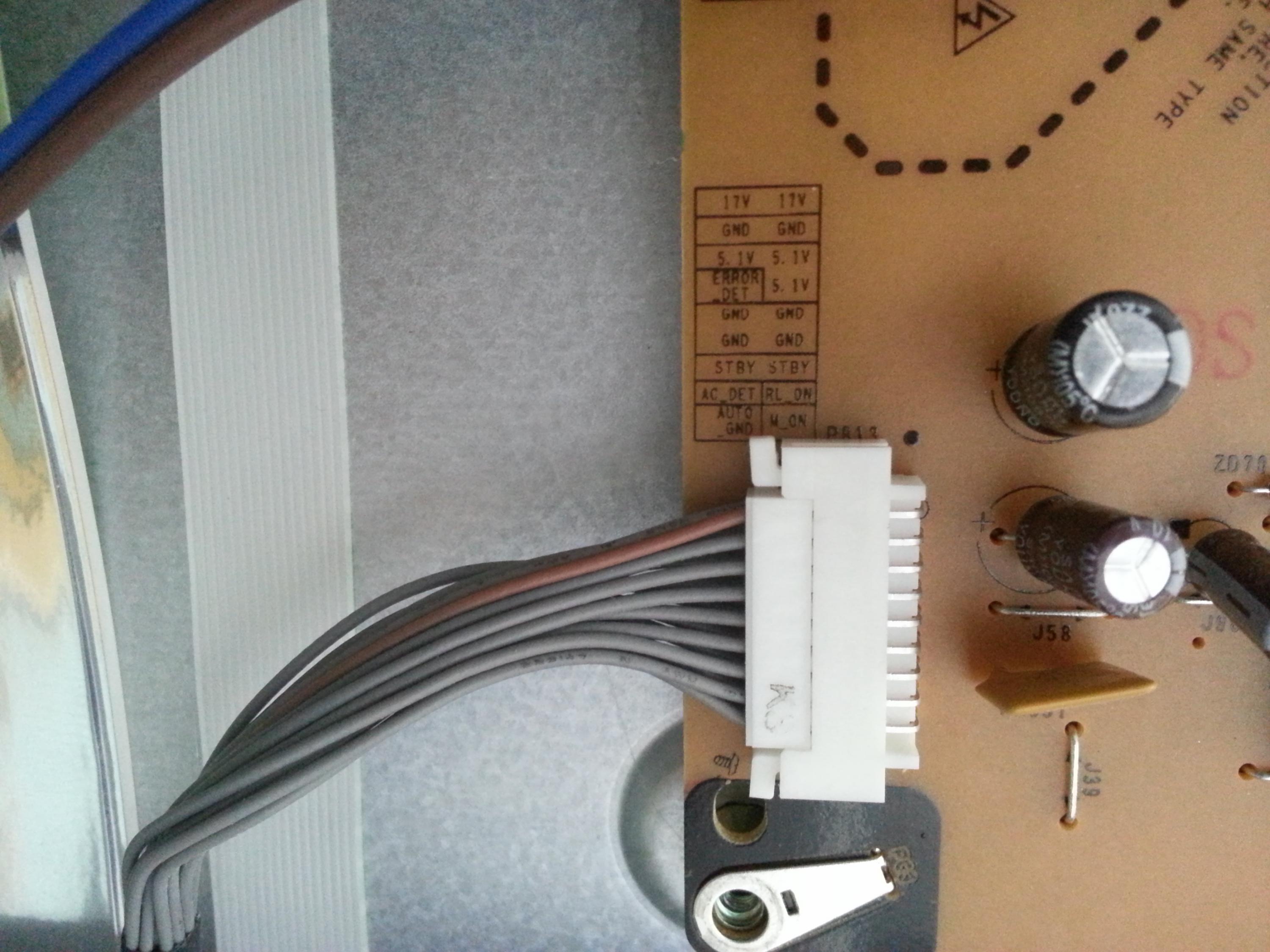

    P813 to Main Board (D) :
    (17.1V, 0V, 5.2V, 5.2V, 0V, 0V, 5.2V, 2.3V, 3.2V)

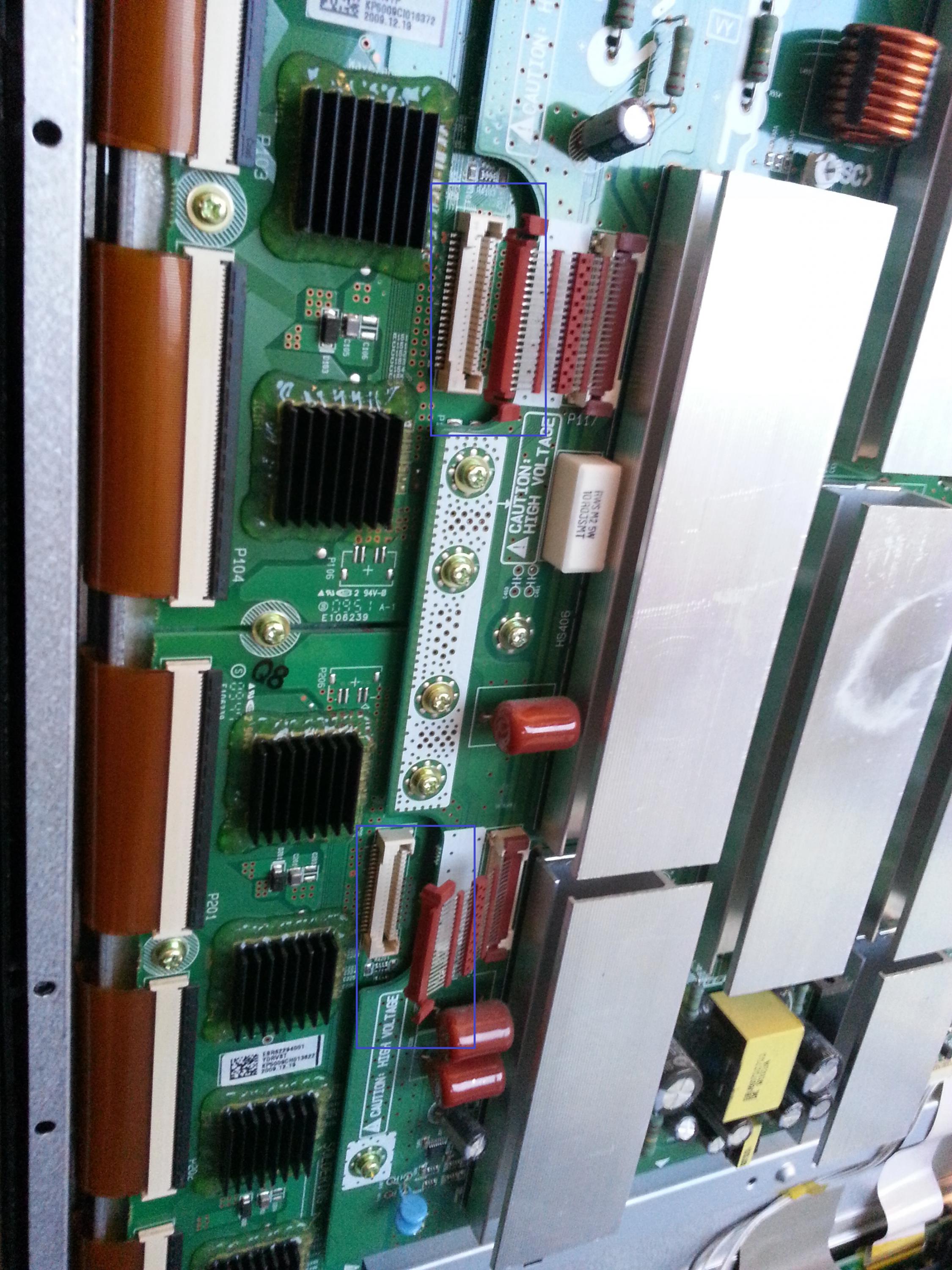

    When I connect just the Z-SUS (B), and power up, there is no picture, but the sound is on. The device is able to sustain power.
    When I connect just the Y-SUS (C), and power up, it flashes “grey” and shuts off shortly after.

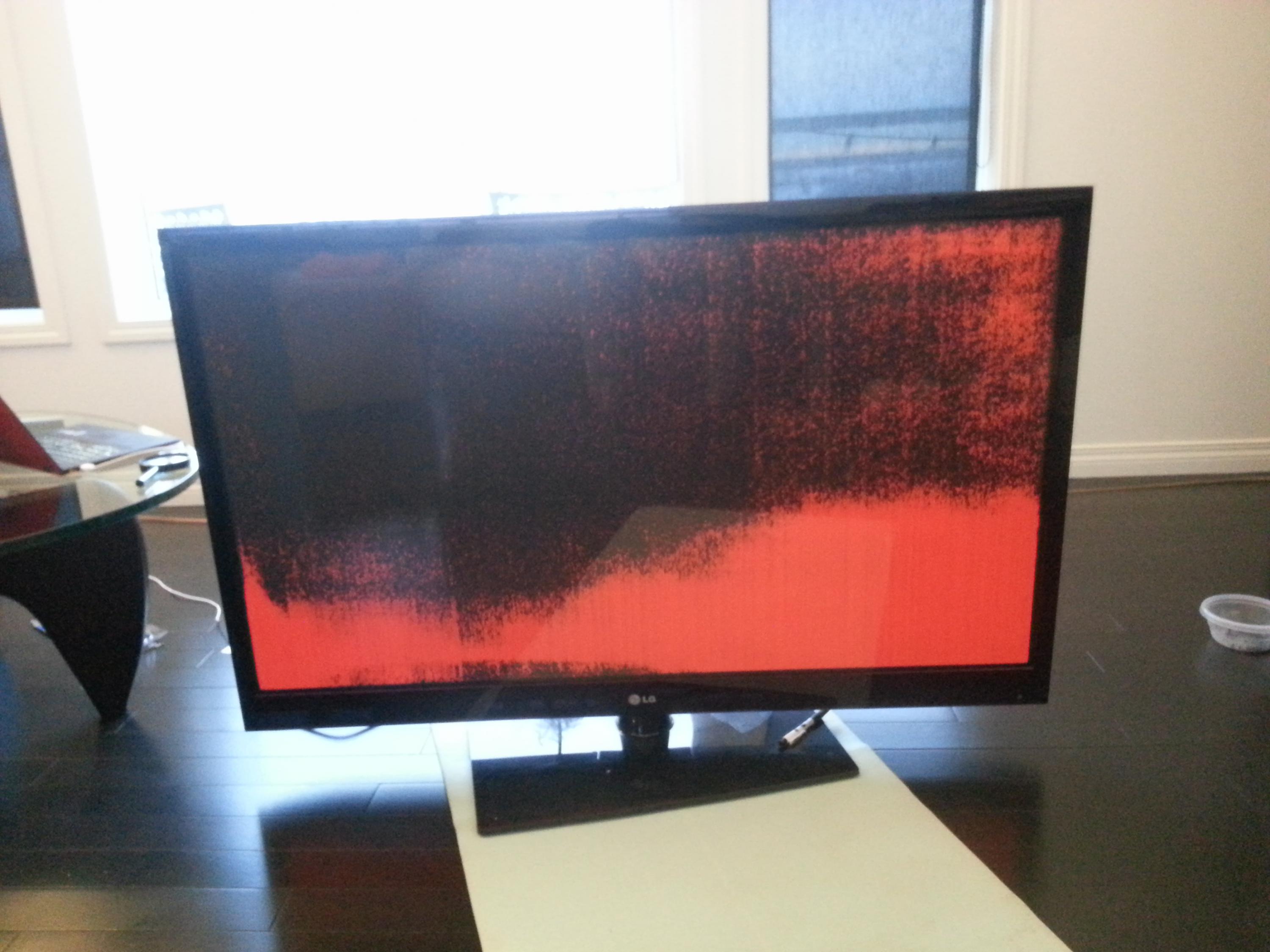

    When I connect just the Y-SUS (C) – but remove the connections to (1) – the unit powers up, flashes a red screen for a few seconds and then shuts off.
