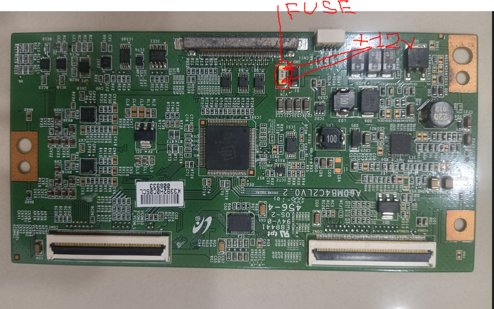

                      1. Searched drawing and board for fuse on TCON board, couldn't spot. Attached picture showed where I tested on T-Con board input from power board - marked values - readings the same both sides of SMD's
                      2. Used HDMI input from Rpi playing video (started with another screen then swapped HDMI cable to TV), no sound or picture observed with flashlight.
                      Going by results of 1. 12V side supply to TCON from powerboard appears an issue?

                            That isn't his tcon, Wodger post a good clear picture of your whole tcon not just a portion of it.
                                      Apologies for the delay (too many things broke over new year so got busy).
                                      Attached is a picture of the TCON board.

                                        Ok, so the fuse is white, labeled F1, what is the voltage of each side, neg probe on chassis ground.
