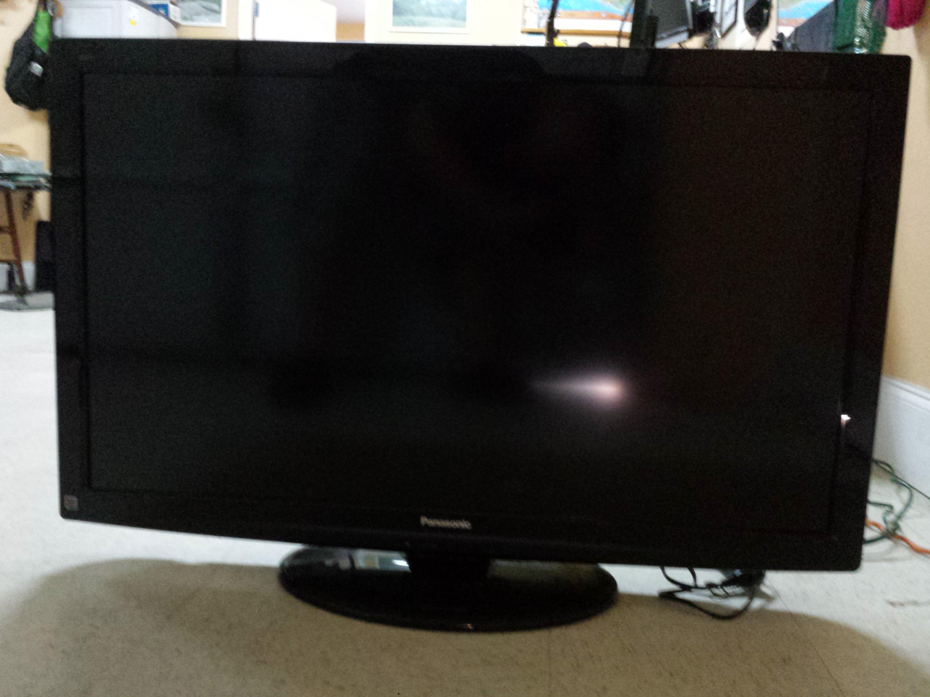

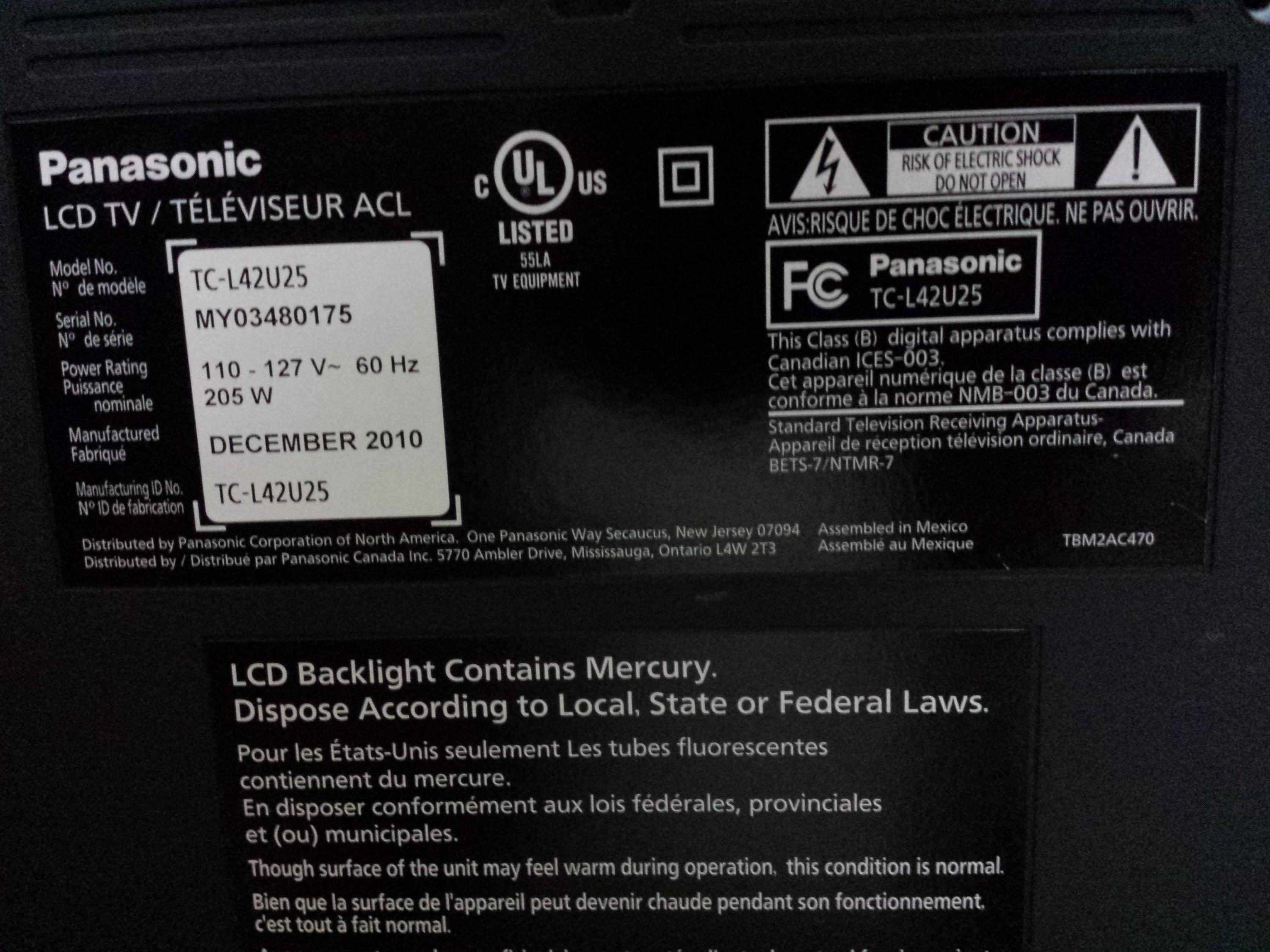

    Hello everyone!, I`m wondering if anyone can help me out with this problem on this Panasonic TV. It has 9 blinking red lights coded in it. I have attached two images to show you how it looks.[/ATTACH]
    Thank you in advance.

    my mistake. the model is TC-L42U25 LCD panel, any one have same issue?
      Re: Panasonic TL-42U25
      Training manual:-
      http://www.tgohome.com/ServiceManual...&Search=Submit
      9 blinks Sound SOS. Page 48.
      Check speaker cables are not pinched against metal frame. Try removing one speaker at a time, including any tweeters if present.
      9 blinks may also indicate t-con failure though that could be a typo as the rest of the manual indicates Sound SOS.
