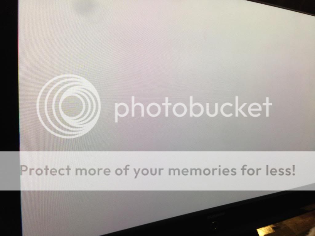

            Ok, I got back in there and setup the TV with pins 3 and 4 jumpered, and the rainbow connector removed. I used the remote and the set powered up. I got a full white screen with no apparent defects.

                    Ok, well, I went and removed the main(SSB) board all together, and jumped pins 3&4 of CN2009. I also jumped PS On and Rtn on the Power supply. Plugged it in and got a solid white screen. Turned it off and switched to 1&2 of CN2009. Same result, solid white screen. I'm thinking the test patterns are not avail on this module. Either that, or it requires a sequence to begin.

                        So, because it would *seem* that the defect goes away with the test pattern, that would suggest that the problem exists on the main board?(SSB). If that's the case, I'm all for component changes whenever possible as opposed to complete board changes. I wonder how this can be narrowed down to where the signal is getting goofy.

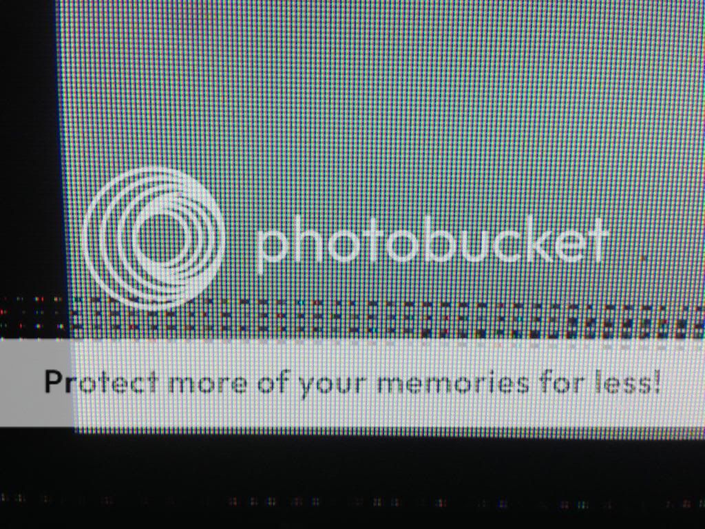

                                Since the main board is the only component out of the circuit while in test, and the normal defect includes colors other than white in the bar across the bottom that are not visible when in test mode, I presume there is something amiss on the main board.
                                Does anyone have information on how this can be narrowed down on the main board to the suspect part?

                                  The defect exists regardless of source selected. I went ahead and did a plain white screen input from my computer, this is the result....(lower LH corner for detail)

                                    Re: Samsung Plasma HP-S5073 Sparkle
                                    I instantly think main looking at that. Especially as the White Screen showed no issue with the panel
                                      I am torn between main and control board.
                                        could it still be the control board even if the discrepancy is gone while set to test mode? ...well suppose it could be... Which tends to be more prone to failure?
                                          Main boards fail a lot more. It is less likely to be a control board on full white pattern but I do not know if that fully tests onboard RAM.
