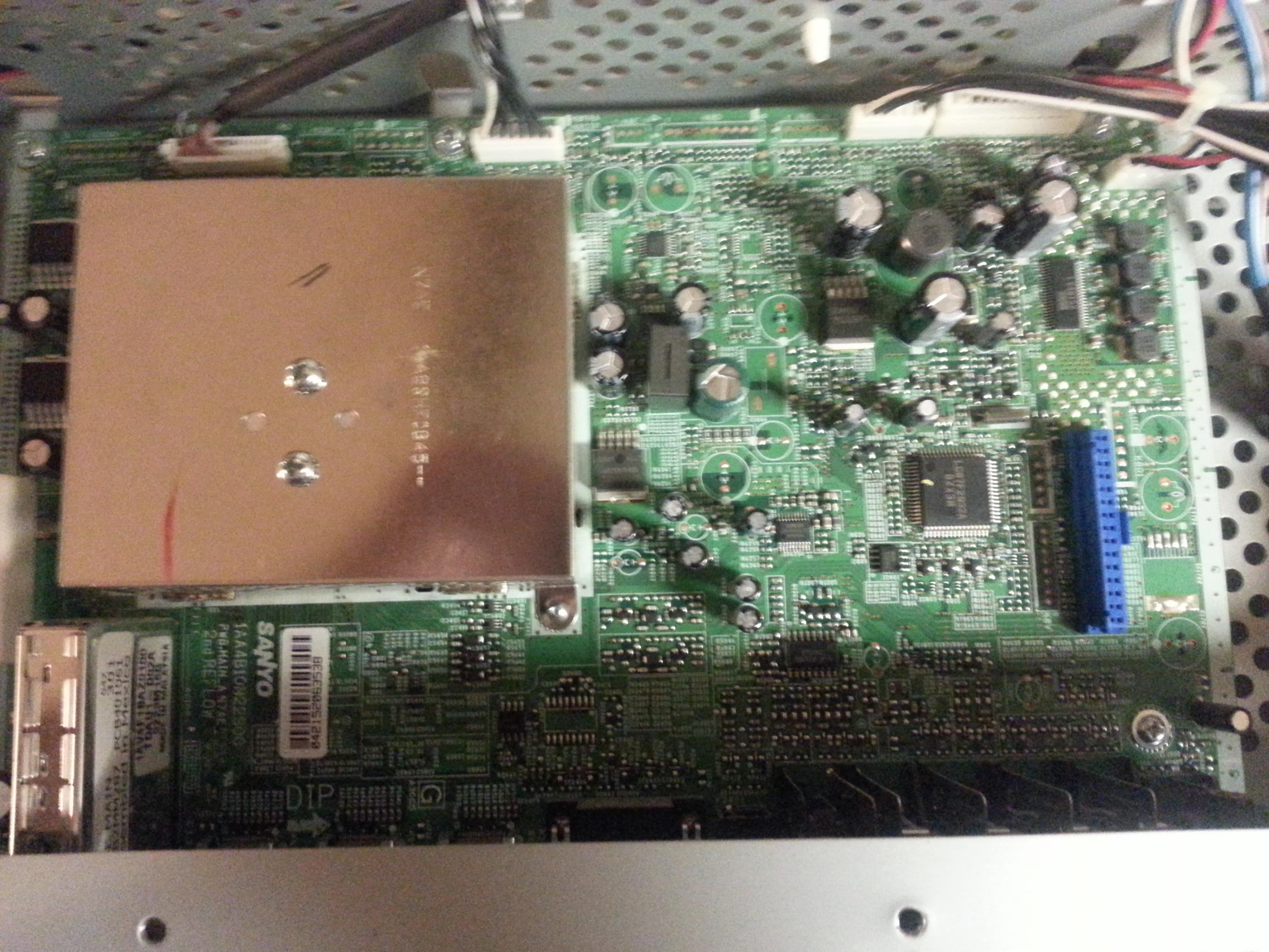

        Re: 50" Sanyo Plasma picture going white
        Since you said only the picture is affected it is almost certainly a main board fault.
        Does it happen on all inputs - for example HDMI, component, CVBS, etc?

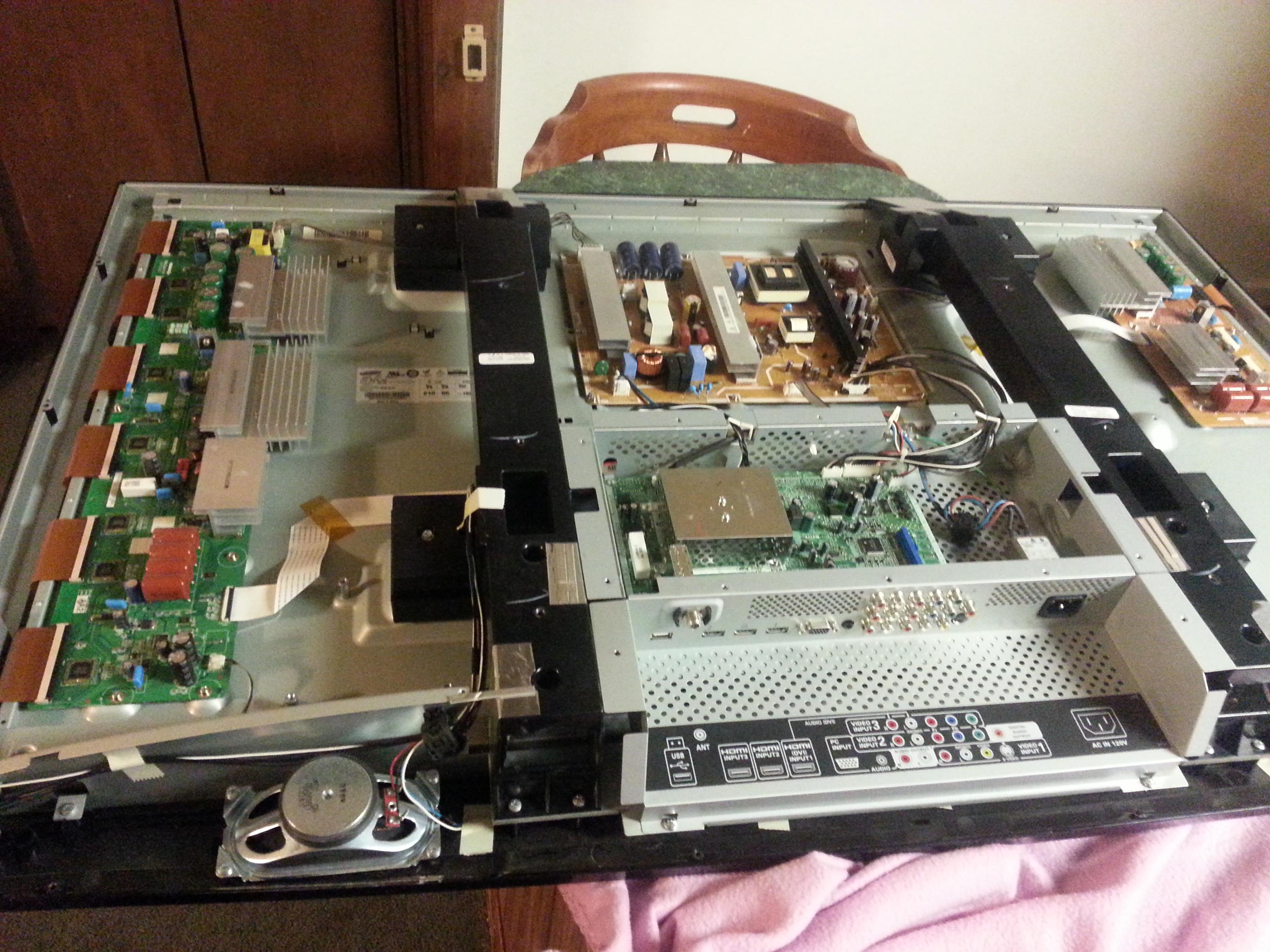

          Yes it will happen on all forms of inputs (hdmi, cable, components). It is kinda like when the tv warms up then it starts acting up. I forgot to mention that it first started this summer and I bought a small fan to help move air behind the tv and it worked ok for a couple months. Now it seems like does it just about every 10 minutes. And if we turn the tv off and back on, it will work fine for a little while.
          I have the tv off the wall mount and have taken the back off to blow out any dust and to try and see any bad connections. But unfortunately I really don't know what I am looking at.

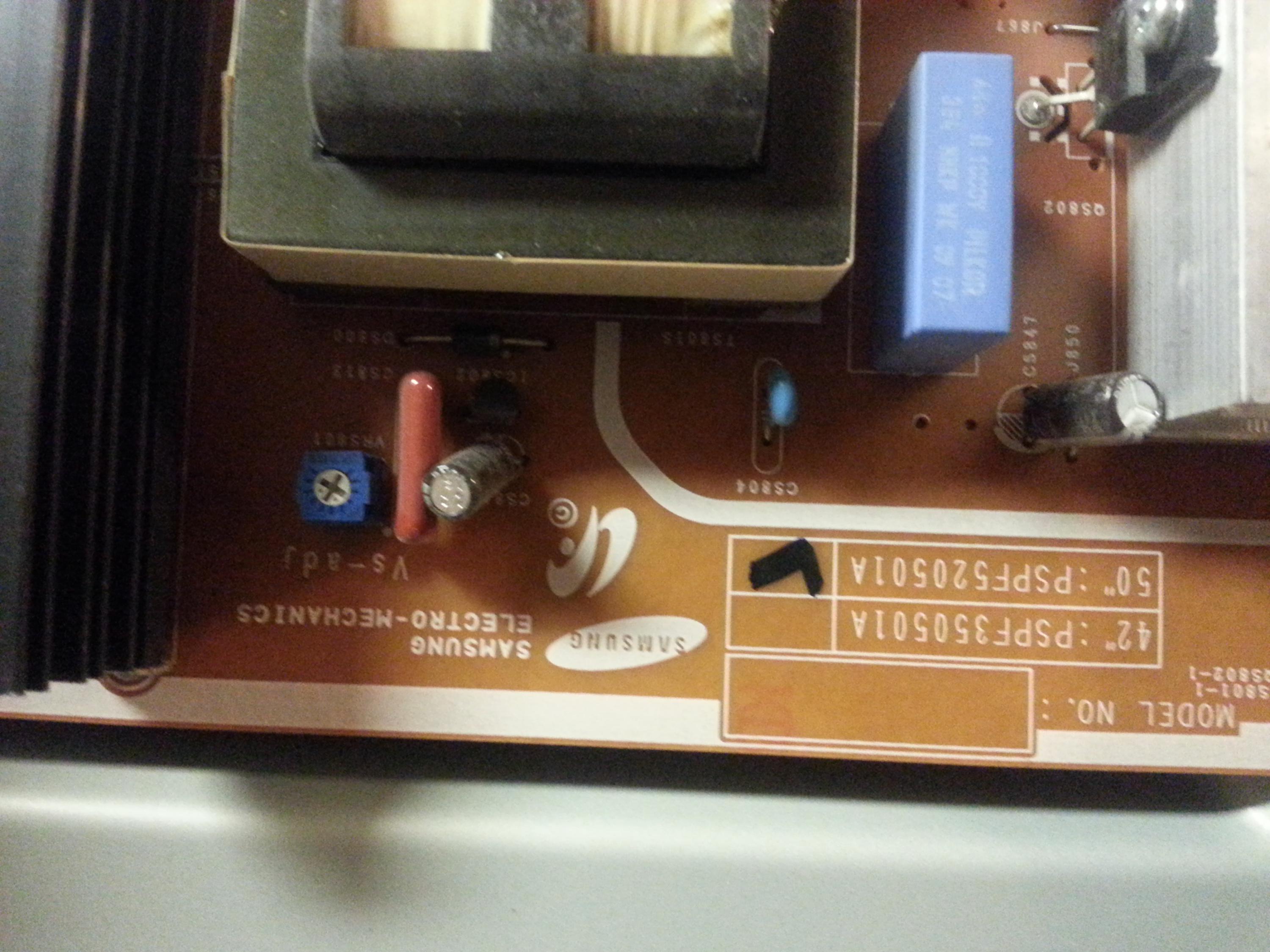

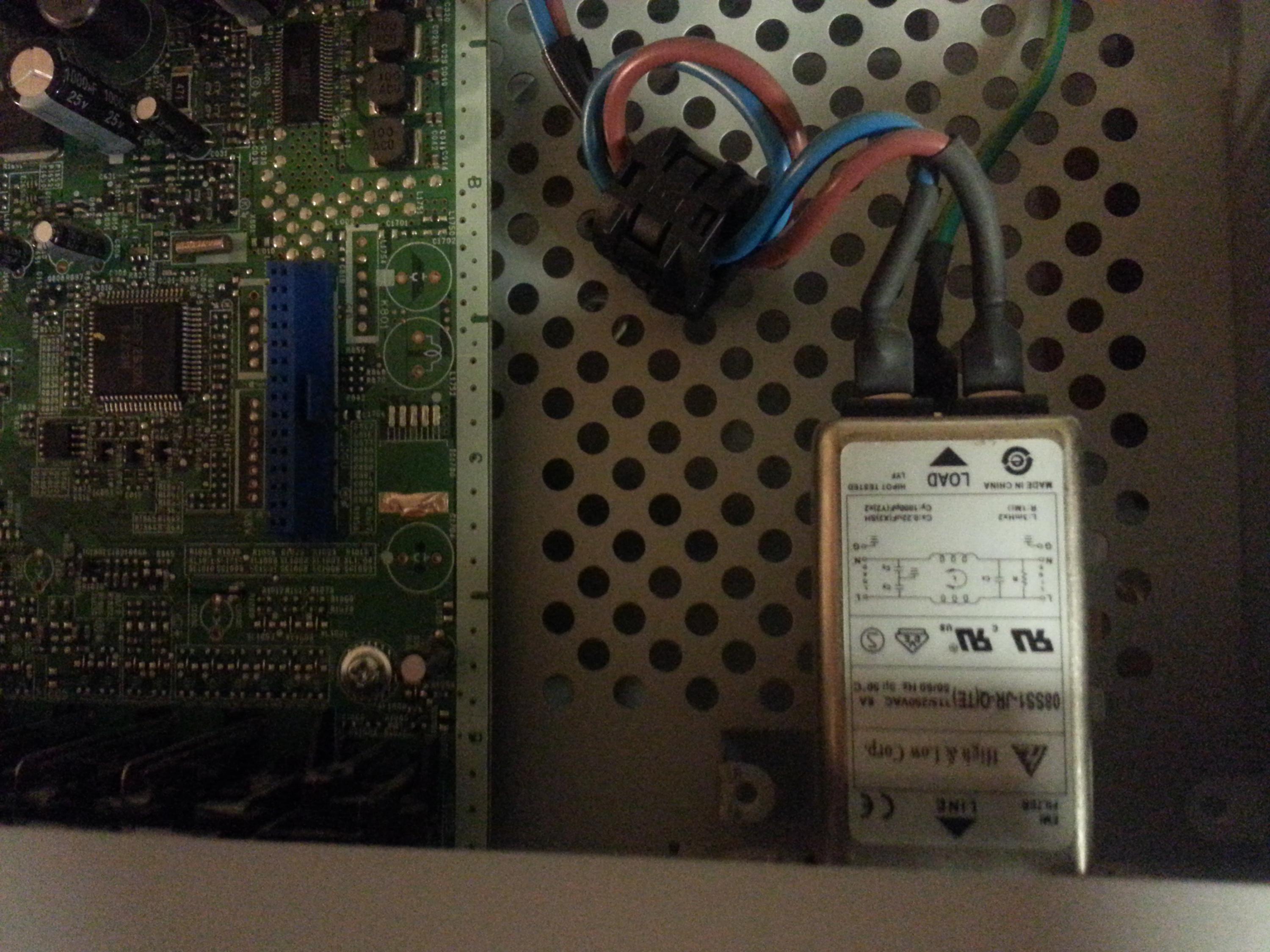

            Well I cleaned up all the dust and checked all the connections on the different boards. I even ohnmed out all the fuses I could find to make sure they are good. I got the TV put back together and reinstalled all the components and hung it back onto the wall. And I have to say, when I turned it on, the colors were clear and bright. But of course about 15 minutes later it started acting up again. I am not sure if it is getting real white/dark or just darker than it should be. It's just to difficult to see the picture. And as I said above, everything else works fine and the unit does not turn itself off.
            So if this is a bad main board, which board am I looking for to be bad? Is it the main mother board J4FE that every site I looked at says out of stock. Or should I be looking into one of the other boards, and how do I test them? Or should I take it to a shop for them to diagnose it for $65 and then parts and labor. (which may be as expensive as buying a new TV.
            I know I am asking a lot, so please bear with me. I am a single father with full custody of my 5 kids, so money is tight. And the fact I have my 6 yr old daughters birthday coming up followed by Christmas, I just can't afford a new TV rite now.

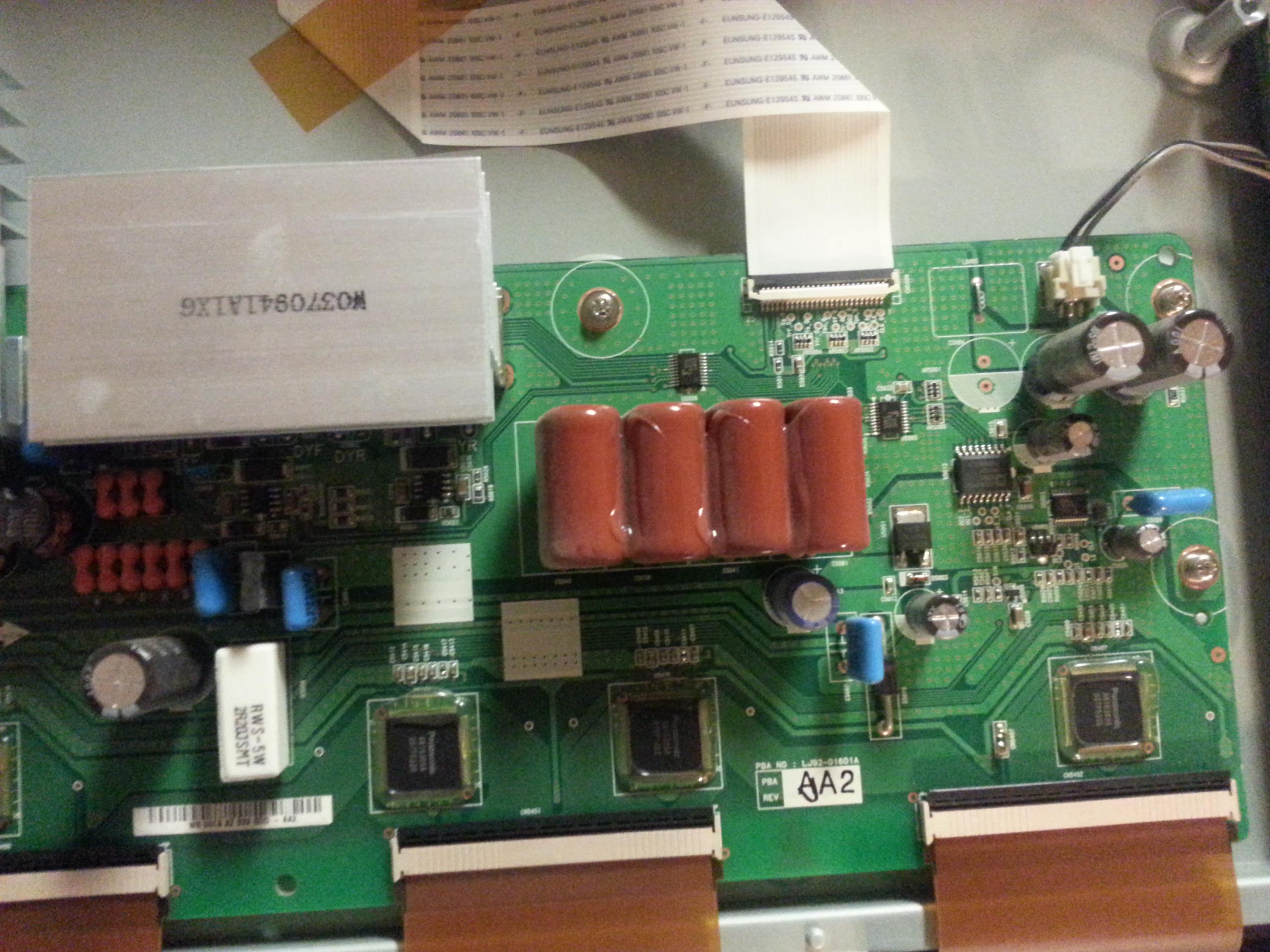

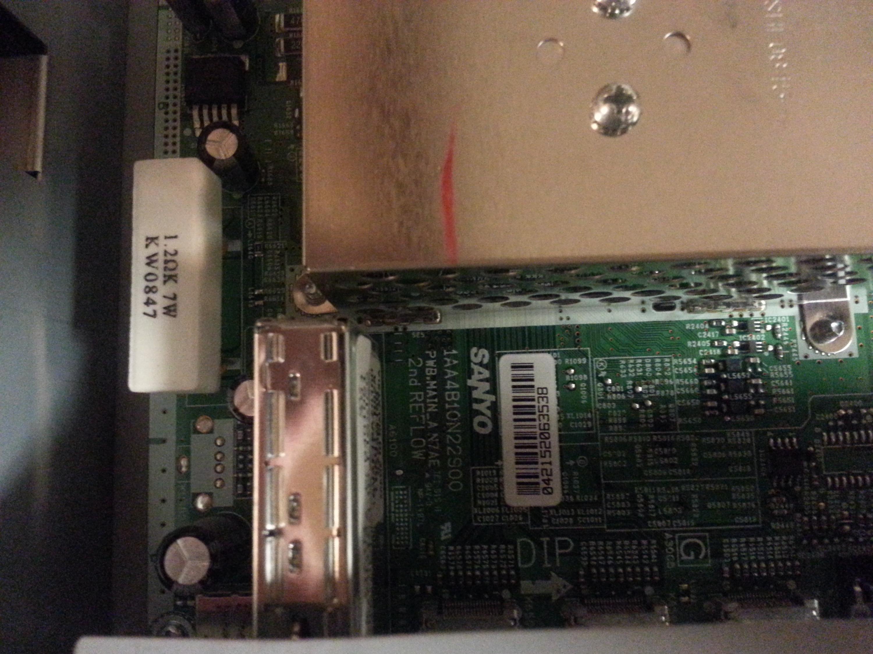

              I'm presuming you own a digital multimeter?
              Service manual is here
              http://www.tgohome.com/ServiceManual...&Search=Submit
              A good, clear photo of your main board would help a lot, perhaps there's a part on the main board going wrong.
                  I would suggest trying to heat up parts of this board
                  https://www.badcaps.net/forum/attach...3&d=1385086482
                  (the main board)
                  to see if you can get the fault to occur. Keep heat low. A hairdryer works well.

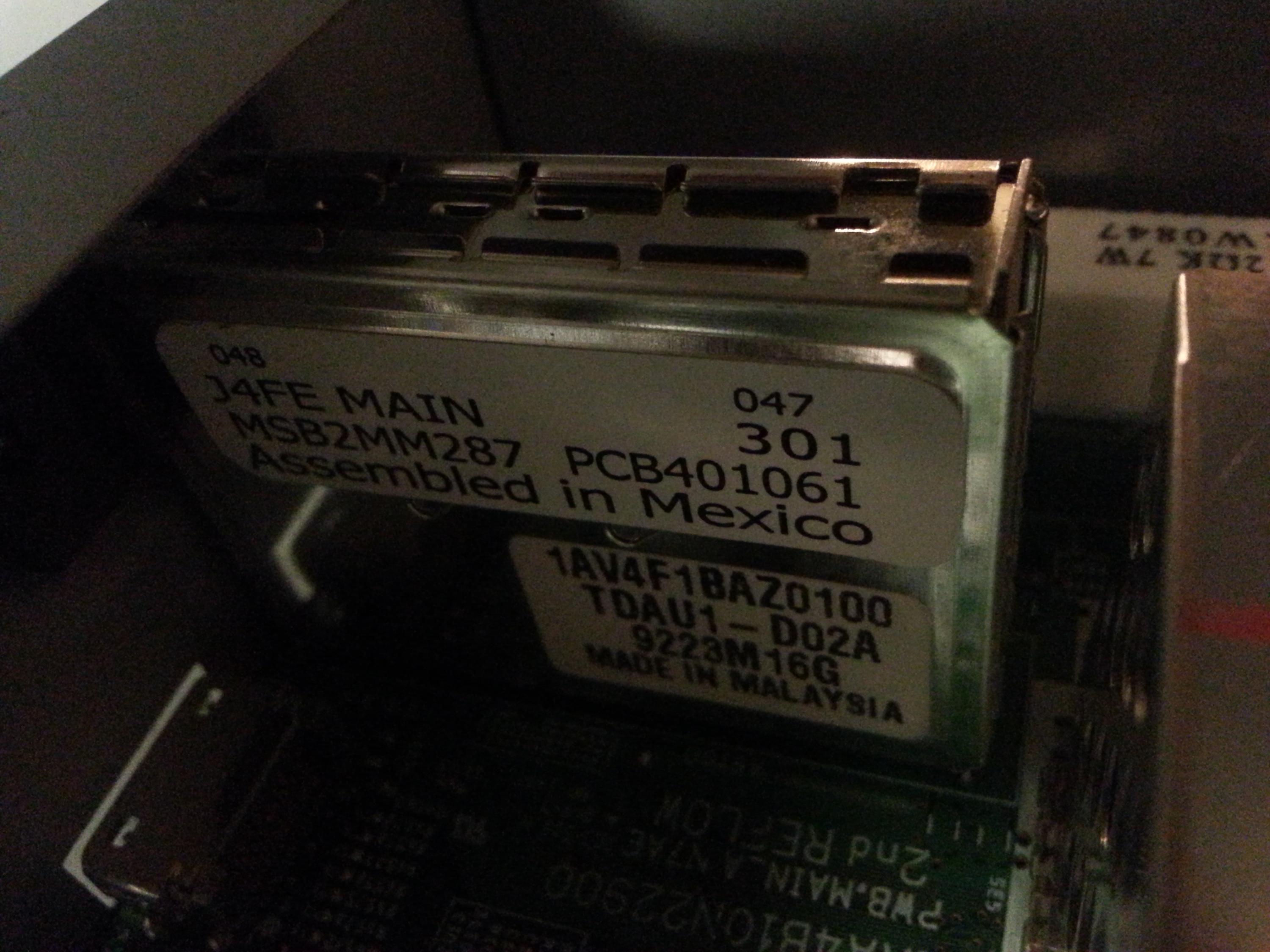

                    I am going to try and do some trouble shooting this weekend. But if my problem turns out to be the main mother board J4FE, is this something I can try and fix or do I need to try and find a new one? I have searched around and can not seem to find one. So any suggestions on what I should try and do?
                      There are schematics for that part, so there are some things that we can check for faults. But most likely you would need to replace the board. It may end up being expensive. You could keep an eye out for TVs like yours with broken display panels, and swap parts around.

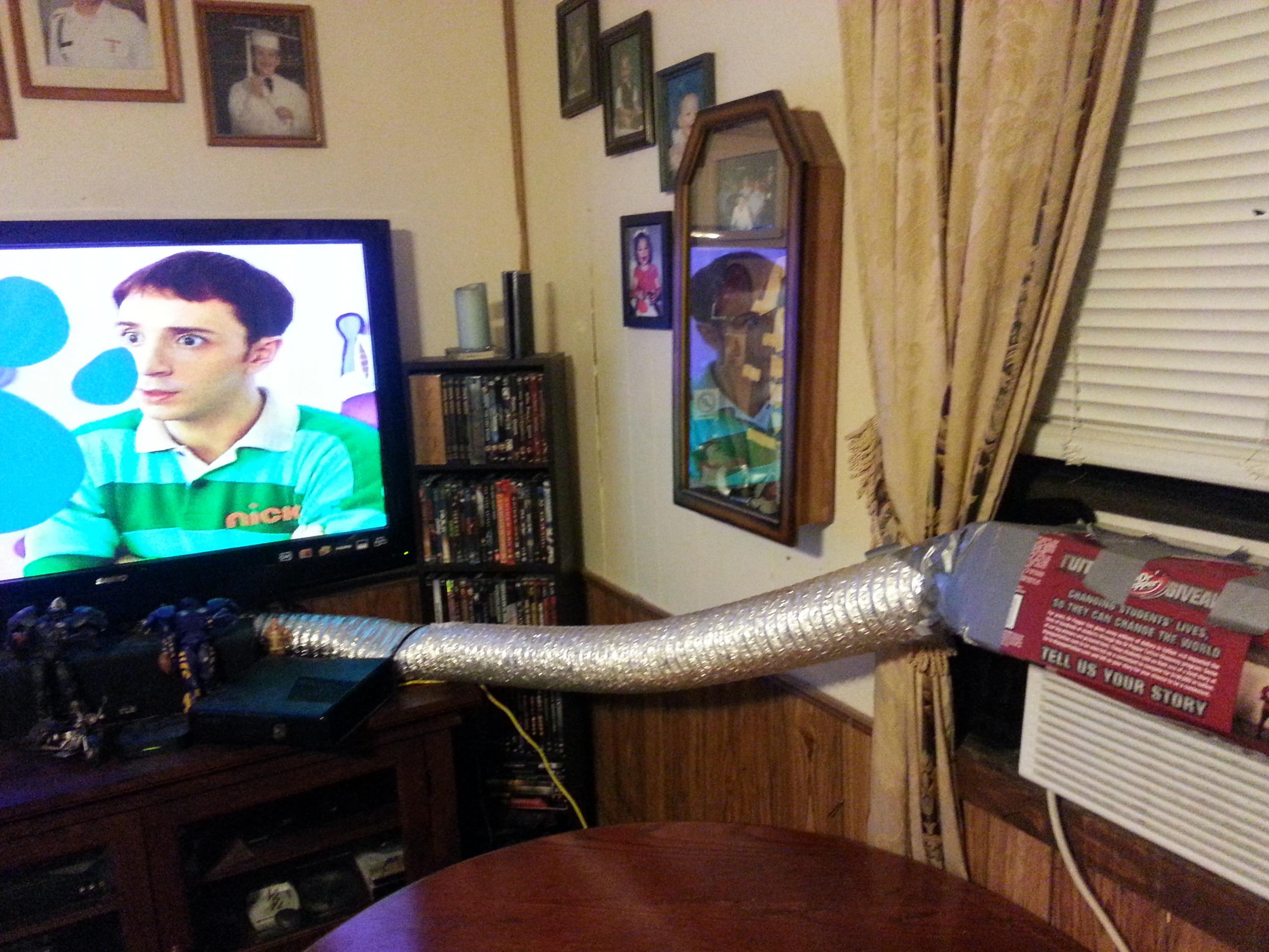

                        Just thought I would give you a quick update Tom66. You have been pretty helpful, so I thought you would get a kick out of this. I have a window a/c unit close to were my tv is, so I decided to try my redneck engineering abilities out. I took a empty Dr. Pepper box to make a plenum, a clothes drier exhaust duct to run from the a/c to the tv and placed the duct to blow cold air at the main board. Oh, and yes I used a whole lot of duct tape! (it's ok to laugh now) I set this up yesterday after I got off work and so far, the tv seems to be working ok. I guess I am stuck with this set up until I can find and afford a main board. But at least my kids can watch some tv while they are out for Thanks Giving break.

                          Pics or it didn't happen!

                            You can laugh, but it is working!
                              Well I was hoping I would be posting good news by now. I finally got lucky and found a main mother board J4FE (which are near impossible to find) and changed out the one that was in my TV. I got everything back together and thought it was good to go. Nope.
                              The picture still goes dark after a few minutes of operation. It turns on and runs fine for about 10 minutes and then you can see the white colors start fluctuating and then the picture goes dark. I put the a/c duct back to blow behind the tv and it works correctly. So as long as the unit has cool air blowing on it, everything works. I will try and get a picture of the screen going dark to help see if anyone has any ideas. But I am getting close to saying the heck with it and buying a new tv.
                                Is it possible you received a bad part?

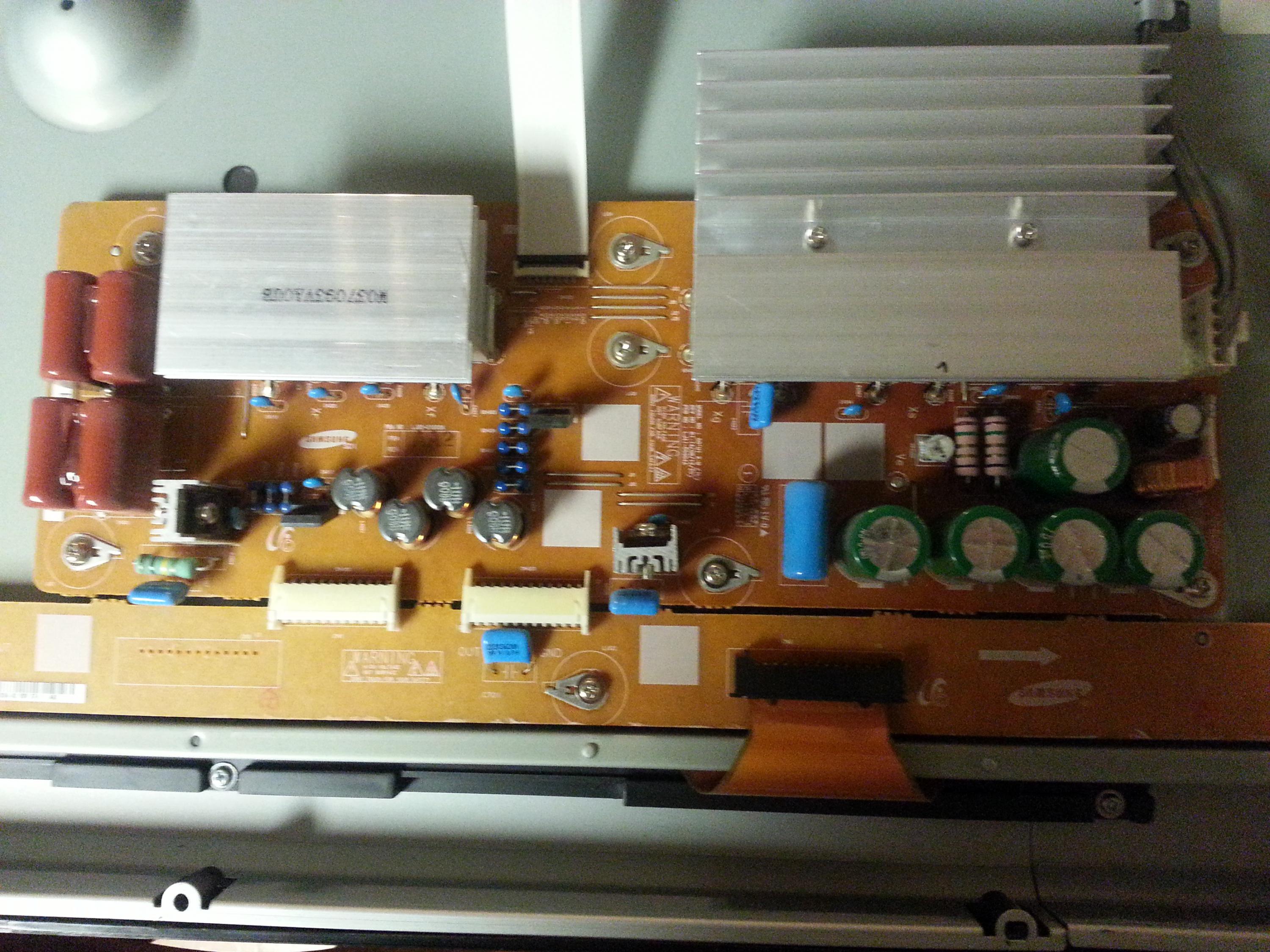

                                    It was suggested the problem may be with the X-main board. So I am going to research that part when I get home tonight.
                                    • gillisfire
                                      • Nov 2013
                                      • 16

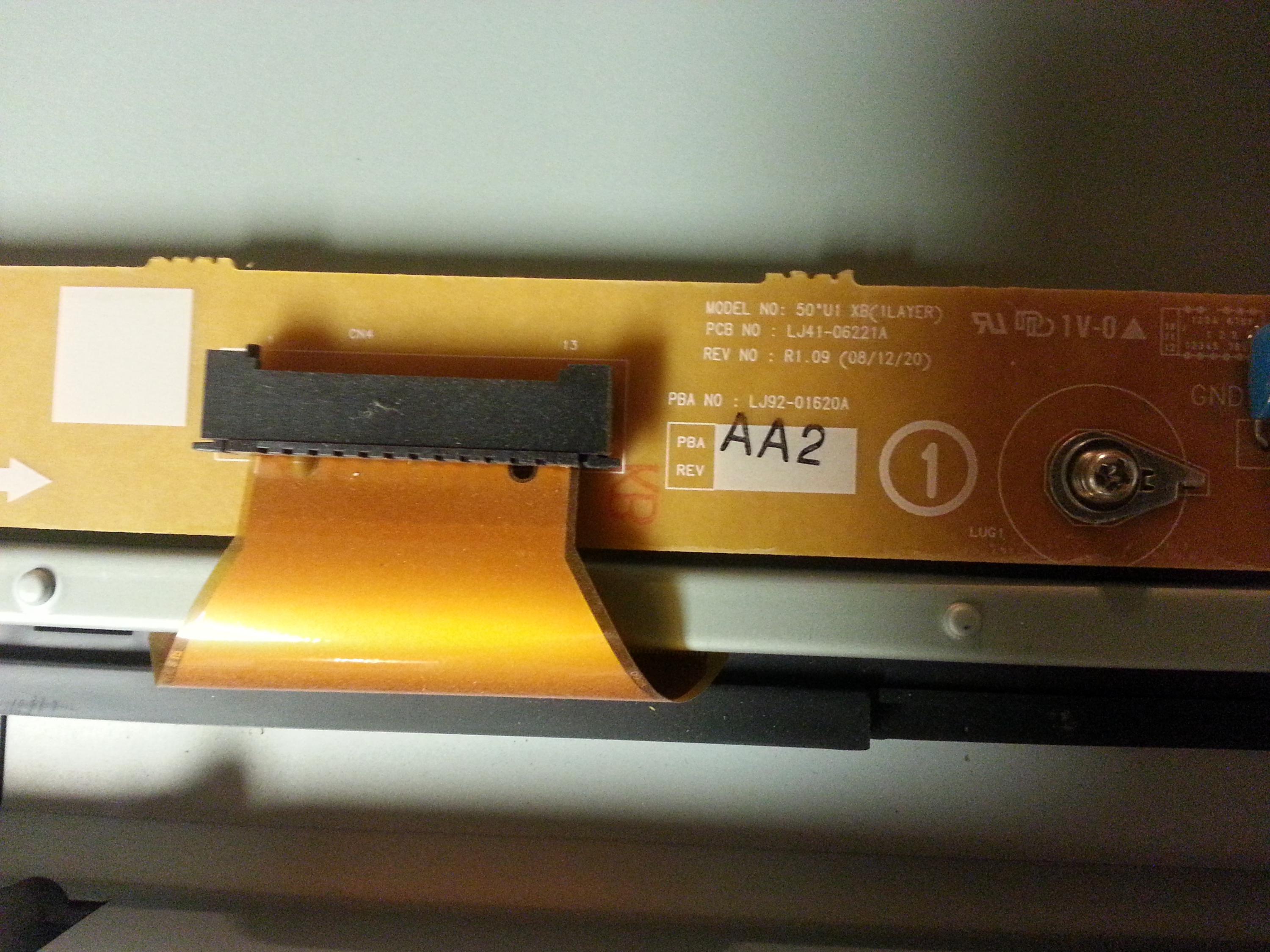

                                      Well I wasn't to sure how to check the X-main board so I looked for one online. I finally found one and the price wasn't to high so I went ahead and ordered it. So I will post a follow up when I get the new board in. Hopefully this will fix my issue. Or I may end up with a filling cabinet full of extra parts!
                                      I am still open to any other suggestions. All help is greatly appreciated.
