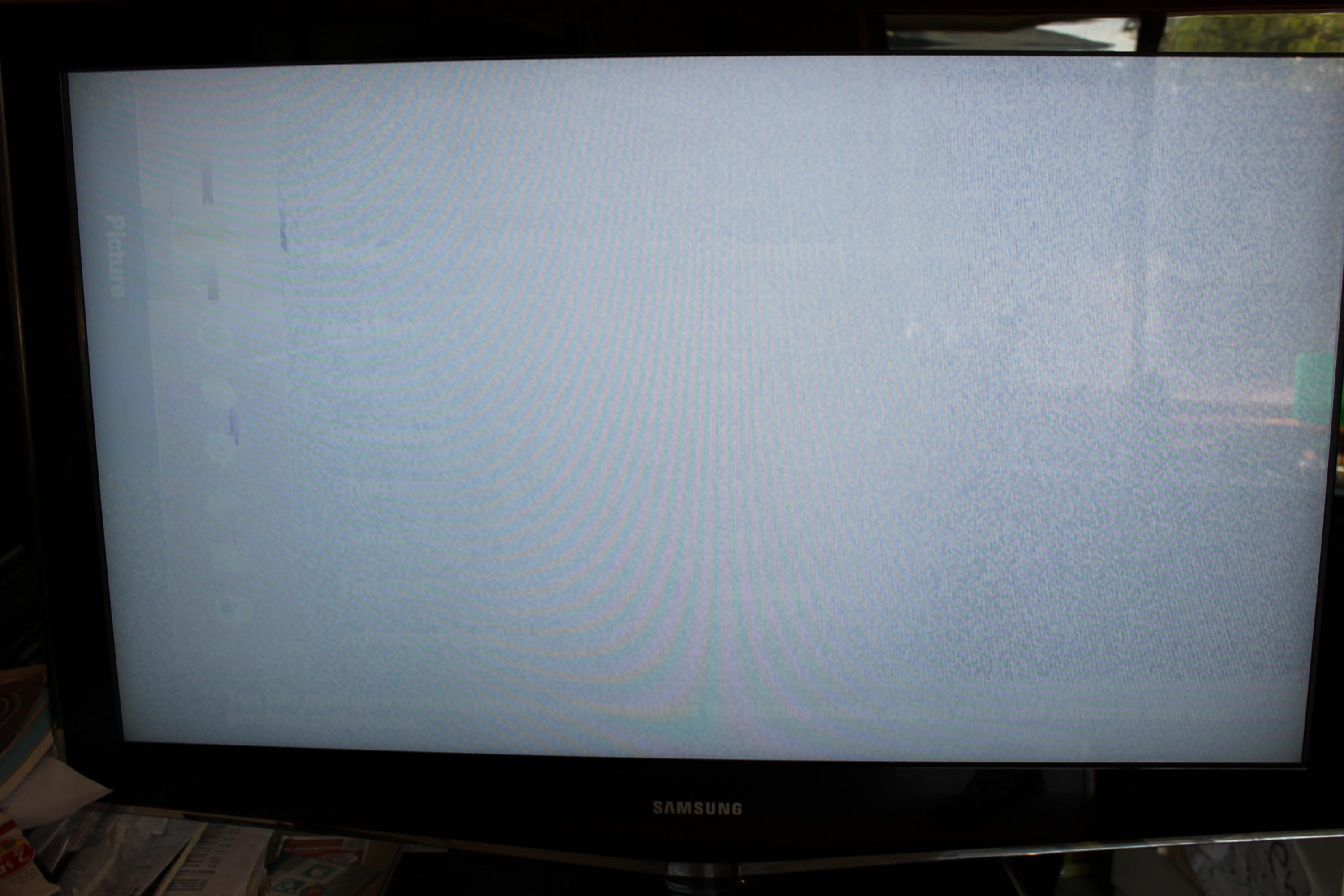

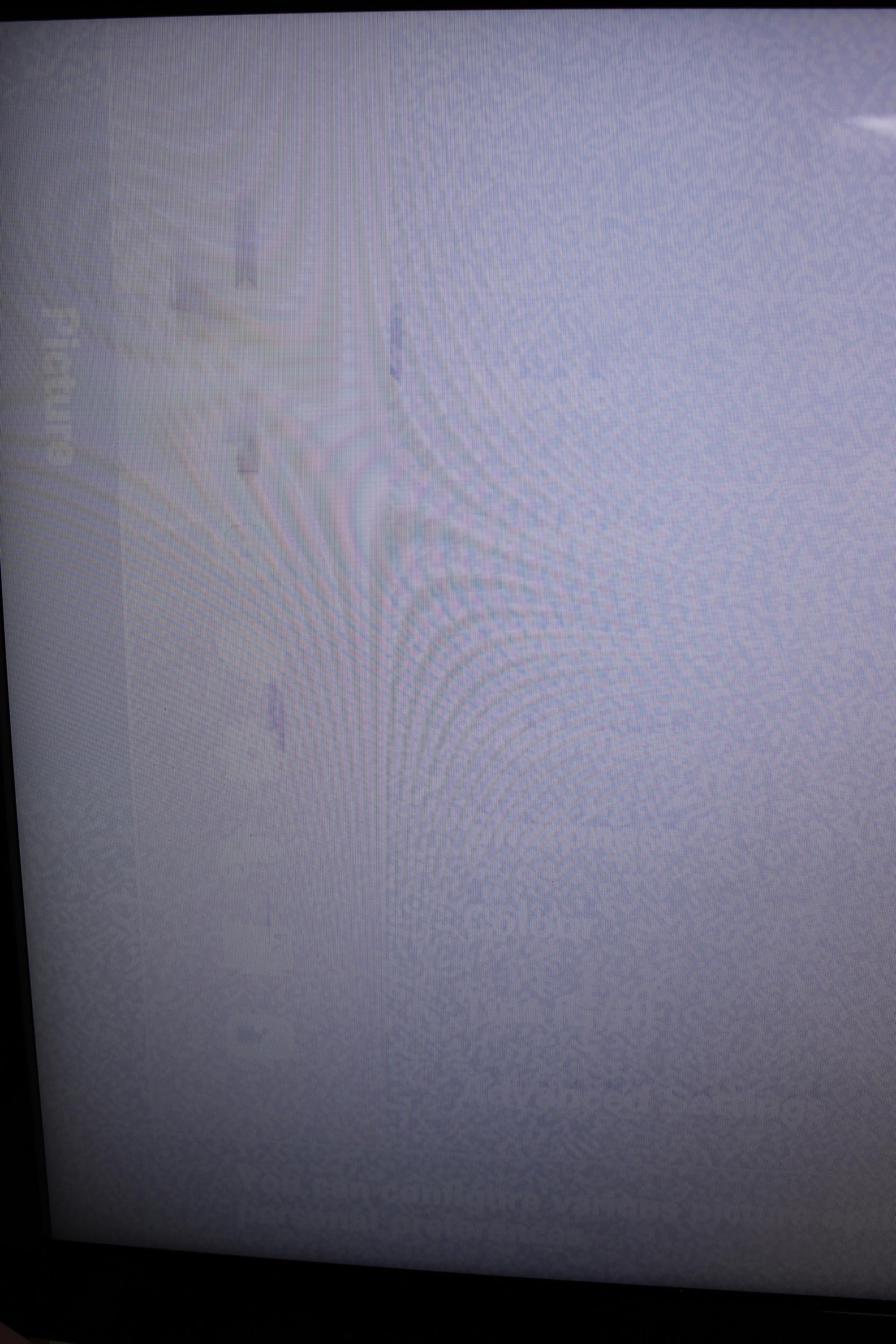

    i thought this was going to be the as15-u chip, but gamma voltages seem ok.
    can it fail and still give good readings, or is there anything else that i can test.
    gamma voltages
    294.8 mv
    0.576 v
    2.657 v
    4.07 v
    5.48 v
    6.83 v
    7.06 v
    7.76 v
    7.88 v
    10.2 v
    10.93 v
    12.83 v
    15.14 v
    15.49 v
    thanks guys!

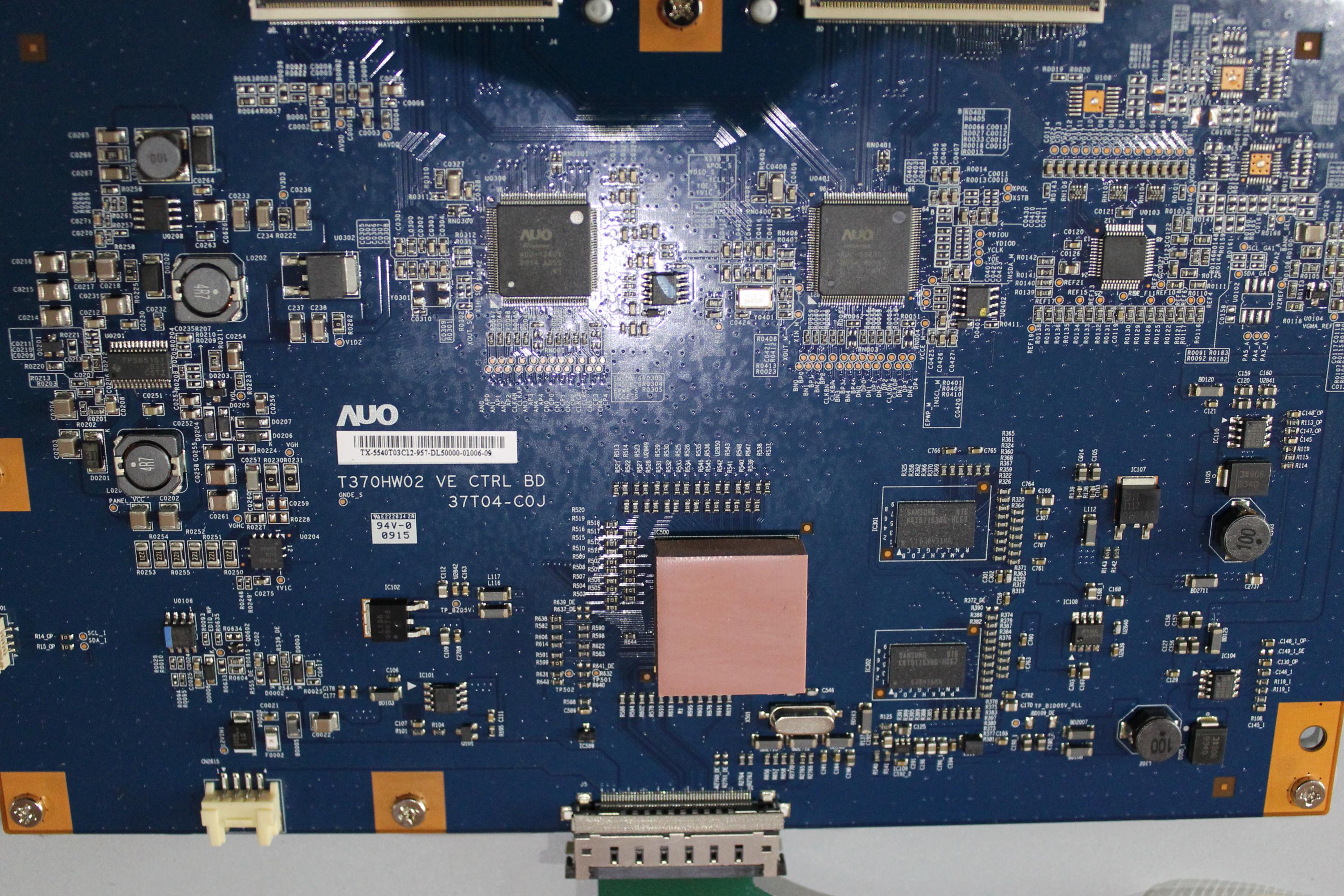

    Re: samsung la40b650t1fxxy
    Those voltages do still look bad -- they jump too much. The increase should follow a smooth curve, centered around 7.5V (AVDD/2 or VCOM.)
        Ignore the horizontal axis of the graph. Your voltages should be 7.5V in the middle, and then spread out identically from there.
            Check VCOM, VGH, VGL too.
            VCOM: ~7.5V (often generated by GAMMA chip too though)
            VGH: +15~30V
            VGL: -5V~10V
                I think VCOM is also bad, but it's generated by the AS15 IC. Therefore, replace that IC.
